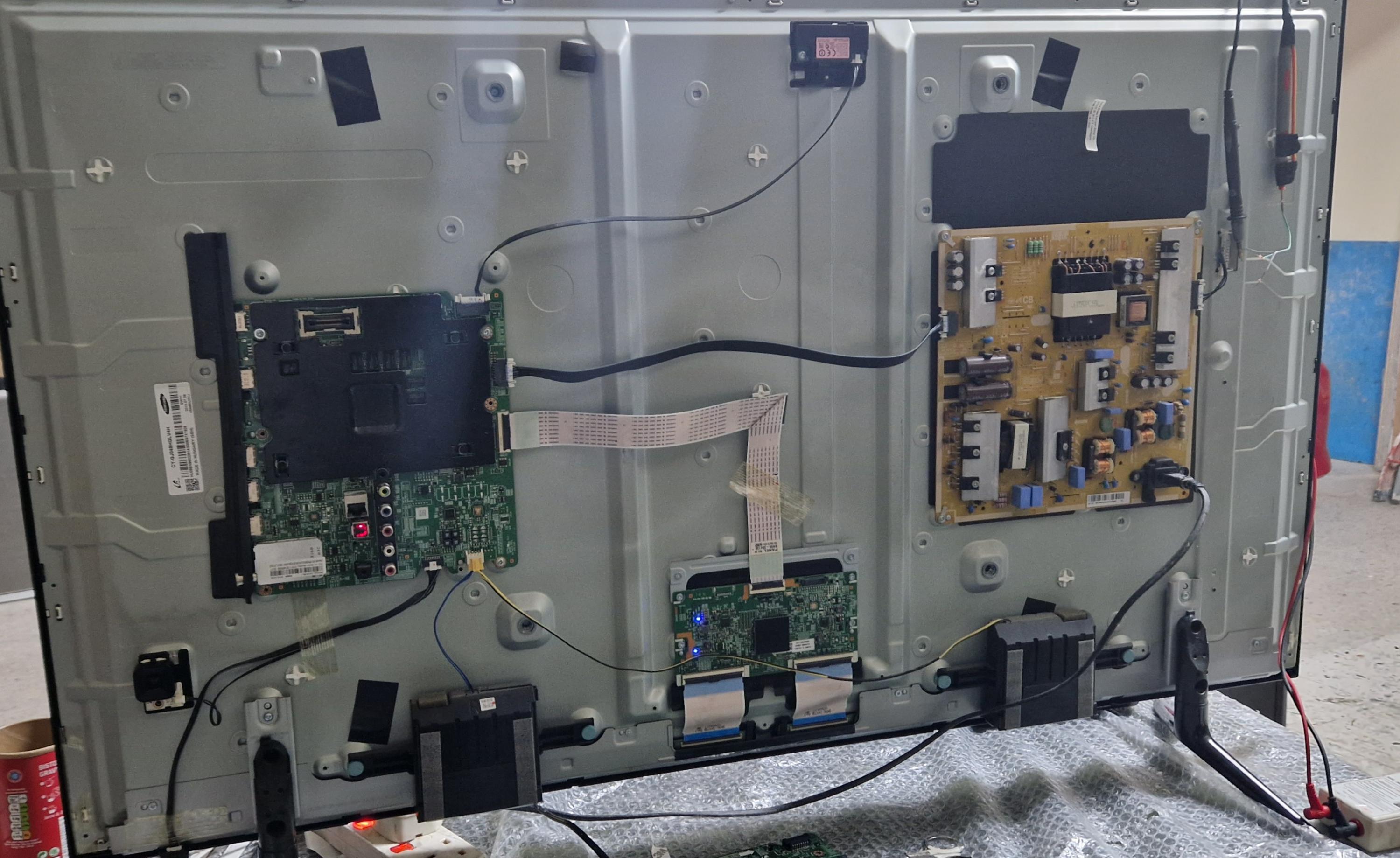

        Hi, you have bad backlight leds /single led, this is typical situation of recent Samsungs, disconnecting main board reduces current to the leds ,also in faulty ones , that doesn't let to flow too much current that the led manager can accept, remember with a shorted/leaking led higher current flows through it, also because default brightness is less than normal one, disconnecting tcon probably shuts off the image sending, maybe software reduces the amount of brightness (dynamic brightness).. this is my guess..

          If i remove the Blu_pwm pin the backlights are on full intensity.
          OK, this confirms that backlights are turned off by main board.
          But it could be because of detected error. There is FAIL_COUNT pin, maybe it's reported through that pin.
          Could be brief open circuit in backlights or on PCB.
          You can experiment with known good LED strips or light bulb.
          LED tester with adjustable current up to few hundred milliamps can help to detect some strange problems with backlight.

                I think everything is fine. The smaller tv has fewer leds and would take less power. Since you have a bigger tv with more lights the main board thinks it’s to much power and shuts it down.
                Either leave blu pwm unplugged or get the correct mainboard.

                    Ana_Dim to ground will decrease the backlight noticeably but still enough. So for a quick cheat fix put Ana_Dim to ground and BL_Pwm pin open which rises to 3.2v.

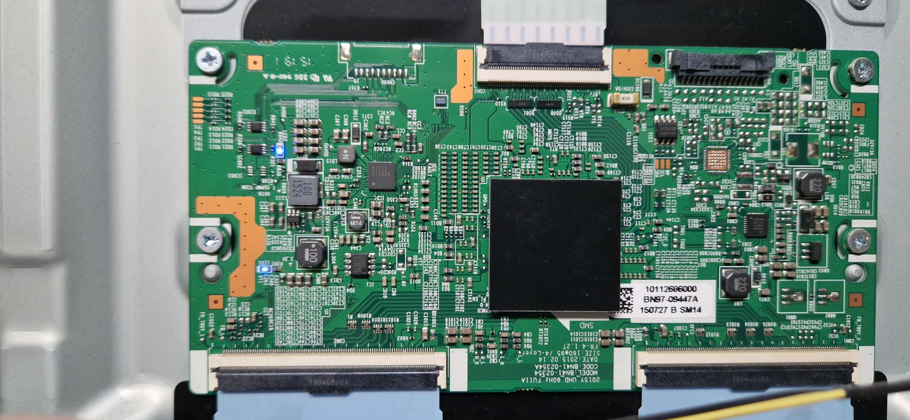

                    Probably stopping here. If i woild continue i would try to change TCON to the same one used with the replacement mainboard.
                    The original main was too expensive and customer wouldn't accept repair unfortunately. I took a chance as found a cheap alternative board and learned quite a lot as well in this thread.

                                Davi.p I have tested with an external set of good LEDS and made no difference. Also the Power supply is equipped with protection circuit that switches OFF leds in case an abnormal current flows.
                                I know how to do a professional job by replacing with the original Main Board BN and version. But was beyond uneconomical repair.
                                I have explained to customer why the Backlights settings do not function. The LED voltage is now 96v instead of 104v. With full intensity the back plate was getting hot. With 96v barely warm.
                                  This is not a sufficent test, this is for psb testing not led testing!
                                  By these 2 answers i see the delicate problem of backlight is not enough clear to you..
                                  it is not a matter of bad mainboard, never read these talkings..
                                  you aren't probably trusting me and this is bad because you will have some returns in future..
                                  it is commonly known in tinkerer's environment that common cheap led testers are not enough to fully test backlights, unless you know how to do it, i have no much experience, i know leds must be exposed, tester must be set to very low current, you will have some leds that glows a little and the faulty ones that doesn't glow at all..
                                  i don't know what do you mean for back plate, is that the rear metal chassis? If it heats too much it is another proof some leds are bad.. because with shorted leds, good leds has an higher V than specs on them and overheats..

                                    Am open to suggestions here for my performed LED Test methods:
                                    1) Use the common LED tester that ramped voltage up to 90v only same on each pair. Full Backlight DC voltage is 104v. So here I agree that tester current output is not enough.
                                    2) Tried a similar model but bigger TV. Same results with just a split second burst of LED On.
                                    3) Found a set of good LED Strips (as I always keep good tested strips when replacing complete set just for testing purposes) and had the same problem and exact voltage measurements.

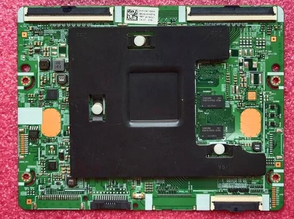

                                    So then my focus went on the main board again ( Original had shorted CPU) knowing I took the risk with difference in BN number although intended for same model UE48JU6000K but mine is UE48JU6000KXZT version 01.
                                    Checked online and found both use a different TCON as shown here. If I manage to get hold of this TV I will purchase the TCON and see what happens. Then I know there is the panel (screen) issue but the service mode has tens of different screens that I can choose . ( I already did this, I got upside down pic on some options)
                                    Re backplate heat: At full intensity (value of 20), the LEDs will get HOT and the back-plate will get hot as witnessed in hundreds of Samsung sets before. I hope you agree on this one as am sure about this. This is one reason why I always reduce the Backlight for all TVs entering my workshop.
                                    After all this added info, do you still think it is an LED problem? Forza Milan

                                        I have just purchased a TCON which is paired with my new mainboard. It was cheap enough to try it out. Will update here once it arrives.
