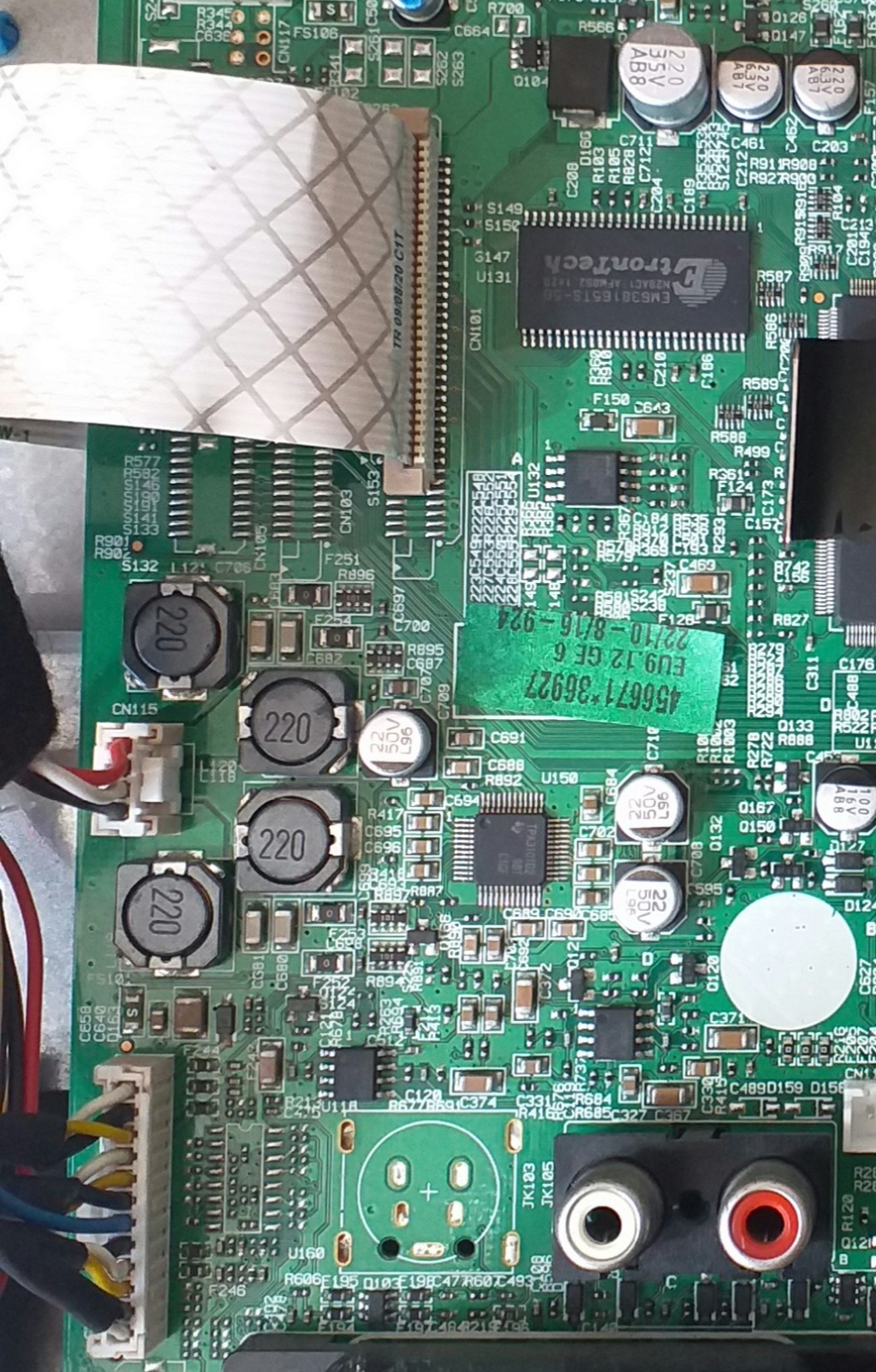

    Hello, everyone
    I have no sound otherwise very nice picture, here is the info from TV TV Main Board TDTC-G101D 10063235 0910 900041
    from HDMI, DVD Play just no sound even headphones
    Thank you very much

    Re: Medion Tv MS20115 DE-A no sound
    Need to check voltages around audio ic.

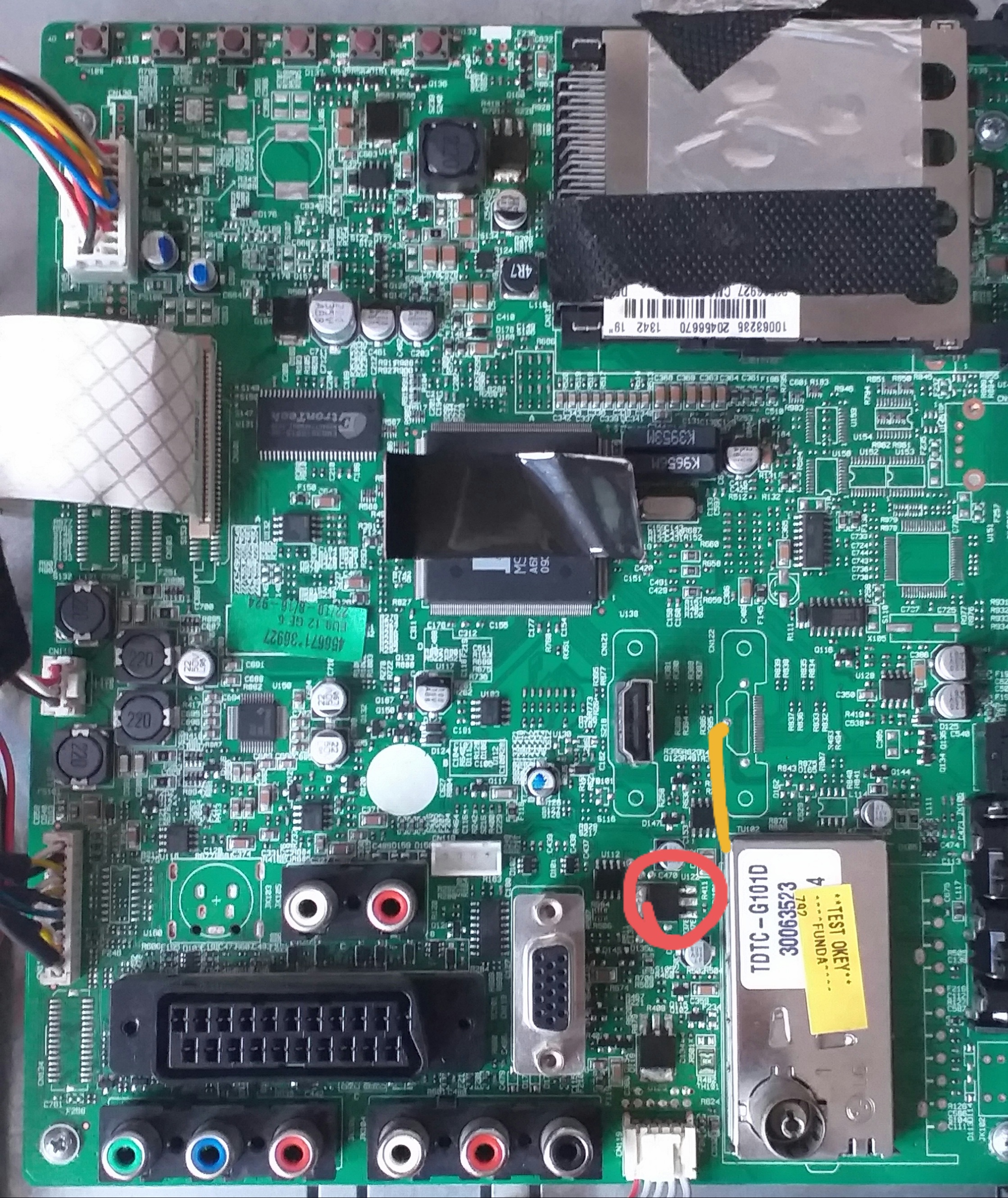

        Originally posted by samtron786
        a question what voltages should have??
        here a regulator gets very hot AZ1117D
            can check the datasheet on that regulator, are the other ones on the board the same with same id? if so maybe check the voltages on them and compare to that one.

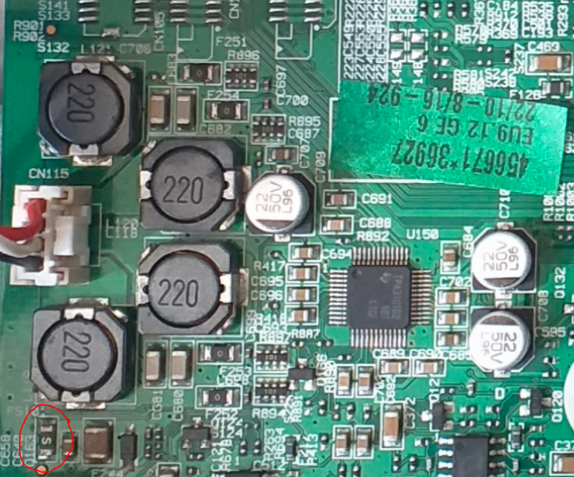

              Audio chip looks to be u150.
                Check the fuse, it may be responsible for powering the amplifier.
