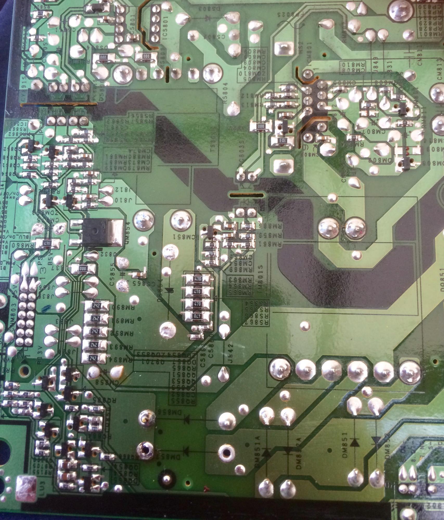

          Re: Samsung UE46EH5000 - Flashing red light but not turning on
          from the bottom of board trace that diode to the next component check that and continue, kind of hard to tell from here without good clear focused pictures of bottom of board.

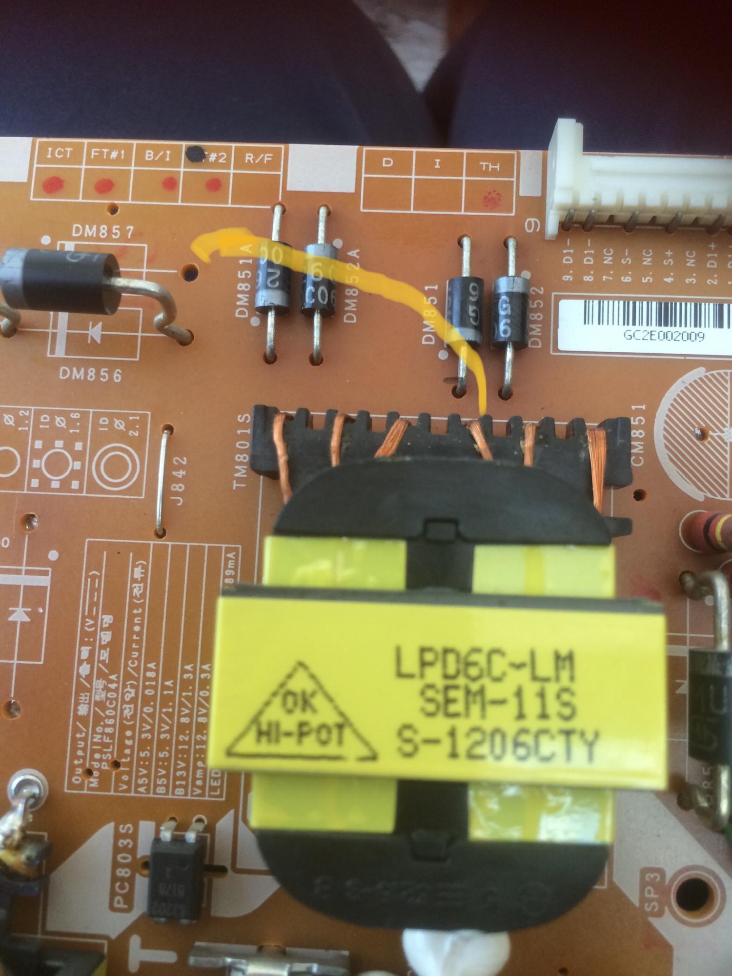

              Have checked the hole that the diode fixes to and it runs up to what looks like a transformer which goes from the hot side to the cold side but more worrying is that it seems to be shorted to the chassis (ie if i use my ohms meter or continuity setting it bleeps or gives a dead short)
              I have attached 2 pictures of the bottom of the board to clarify.The hole in the center of the rear of the board is the ‘shorted' hole.
              Esr readings for the caps were
              25v 470uf = 0.06
              10v 1200uf = 0.03
              25v 470uf = 0.04
              200v 47uf = 0.24
              350v 22uf = 1.7
              The 3 diodes are SR510 OC02
              I'm not really sure how to measure them but on my diode tester they read 283 and on a 20k ohms scale they read 1.64 - how should i measure them?
              Do you think the transformer could have blown?
              Thanks for helping I probably would have given up ages ago without the guidance here but it also a good learning curve 🙂
                  probably schottky diode, so 283 in one direction and l in other direction out of circuit is probably ok.
