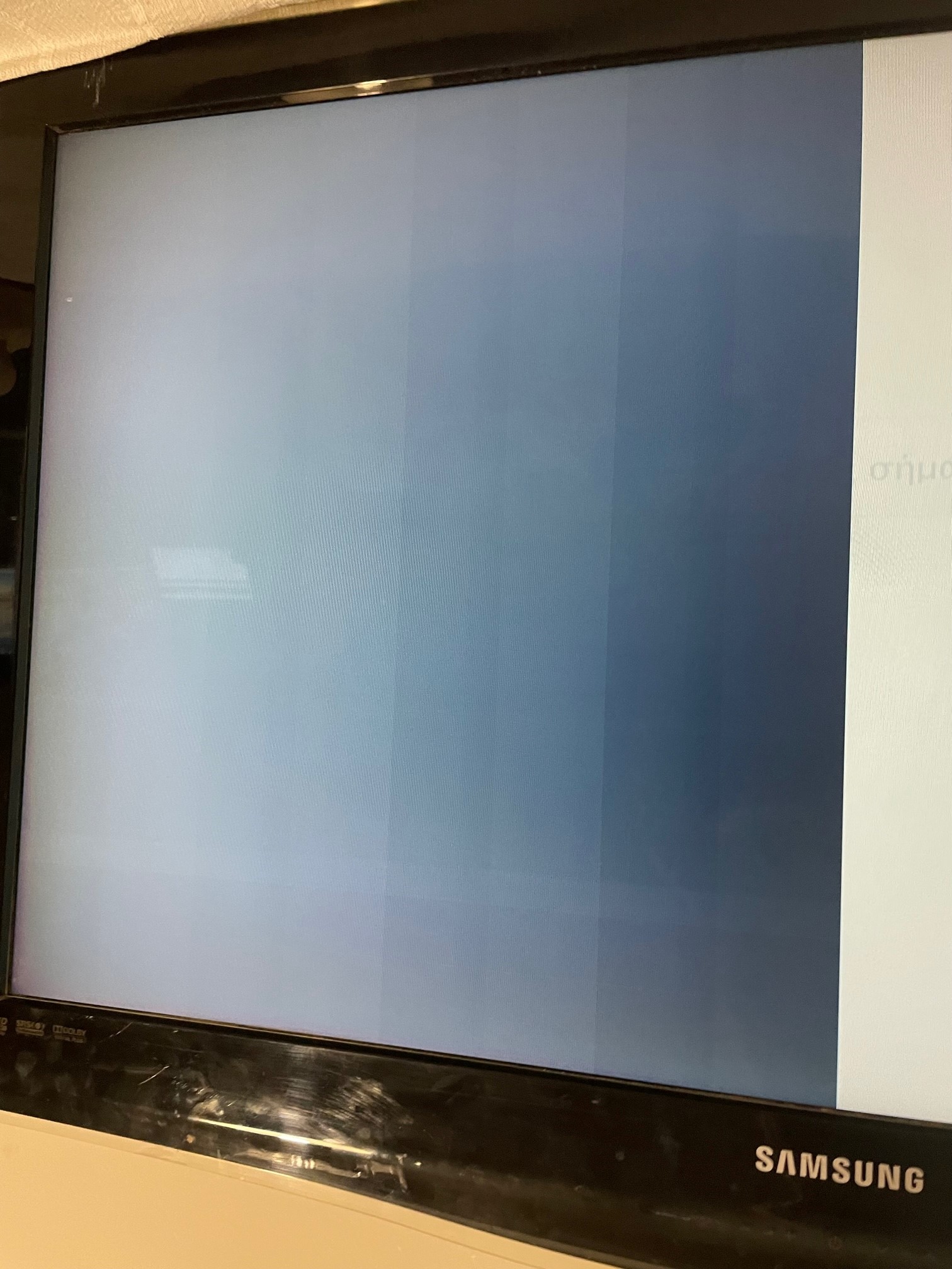

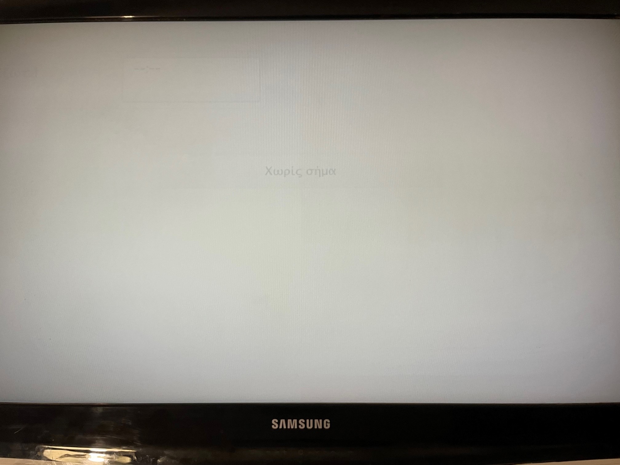

    I picked up this TV with a problem showing white image.

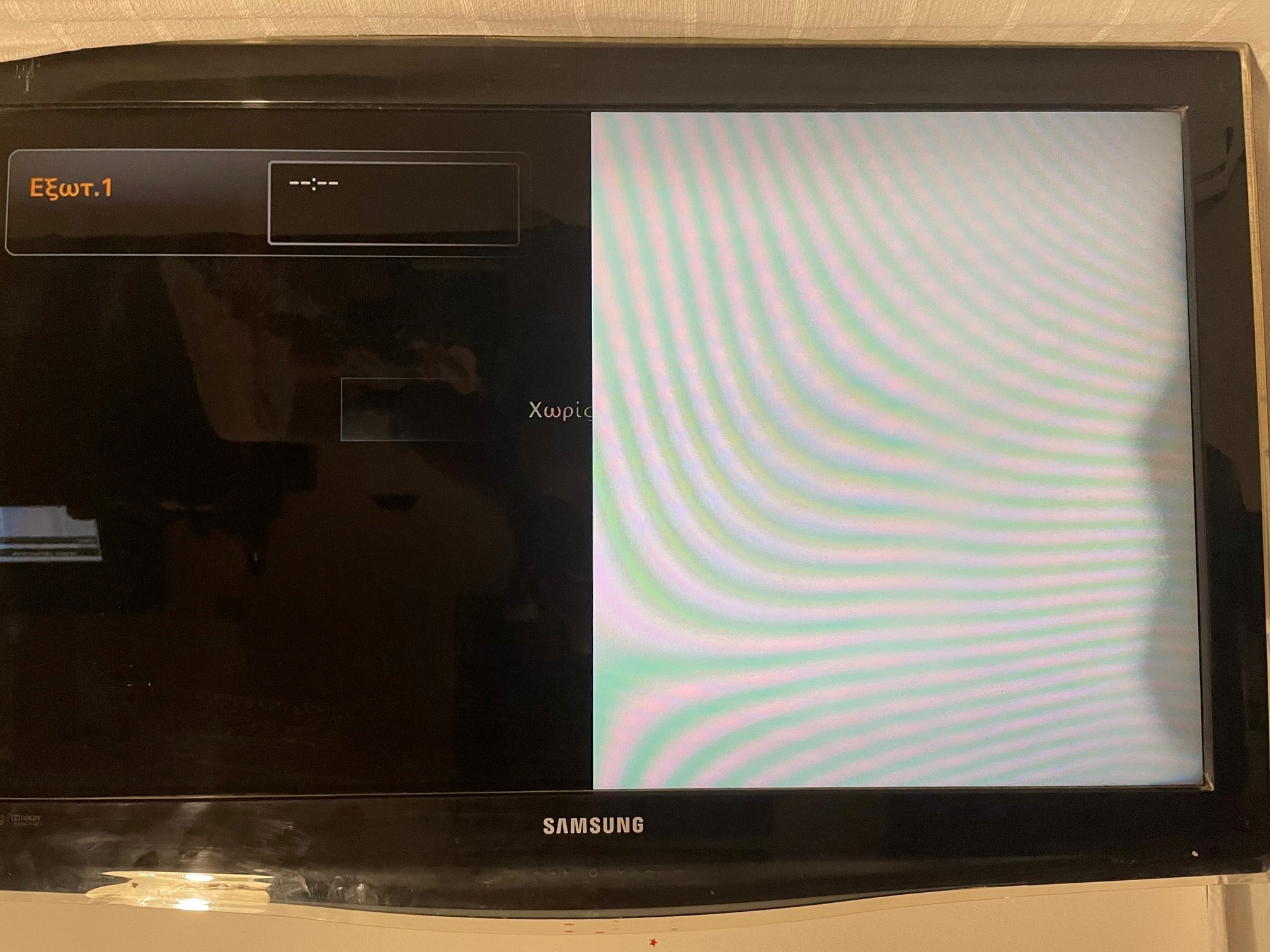

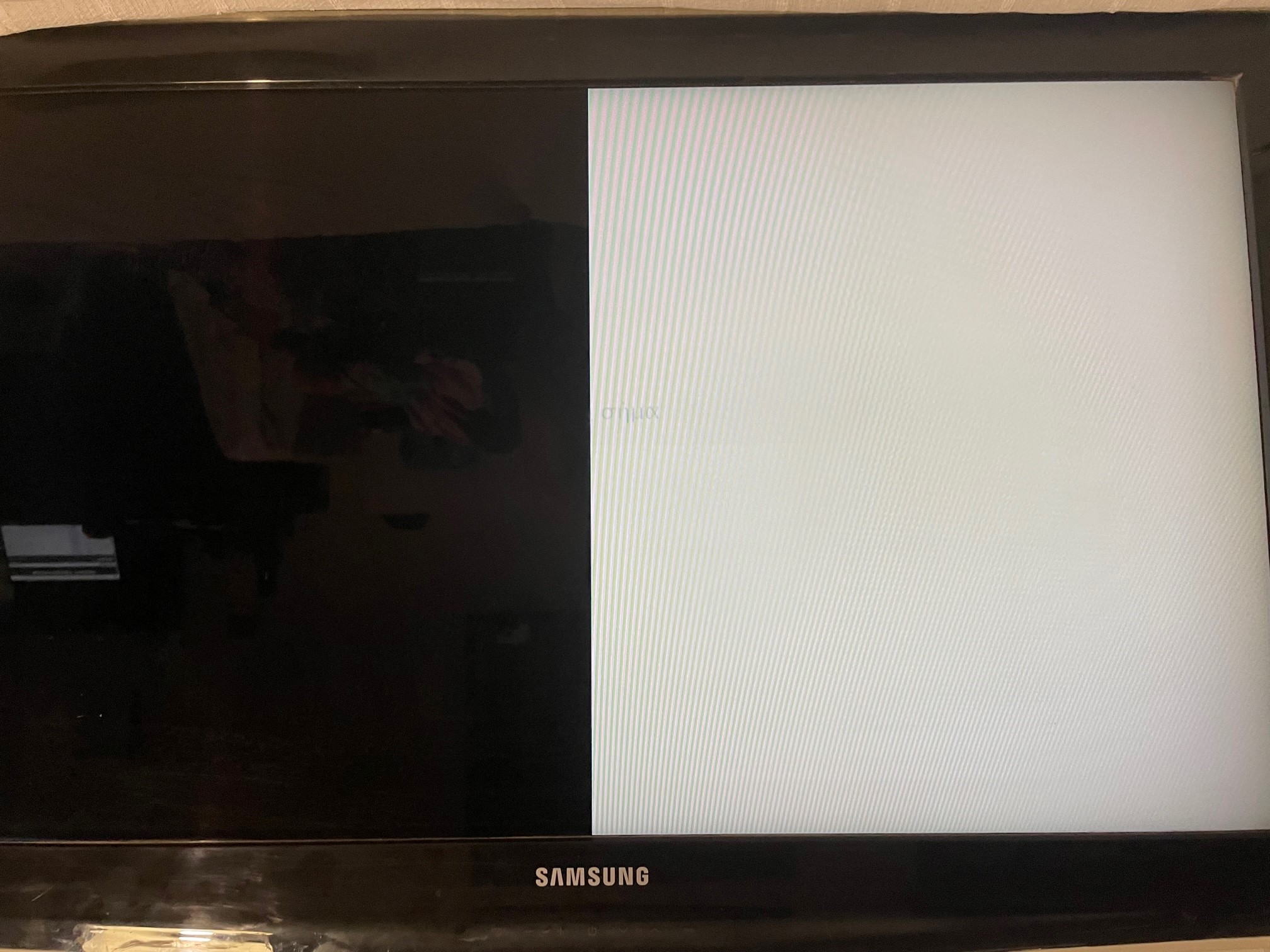

    When I unplug the right ribbon from the T-con to the panel board the right side is white with a dark shade at the edge and the left side shows perfect image.
    When I unplug the left ribbon from the T-con to the panel board the left side is dark and the right side shows image but white. After a while the left side turns grey with vertical and horizontal lines. I found online that by swapping the AS15G it fixes images problems but not in my case.

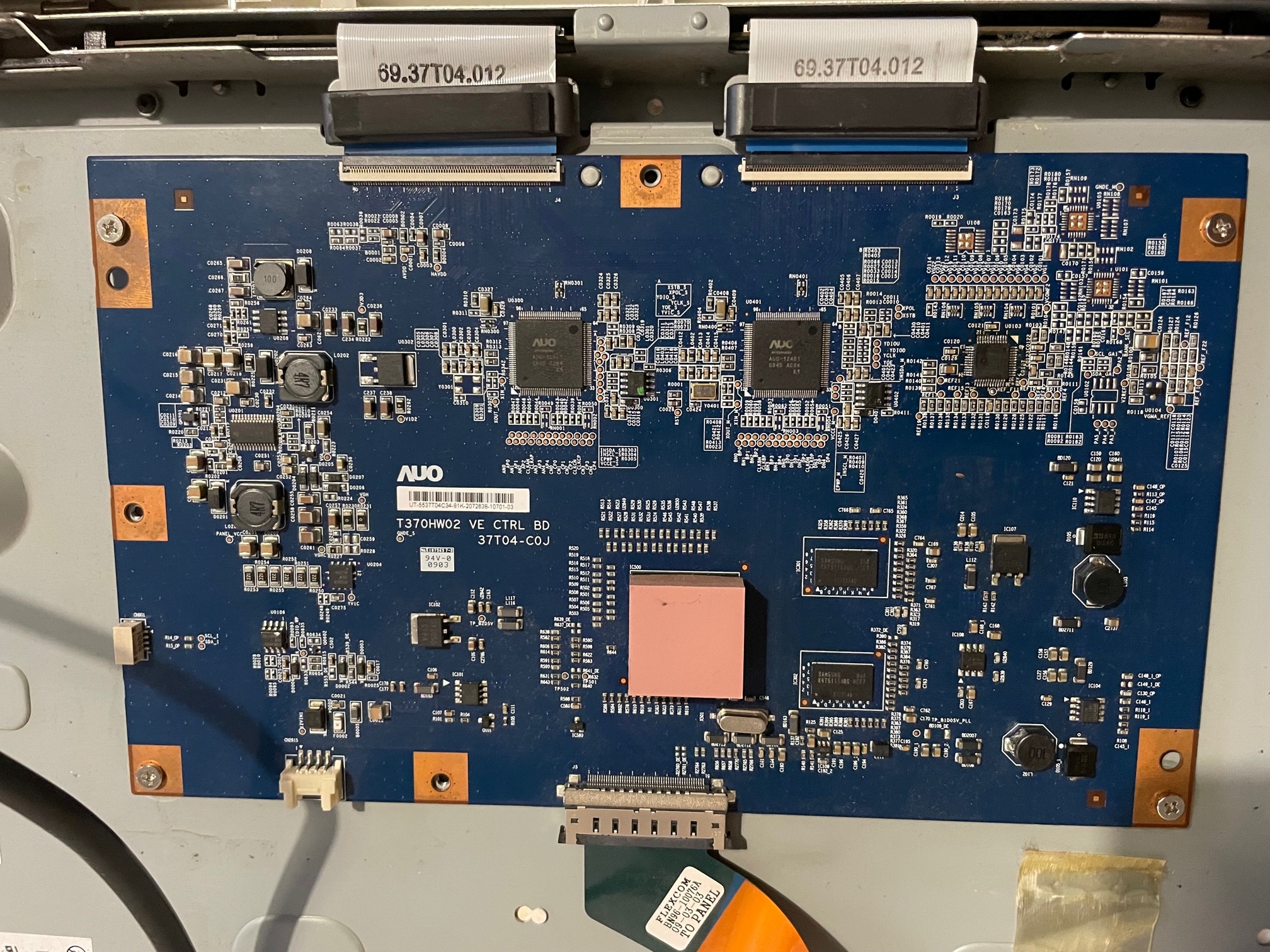

    could be tcon or panel problem, maybe try the tape cut-off method.

      That's going to be the gamma IC on the t-con, I'd guess an AS15-F.
      It's the IC top right in photo #2.

          Most likely a panel problem. Also lots of test points on t-con to check.

            I've done AS15 or tcon swaps with whitewashed video on these old LCDs before with no change so assumed the problem was in the panel.

              So are you saying you changed out AS15G and have same exact problem?
              Yes changed the IC but nothing changed.
              I kept the boards and threw away the rest TV after seeing your posts. So thank you all but TV is gone

                ooo, that was an early toss, many times it's just one of those little capacitors on the panel driver board that needs changed out.

                  You changed it more than once ? it's not uncommon to get a faulty AS15.
