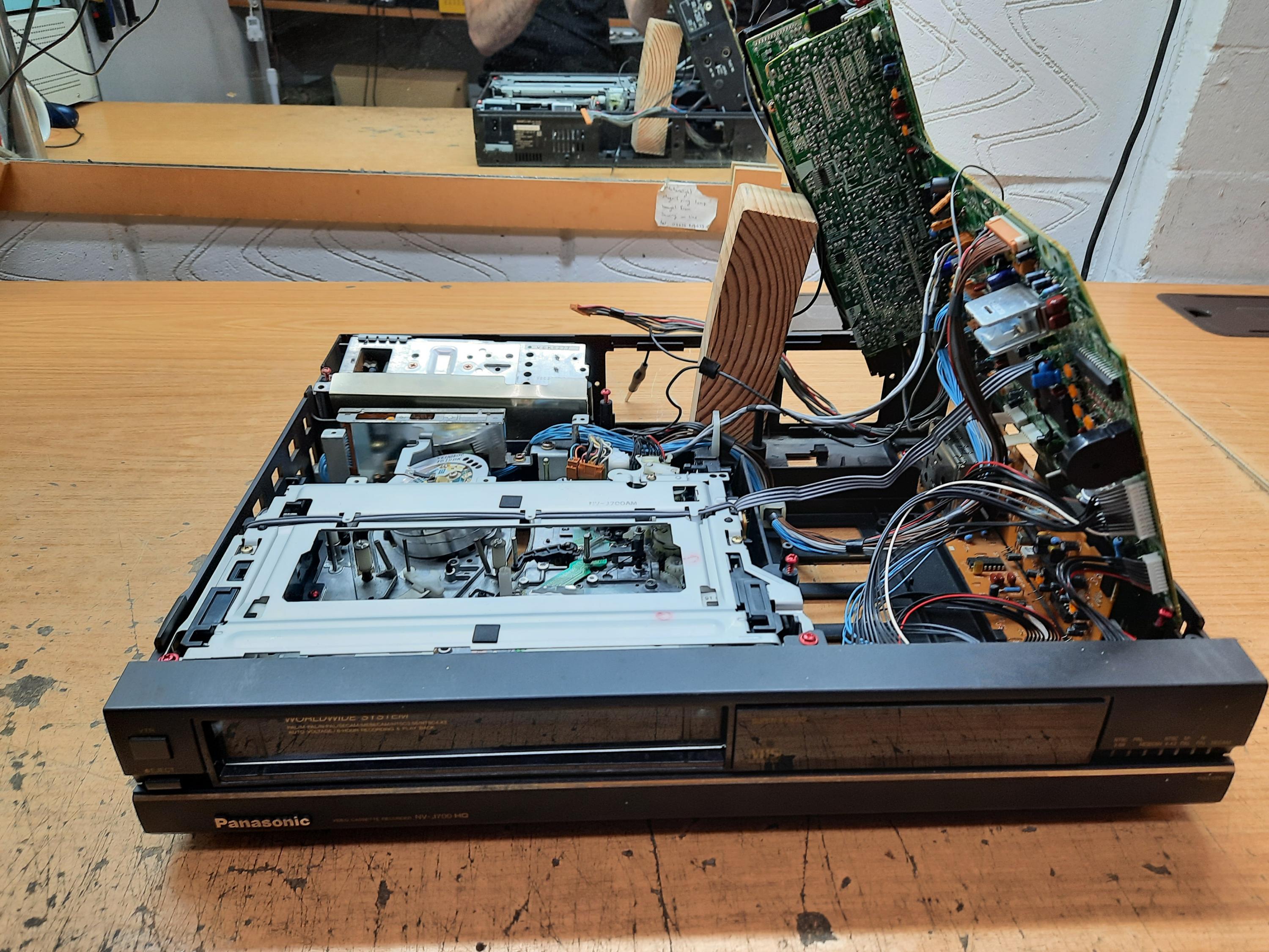

NVJ700 . Interference & glitching on playback .
07-06-2022, 04:56 AM
Hi all
The glitching is random & almost seems servo related .
Can anyone advise ?

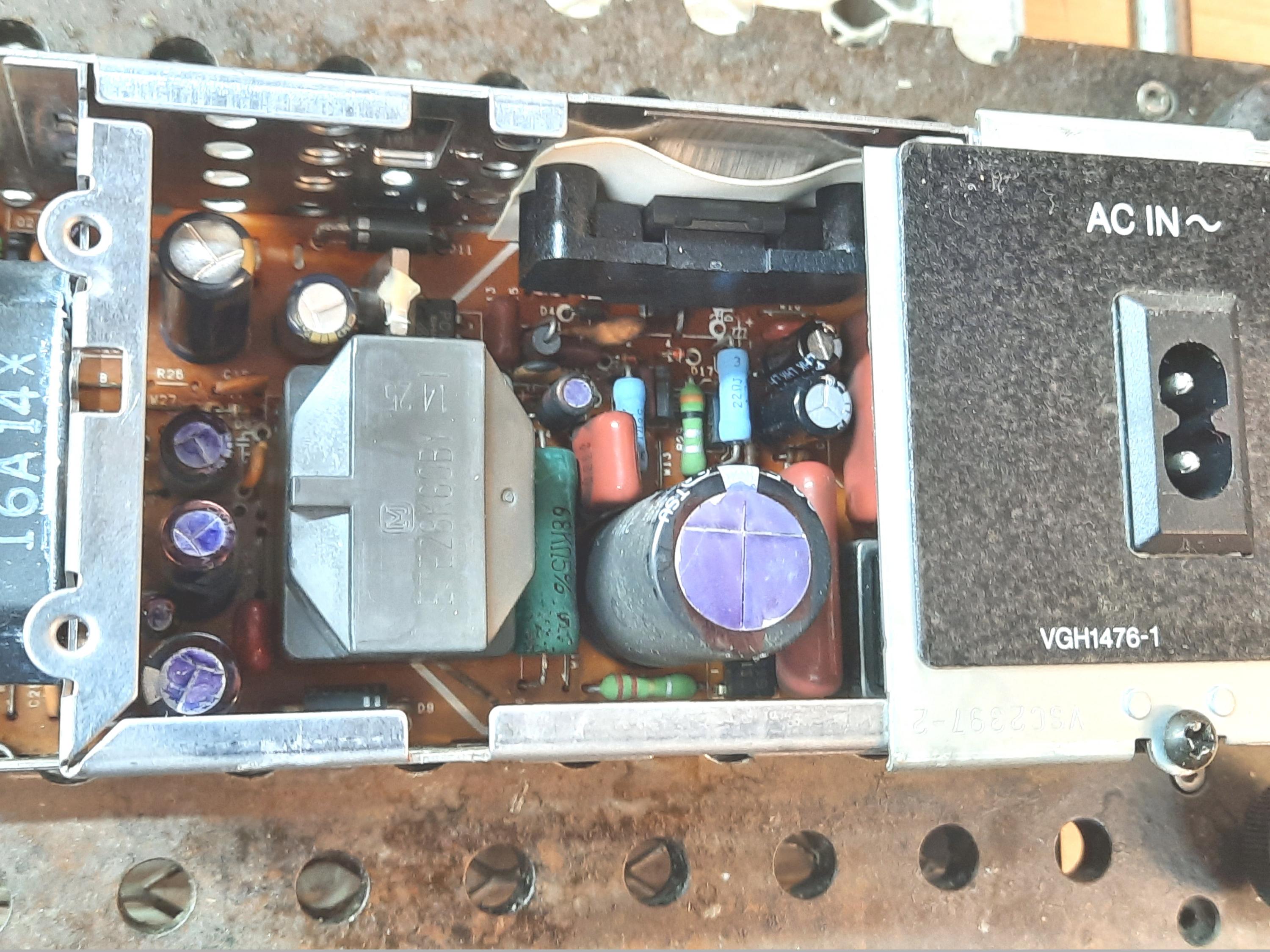

07-06-2022, 07:22 AM
Re: NVJ700 . Interference & glitching on playback .
Discovered that symptoms would improve when PSU module heated .
Replaced most of the caps .
Now on test .
