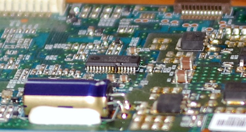

    Originally posted by Dgtech
    What is the part number of the chip in the green box (above pic) that is connected to the heatsink?
    I'm a little shocked that there is no fuse somewhere in the secondary circuit of that huge transformer.
    I'd be shocked if there was. The transformer has an output voltage in the 1500 - 2000 volt range. The output current is probably in the 100-200mA range. That makes for a very expensive fuse.
    PlainBill
    • Ripsnort
      • Oct 2010
      • 4
      #42
      Re: 42PFL7422D/37 Service Manual Needed
      Here are 2 pics. I see there are some inverter boards on ebay for this model. Must be a very common failure just with that little board.
      By the way, thanks for the service manual. Seems to be the exact match.
      Thank goodness for the internet!
      I have the exact same issue. Same exact location of burned pin.
      Is this an inverter board? I tried typing in the S/N on the back of the inverter board at B&D and it came back with nothing.
      Where can I buy one of these? Thanks so much!
      Edit: I typed in the wrong number.
      The *right* number I believe is LC420WU5.
      Did a visual inspection of all the caps and other boards, no buldging or leaks, and this part above appears to be the culprit.
      Any input appreciated!

        Pic and THANK YOU! Hopefully this will fix the problem.

          Well, If you do a search on ebay for the chip(bd9897fs), you will find multiple vendord selling it as low as $5 per chip. I just bought about 5 of them last week from a seller on ebay. I have seen this chip in a Philips set and a Vizio set. When I did the Vizio, it was nice to have an extra chip just sitting there. I removed it and replaced it within an hour. However, If you want to replace the board (LC420WU5), ebay sellers are selling this one for $120.
          • Ripsnort
            • Oct 2010
            • 4
            #45
            Thanks for the reply.
            I ended up canceling the order for the mistake in the board I ordered. (Thought I was getting everything attached! haha!)
            So, I did order the 2 inverter board kit. Plan on replacing both even though the 2nd shows no sign of duress.
            I'm crossing my fingers that this will fix the issue permanently. I've never seen an IC chip blow on it own. Something else has shorted out causing that part of the chip to overload. Maybe I'll have to sell it fast like you did. (I was planning on replace my bedroom 37" LCD with this back up TV....)

              The kits you refer to have four of the smaller chips and one of the larger (32 pin) chips. If you read my post here, (#29)
              https://www.badcaps.net/forum/showth...974#post129974
              this will minimize what you need to replace.

                Fixed! Thanks again all!
