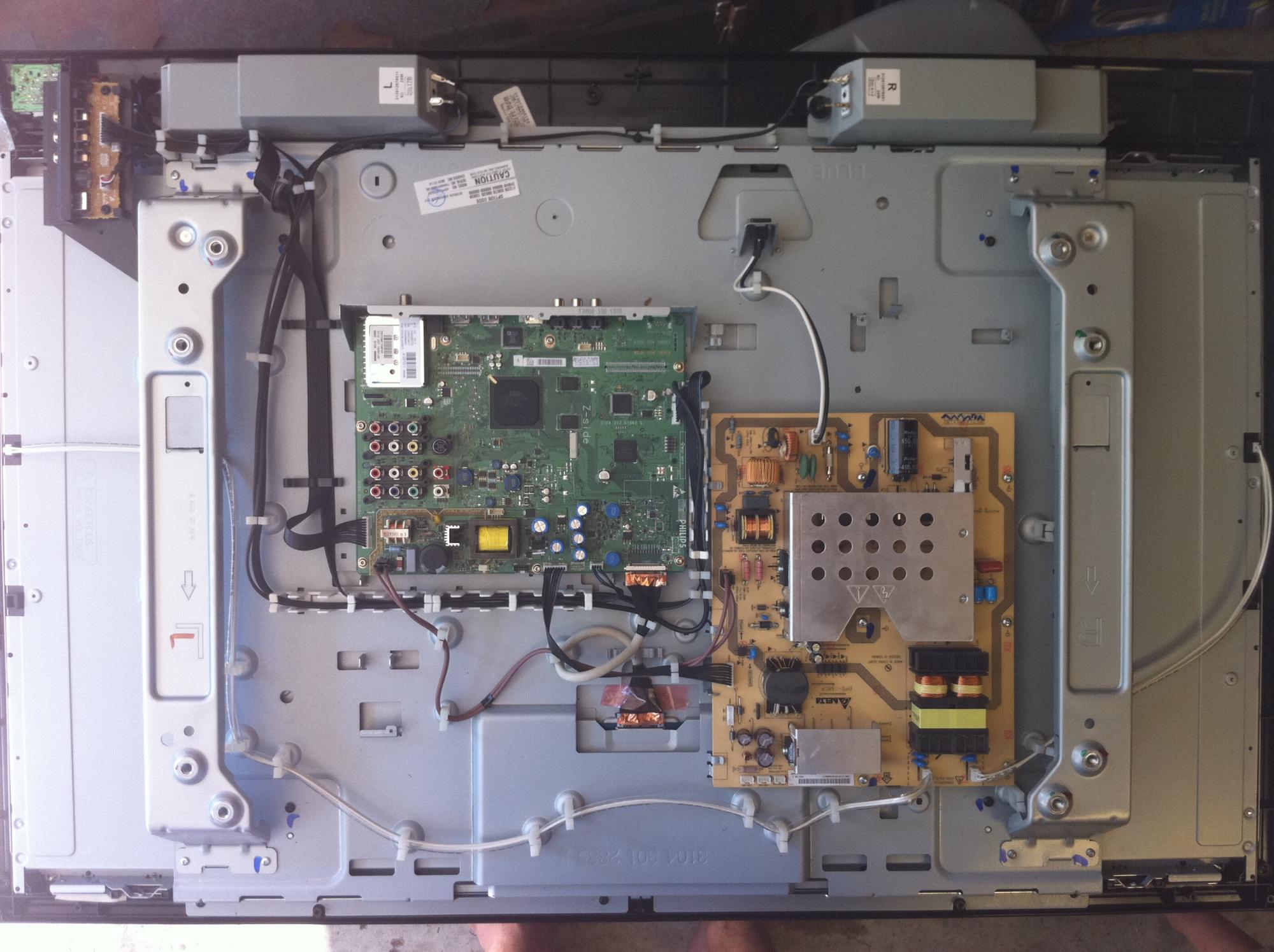

          Re: 42PFL7422D/37 Service Manual Needed
          Once you post some pics, and what chassis number you're dealing with, we'll be able to help from there.
          • Foreveraltared
            • Sep 2010
            • 12
            Sorry for the delay. We have five kids. The last two are twins and they be babies.....so life has a different pace. Hopefully someone will get this and can help a brother out. Would love to be able to get this one back and running. Here is the pic of the back open. The model number is 42pfl7422d/37
            The chasis is q523.1u. La
            Again. Thank u all

                      #30
                      Gentlemen, thank you for taking the time..
                      Here is the pic of the model info on the back. I am not sure if it is a plasma or not (sounds so uneducated, I know). On the back it says things about LCD warnings and such, but I really am unable to find the inverter boards. SO - here is the info - really looking forward to your advice. Thanks much

                        #31
                        Funny, I kept looking for inverter boards but this one does not have separate master and slave inverter boards. It is done on the power supply board. There is a fuse(pink), I think, near the 3 white connectors, near the 3 capacitors. Check this, make sure it's not blown.

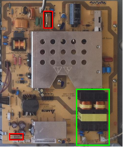

                            #33
                            I doctored up this photo to highlight the area (in red) where the two fuses are. One I am sure of but the other one, near the 3 caps, may not be a fuse. Hard to tell with the photo's limitted range. Also if you can take a picture of the backside(solder side) of that board we can look at the area I marked in green to see if the joints are ok.
                            Are there any markings on this power board (numbers etc...)?
                            What are the markings on the black and yellow transformer (highlighted in green)?
                            I will need whatever you can give me to look up some info on this TV.
                            Ok. I've given you enough homework for now.

                              #34
                              my homework assignment

                                  #36

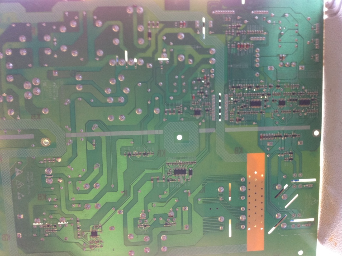

                                  This one has me a little baffled. Without the normal "master/slave" configuration, it's a little harder to localize the problem. The fact that you have sound but no picture tells me that at least most of the power supply board is OK. The glass fuse is OK. Something in the circuit of that huge black and yellow transformer is funky. It seems the output is taken right near there from those two white connectors. One going left, one going right.
                                  What is underneath these heatsinks?
                                  Are there any board model numbers? I really want to see a schematic of this board so I will need this. I think it is located in between the output transformers. I think it starts with "DP "
                                  I'd desolder these caps and check them on a capacitance meter(located in the green box of this picture).
                                  Just based on the size of that transformer, I'd reflow the solder joints on it as well.
                                    So are you saying not to waste my time replacing the fuse?
                                    I will take a pick under the heatsinks...
                                    Also I will look for a model number on the board
                                    Reflow you mean to add solder right? Dont know all the tech terms - been 15 years since Electrical Engineering has even crossed my mind...

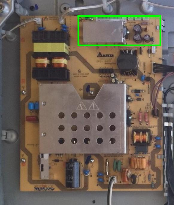

                                      #38
                                      and the board number is...
                                      DPS-168EP

                                          #40
                                          What is the part number of the chip in the green box (above pic) that is connected to the heatsink?
                                          I'm a little shocked that there is no fuse somewhere in the secondary circuit of that huge transformer.
