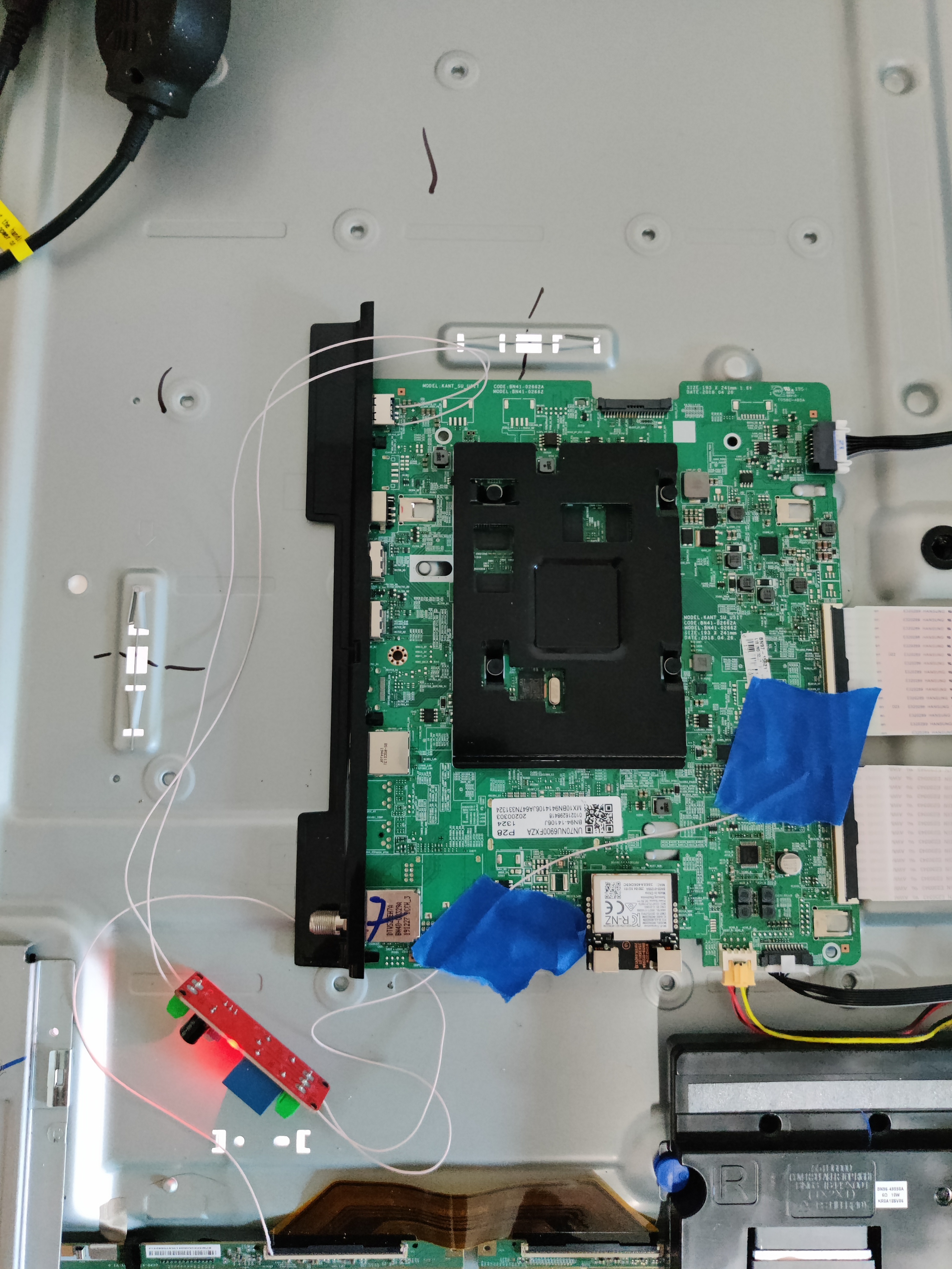

                Ok, finally got my delay switch, installed, took power 5v from USB on board, delay is set to ab 2 sec, TV is working as expected, thank you everybody for your help and ideas, maybe this one would be useful for someone else.

                  Hi xfox, glad to see you found a work a round. I too have had no luck with changing R13246 values. The only "fix" I had was to tape pins 13 to 24 on the Right (shorter) ribbon cable which results in a color fade from Left to Right on the TV screen. Could you show a picture of what is under the blue masking tape by the ribbon cable and identify what pins or points you soldered the wires from the 2 second delay circuit from the 5V power source? Did this give you a normally working TV with no color fade? Thank you.

                Very nice work, good to see this method works sometimes when the resistor change does not, glad people are finding ways to get more use from these tvs. And SHAME on samsung for these design flaws.

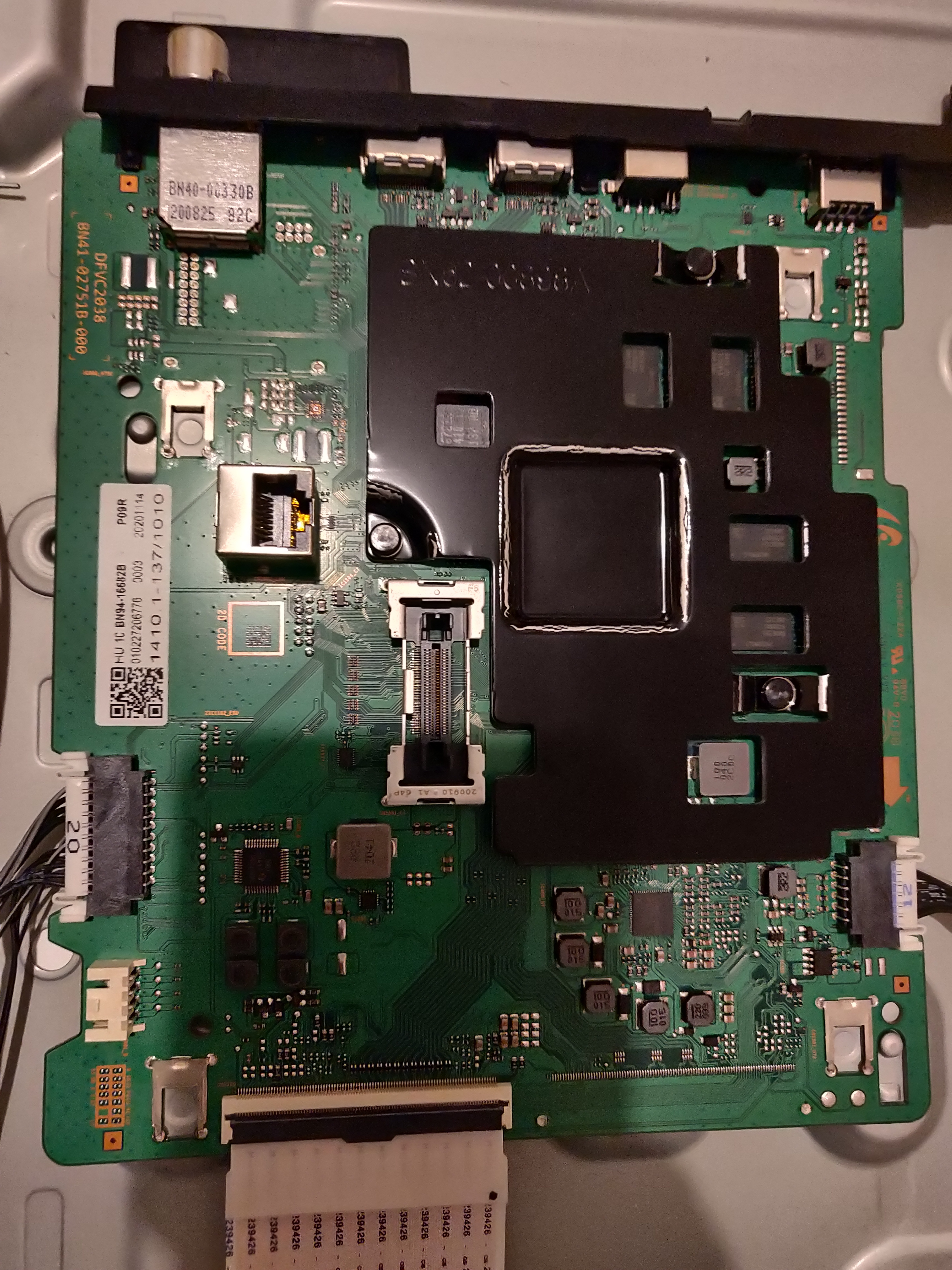

                    Hello all,
                    That's a really good thing to have found this thread.
                    I've actually the same kind of issue With my UE58TU6905 Samsung tv.
                    Before moving forward with the resistor solution proposed here that seems to solve many tv.
                    I'd like to know if it's normal situation to do not have 25v steady on the main board when ribbon cable to drivers is unconnected?
                    I think that I need to get this 25v fixed before moving forward.
                    I get this voltage on the 22pin on my connector , when ribbon cable to driver is connected and at the beginning of the looping restart only.
                    Is this something that somebody already got?
                    Here under a picture on my main board that is a bit different of the ones shown here. I was boy able to find the resistor and nothing really clearly explained on this board
                    Thanks in advance for your reply.
                    Regards
                    "EDIT":
                    Pursuing my investigation, found one this, that the VL0 line when is isolated from the ribbon cable on the left screen side my TV stopped rebooting, only isolating this line.
                    But, VGH don't show any voltage output.
                    I've taken the resistance and found only 5.2kΩ between VGH and Ground, that seems to me a bit low.​
                    Anybody has a feeling of i should do next?

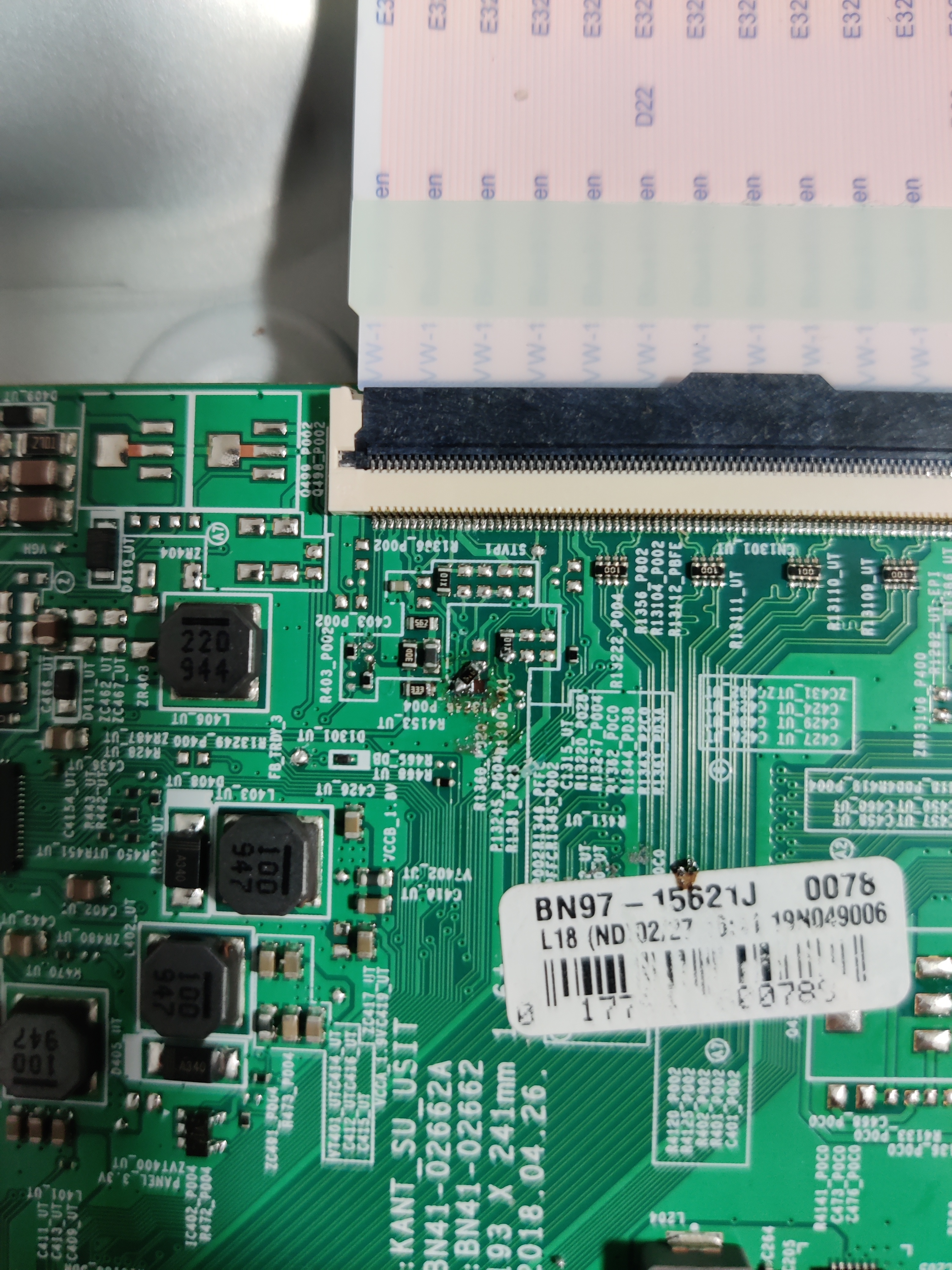

                            Today's Update, finally found a short to ground, attached to some caps just in the opposite side of the µC.
                            Some many components are in short.
                            I guess i need a new board, but don't know if the panel has an issue too

                              Can you show a picture of the shorted components.

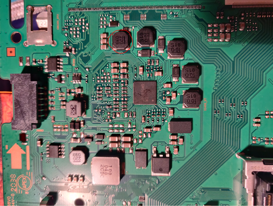

                                Don't know how to ensure panel is ok, the first steps of the issue, was a small blue line on the right side of the screen, then a complete blue line to come to this end, no picture on the screen and rebooting TV.
                                In the red circle this is the coils that present short to GND, i can find some caps just under the
                                  There is one choke and should be on the ground, since a negative voltage (-) relative to the ground is generated on this line (VOFF = VGL = VGOFF = VEEG).

                                    Ah that's a good information, i was not aware of.
                                    But as I've got some caps short-cutted I need to know which one is faulty.
                                    I'll take picture of the caps found in short, maybe the short is in the micro controller
                                    Thank you for your support

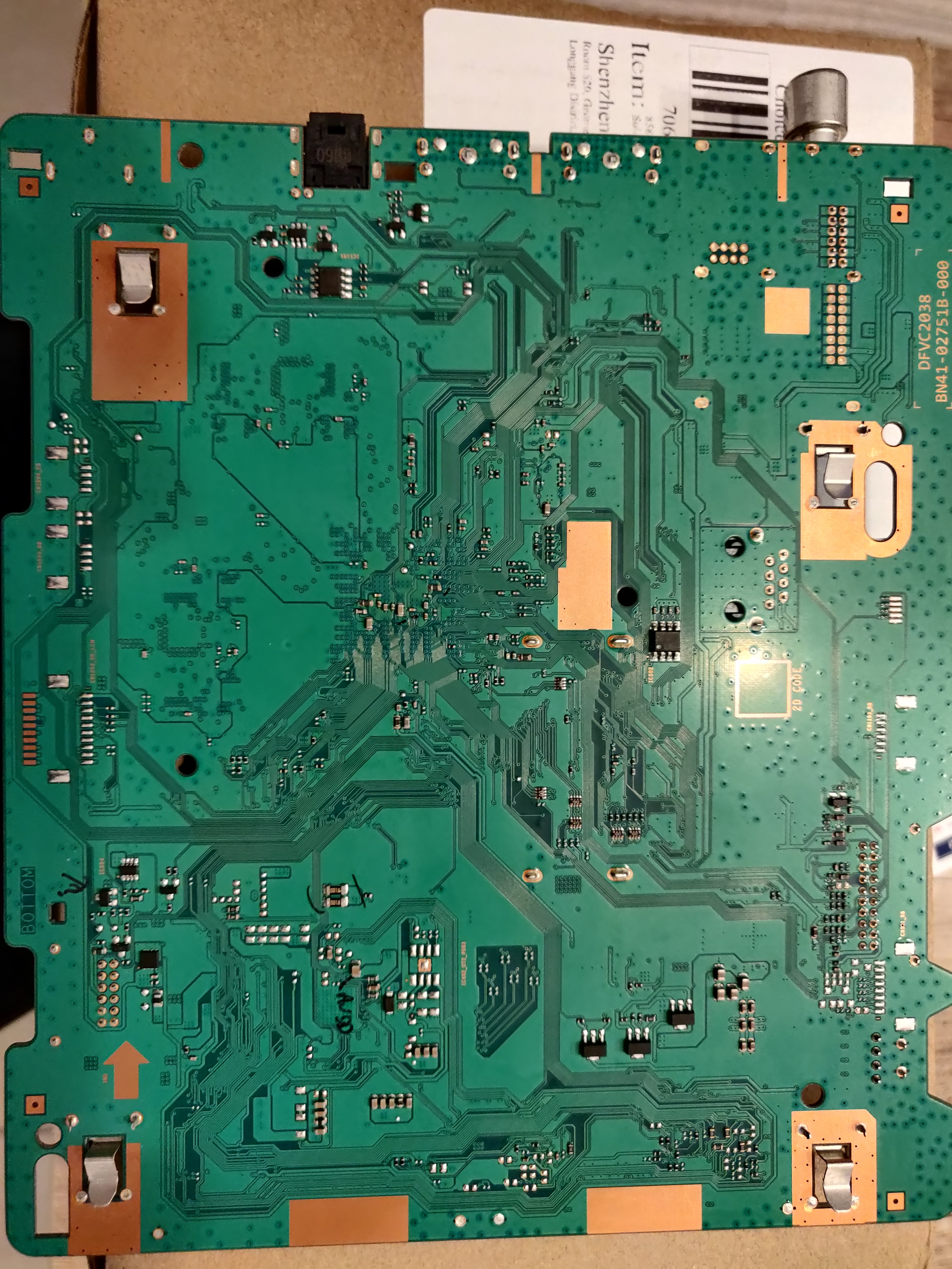

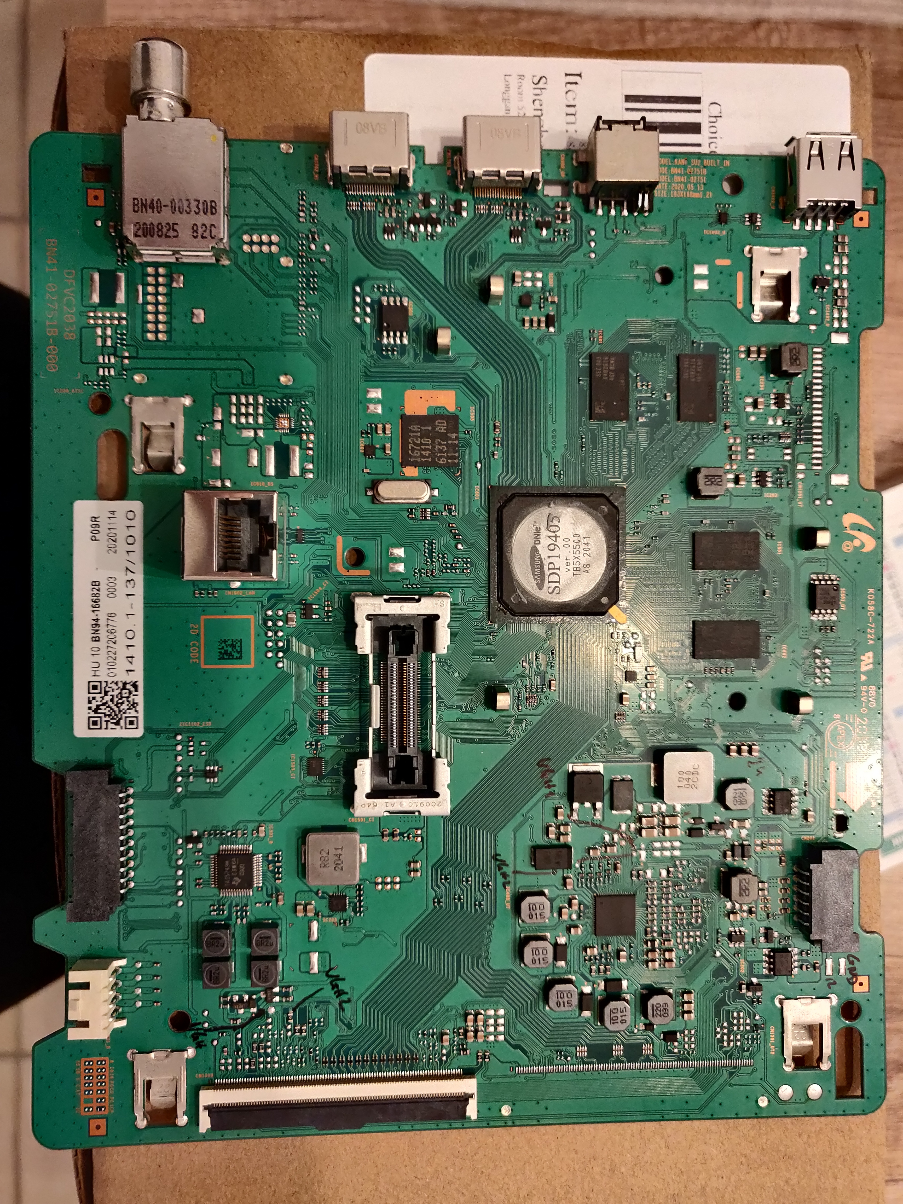

                                      There are the pictures of my motherboard.
                                      On the motherboard I've marked the short with a black pen.
                                      I've a doubt on a component that looks like a transistor but I'm not sure.
                                      I can read values between all pins. 🤔
                                      but no short as measured on caps close to 0.2ohm.
                                      Thank you in advance.
