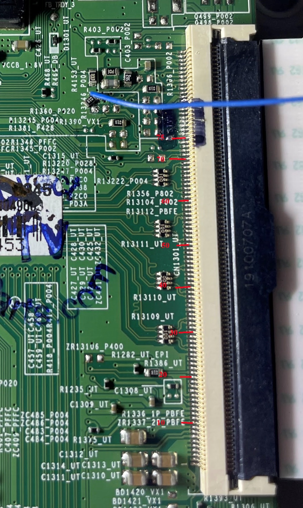

            Turns out this is a un70, not un65. Same main board, just didnt notice it until getting it back together.
            Some photos here
            https://imgur.com/a/D0jeeCT
            So this mod is
            ::Remove or adjust the R13246 resistor off the pads to break the 25/30v VGH connection to the panel.
            Solder a wire to the hot side (will read 25V when powered on) of the resistor/pads.
            Solder other end of wire to the test point marked "VGH" on the panel PCB.
            Cut wire in the middle and put a 10k+ resistor in line. (precise value is probably not needed, it was an educated guess on my part)
            Another observation, direct 0 ohm wire connection fails to start up.I snipped the blue wire and I put a 150K resistor inline, boots perfectly, image perfect. :edit: I also tested a 1K (fail) and a 12k (success)
            You will know you have this problem if you measure very low or no voltage on that R13246 resistor. When the resistor is removed you will measure 25V on the same point that was low in the prior test.
            I have no explanation for why this works, but hopefully it helps someone fix their un70nu6900f that blinks twice and power cycles forever.
            I also have a strong feeling that simply replacing R13246 with a higher value resistor in the 10K range will do effectively the same thing, but my test tv is assembled and should be going home today.

                  • Diah
                    • Feb 2013
                    • 6500
                    Re: samsung un65nu6900f common problem, digging deeper
                    did you check the temperature of added R 10k+??
                    • nomoresonys
                      • Jan 2013
                      • 12312
                      • U.S.
                      as long as this is safe, it looks like a good solution to the problem?
                      • itelite
                        • Aug 2016
                        • 124
                        Yes, no different than room temp. Practically no current going through this.

                          • itelite
                            • Aug 2016
                            • 124
                            so does anyone know what is broken that this solution is fixing? meaning what would be the "official" factory fix?
                            This is venturing heavily into pure speculation, but there could be some kind of a signal timing aspect to this.
                            For instance, if solder my direct wire with no added resistance, the tv will not boot. it will do the 2 blink power cycle.
                            If i take the same wire, turn on the tv, count arbitrarily to 3, then press the wire on the test point it will boot with a perfect image. Removing the wire will degrade have the image as expected. Pressing it back on the test point will restore the image.
                            As mentioned if i put any resistance into the soldered wire 10K or above (up to tested 150K) it boots and works perfectly as though it never had an issue.
                            My wild speculation is that maybe the added resistance is delaying the signal enough on the initial boot to allow normal function? It would be an incredibly small delay, certainly not my arbitrary count to 3, but there will be a delay.
                            Ive fixed a lot of things over my life, this one stands out as very difficult to explain.
                            Been running tv without issue for around 6 hours now.

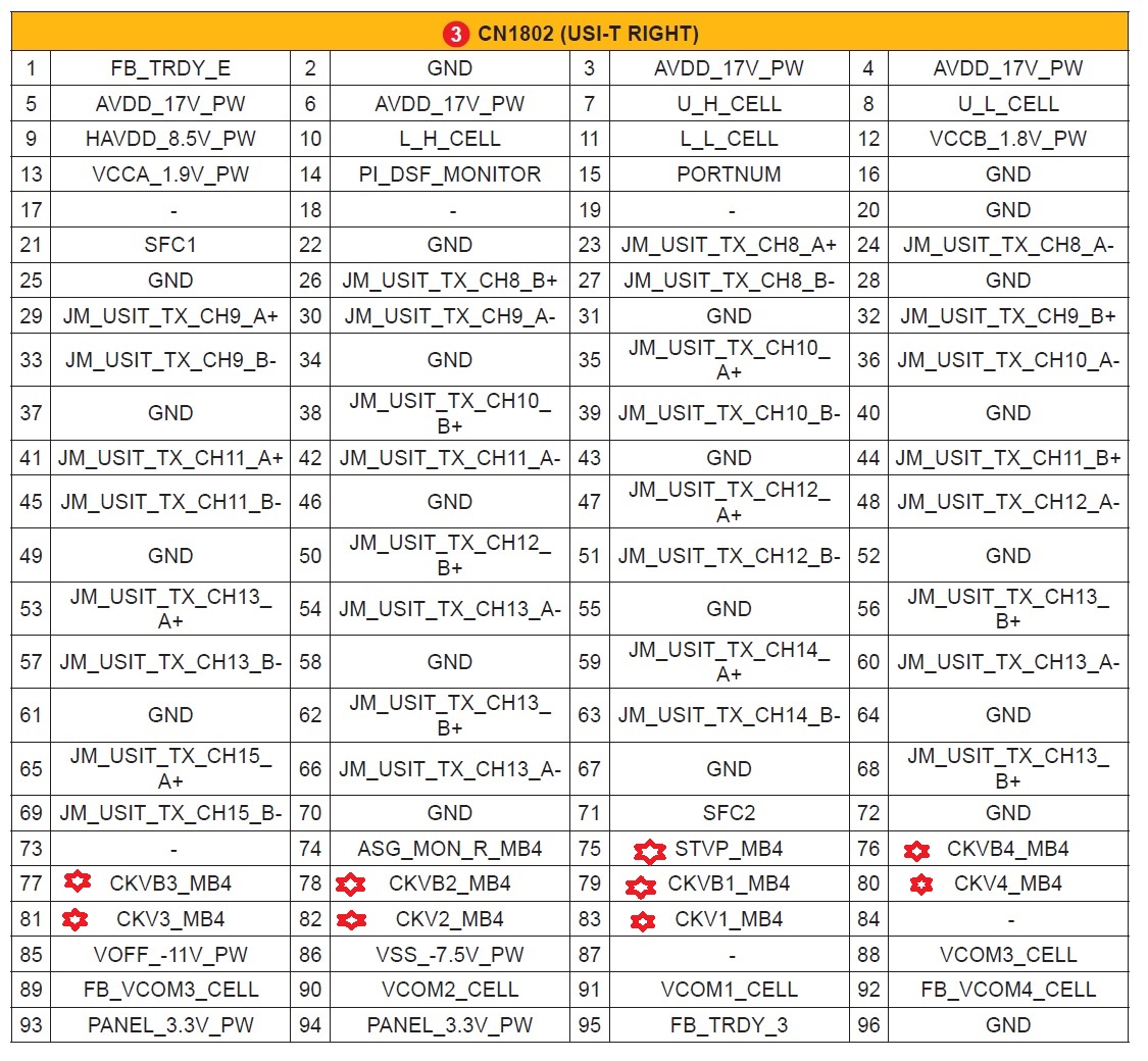

                            • Diah
                              • Feb 2013
                              • 6500
                              so this line No.75 STVP_MB4 ???
                              • itelite
                                • Aug 2016
                                • 124
                                I believe it is listed as VGH30V or something similar (pin 84). It is actually listed as a NC in the 65" service manual. I do not have the manual for the 70.
                                It appears to be another version of pin 11 on the other LVDS connector. I would imagine that would be another place to look if this location in the circuit measures correctly.
                                • Diah
                                  • Feb 2013
                                  • 6500
                                  its as i mensioned before Pin 75 STVP_MB4
                                  all TU /NU/MU size share same sockets design & MB

                                      • itelite
                                        • Aug 2016
                                        • 124
                                        Just to clear this up, it is in fact pin 84. It is hard to tell from my photo because of my black marker, but that trace does wrap around and go up to the resistor.
                                        The pin name should be VGHD_30V_PW, but is shown as a NC in the manual. I can confirm that on both the old board and the new board a 10ohm resistor is present in the R13246 position.
