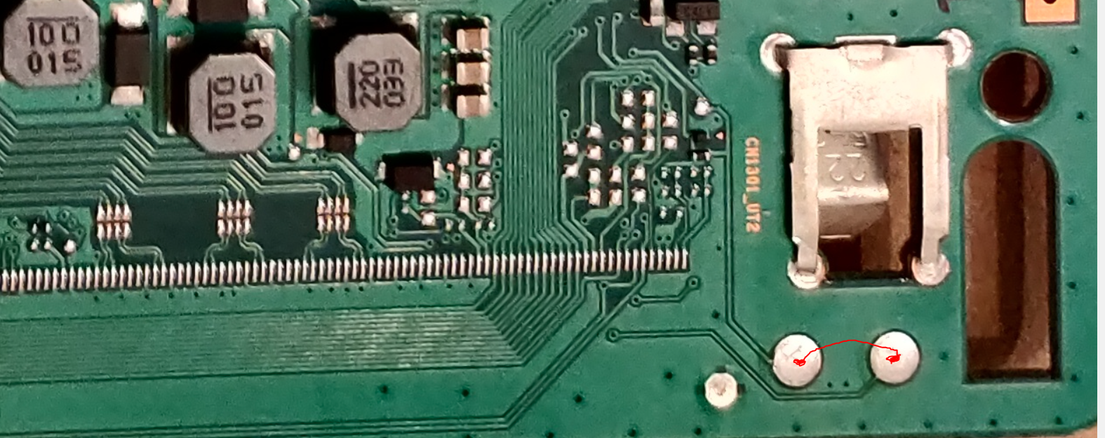

    Place a jumper between these points, disconnect the LVDS cable and check again that the voltage appears on VGH.

              @Iotas thank you, i works, i've soldered the jumper between these two points and my 25V is back and stable.
              Could you explain me why, I need to understand
              Do I need to connect LVDS cable now to see what is the behavior or do I need to perform other tests?

                This says that you do not have a working panel, try masking (CKV...) on the non-working half, reduce the VGH power...

                    #89
                    The jumper (FB_TRDY_1, FB_TRDY_3) simulates - as if we have a panel connected. When the LVDS cables are disconnected, the motherboard does not see the panel and blocks the supply voltage to the panel.

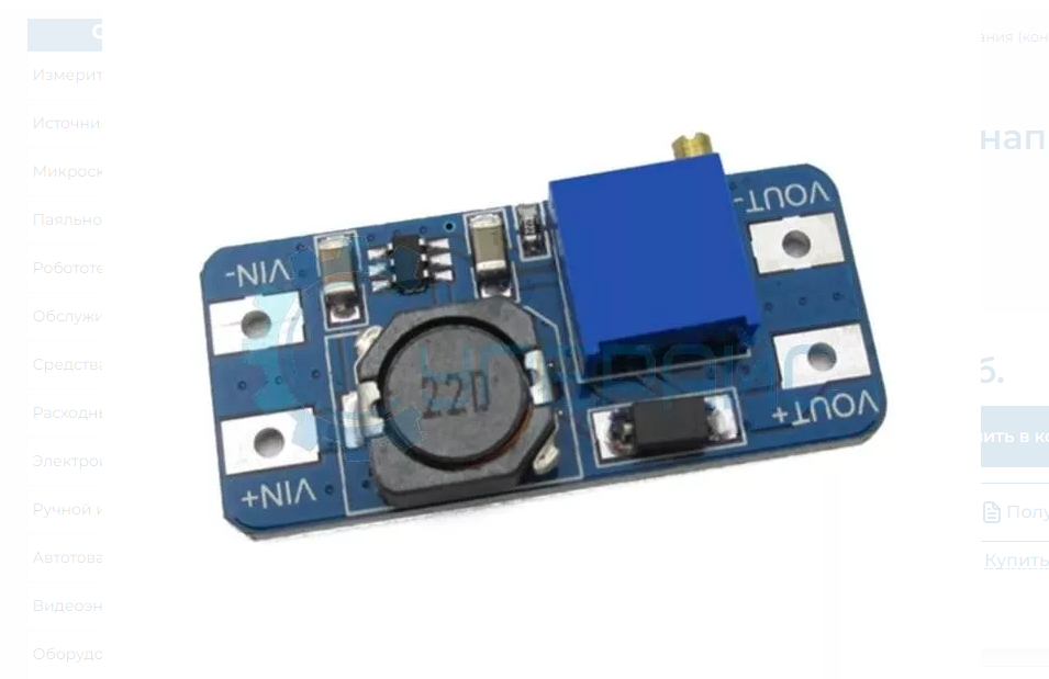

                          Job is done, found a way a save it.
                          I'll add a step up DC dc to reduce VGH from 25 to 19v on whole panel.
                          Defective side has been reduced at 14v
                          Cuted ckv and grounded

                            Everything is done correctly and the TV works.
                            Have you used this one?
                            Model: MT3608
                            Input voltage: 2 - 24 V
                            Output voltage: 5 - 28 V
                            Output current: 0 - 2 A​

                                Hello Iotas, nope I used nothing.
                                I've cutted the VGH line on the defective driver panel side and took the 14v from the caps just near and make the connection.
                                I've bought a DC to DC but the wrong one, step down don't work for me 'cause I guess the current consumption switch the main board DC dc into safe mode.
                                I'll buy a step up DC dc to take the incoming 12v and convert to 19V to preserve the panel.
