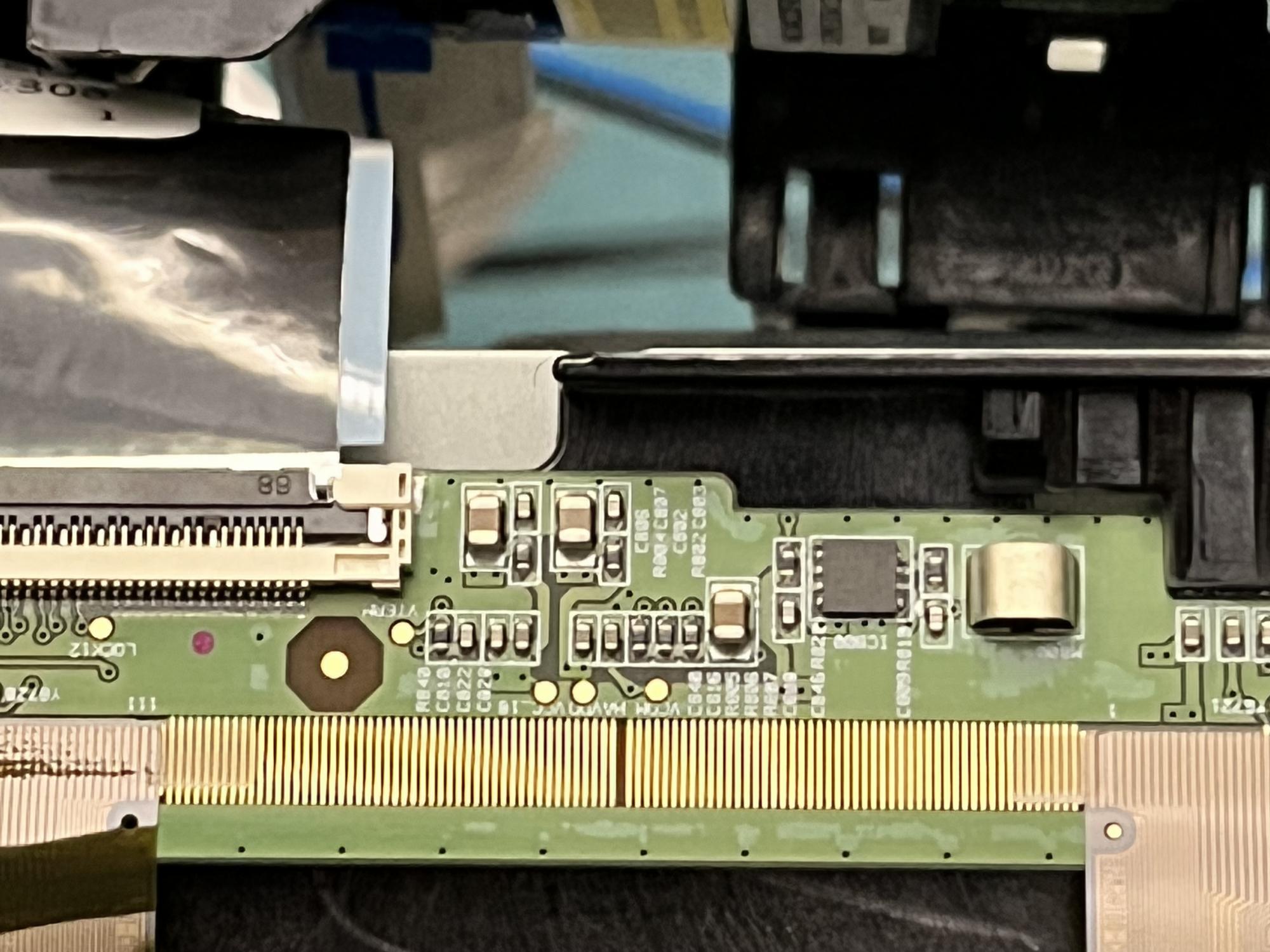

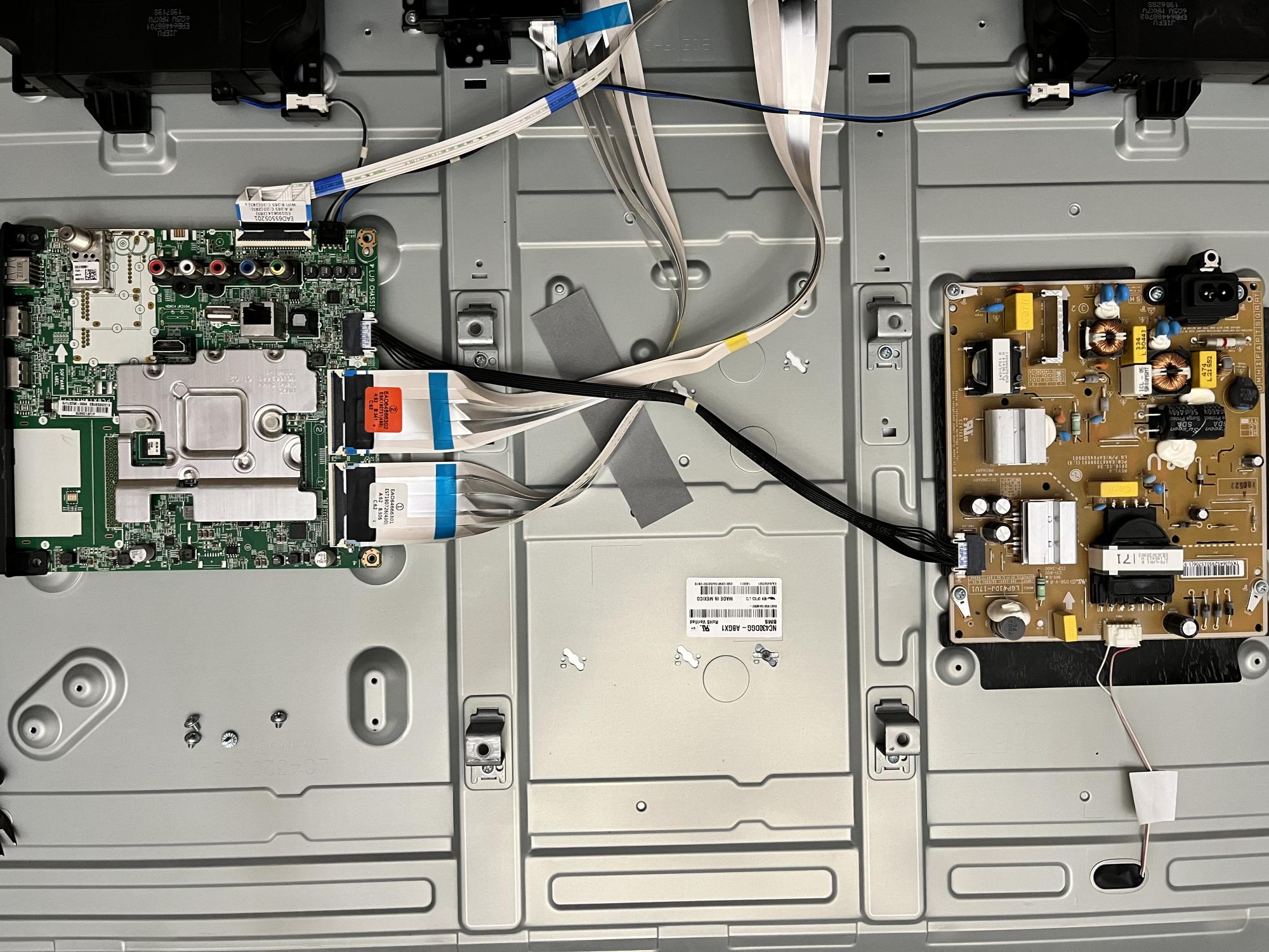

    An LG 43UM6910PUA was donated to me. The backlights turn on and the voltages on the power supply are good. The mainboard appears to leave standby but the LCD stays off.
    Disconnecting the right-side LVDS ribbon cable turns one half of the LCD black. Now if I measure voltage at the AVDD test pad on the connected left driver board, I get 17V.
    If I re-connect the right LVDS cable, then the AVDD test pad on both of the driver boards goes to 0V. If I only connect the right-side LVDS cable, then the right driver board's AVDD test pad is still 0V.
    With my + probe on the LOCK test pad (the only pad above the LVDS connector in the blurry pic [sorry]) on the faulty right-side driver board, I can see the voltage jump to ~3V and then AVDD goes to 0V. The ~3V is only an estimation since my multimeter isn't fast enough to measure it.
    I tried taping off the CLK pins, they're the left-most 4 pins on the LVDS connector (again in the blurry pic [sorry]) but no difference.
    Would appreciate any further guidance to dig deeper in this.

    Re: LG 43UM6910PUA backlight on, but no picture
    Check caps on right side for shorts.

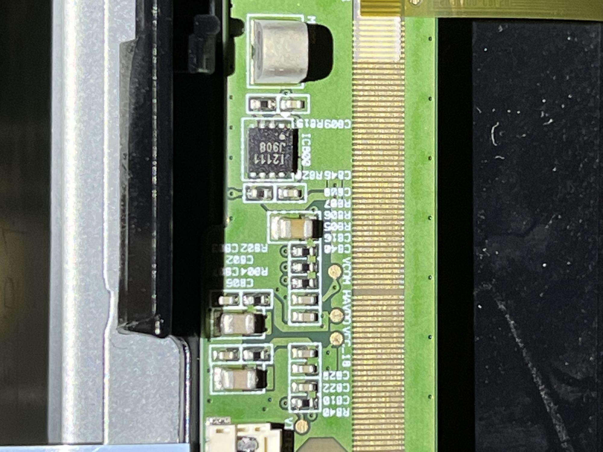

                    One IC produces most of these voltages. Have to think one of the outputs is being loaded down. VBH, VGL, AVDD, HAVDD could have a short.
                    Would need better pictures to find test points.

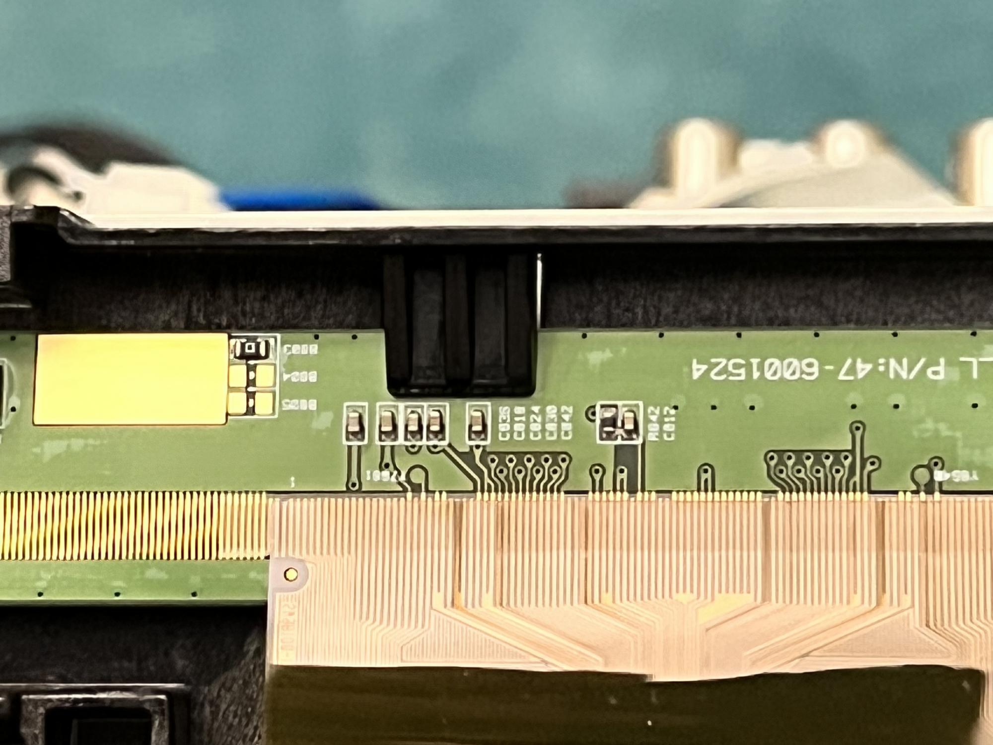

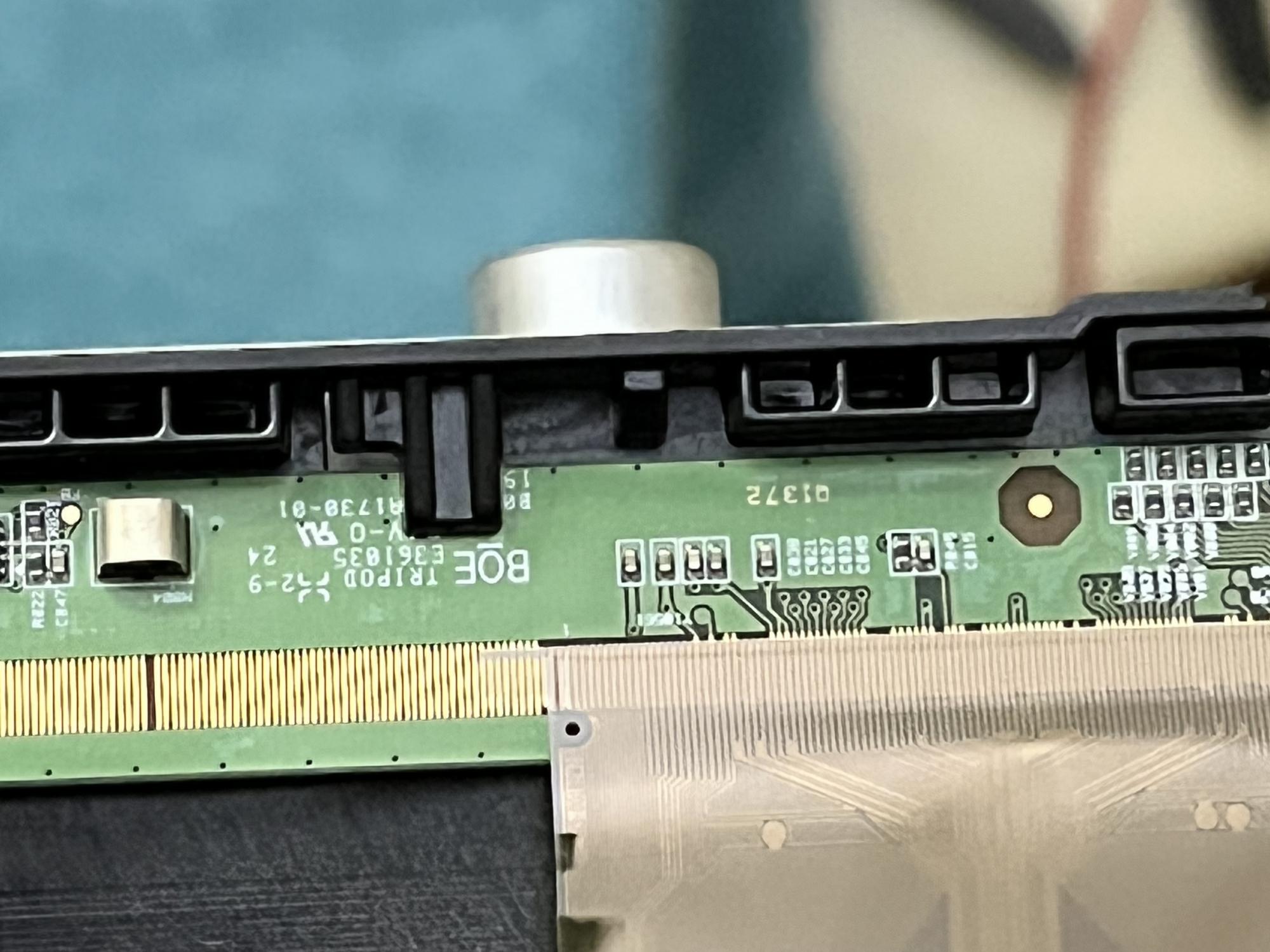

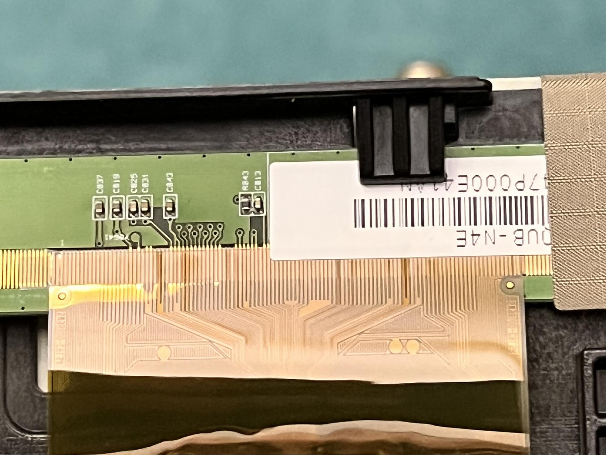

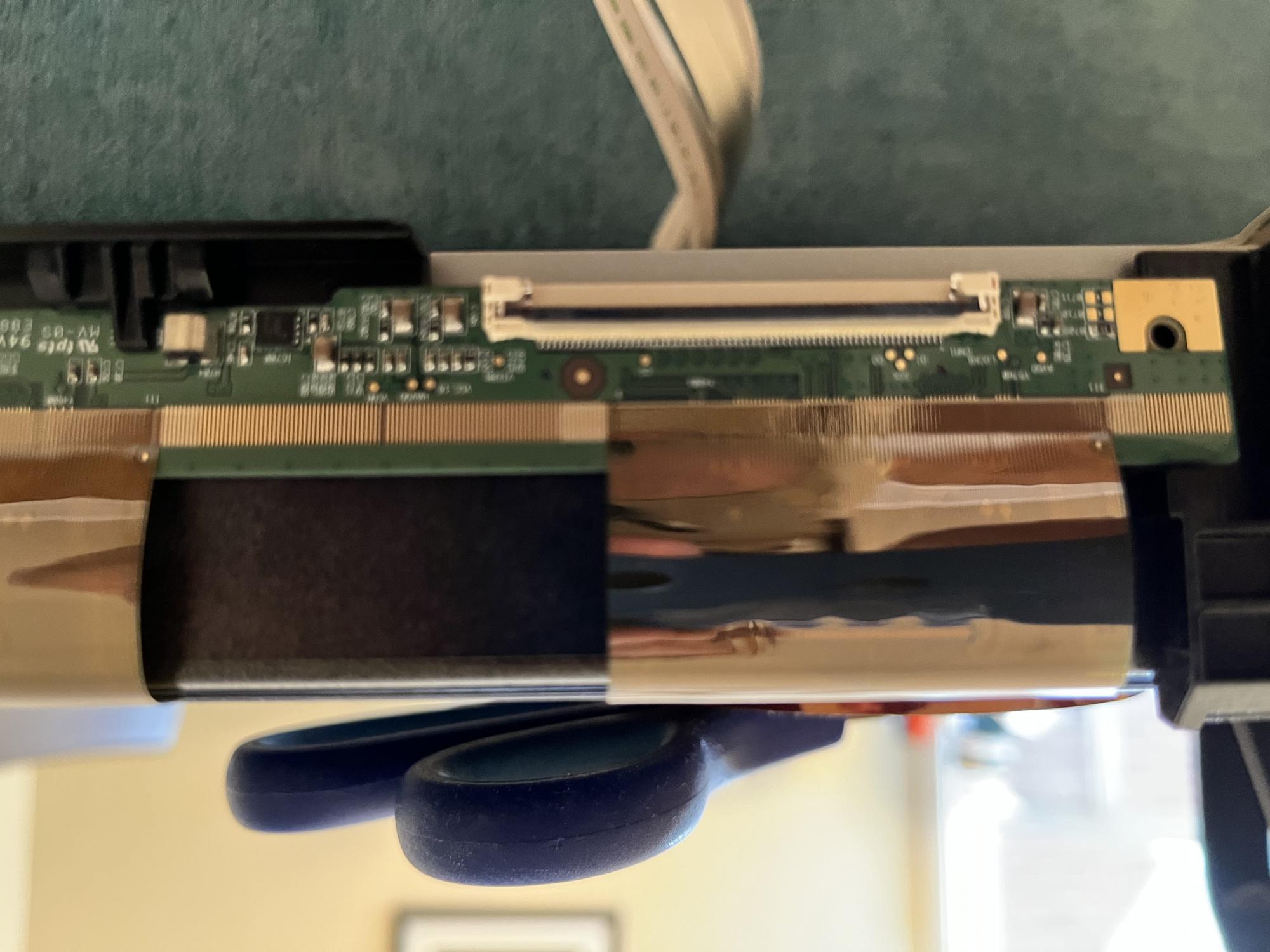

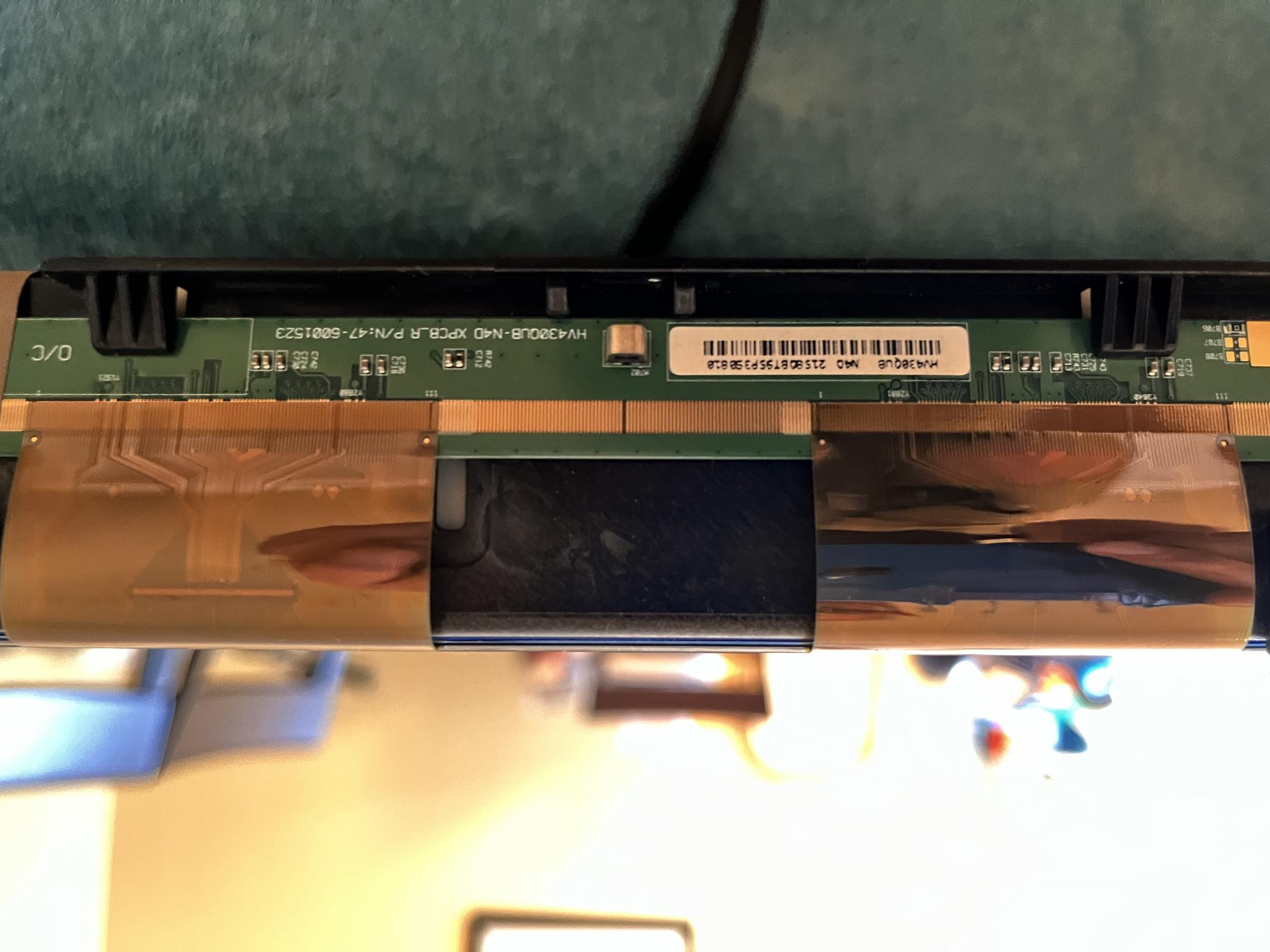

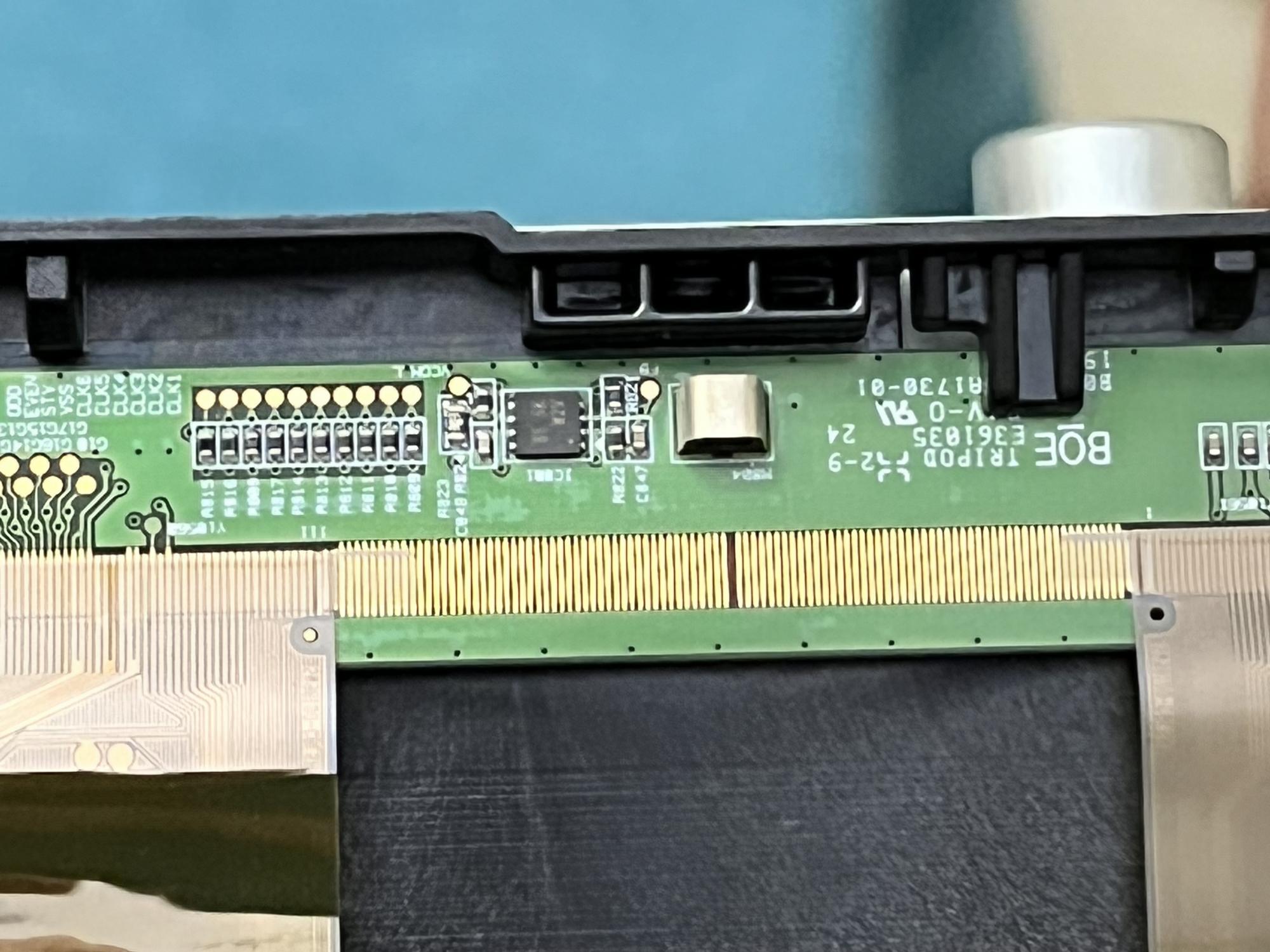

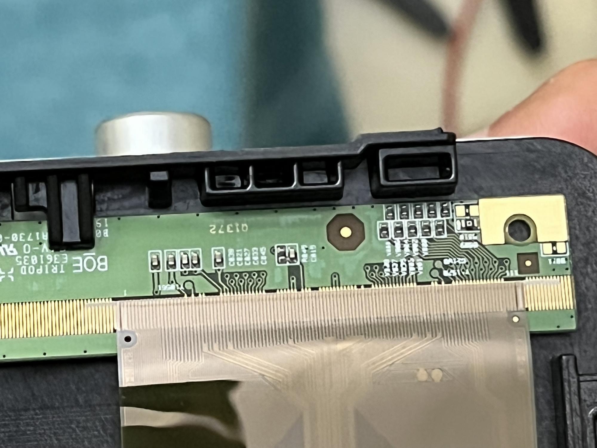

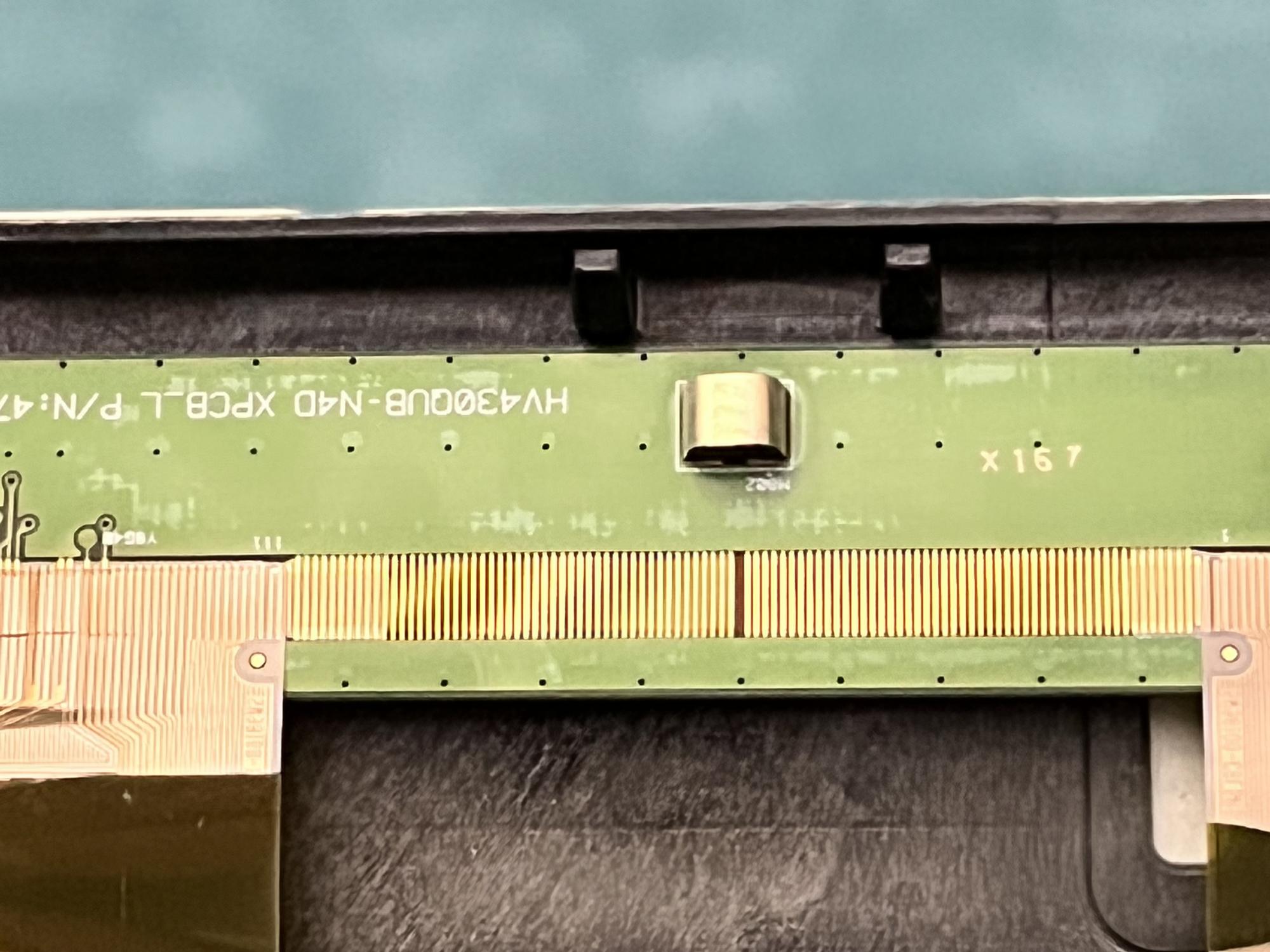

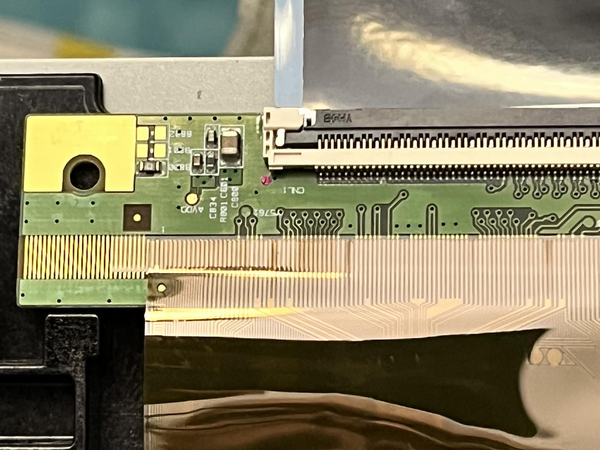

                      Here are some closer shots of the driver board.

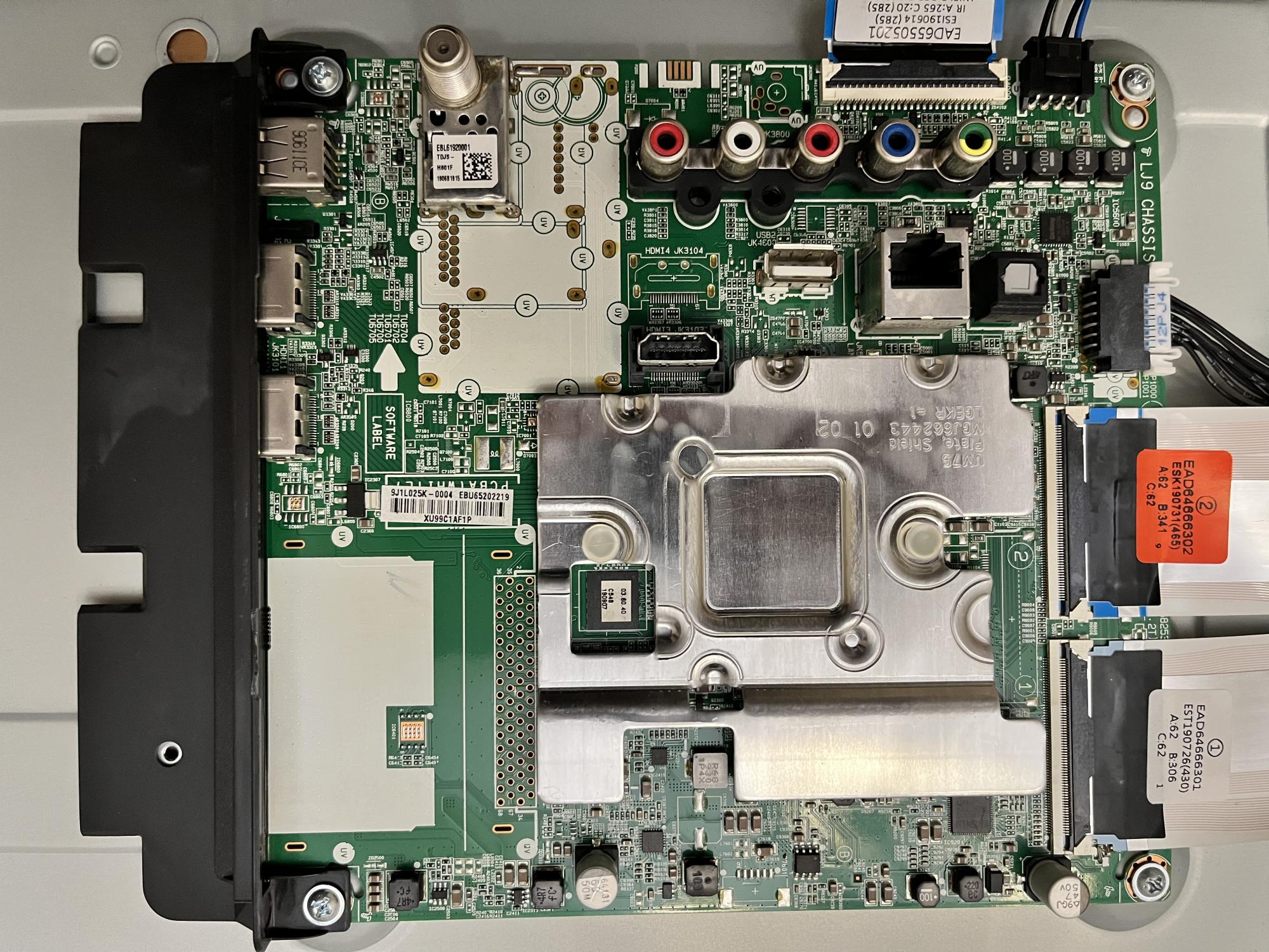

                      The LVDS cables are coming from the main board as opposed to a separate TCON board -- there's a photo of that set up in my first post.
                      Thanks everyone for the help so far!
                        I don't see the area on your blurred picture on bottom set of pictures.
                        • lapse
                          • Jun 2022
                          • 21
                          Hmmm. Which blurred area you referring to?
                          The pictures are of the driver board PCB so it's narrow -- anything blurred is in the background. The blue/cyan is just a towel on my table.
                          Apologies if I misunderstood!

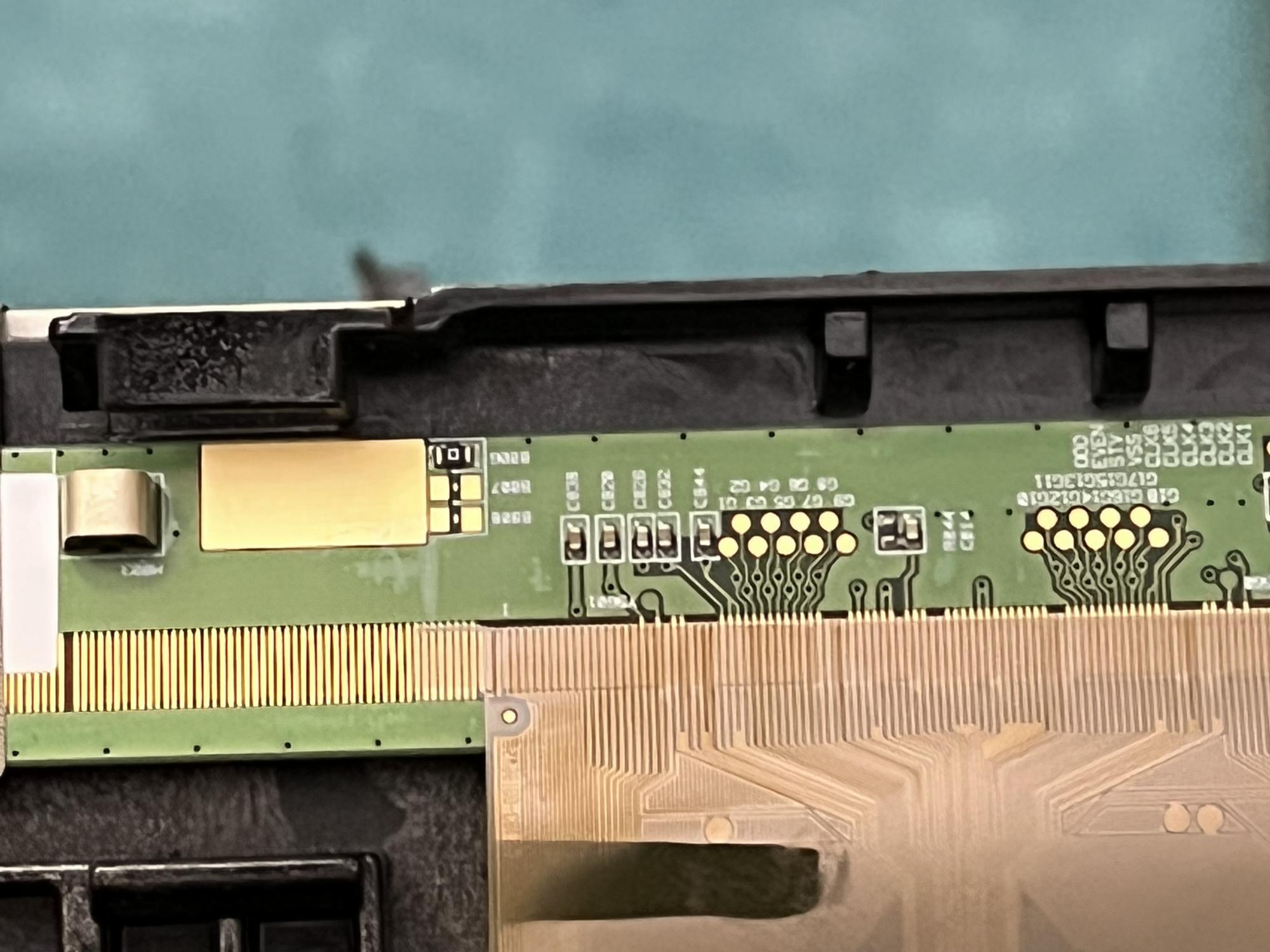

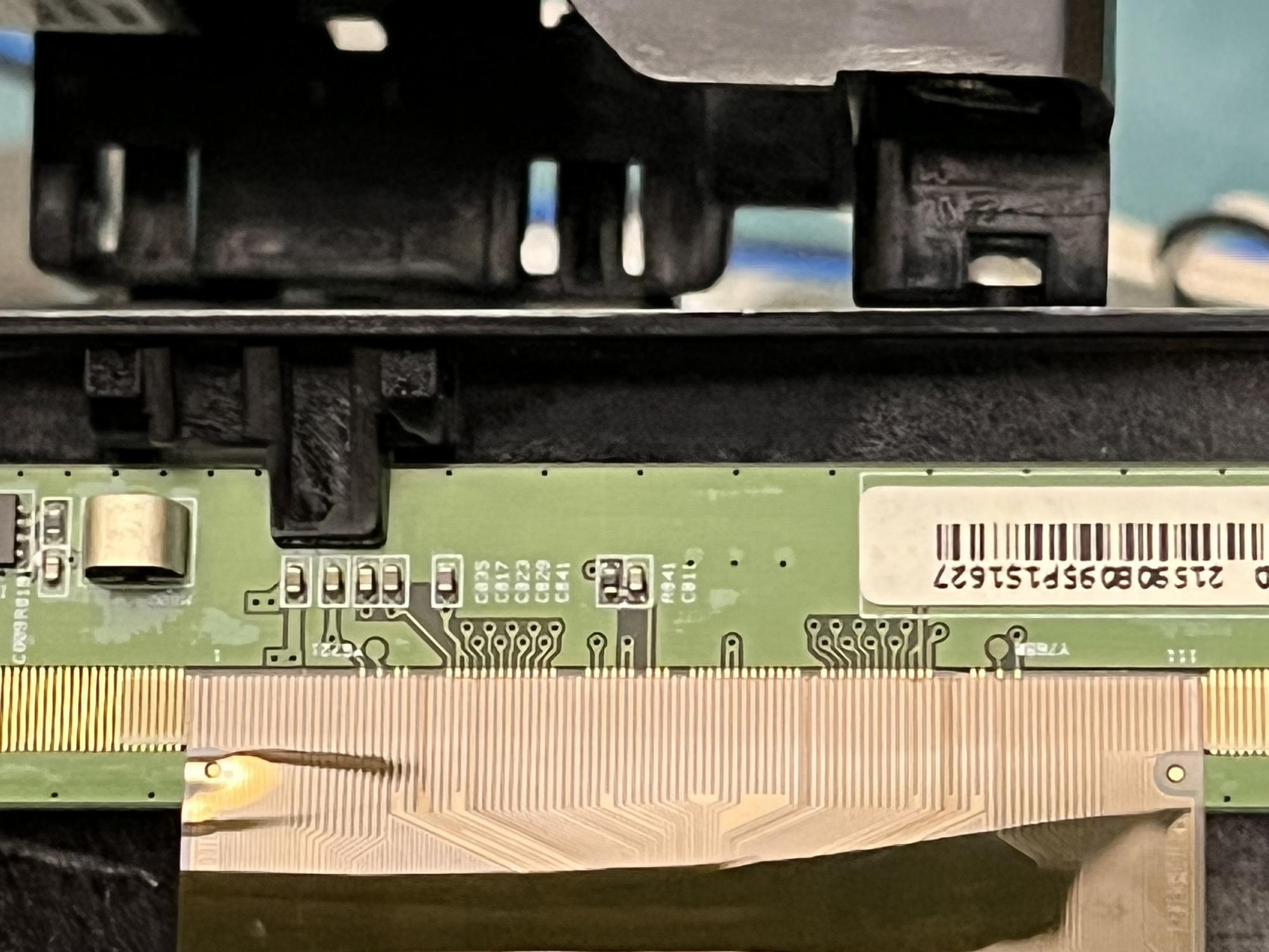

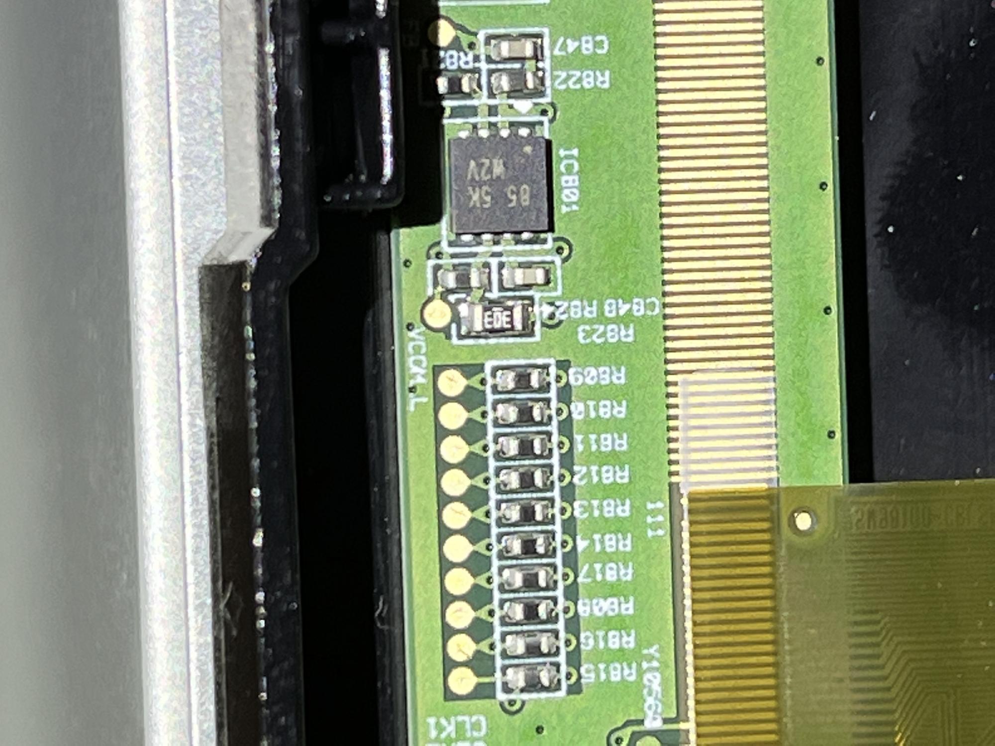

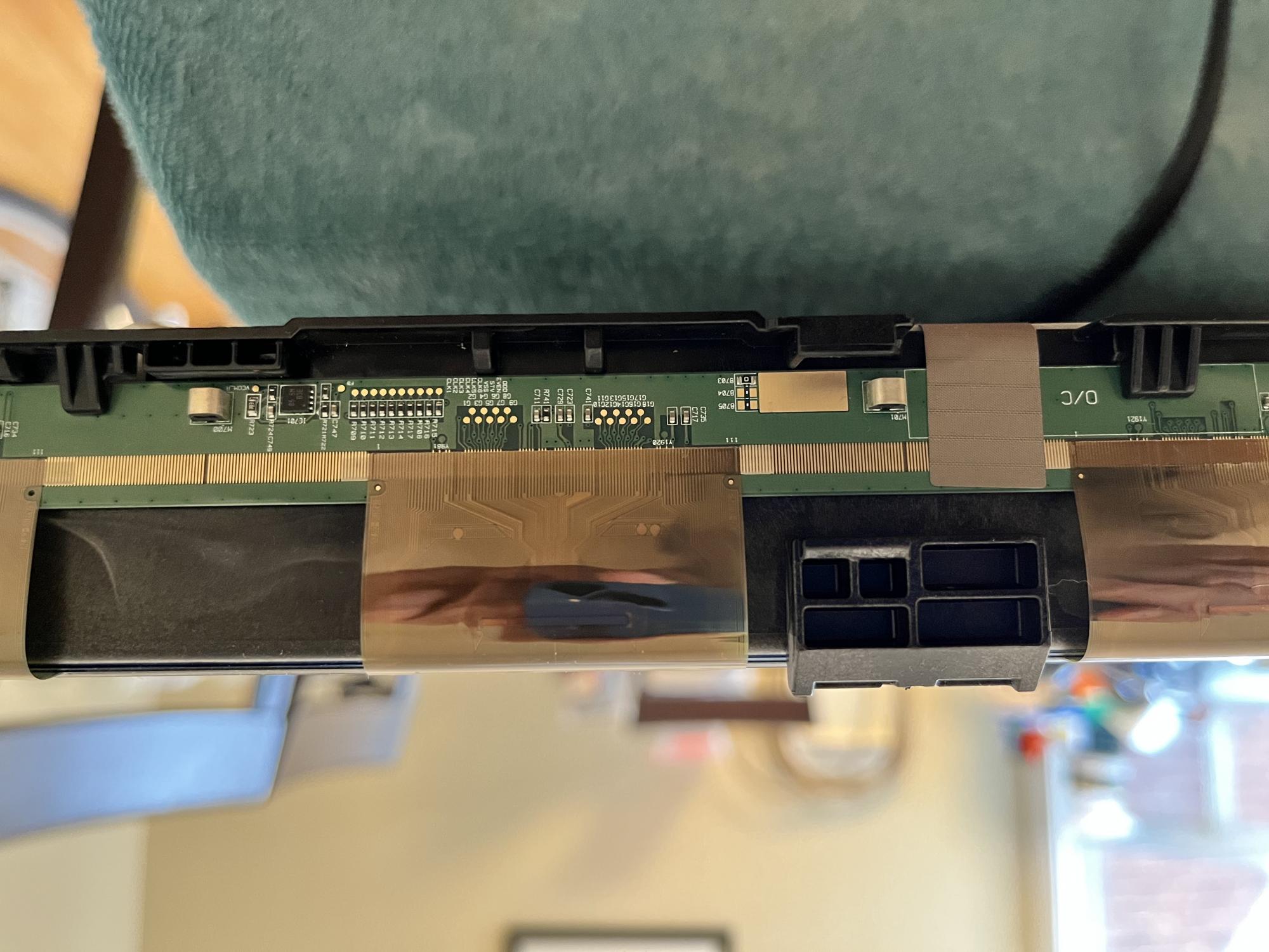

                            Here are two more pictures with the ICs on the LCD PCBs. Please let me know if you need more!

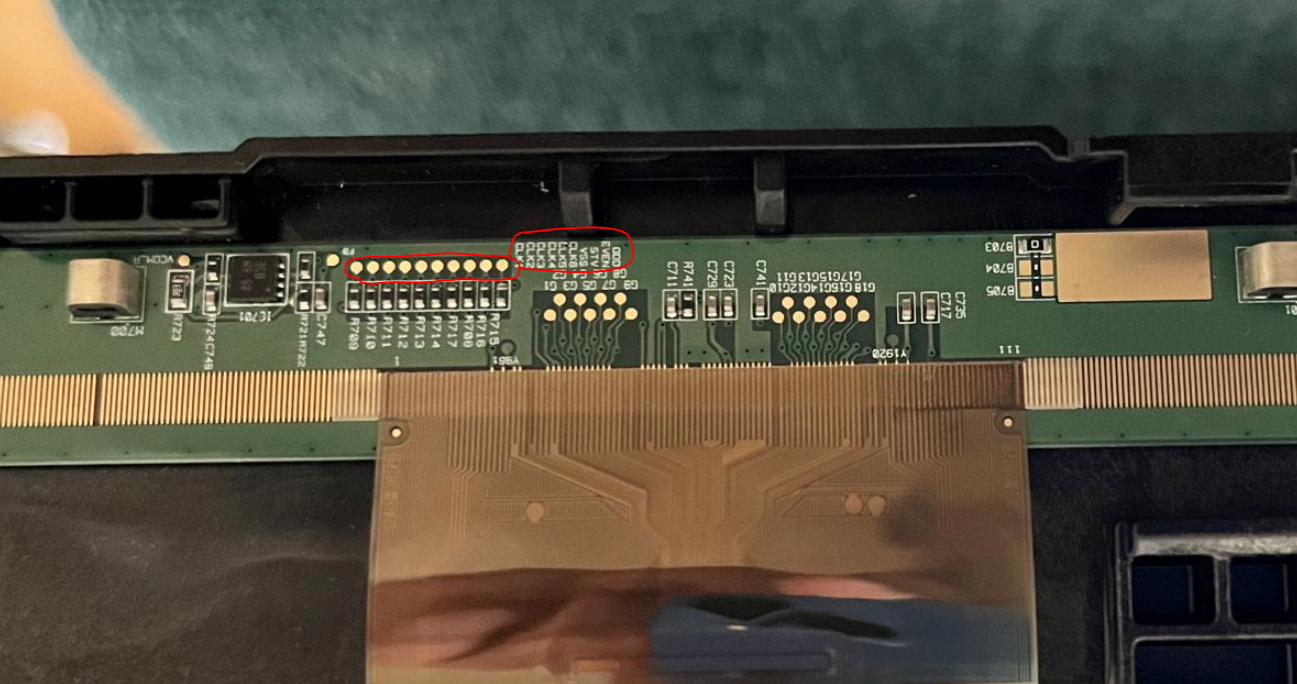

                              Third picture at top. What picture would that be on bottom pictures?
                              • lapse
                                • Jun 2022
                                • 21
                                Ahhh, I see -- the third picture in the top is actually a picture of the GOOD driver board. The good board and suspect board are mirror images of each other.
                                  FYI I taped up about 15 pins and got a semi-stable picture. I reduced the number of taped pins by 1 repeatedly until I got a picture that looked good to me. At the end of the procedure, I had stopped at about 11 pins.
                                  Not quite the fix that I was hoping for, but spending hours beeping out caps and resistors, and measuring resistance, and then comparing to the other driver board led to my wits end when everything matched up.
                                  Good enough for a garage TV!
