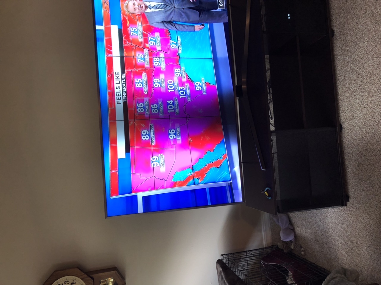

    Samsung UN65KU7000
    Vertical line in screen that comes and goes right now. Is it worth tearing into or does it look like a tab problem? Thanks
  • dskall
    • Oct 2016
    • 2905
    • usa
    Re: Samsung UN65KU7000
    Not a tab problem. At least from that picture.
    • Hornnumb2
      • Feb 2011
      • 210
      samsung un65KU7700
      Does anybody know if its edge lite, could it be some leds going out?
        Shopjimmy shows 2 led edge lit bars for this model, they also show 7032 individual led's for replacement but are out of stock
        From shopjimmy's site:
        Forward Current (IF ):180mA
        Pulse Forward Curren t1 (IFp):mA
        Reverse Current (IR):uA
        Reverse Voltage (VR):0.7-1.2V (5mA)
        Power Dissipation (PD): W
        Operating Temperature (Topr): -40 +85C°
        Storage Temperature (Tstg): -40 - +100 C°
        Soldering Temperature (Tsld): Reflow Soldering:260 C° for 10secs
        Hand Soldering:350C° for 3secs
        Junction Temperature (Tj ): C°
        Forward Voltage (VF): 5.9-6.5V(120mA)
        Luminous Flux (MCD): 19470-27330MCD(120mA)
        Wavelength (nm) : 443-451nm (120mA)
        Emissions-farbe Color of Emission :
        Color Correlated Temperature (CCT): K
        CRI : 80°
        Viewing angle : 120°
        LED size about: 7mm x 3.27mm x 1.3
          Yeah this pic shows it better, looks like a few on bottom out.

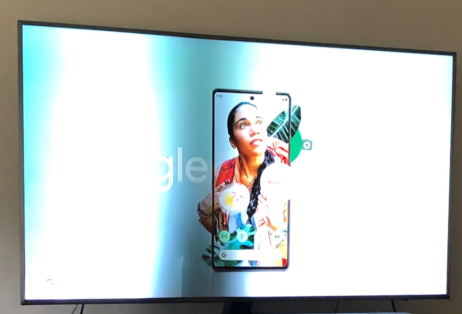

            Samsung UN50TU8000FXZC shows thin horizontal green line when warm
            by cubytus
            Hi to all,
            I was given this TV, an entry-level 4K 50" set. Some have criticized its lack of contrast and relatively poor colour rendering, but for my needs, it's very decent.
            I reset everything to factory settings, but this line keeps on fading in and out when watching a streaming channel from the Tizen firmware. Interestingly, it only happens when TV is warm, after about 1h45 of it being turned on.
            Watching a movie from an external source doesn't trigger the line as easily (needs 2 hours), and from a normal viewing distance, is hardly noticeable. It...
