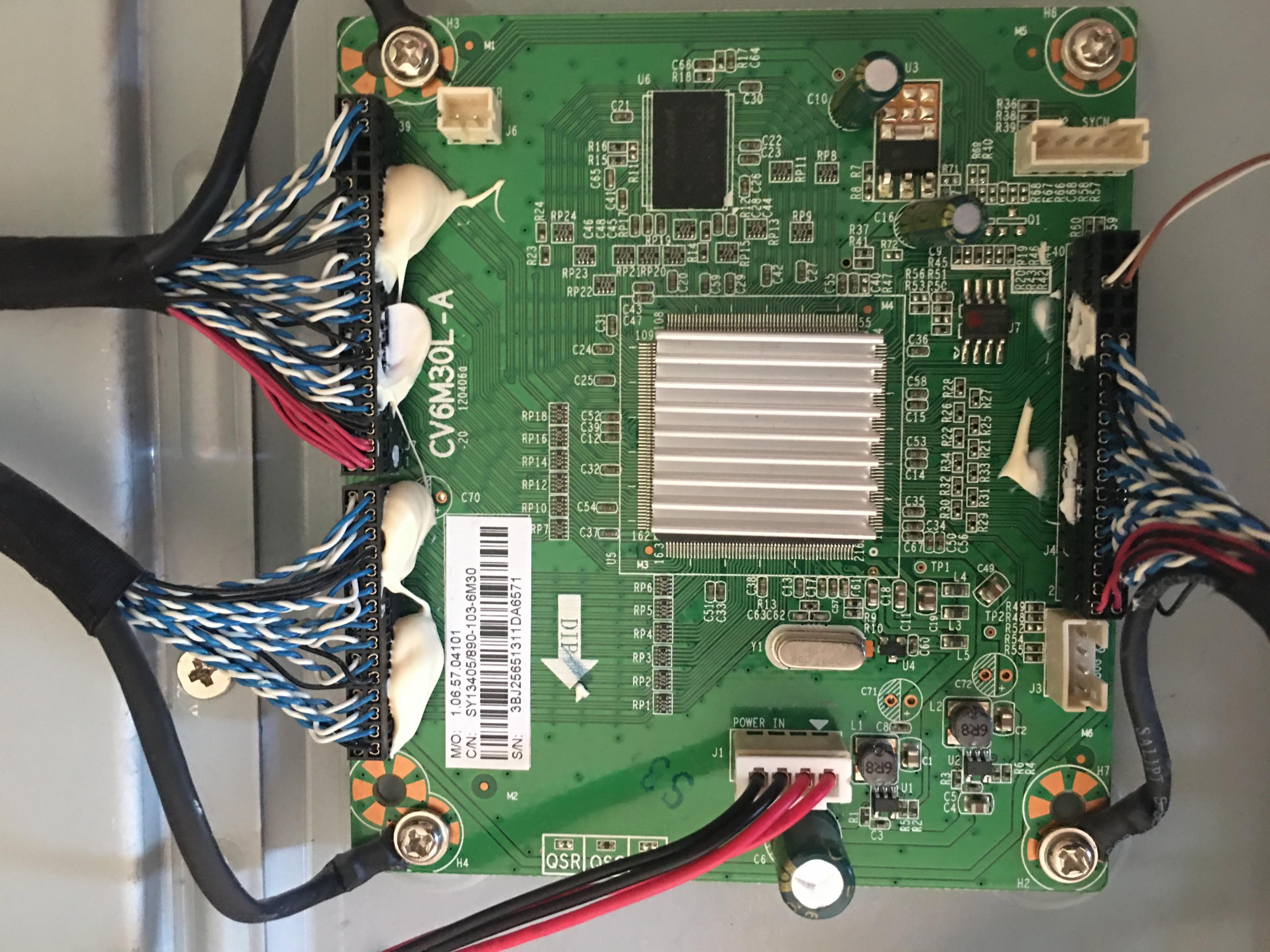

    Re: Sharp LC-60LE452U Working (Not)!
    Show the photo FRC board
    • Lupin3
      • Jan 2022
      • 29
      Here's the shot...

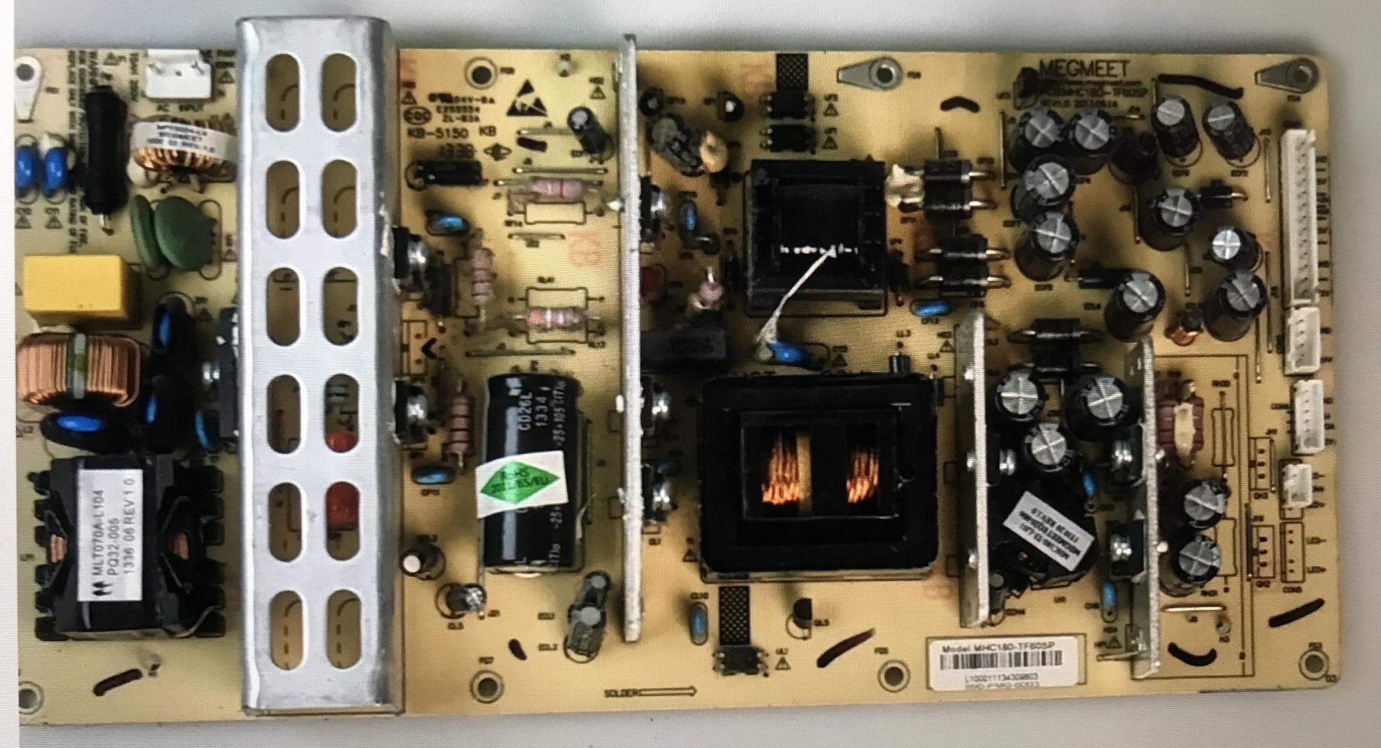

            … Show a photo of the power supply

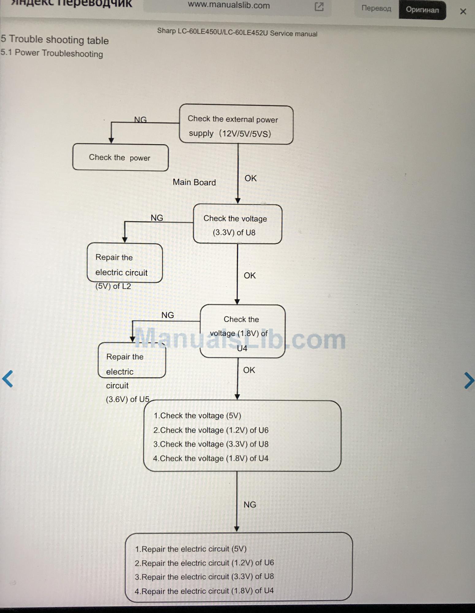

              Where would I find the "U8, U4, U5, U6"? Power Board?
              • kasfamily
                • Aug 2014
                • 774
                • Russia
                Main board

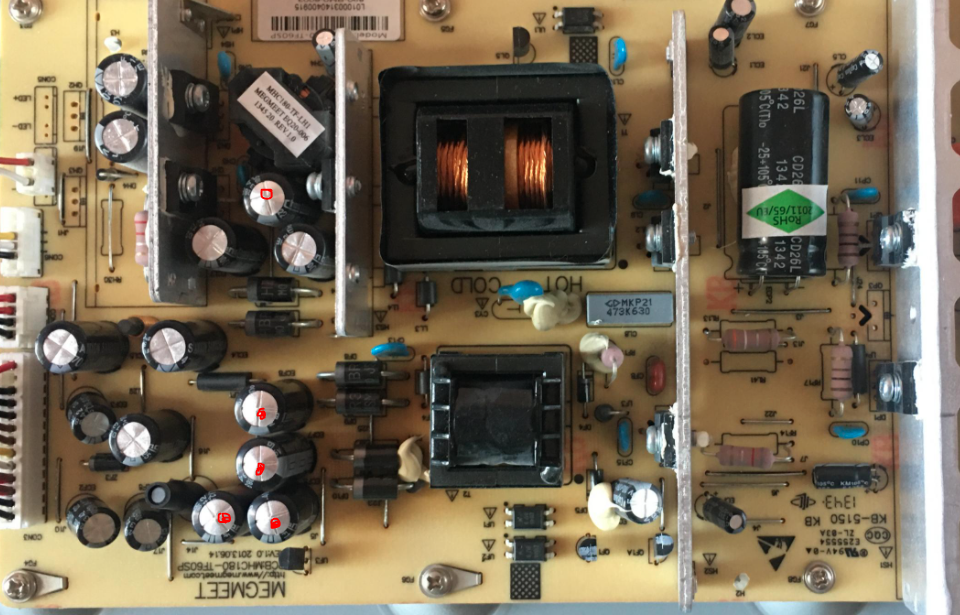

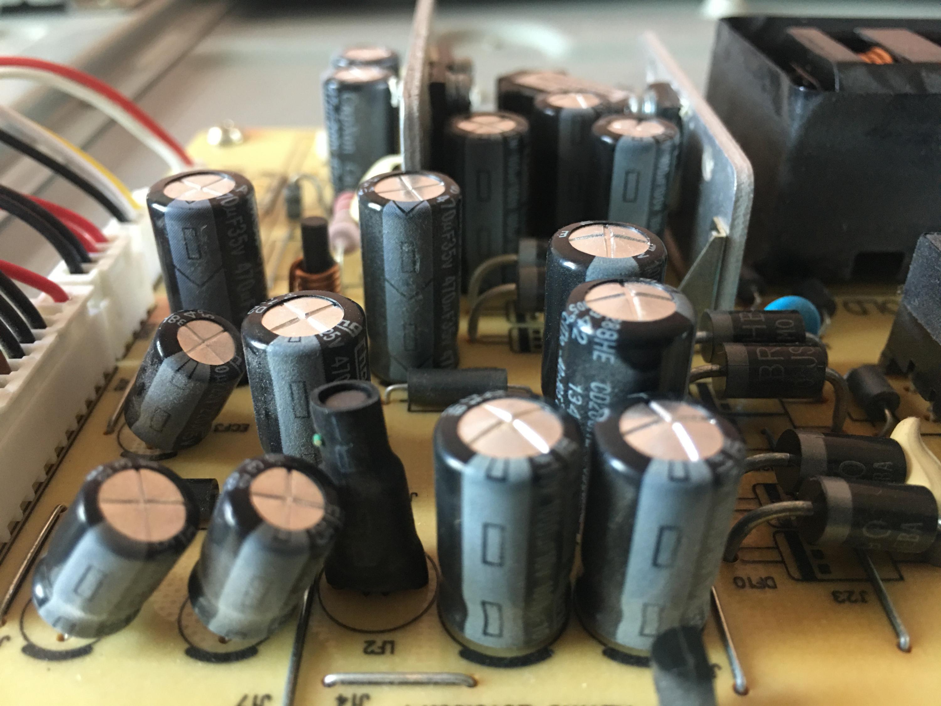

                            Will do the hair dryer trick...here's what my Board looks like.

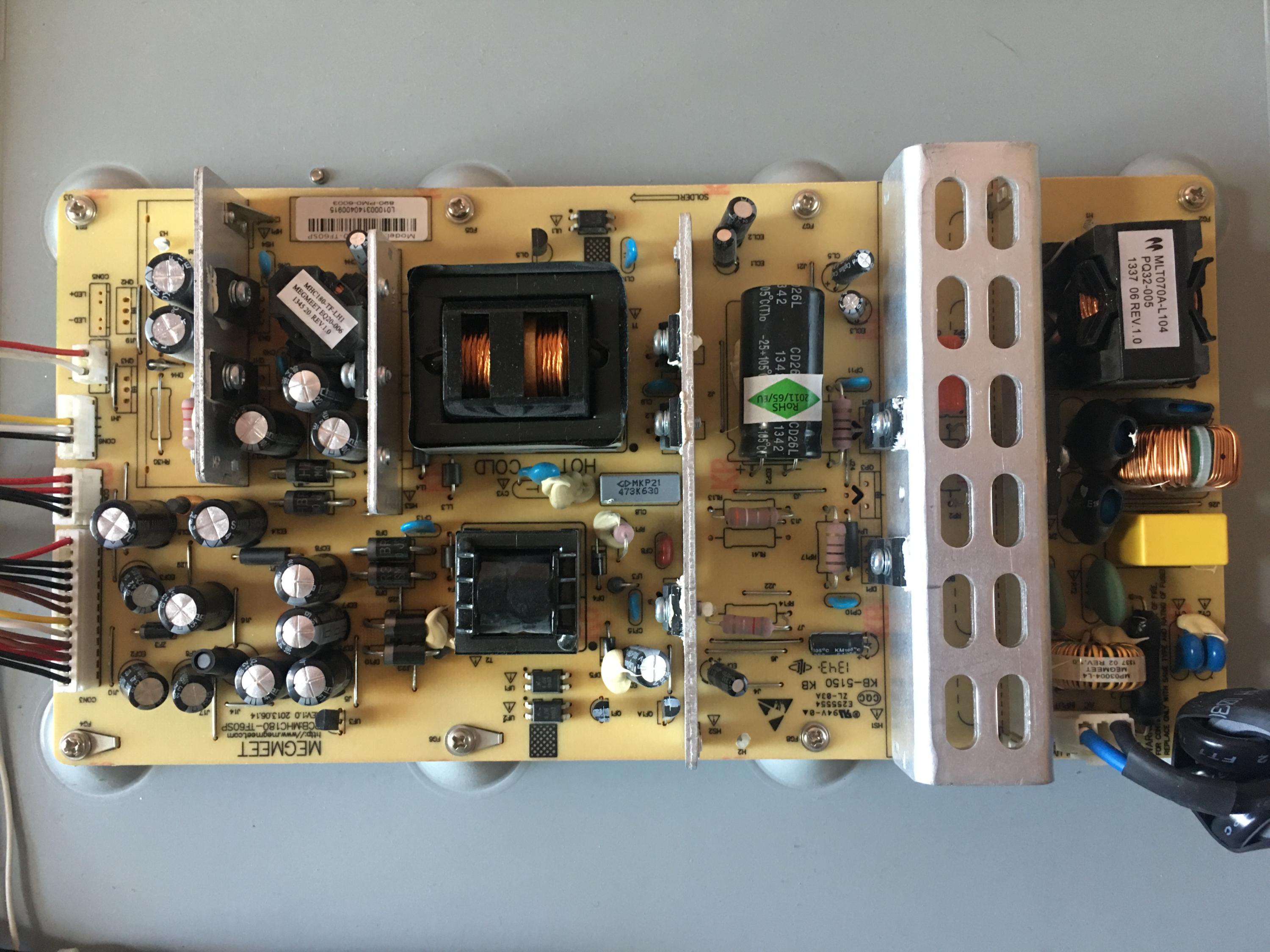

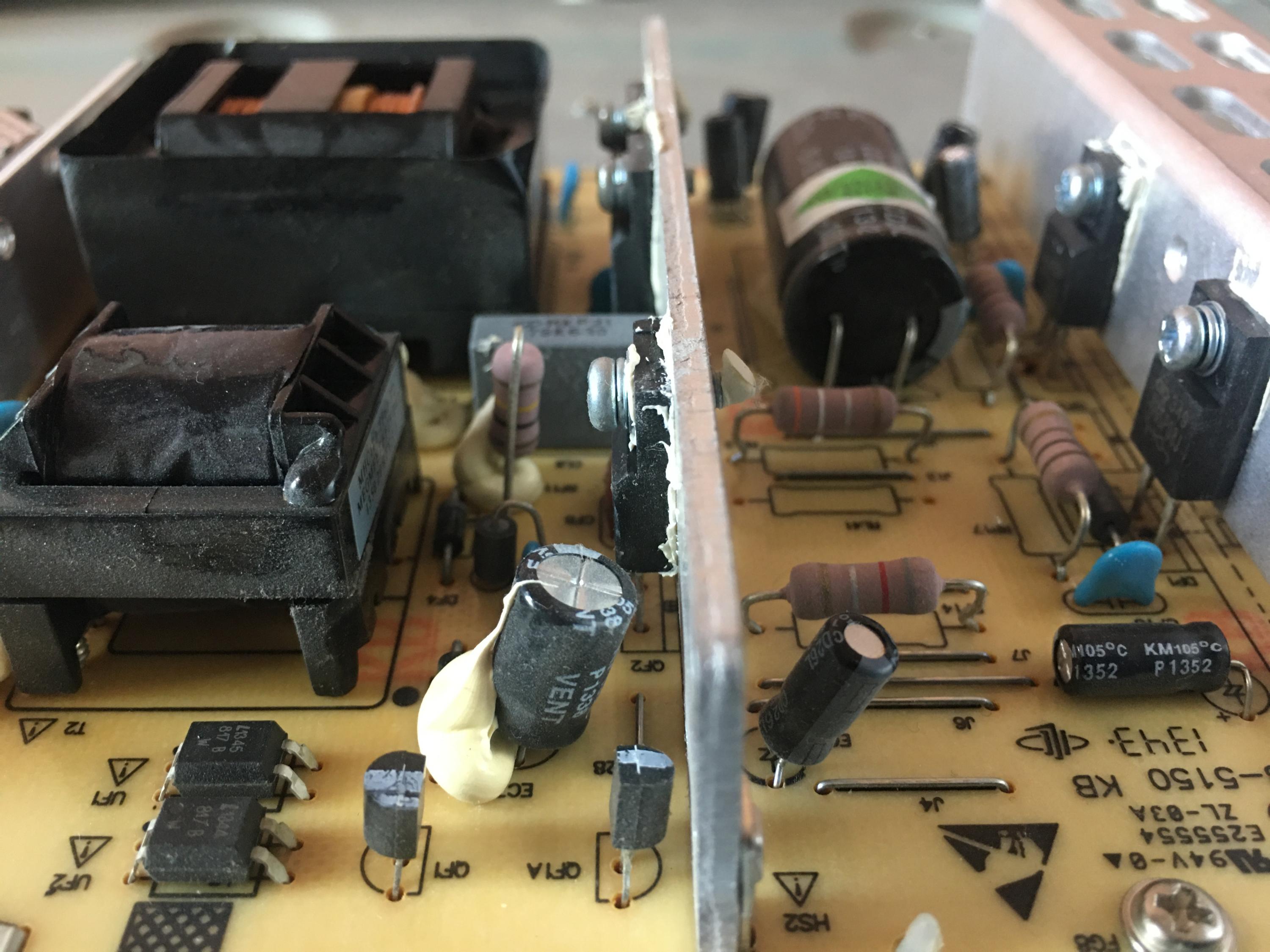

                            • Lupin3
                              • Jan 2022
                              • 29
                              3 pics to see the caps
                                Success with the hair dryer!!!
                                Does this mean the Power Board is the problem?
                                • Diah
                                  • Feb 2013
                                  • 6598
                                  one or 2 caps are at end life. no need to replace boards do it just caps. you can all replace with less 3$
                                  at yours photo its look 2 caps swollen up.. any in this shape change it

                                    • lotas
                                      • Jan 2016
                                      • 4883
                                      • Russia
                                      The photo shows that five capacitors are swollen, well, it's better to replace everything.
