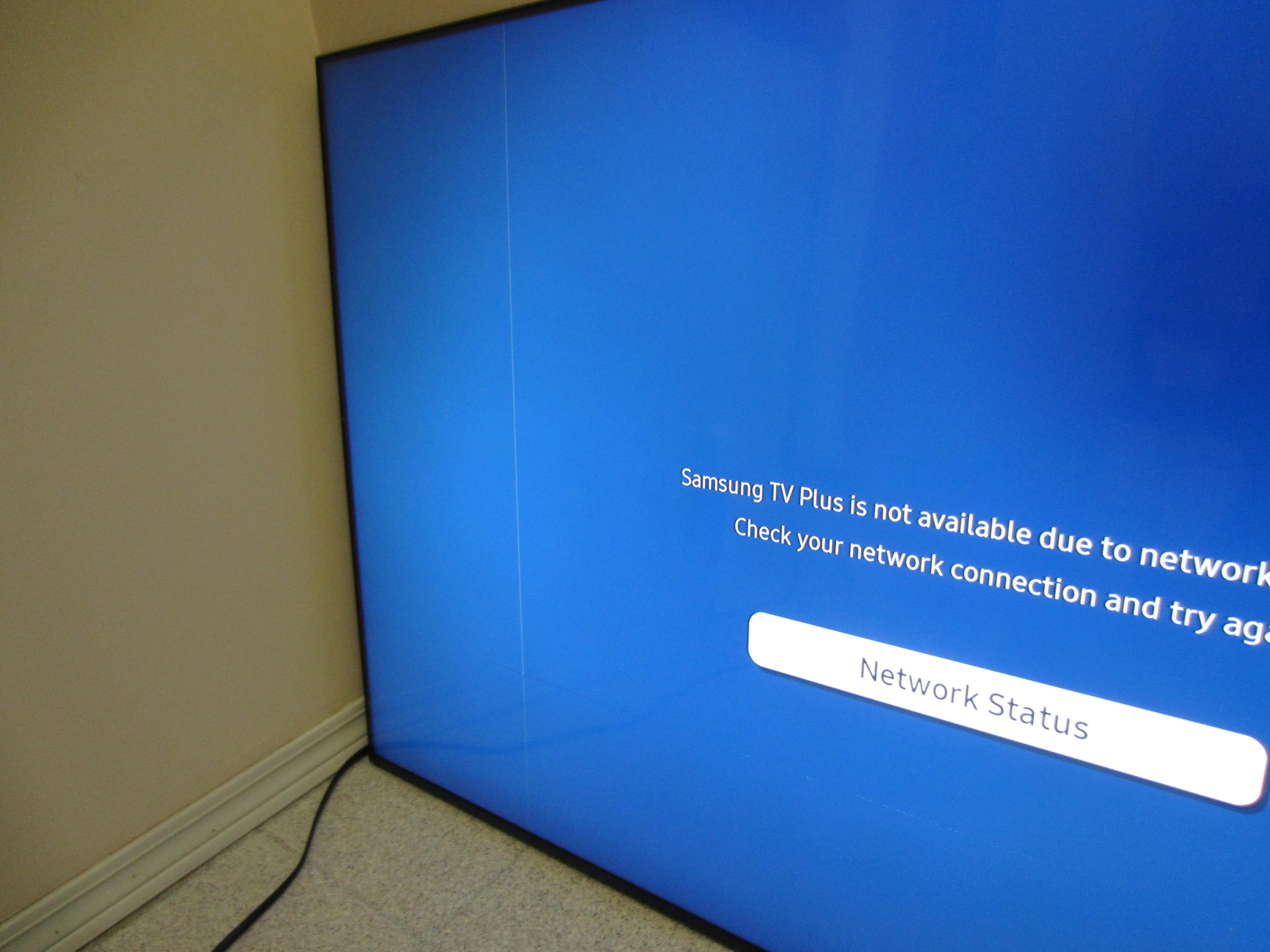

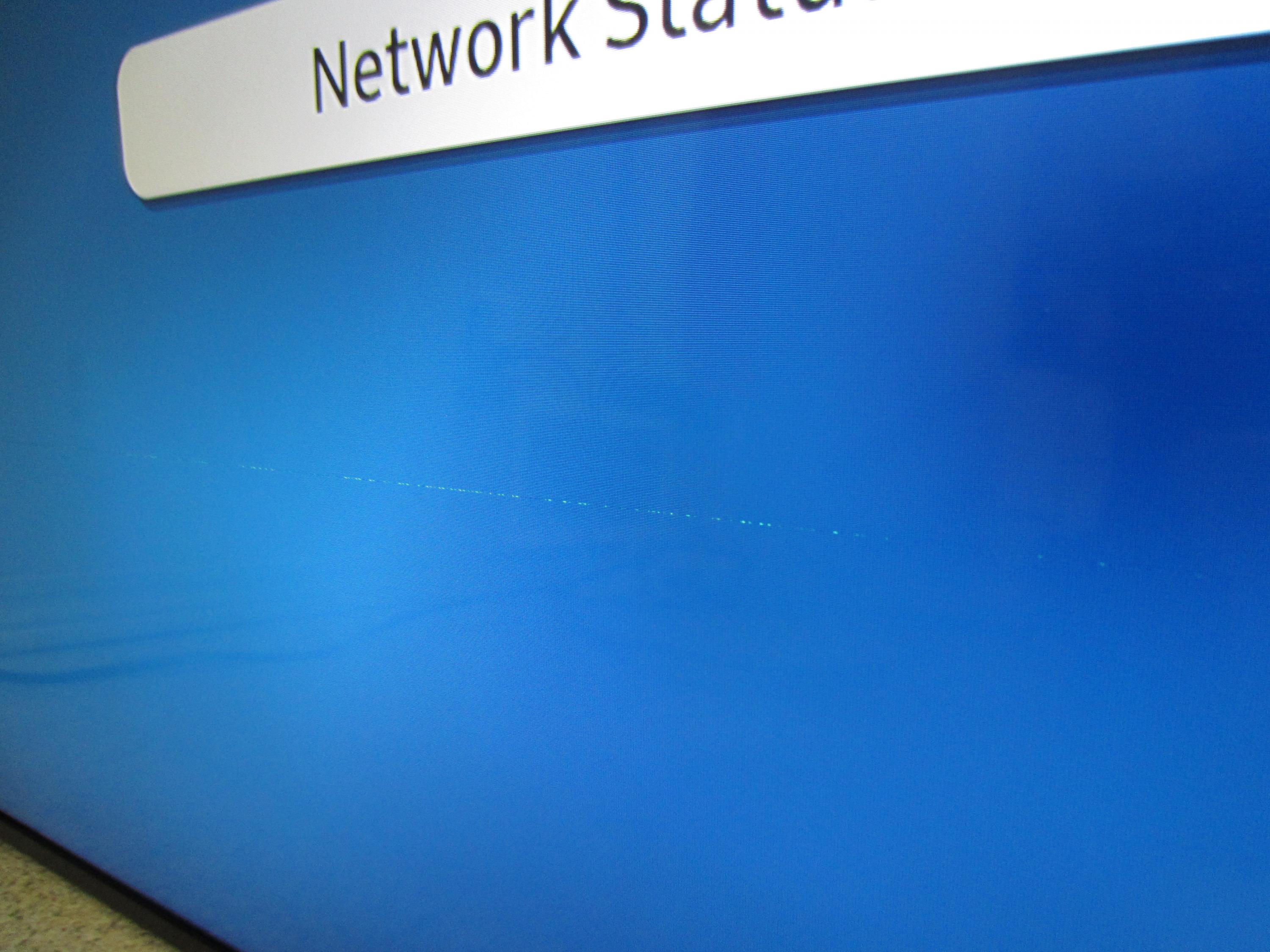

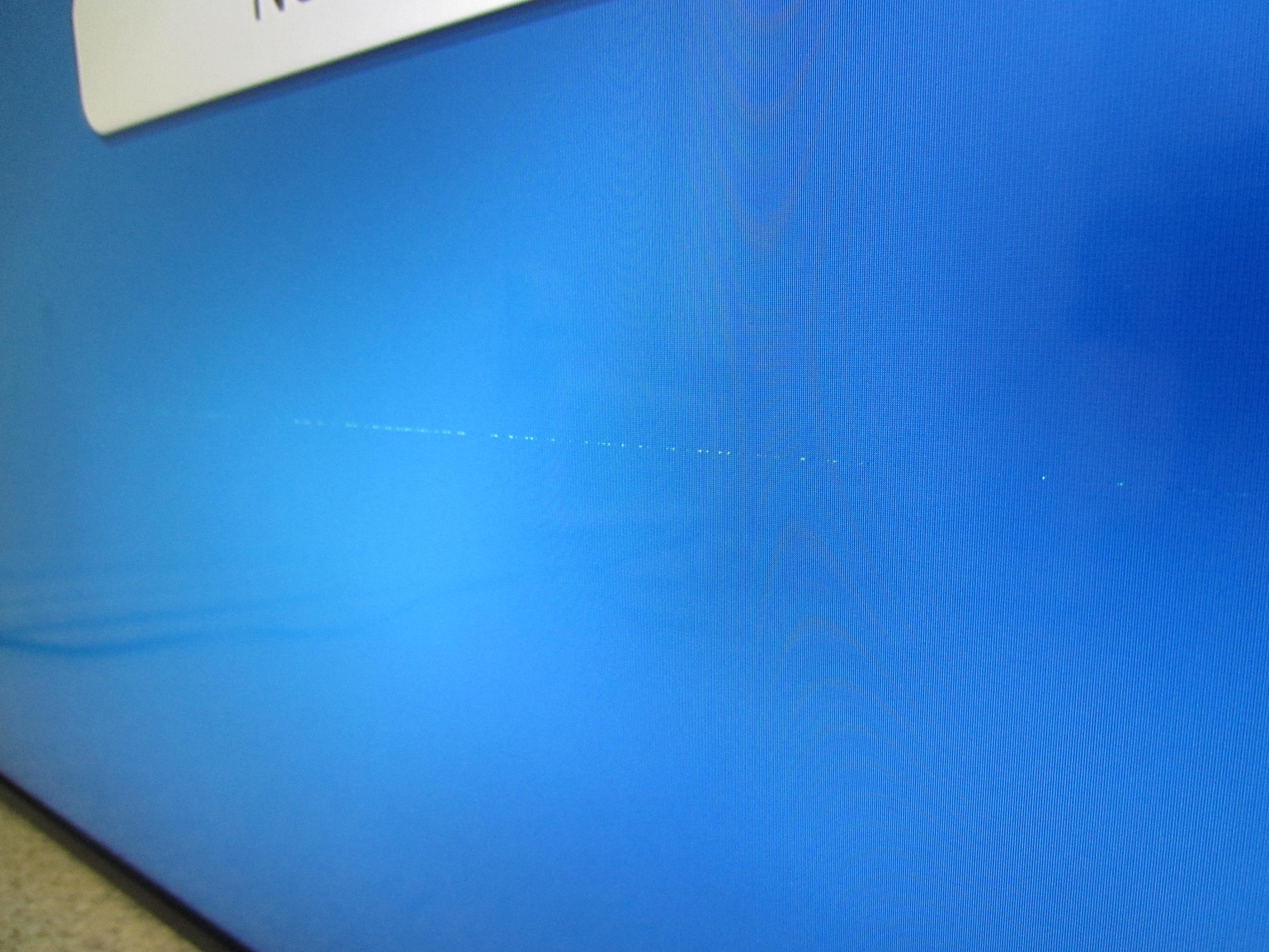

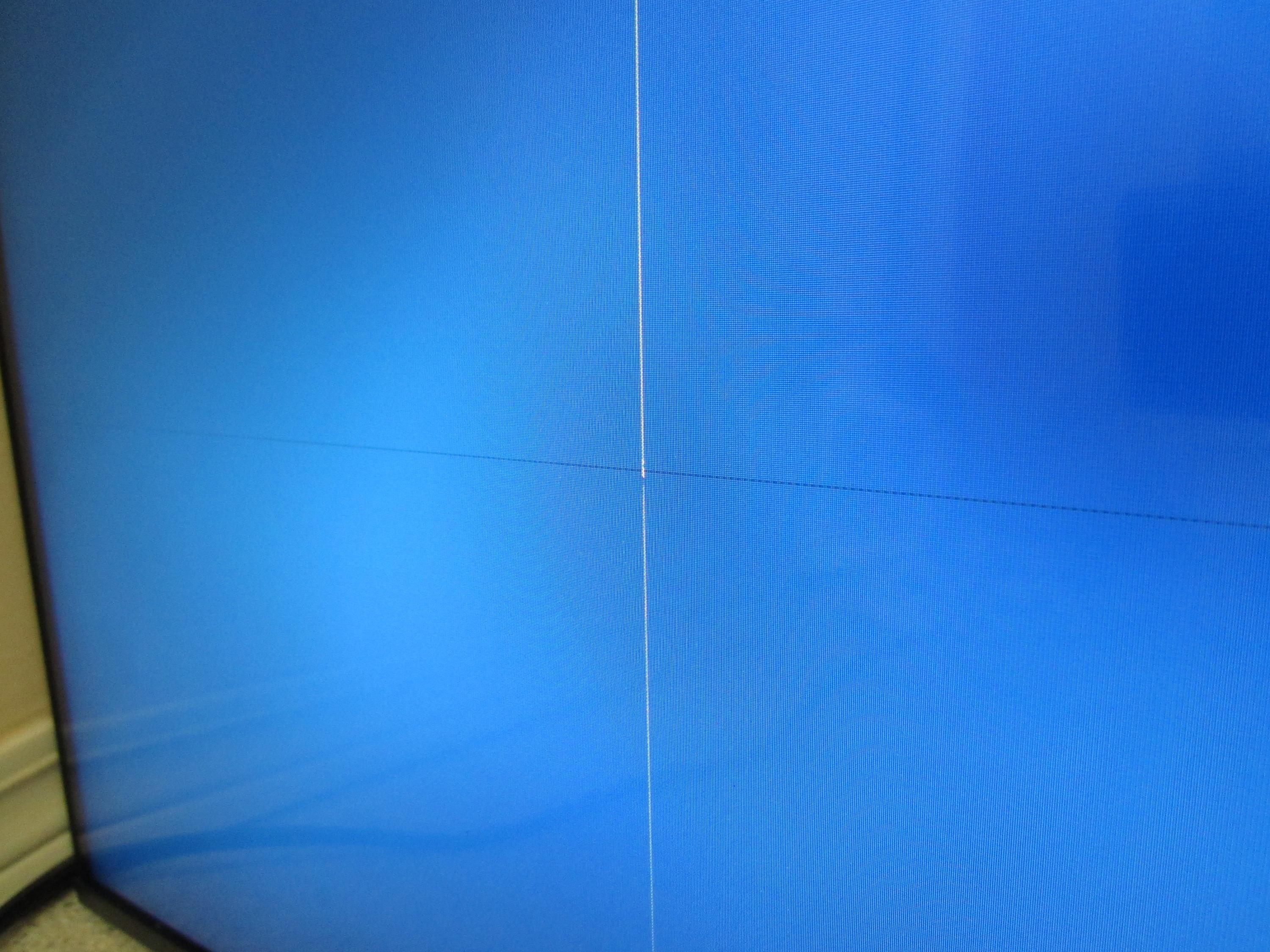

    Samsung UN50TU8000F - 1 horizontal line, 1 vertical
    I have a 50" panel that is SO close to being saved. I checked Youtube and Reddit and found this panel has a few faults as well as power-on issues but can be resolved with the "tape fix". Since I found no matches on the forum for this model yet I thought I'd get a thread started. All the videos on youtube appear to be Brazilian, but no Americans have uploaded. Is this model only available in Canada or Mexico or Brasil for some reason? Is Samsung ditching this model on markets other than American because they know it is faulty? It's only 2 years old with 141 hours. Just looking for the correct placement of tape as I have been at this almost all day now with the same result or no picture.

    Cof problem !
    https://www.youtube.com/watch?v=mFrC...annel=NOELTECH

      Re: Samsung UN50TU8000F - 1 horizontal line, 1 vertical
      I'm going to take a look at the left side first. I wonder if chopping off the bad one would work, but I hate damaging things.
        There don't appear to be any side COFs on this set... looks like the pane goes right to the side with only drivers on the bottom of the screen.
            Vertical lines can't be fixed with tape method. Google Sony tcon training manual.
