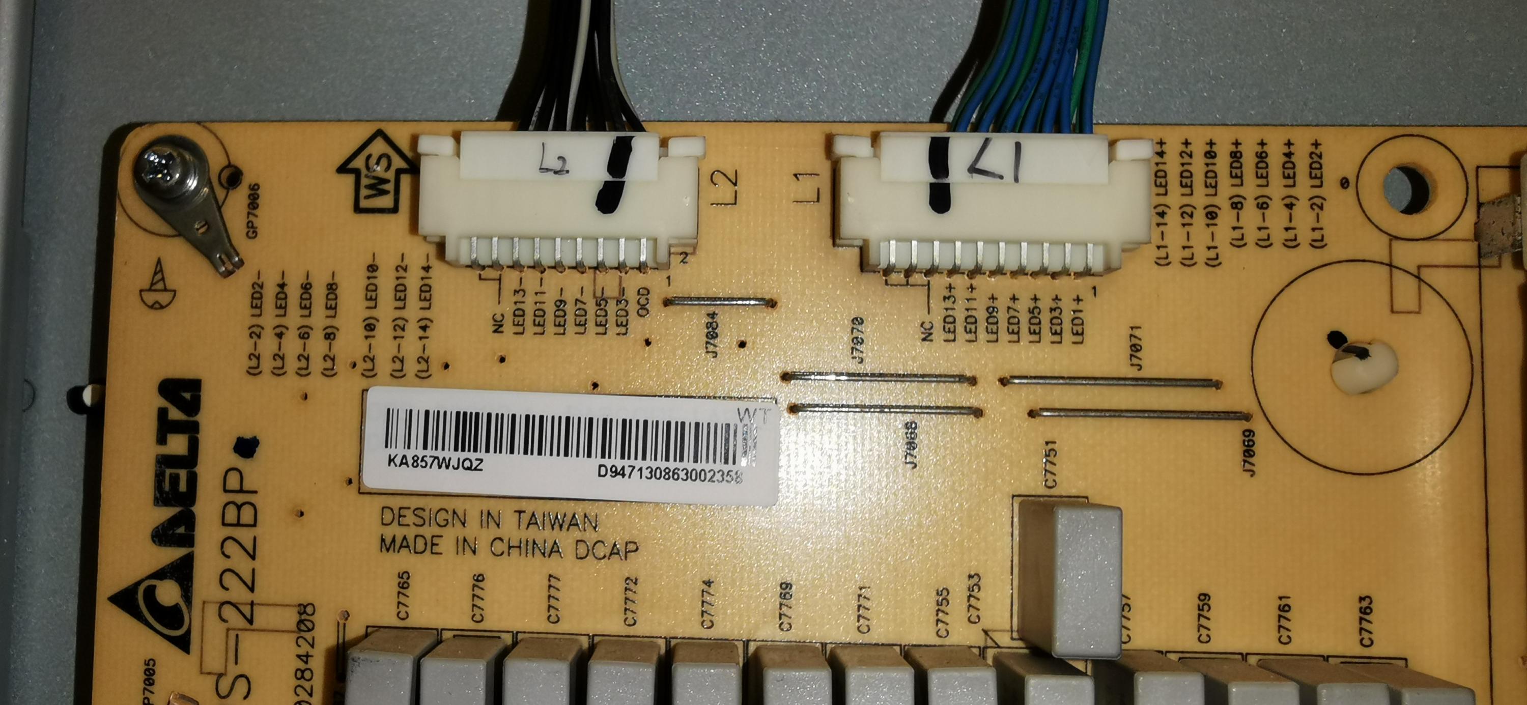

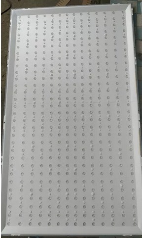

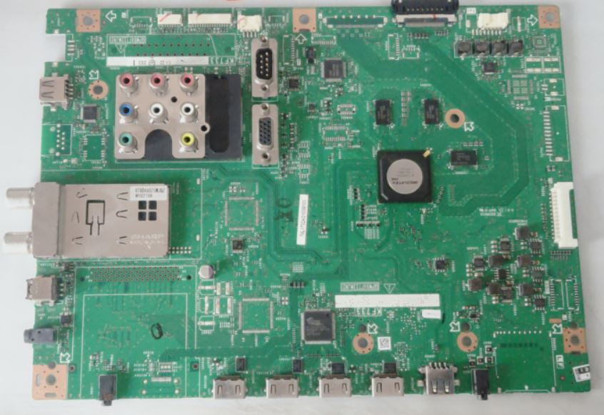

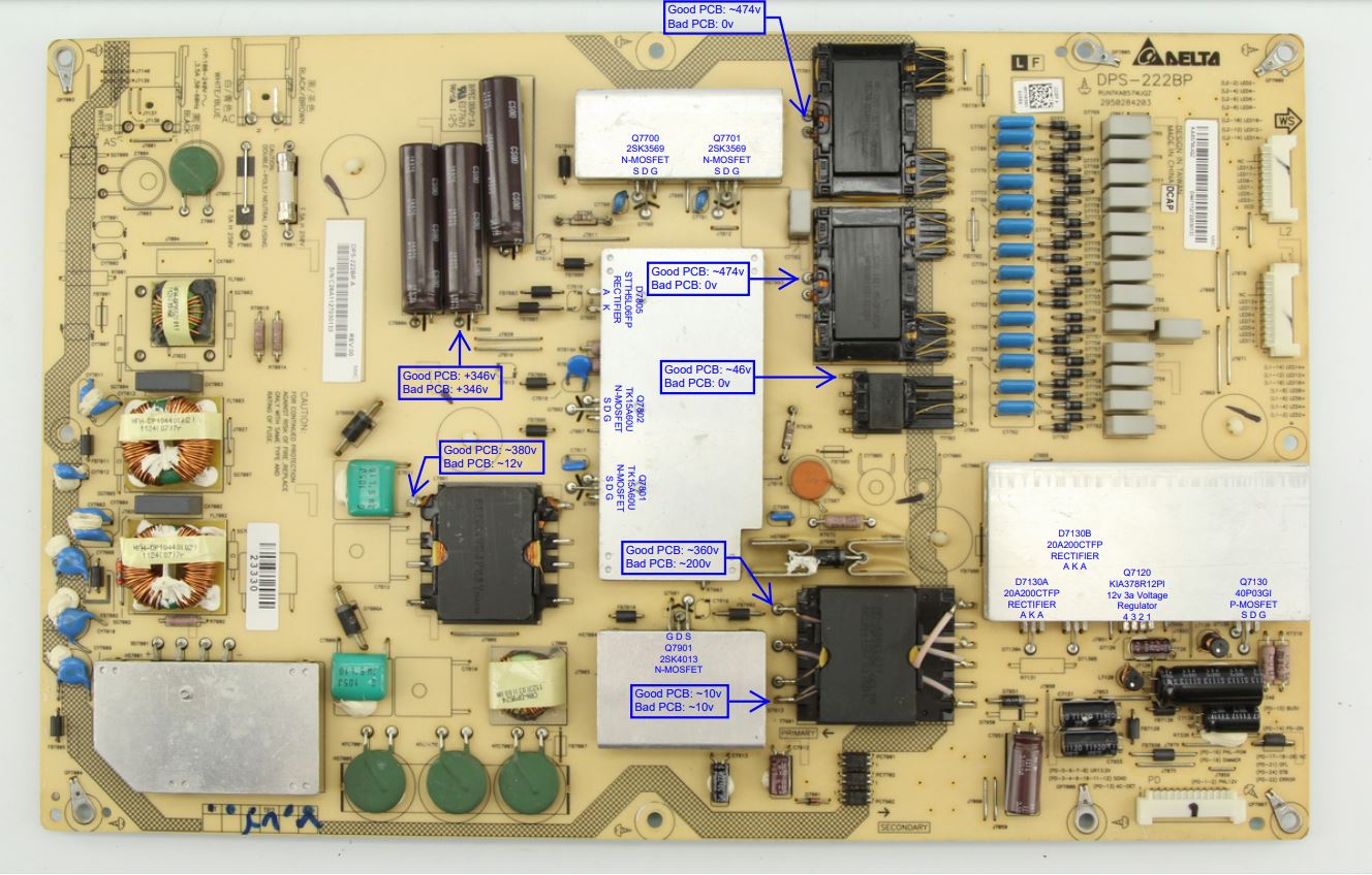

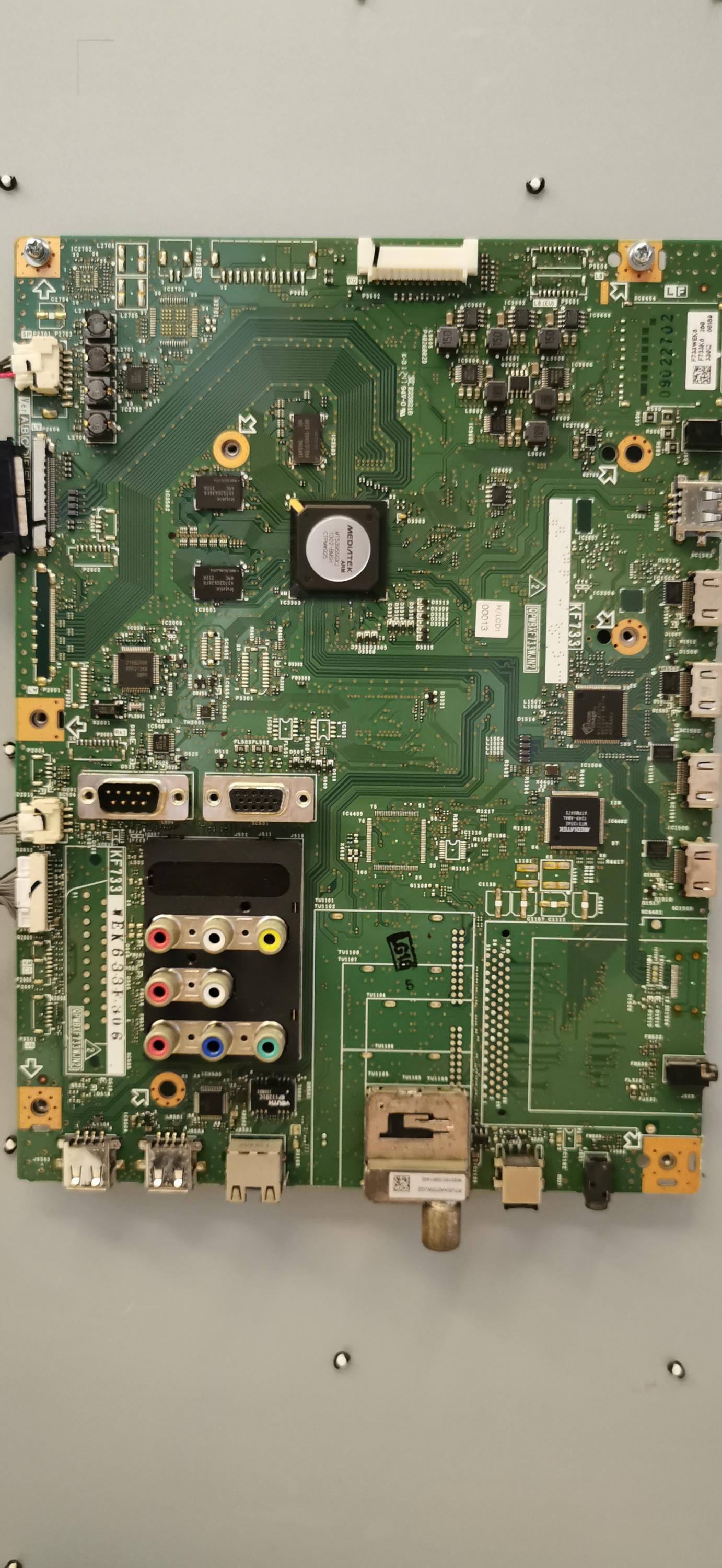

Sharp LED TV flashing green 2x per second - LC-70LE735X, DPS-222BP, RUNTKA857WJQZ
  • beetle1303
    replied
    Re: Sharp LED TV flashing green 2x per second - LC-70LE735X, DPS-222BP, RUNTKA857WJQZ
    I found this page from one of the link provided interesting and will be very useful if the replacement MB doesn't fire-up the backlight.
    Leave a comment:
  • beetle1303
    replied
    Re: Sharp LED TV flashing green 2x per second - LC-70LE735X, DPS-222BP, RUNTKA857WJQZ
    I went ahead to order a closest model MB for replacement, arriving in 10-20 days. Hopefully it will turn on the PD pins for backlight, and fire-up all the led strips.
    Figure crossed!
    Leave a comment:
  • nomoresonys
    replied
    Re: Sharp LED TV flashing green 2x per second - LC-70LE735X, DPS-222BP, RUNTKA857WJQZ
    ok, yeah I thought there should be some sort of flash but wasn't sure.
    Leave a comment:
  • Diah
    replied
    Re: Sharp LED TV flashing green 2x per second - LC-70LE735X, DPS-222BP, RUNTKA857WJQZ
    so according to that, it's looking like maybe one bad led per string then?
    i don't think so, because he had MB issue, and this sharp when you force it on as he did.. will clear error at LED if exist and light them up even for short time or long time with just few strips.
    Leave a comment:
  • nomoresonys
    replied
    Re: Sharp LED TV flashing green 2x per second - LC-70LE735X, DPS-222BP, RUNTKA857WJQZ
    Originally posted by Diah
    from the PCB design of LED section. it sound LED are 5-6V. so 30x6 180V. beside the ampere, tester show you 174V. and i do know of sure its very limited with currents.
    so according to that, it's looking like maybe one bad led per string then?
    Leave a comment:
  • nomoresonys
    replied
    Re: Sharp LED TV flashing green 2x per second - LC-70LE735X, DPS-222BP, RUNTKA857WJQZ
    worth a try, from what I gather the lc and le just might be interchangeable, if it don't work you could resell it I guess.
    Leave a comment:
  • Diah
    replied
    Re: Sharp LED TV flashing green 2x per second - LC-70LE735X, DPS-222BP, RUNTKA857WJQZ
    Originally posted by beetle1303
    But I am tester each of the 14 strips individually - should be able to lit up the 30 leds in it as I have tested it on older 30-led strip.
    I will retry in total darkness and see if what happen.
    *the link to MB you provide is quite expensive... I am searching of cheaper ones from China but they seems to be of different models.
    from the PCB design of LED section. it sound LED are 5-6V. so 30x6 180V. beside the ampere, tester show you 174V. and i do know of sure its very limited with currents.
    Leave a comment:
  • beetle1303
    replied
    Re: Sharp LED TV flashing green 2x per second - LC-70LE735X, DPS-222BP, RUNTKA857WJQZ
    yes, that must be it, if you can match those f733wek6 or f733k6, you should have a match, as far as other boards working, I don't know.
    https://www.bukalapak.com/p/elektron...35x-lc70le735x
    This part link provided by Diah looks like identical to my original MB, but it's 10x more expensive the the close-look from China.
    I think I will try my luck with this cheap one.
    Leave a comment:
  • beetle1303
    replied
    Re: Sharp LED TV flashing green 2x per second - LC-70LE735X, DPS-222BP, RUNTKA857WJQZ
    Originally posted by Diah
    i see now each socket 14 wires.. this is monster.. yours LED tester cant turn on them as i think its limitet with currents few ma.
    at time yours LED BL are 420 LED
    in Australia there are used one MB and in Philippine too
    But I am tester each of the 14 strips individually - should be able to lit up the 30 leds in it as I have tested it on older 30-led strip.
    I will retry in total darkness and see if what happen.
    *the link to MB you provide is quite expensive... I am searching of cheaper ones from China but they seems to be of different models.
    Leave a comment:
  • nomoresonys
    replied
    Re: Sharp LED TV flashing green 2x per second - LC-70LE735X, DPS-222BP, RUNTKA857WJQZ
    yes, that must be it, if you can match those f733wek6 or f733k6, you should have a match, as far as other boards working, I don't know.
    Leave a comment:
  • Diah
    replied
    Re: Sharp LED TV flashing green 2x per second - LC-70LE735X, DPS-222BP, RUNTKA857WJQZ
    Originally posted by beetle1303
    See attached pic - there are 14 LED+ and LED-
    With LED tester red probe on LED+ and black probe on LED-, it reads 173-175V range, mostly 175V. *Cannot* see any light from the back of chassis holes, nor from the front screen.
    *LED tester working when tested with spare led strip.
    i see now each socket 14 wires.. this is monster.. yours LED tester cant turn on them as i think its limitet with currents few ma.
    at time yours LED BL are 420 LED
    in Australia there are used one MB and in Philippine too
    Leave a comment:
  • beetle1303
    replied
    Re: Sharp LED TV flashing green 2x per second - LC-70LE735X, DPS-222BP, RUNTKA857WJQZ
    what are the 5 letter numbers on the white sticker on the original mainboard?
    This white sticker?
    Leave a comment:
  • nomoresonys
    replied
    Re: Sharp LED TV flashing green 2x per second - LC-70LE735X, DPS-222BP, RUNTKA857WJQZ
    what are the 5 letter numbers on the white sticker on the original mainboard?
    Leave a comment:
  • beetle1303
    replied
    Re: Sharp LED TV flashing green 2x per second - LC-70LE735X, DPS-222BP, RUNTKA857WJQZ
    Originally posted by beetle1303
    Nope... torch with lowest frame for 1 minute or so, and stopped immediately at the sight of light smoke! No, it did not trigger fire alarm, but retested and ya, completely BBQed
    Shopping for a replacement MB:
    This one from TaoBao is the closes I can find:
    Model: LCD-70LX732A MB: QPWBXF733WJN2 Panel: LK695D3GW30C
    Original:
    LC-70LE735X MB: QPWBXF733WJN2 Panel: LK695D3GW3AD
    You think this will work?
    Leave a comment:
  • beetle1303
    replied
    Re: Sharp LED TV flashing green 2x per second - LC-70LE735X, DPS-222BP, RUNTKA857WJQZ
    Originally posted by Diah
    i just reading back yours POST #13 you wrote that you cant see any light of LED with tester however the tester show 173V !!
    you dont have 14 strips from the photo i can see only 7 wires on eack socket the LED - socket L2 and LED+ socket L1
    so forexample testing LED-2 with LED+2 LED-11 with LED+11 and so on.. you can see from amy whole at the chassus if there are light or not.
    See attached pic - there are 14 LED+ and LED-
    With LED tester red probe on LED+ and black probe on LED-, it reads 173-175V range, mostly 175V. *Cannot* see any light from the back of chassis holes, nor from the front screen.
    *LED tester working when tested with spare led strip.
    Last edited by beetle1303; 04-21-2022, 10:33 AM.
    Leave a comment:
  • Diah
    replied
    Re: Sharp LED TV flashing green 2x per second - LC-70LE735X, DPS-222BP, RUNTKA857WJQZ
    Originally posted by beetle1303
    A quick checked - the big cap shows 403Vdv but all the transformers above it shows no voltages in all the output pins... With a LED tester - all the 14 led strips are mostly 175V, with 2-3 showing 173-174V.
    i just reading back yours POST #13 you wrote that you cant see any light of LED with tester however the tester show 173V !!
    you dont have 14 strips from the photo i can see only 7 wires on eack socket the LED - socket L2 and LED+ socket L1
    so forexample testing LED-2 with LED+2 LED-11 with LED+11 and so on.. you can see from amy whole at the chassus if there are light or not.
    Leave a comment:
  • beetle1303
    replied
    Re: Sharp LED TV flashing green 2x per second - LC-70LE735X, DPS-222BP, RUNTKA857WJQZ
    Originally posted by Diah
    wow... try but could be good if you put weight on the IC and from downside start heating or from the top ab to you just to avoid the chips move from it place... be sure you know the emergency fire police Tel No,
    Nope... torch with lowest frame for 1 minute or so, and stopped immediately at the sight of light smoke! No, it did not trigger fire alarm, but retested and ya, completely BBQed
    Leave a comment:
  • Diah
    replied
    Re: Sharp LED TV flashing green 2x per second - LC-70LE735X, DPS-222BP, RUNTKA857WJQZ
    Originally posted by beetle1303
    I have a butane torch for brazing that can heat to 700°C - can use this at low frame for 1-2 minutes?
    wow... try but could be good if you put weight on the IC and from downside start heating or from the top ab to you just to avoid the chips move from it place... be sure you know the emergency fire police Tel No,
    Leave a comment:
  • beetle1303
    replied
    Re: Sharp LED TV flashing green 2x per second - LC-70LE735X, DPS-222BP, RUNTKA857WJQZ
    Originally posted by Diah
    you need at least 250° only hot air gun can do,, or infrared Korean BBQ
    I have a butane torch for brazing that can heat to 700°C - can use this at low frame for 1-2 minutes?
    Leave a comment:
  • Diah
    replied
    Re: Sharp LED TV flashing green 2x per second - LC-70LE735X, DPS-222BP, RUNTKA857WJQZ
    Originally posted by beetle1303
    Nope.. with the big 2200w hairdryer at max heat min for 6-8min, nothing happens..
    you need at least 250° only hot air gun can do,, or infrared Korean BBQ
    Leave a comment:
  • Cemal Odabasioglu
    MacBook Pro A1707 Motherboard Diagnostic Help – CD3215 heating and Fluctuating Rails
    by Cemal Odabasioglu
    I'm currently diagnosing a MacBook Pro A1707 motherboard that does not power on. I've gathered some data but am stuck and need expert advice.
    Note that i'm a beginner in electronics and i'm trying to learn while trying to repair this macbook that my work gave me. I'm really curious and love understanding how thing works and i already learned so much.
    Only one usb c port is taking 20v and have 12.5v on PPBUS_G3H. when trying other ports, 2 are not going to 20v and one is going to 20v but the CD3215 is getting really hot.
    Observations...
    01-14-2025, 03:54 PM
  • triplefour
    ONN 100012588 Has fluctuating Voltage on PSU 12v
    by triplefour
    Hello all got another TV here im puzzled by. why cant they all be easy fixes that just need a little love and some tape???
    anyway i go to this guys house to look at an ONN 100012588
    this is my first time looking at one of these brand of TV's.
    TBH i have low expectations because i see ONN as the cheap walmart brand that suddenly popped up selling the cheapest version of all kinds of tech things. and someone sent me a ONN flash drive with some data on it with some recordings they wanted me to check out and it immediately broke and corrupted the data and i was unable to...
    09-14-2022, 07:41 PM
  • beetle1303
    Wine Chiller - SMPS issue - fluctuating voltages
    by beetle1303
    My wine chiller, TECNO SW-126LCD, is semi-functional - it powers up, can set temperature, and chilled to the set temperature, and cuts off compressor, etc. It however runs very hot.
    Upon taken out the PSU and did some basic check - 5V output to LCD panel buttons and display is stable, but there is no 12V output to LED lights, and fans.
    Further checks found the secondary side voltage is fluctuating around 8-15V range, but the 7805 regulator seems ok and producing the stable 5V output.
    Checking further on the primary side: Incoming line input to bridge...
    09-04-2023, 10:33 AM
  • koby058
    yoga9 3v3 5v fluctuating
    by koby058
    Hi
    board model: NM-D992
    type c remains on 5v. when i connect it the 3.3VALW and 5VALW fluctuating. can someone please help understand why?
    main power rail voltage 13v
    till now i have tried:
    measured all coils resistance looks ok
    replaced RT6585CGQW to a brand new one
    replaced all mosfets for 3.3v regulator and the dual mosfet for 5v regulator
    happen both on DC power and on battery
    issue remains
    video
    schematic attached...
    08-03-2025, 09:06 AM
  • ronelex
    Macbook Air A1466 Fluctuating 3v supply
    by ronelex
    Hello
    I got this unit with orange light but wont boot up
    I notice that its L7560 3.3v supply is fluctuating
    this is the reading I got on its PWM U7501 TPS51890A
    pin 4- EN1 - 0v
    pin 12 - EN - 3.3v Fluctuate
    pin 21 - EN2 - 3.3v Fluctuate
    pin 22 - vreg3 - 3.3v ok
    pin 23 - vin - 8.62V
    pin 29 - vreg5- 5v fluctuate
    I already check the power rails line in page 62 but I didn't find any short on those lines. I already tried replacing the pwm but same issue.
    I hope you can guide me where I can look for the fault of this...
    02-07-2023, 04:39 AM
