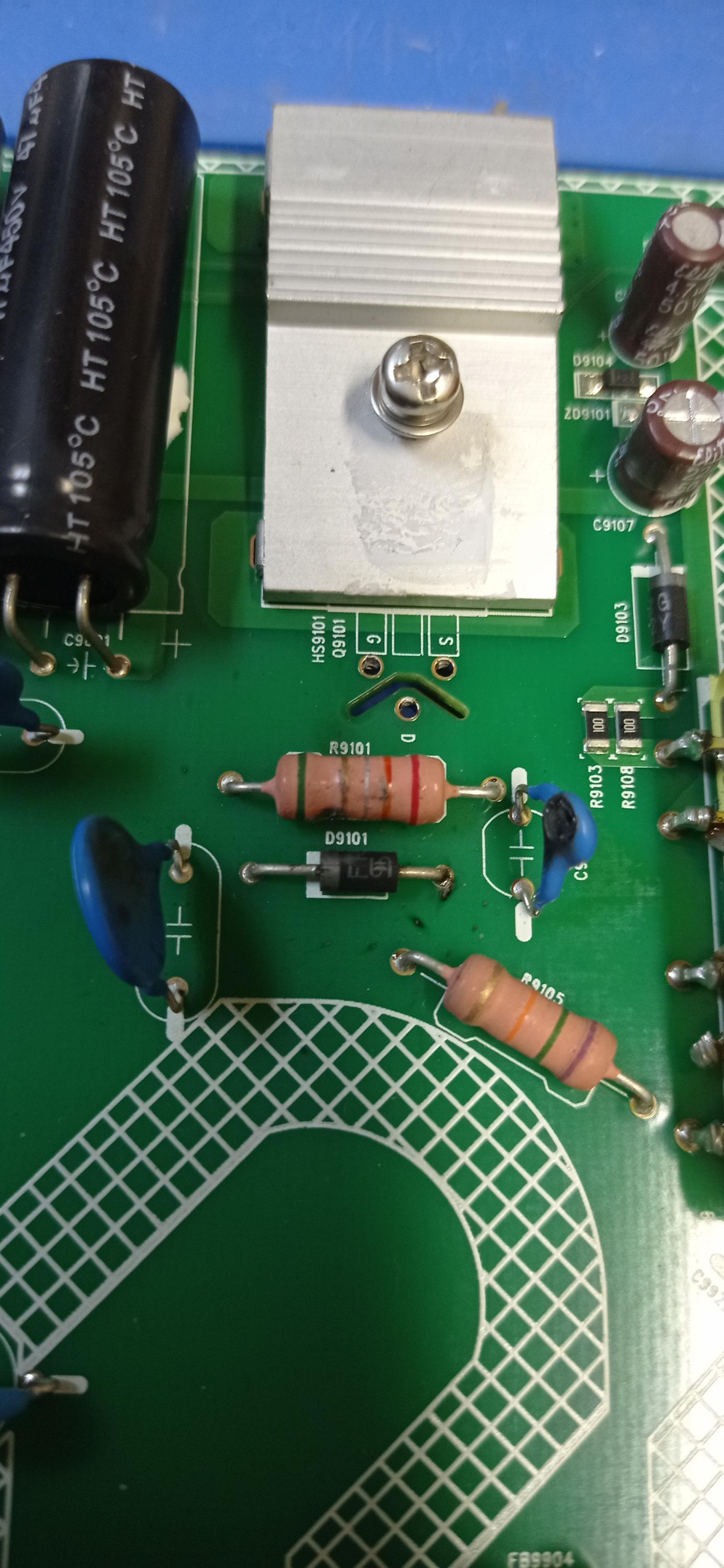

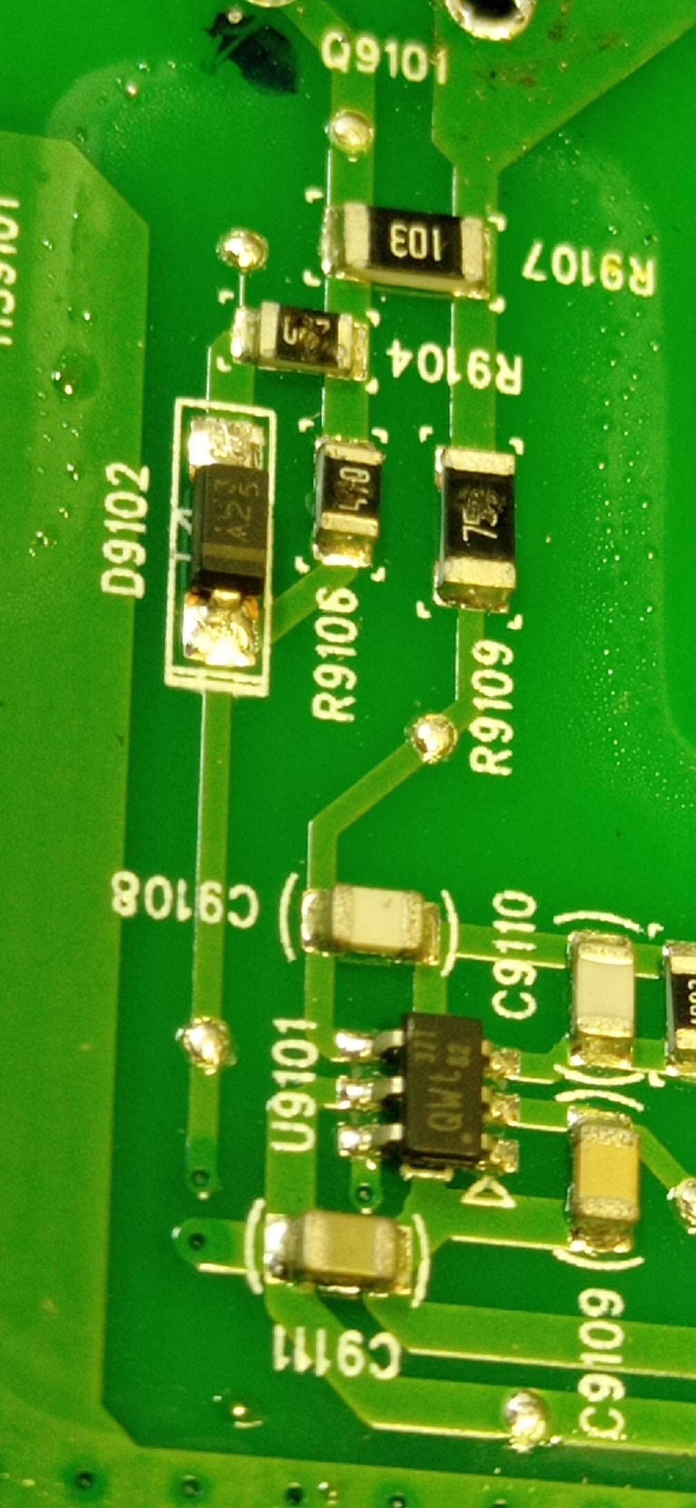

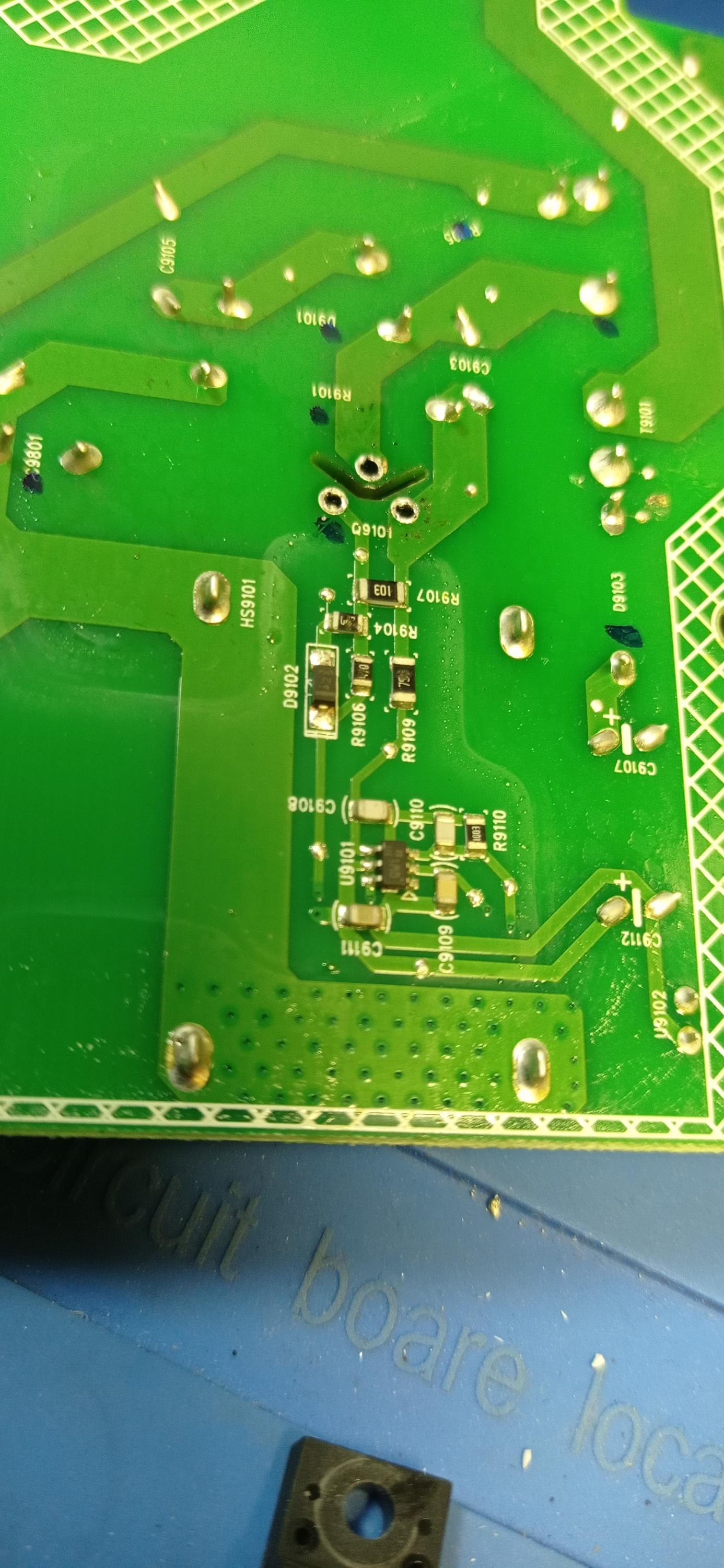

      Hello. The manual shows that the Current Sense Resistor that is blown at the photo is 0.2R or 200mOhms. The colour code though tells me that this resistor is 0,22 Ohms with 5% tolerance. Do you know how many watts this resistor is and what type? Thanks!

        R9101 is likely a 0.22Ω 2 watt, the blue ceramic cap (C9108?) is also blown, so ic9101 will also be damaged and need replacing. R9109, R9106, R9104 are also damaged, D9102 is also likely bad, and I would also replace C9107 and C9112

          Thanks for the reply. In my situation there are much less blown components.
