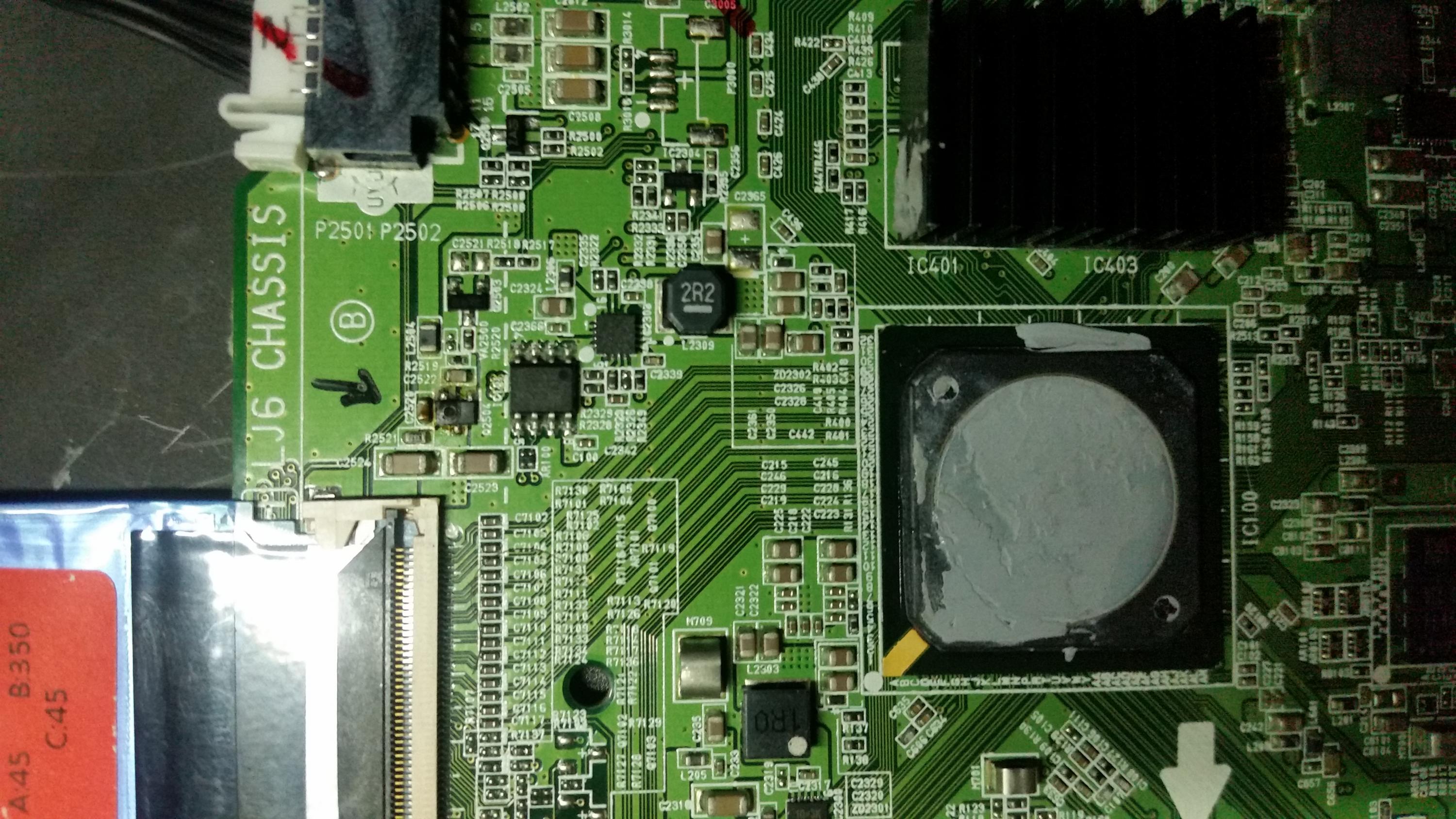

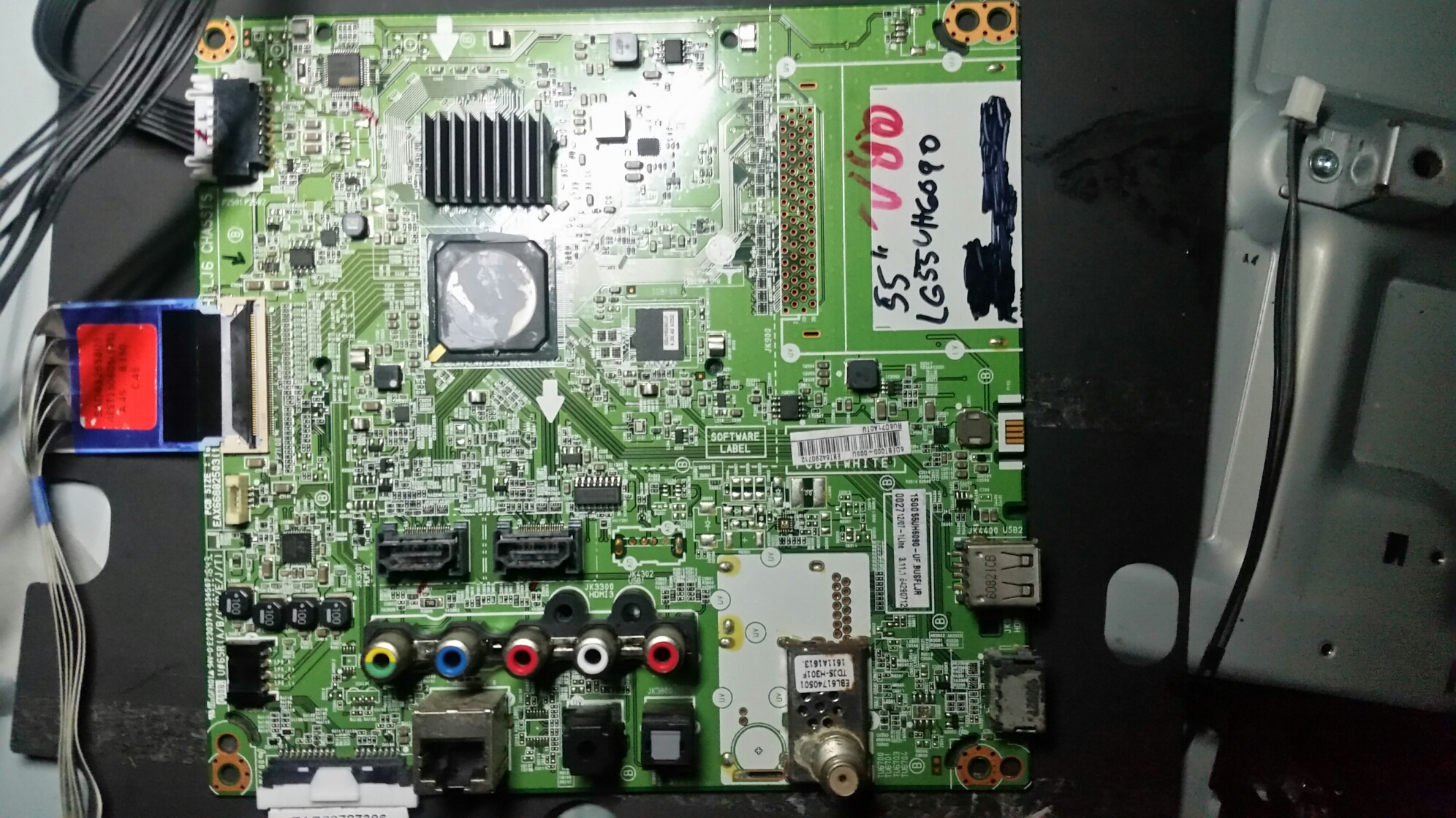

    Here's some pictures. There's 3 more but I have to resize them

      You connected the main board from a 4K TV to a non 4K one. U in the model number is an indication of 4K (UHD). Sometimes ok to try swapping mains from same/similar model but different screen sizes and the connections and board match.

        The transistor Q2504 supplies 12v to the t-con and likely the panel as well, which is likely different between these models.
        The transistors, collector would normally connect to the t-con fuse via the lvds cable
        It looks like the supply for the t-con is on different pins on the t-con boards.
        I suspect your main board tried supplying 12v to ground (or some other component on the t-con or the panel which may now be damaged) via the transistor

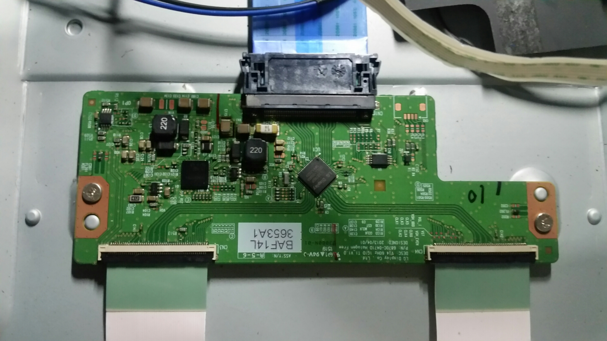

            Here's those other pics. This is the original tcon. I guess I assumed the lvds pinout would be same if similar model same brand and connectors match...feel I've done this before in other tvs with no harm. Maybe doesn't work but no harm...come to think of it I had already tried a different psu and main board combo on this panel. One from a 50" lg that also had a different tcon but same connections. I had no visible problem other than the TV just displayed some vertical lines. Though who knows maybe doing that damaged the panel already.

              the blown IC are stepdown . just you have the MB now toasted... T-con maybe toasted too as the VCC pin are at different align .. panel will not effected.

                I accept that i may have fried that mb too bad to repair but i still would like to replace that component just to see. I have a spare tcon of the same kind if it took that out as well. For now I'm gonna focus on getting the original main board to boot up. It just sits there not responding to button or remote but the light is on. Lights are on but no one's home! I see 3.5v on pin 3 of the button board connector and it goes down to zero when I push the button so that part of the circuit is working. I see 3.1v on the PSON pin which I think needs 5v to tell the psu to turn on all the way? Not sure about that because all 13v voltages are present. Backlight on pin sits low, so mb is not turning it on...I guess I'll try to trace where both of thise pins lead to.
                This is all a learning experience. I'm working with scavenged tvs and parts so no real damage to anything but my ego...and that poor mainboard!
                  Thank you for clarifying this. I will watch out for the U from now on!

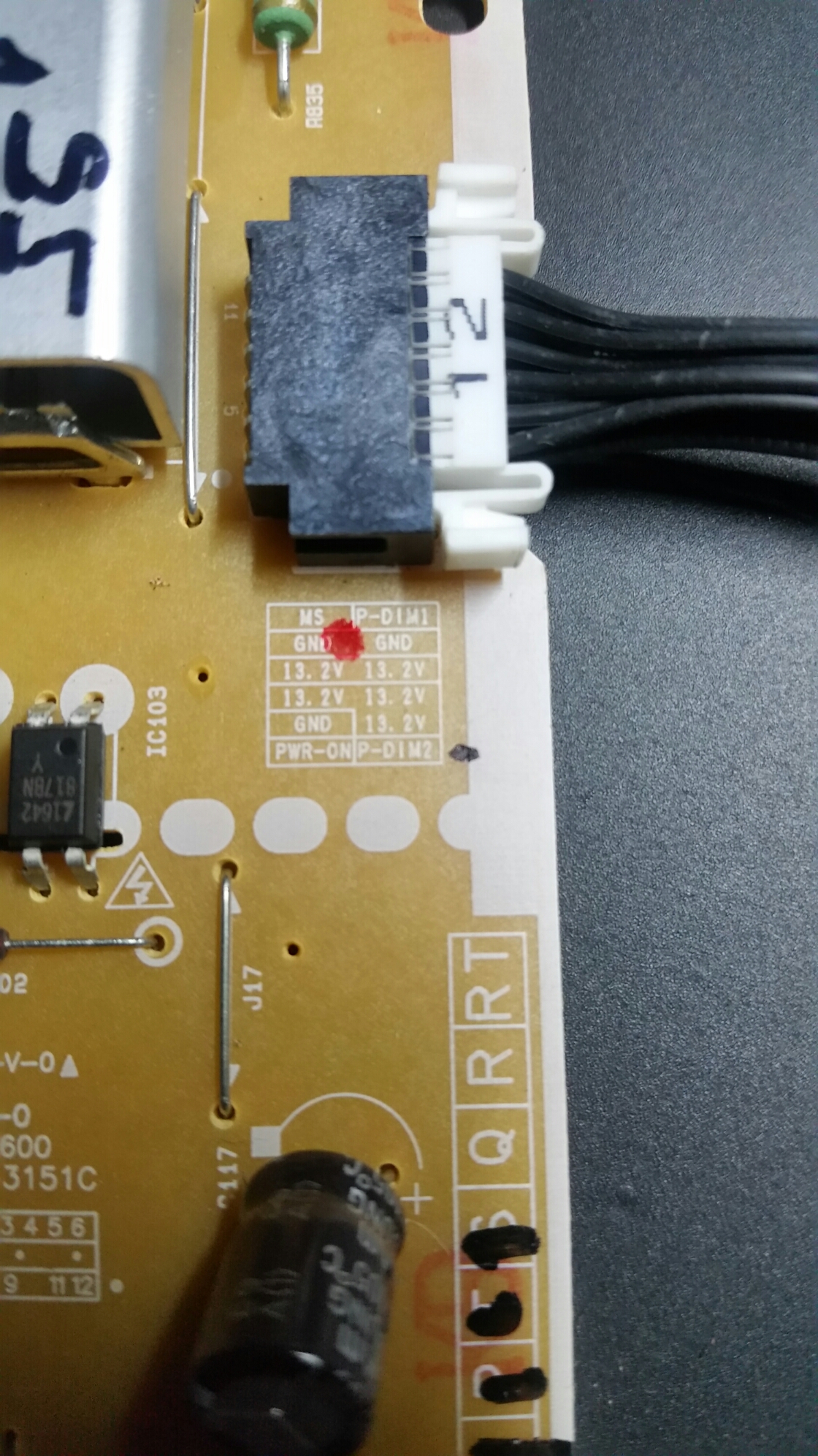

                    Yes upon closer inspection I now know that the mainboard sends 12v via the leftmost 8 pins but on the tcon for this panel it only receives 12v on the leftmost 4 pins so the 12v went to 4 more pins than it should have!

                        I checked a different schematic and found the panel_power transistor is a SSM3J332R,LF mosfet, I suspect this would work for Q2504

                                    so SSM3J332R panel VCC of sure because of false pin align went short.
                                    BTW: yours Photo is ths belong to original MB.. if yes it work and booting 100%. if you feed it with HDMI signal it will of sure hear sound. if no video then T-CON. .. or panel to start one side ribbon plug out.

                                      Thank you. The orginal mainboard does not boot. Does not respond to button or remote. Backlight doesn't come on. Red standby light is on and light from optical audio out is on. I haven't had a chance yet to study the schematic but I will soon

                                        i am confused... the photo i mentioned before of mainboards you uploaded .. belong for what then ???
                                        we can see on it the optical port lit on mean this mainboards booted complete ... !!!
