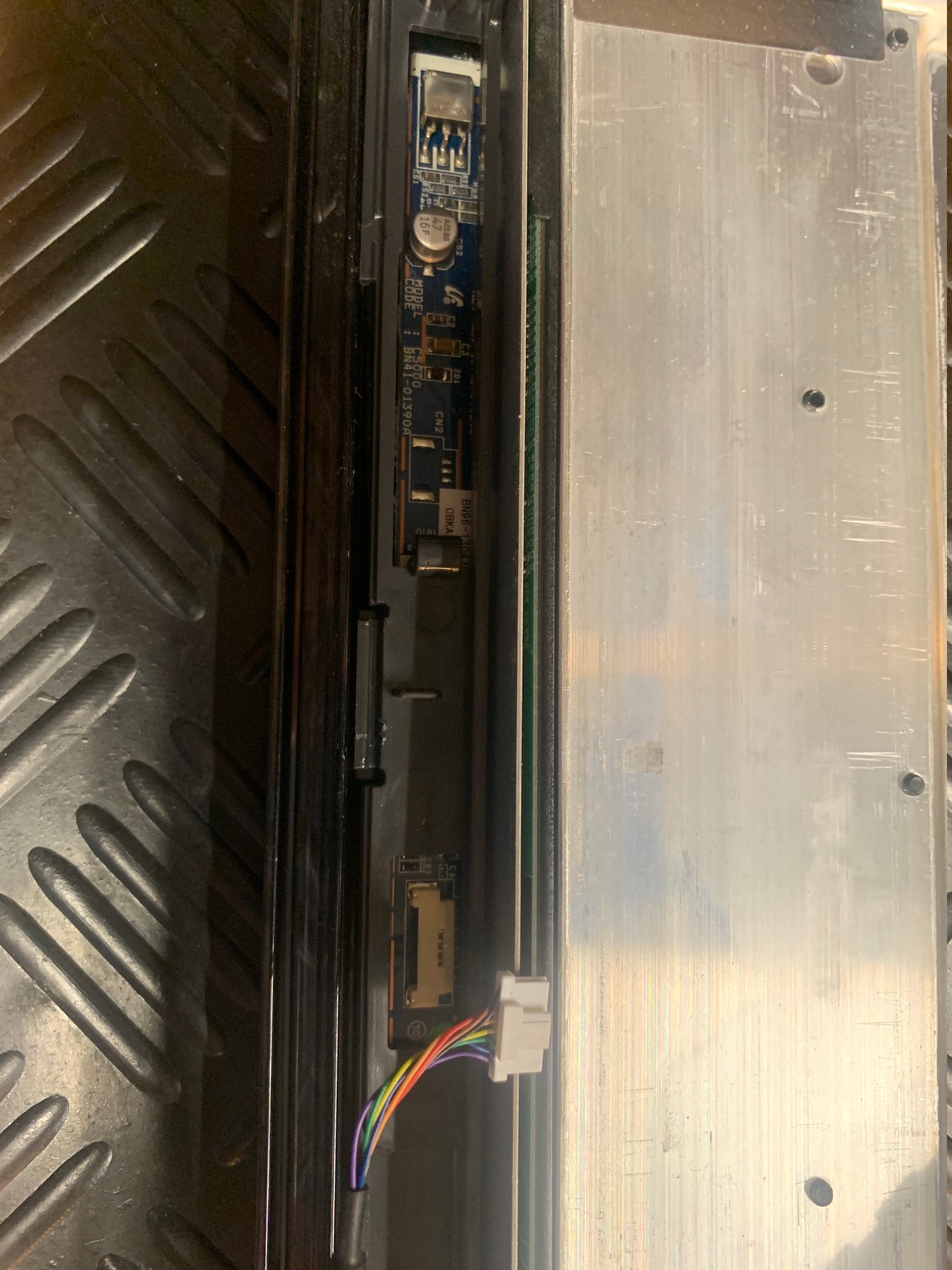

    I've got a Samsung UE40C6005 which turns itself on and off as it wants to. It's exactly as I use the remote or the touchstrip on the front.
    My question is if this could be related to a faulty touchstrip and is it possible to disable the touch but keep the remote reciever operating (placed on the same pcb which has Samsung P/N BN96-13047G
    It would be ok to skip the touch function and only use the remote. Anyone know the pinout of the ribbon cable ?

    Just ohm out the ir sensor. With connector unplugged does it still turn on and off?

      Re: Samsung UE40C6005 turns off and on by itself
      Stupid of me to not test that first...
      It's not so often it happens but I will run it with connector unplugged.
      I thought perhaps the IR sensor and the touchbuttons were sent through a common SPI bus or similair...
      • PowerAmpFreak
        • 982
        • Sweden
        Without touch / IR module the set works correct. Does not turn on and off by itself.
          wonder if the power button is sticky, maybe get a little isopropyl alcohol in between the buttons and click them many times, might also just be bad.
