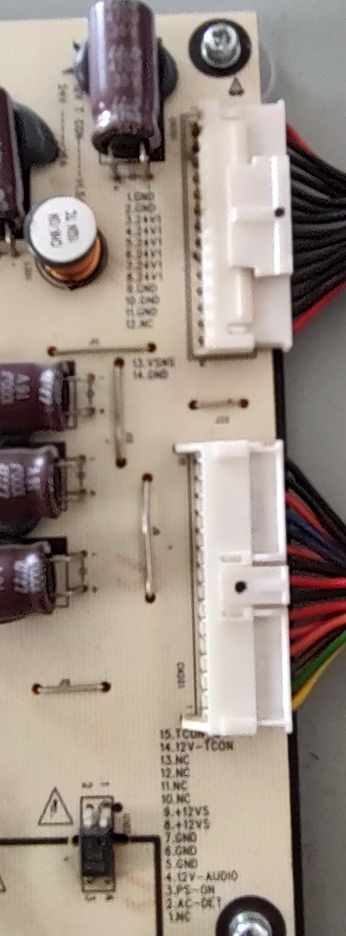

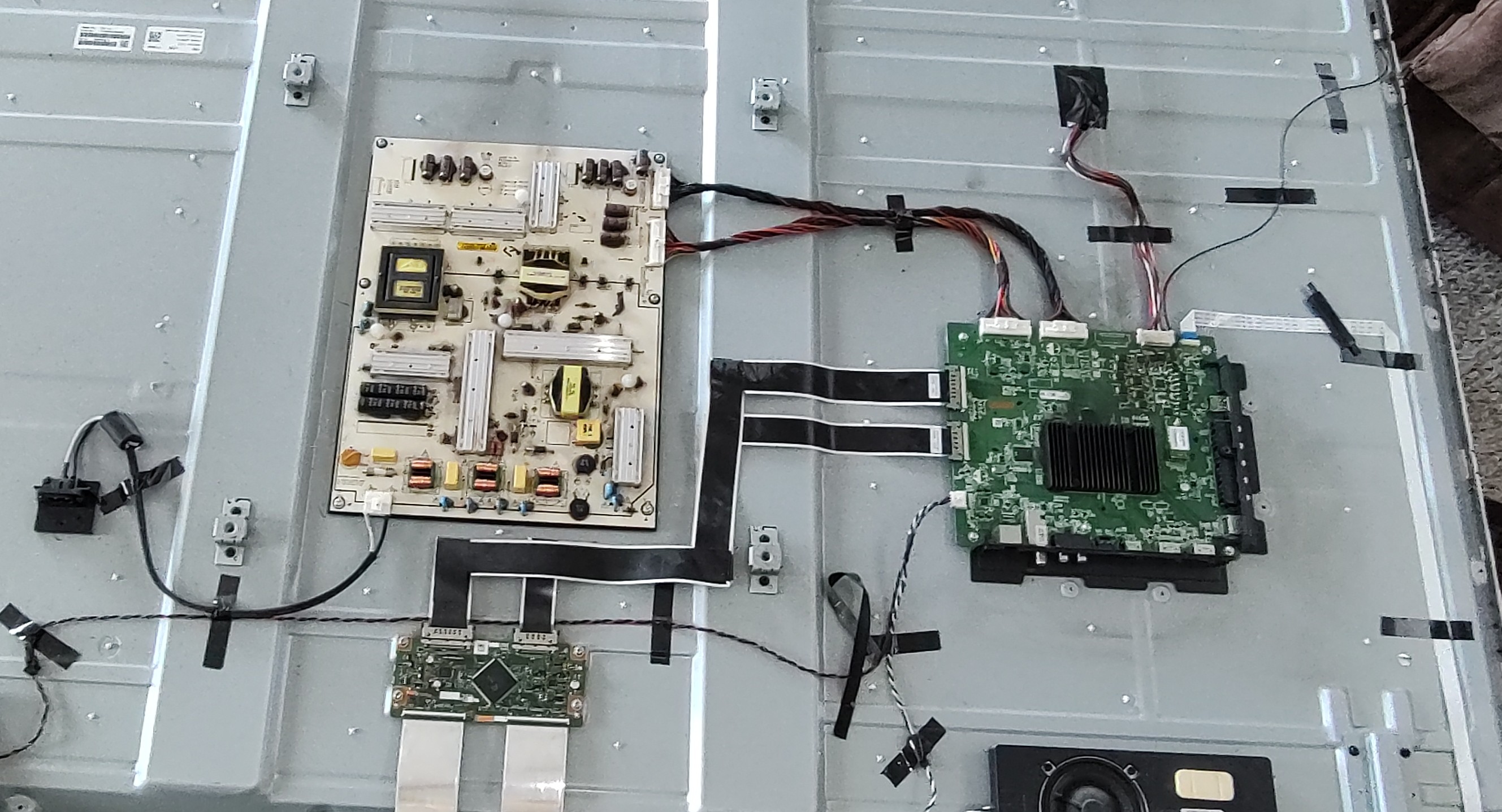

    Hi new to this forum. Also not very well versed in modern electronic circuits but well versed vintage vacuum tube electronics I'm owner/operator of www.nosvalves.com I appreciate any insight you folks my have on this TV problem.
    Anyway I've owned this TV for 6, 7 or 8 years? It started losing back light LED strips until the picture was getting dark over about 40% of the screen. I checked online and found a full set of led strips for $82 shipped so thought why not give it a whirl. Watched a couple YouTube how to videos. Ended up not being to hard but it was tedious.. the bad part is once done I fired it up all the led lit so I put it back together hung it on the wall hooked all the sources.. it again was obvious the led strips all lit up but it never boots to the "V" Vizio logo. It seems the LCD is inoperable now. I took it back down checked and triple checked all the connections.
    So I went to checking all the voltages on cable sockets of the power supply board. See 3 photos for results. 24Vs are 2+ volts high, 12V are slightly up. Tcon volts not present. Some voltage present that are not specified on the board.
    Any clue what might be the problem?
    Thanks for any help!
    Craig

    Re: Vizio E70-C3 issue

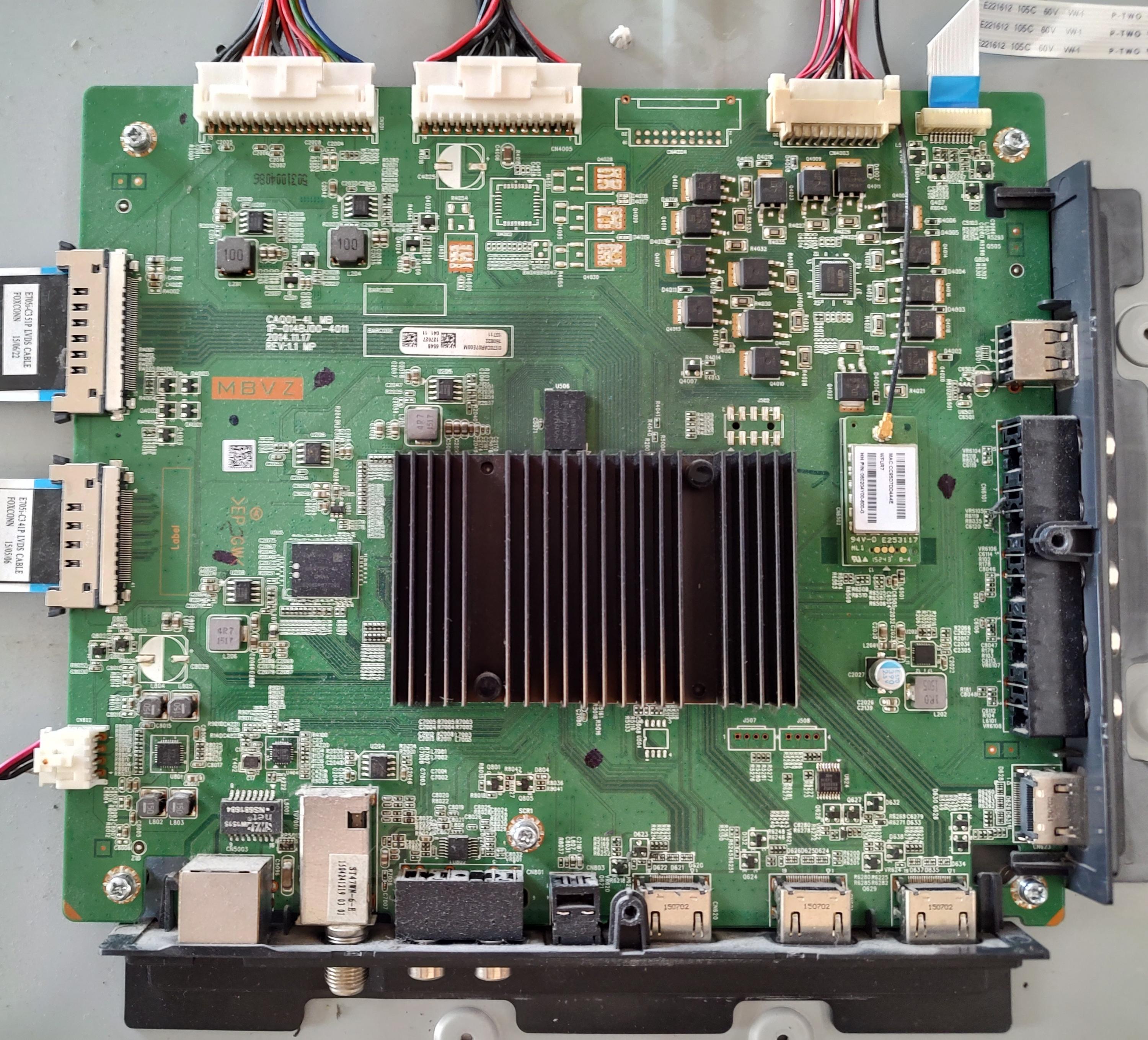

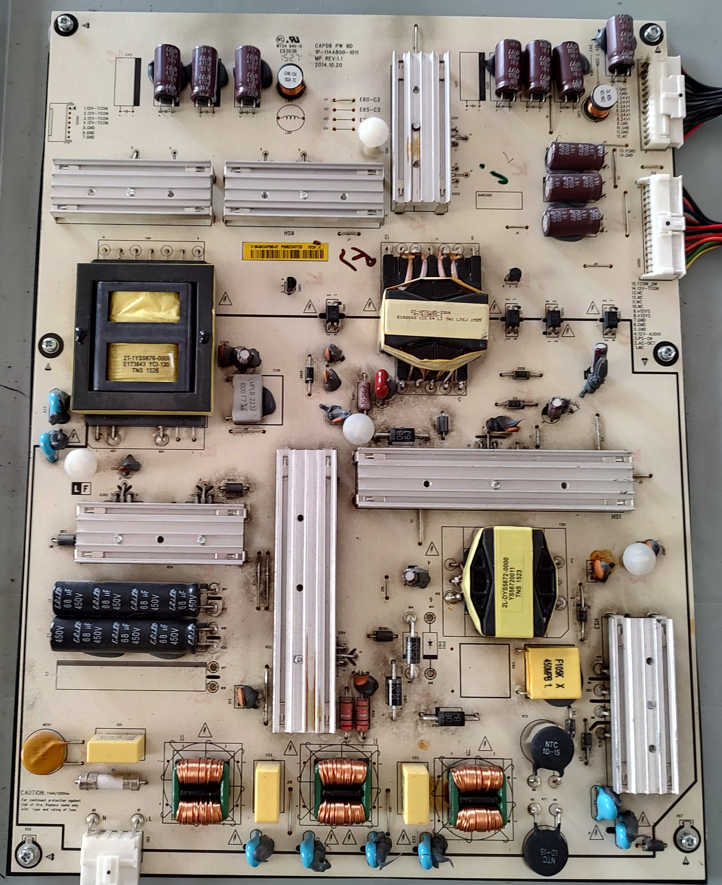

    can you post some good focused pictures? one of the whole back with all the boards in it and one of each board?
      Sure! Thanks

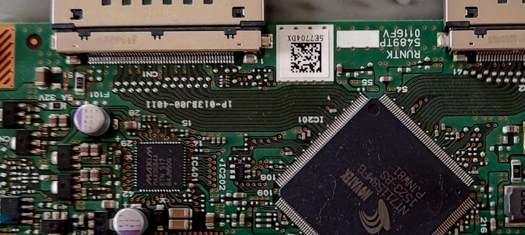

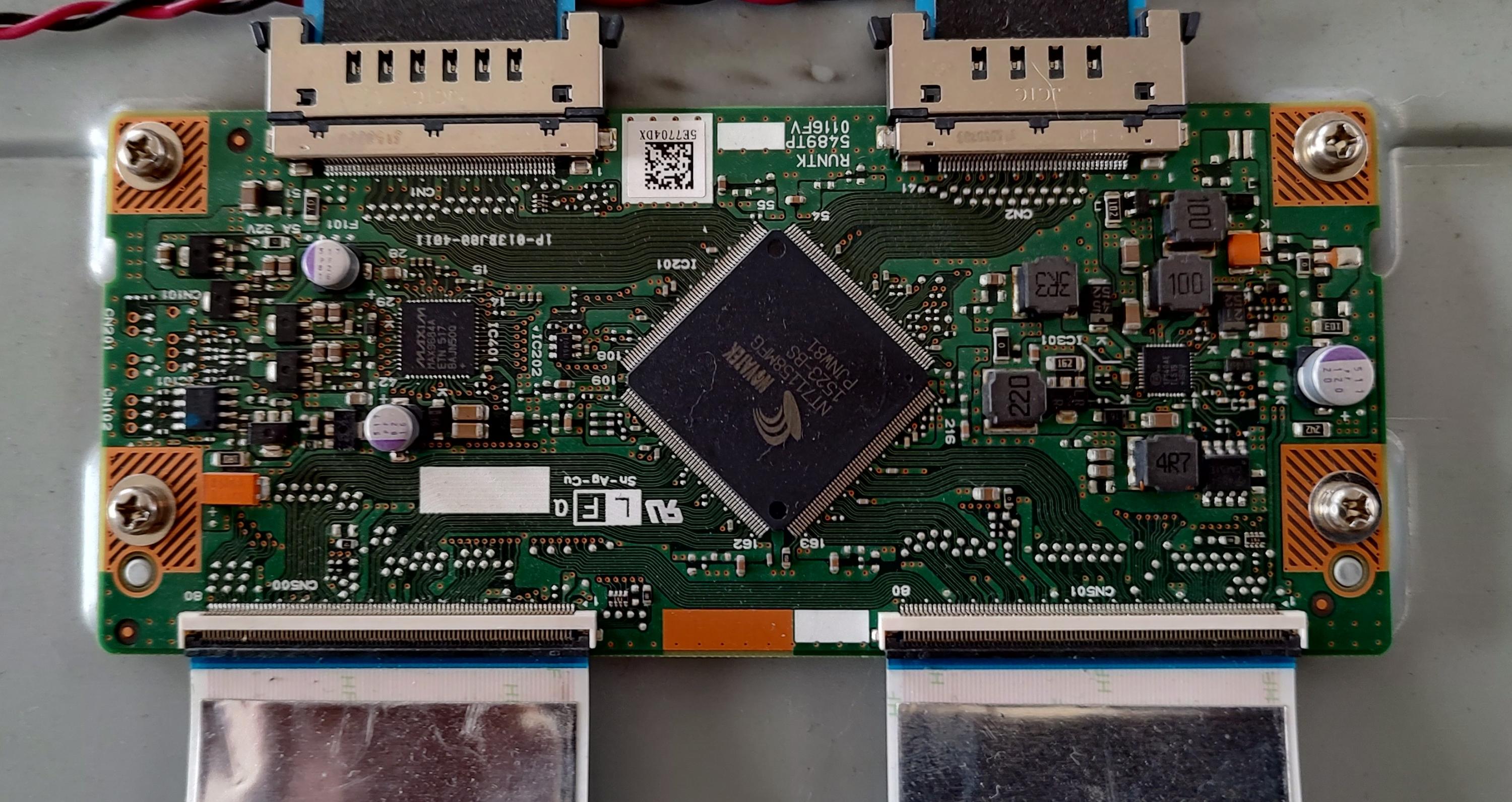

        not sure maybe check the fuse on tcon, neg probe on chassis ground, pos. probe on each end.
          sorry to write bad news.. you probably damaged the panel (screen ) when you take it apart... hopefully not.. but you can disconnect one ribbon cable between the T-CON and the panel at time and turn on see if you will have half screen displayed,
          another possibility could happen... you damaged the ribbon cable as they are old enough and dried out easily to bracken the contact pins ( take them out and inspect them carefully with good light source and loop )
            being a vizio e, i wouldnt be surprised if the panel was bad, try unhook one side of the tcon ribbon to panel, turn on tv, see what if anything on display, then do the other side, ALWAYS do plug and unplug of cables with tv unplugged from power, to avoid any problems.
                Your vizio light changes when you power on? Your 3.4v on nc. is puzzling.
                  I thought that was strange too. I also wonder about the tcon 12V being 0V and the tcon-ON being 0V....if that board is not turning on how could the display work?
                  Another thing I found is one low voltage electrolytic cap has zero volts and both the 450V caps in the lower left of the power supply board have zero volts. It does not seem logical that a bad panel would cause these things?
                      What does this fuse look like?

                        Your tcon-on should have about 3.4v on it to turn on tcon 12v to power t-con board. No wires where changed? Is that nc pin on power board indeed have no traces coming off of it?

                          Fuse 5A
                            If you are referring to the long caps on hot side of board you have to reference your ground on neg. side of those caps. They should be around 390vdc.

                                Sorry I'm not home right now so I can't test anything. I previously already unhooked both ribbon cables between tcon and the LCD it didn't change any of the suspect voltages. I'll do any tests mentioned above tomorrow. I'll be surprised if it is the LCD my wife and I were really careful moving it. If it is damaged it will be the address board to LCD that are a little rough getting loose to tape them out of the way to the front. But I guess from what I've read they can be real delicate.
