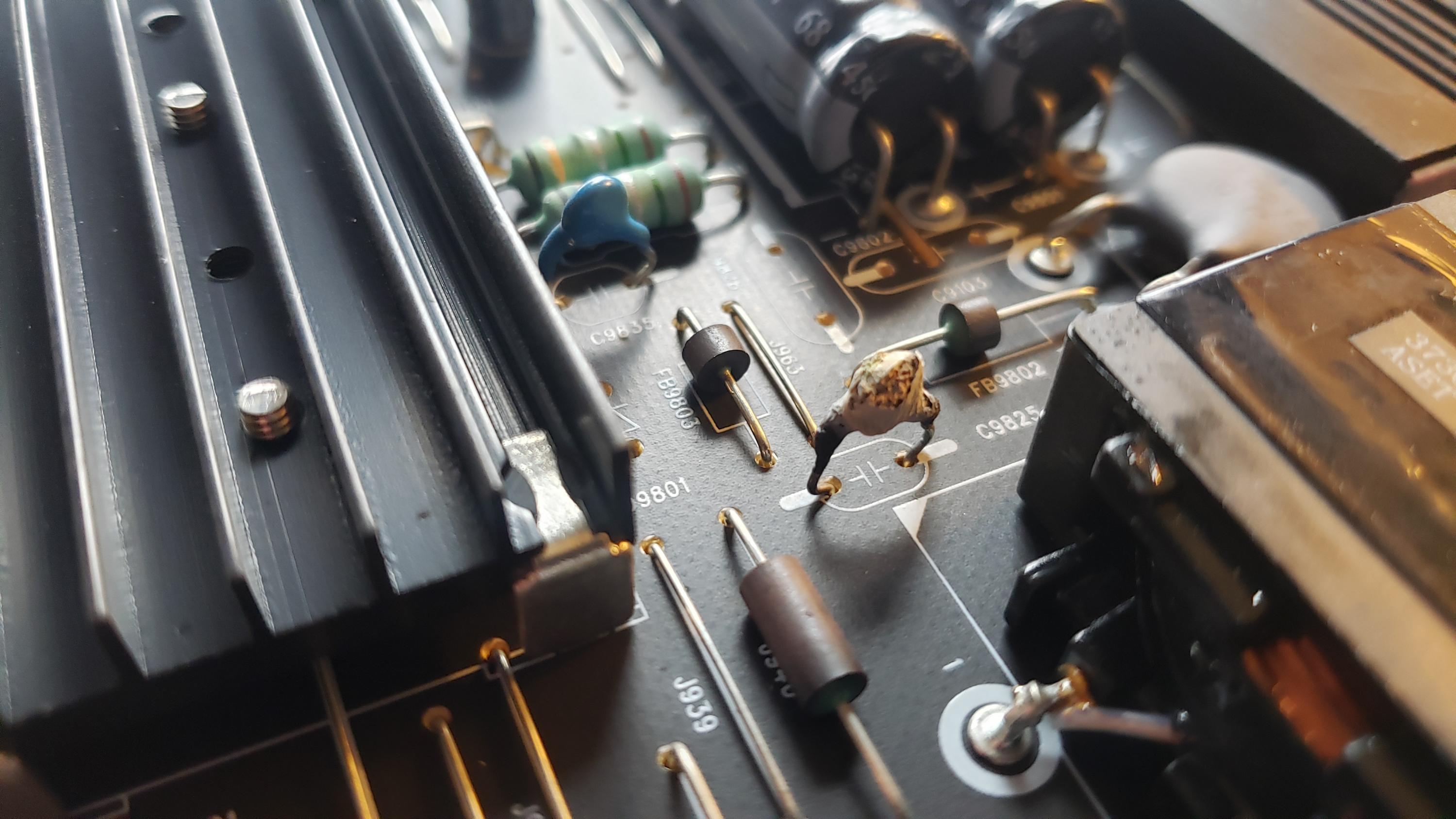

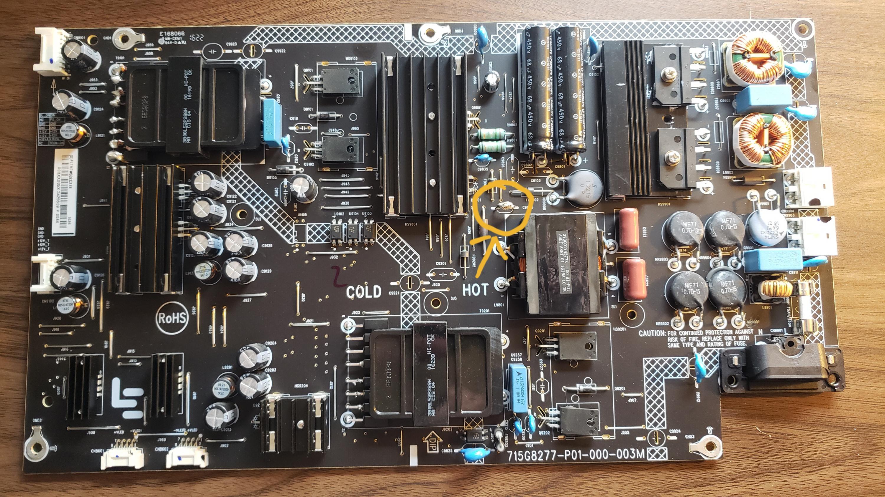

    LeEco X4-55 TV no picture but had sound.
    Hi Everyone,
    Recently I smelled something nasty after the picture on my TV went out. The sound somehow stayed though. I tore down the TV and found a burnt capacitor, and was wondering if this can be repaired? How would I go about figuring out what capacitor to replace it with? The closest capacitor above it reads: RR 101K 1kV 54
  • CapLeaker
    Leaking Member
    • Dec 2014
    • 8352
    Re: LeEco X4-55 TV no picture but had sound.
    Look at Digi-Key or mouser etc. they have 101k 1kv caps without an end. Just replace it.
