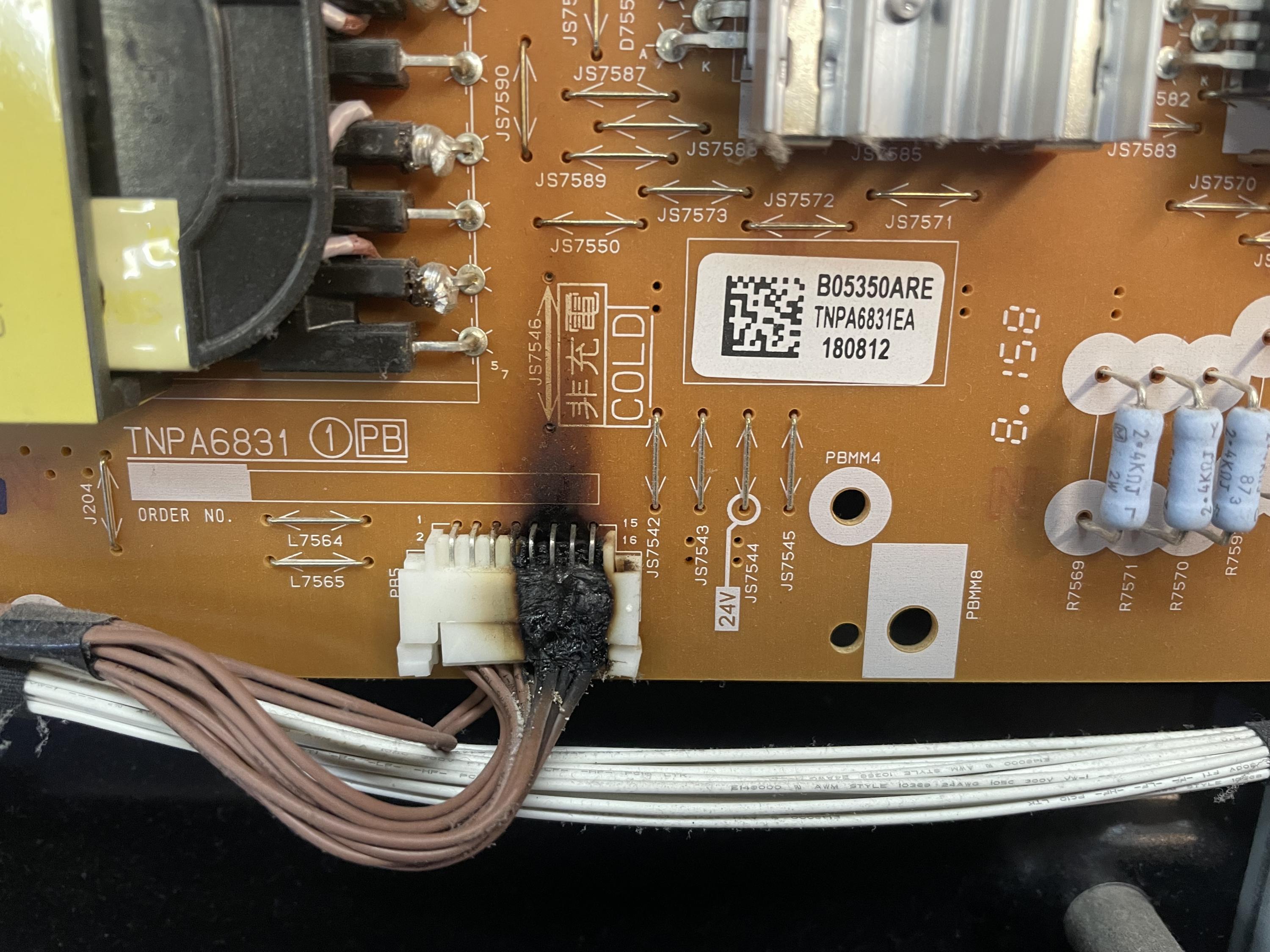

    Re: Panasonic Oled TX-65FZ800E, no picture, red led blinking every 4 sec
    Exact same problem here, and same solution
    • thetech_IV
      • Jan 2016
      • 2
      #42

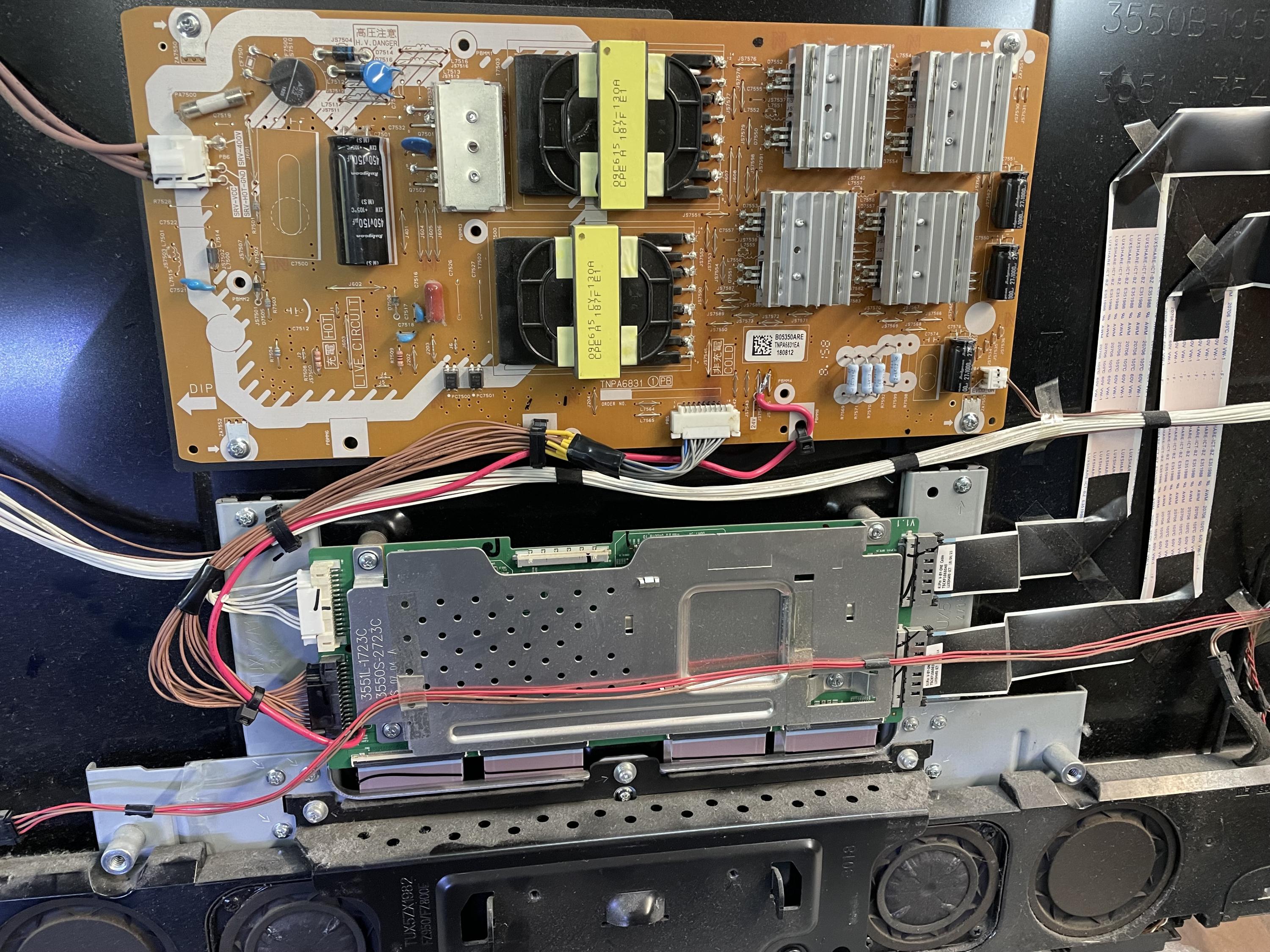

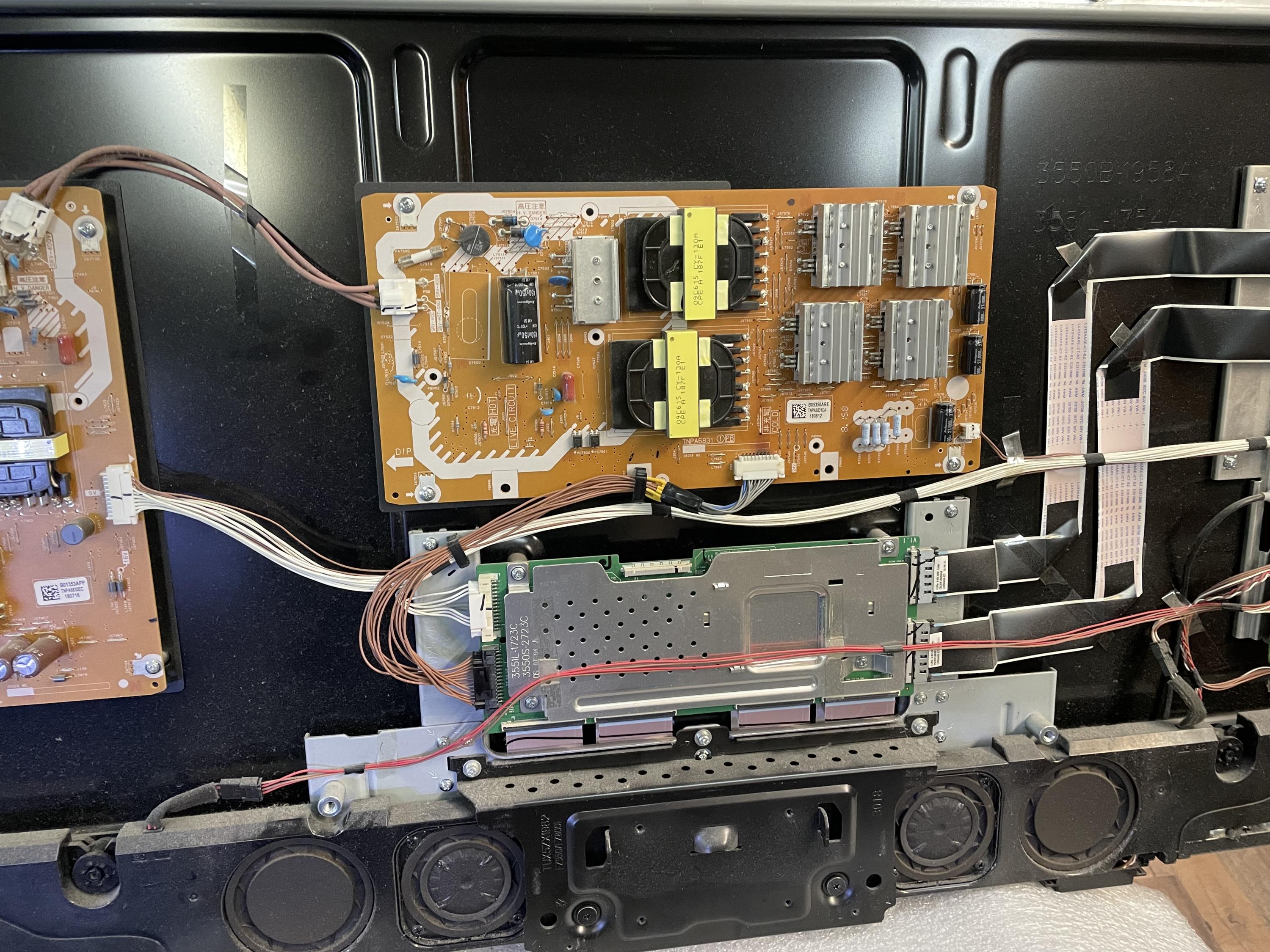

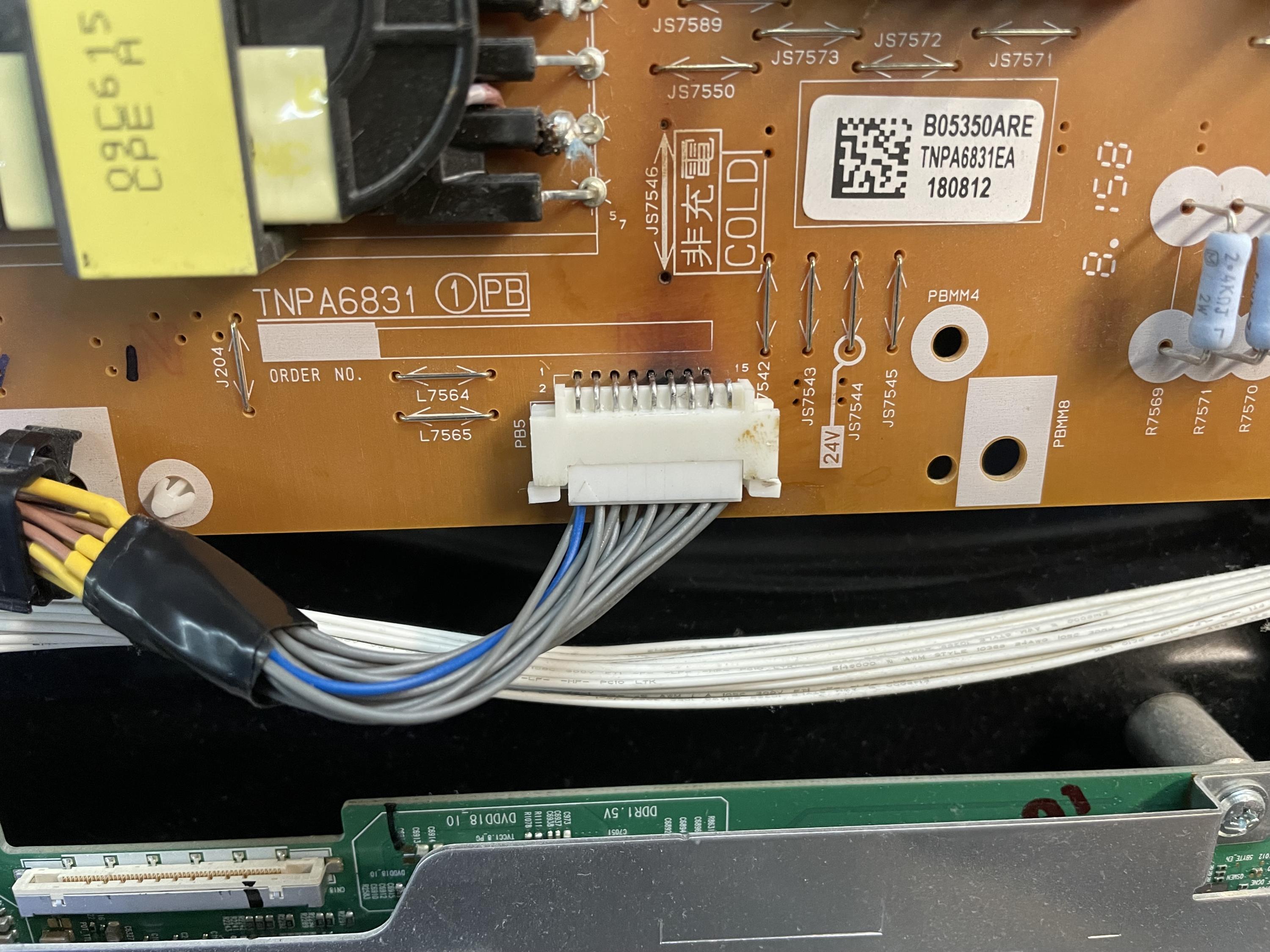

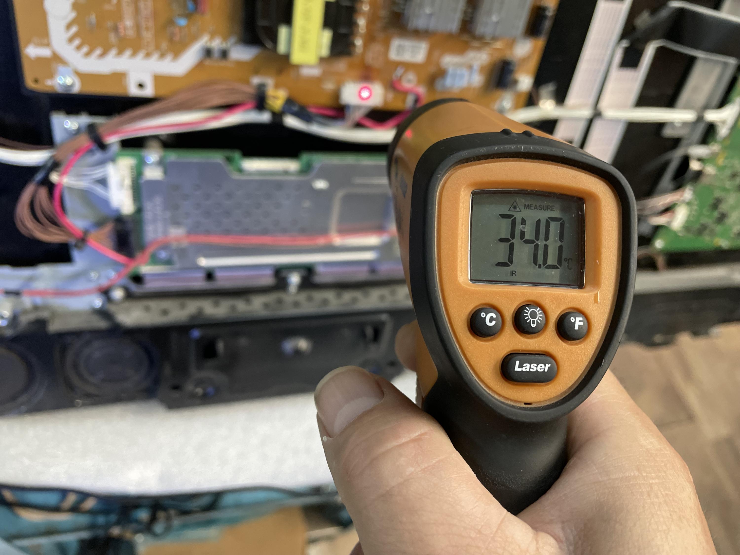

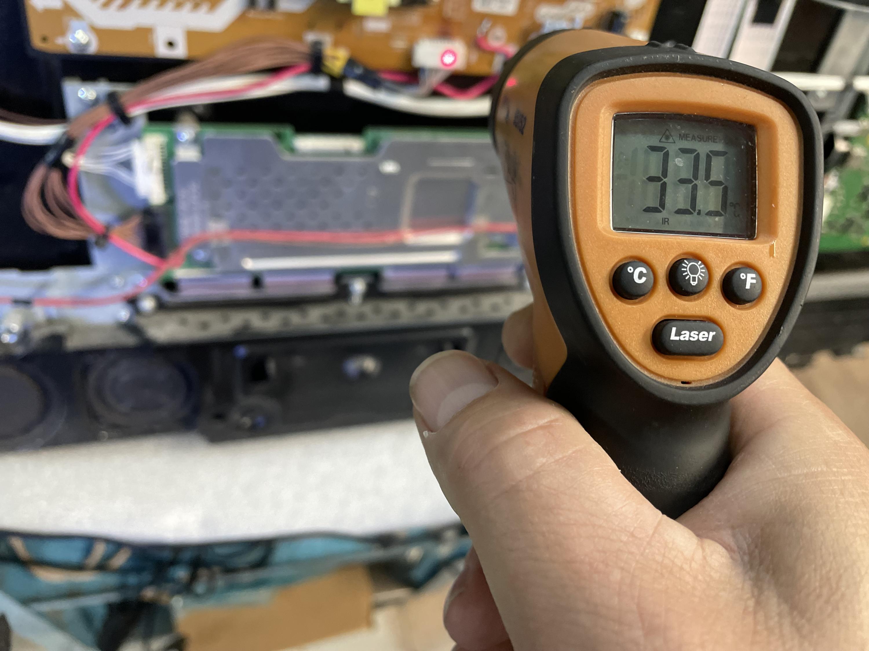

      The connector becomes very hot, more than 60 celcius, I had to pass a wire to remove the heat stress on the connector
        cheap socket material... good job
          So are improved sockets available. The bypass in post #42 looks interesting, can someone explain the procedure.

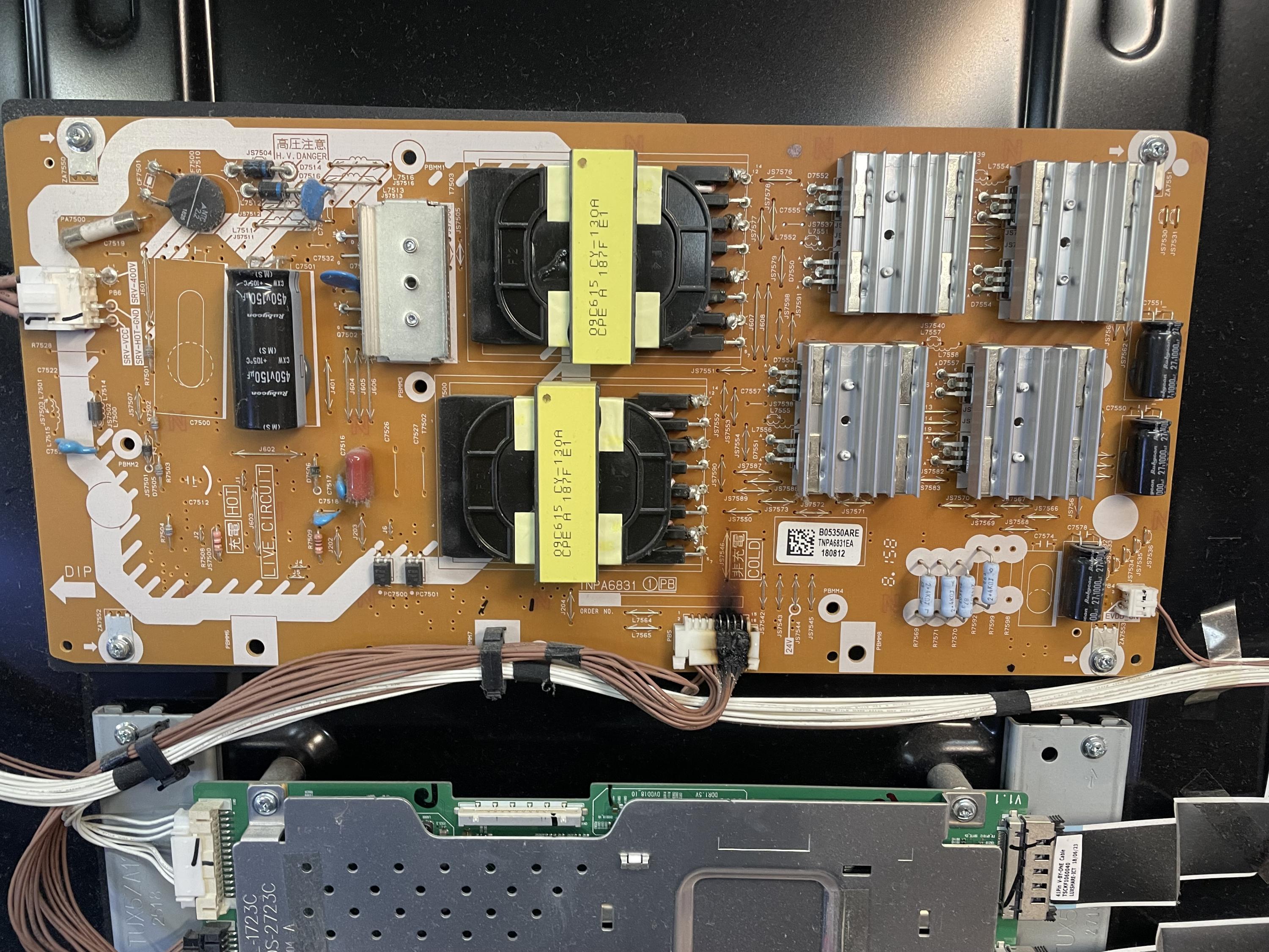

            he took thick wire and connect the +24V from boards to boards to reduce the load on the socket
              Thanks Diah.
