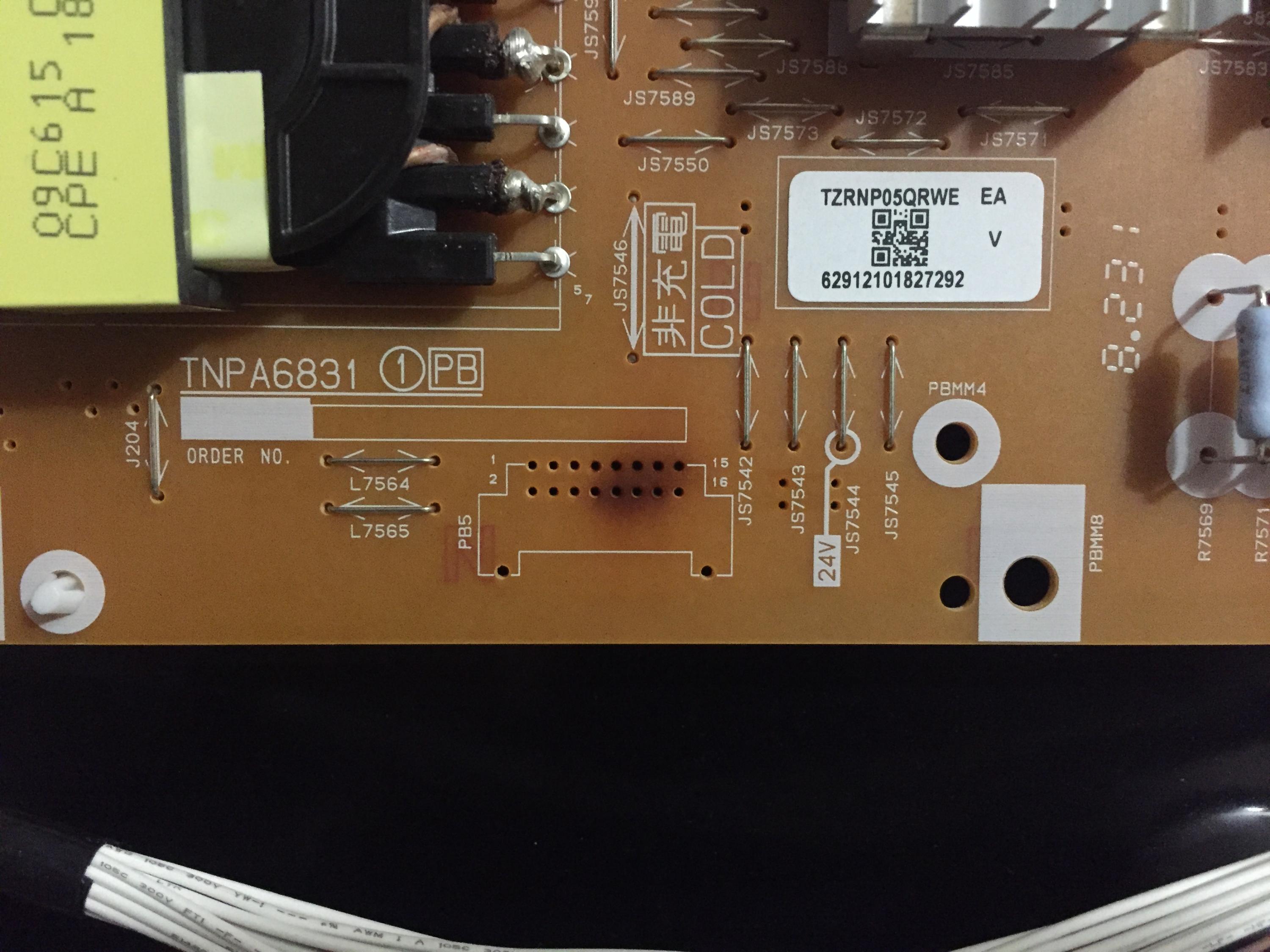

    Re: Panasonic Oled TX-65FZ800E, no picture, red led blinking every 4 sec
    Originally posted by lotas
    24v schematic
    thanks you lotas,,, if you have it why you make my eyes hurt lol
    so we have only + &- but we have 2 caps 27585 27587 1000p 50V on half way of +
    if one of these caps leaked then we should have F go out on seconderay and this is not the case..
    we need to take the socket out.. under any cost.

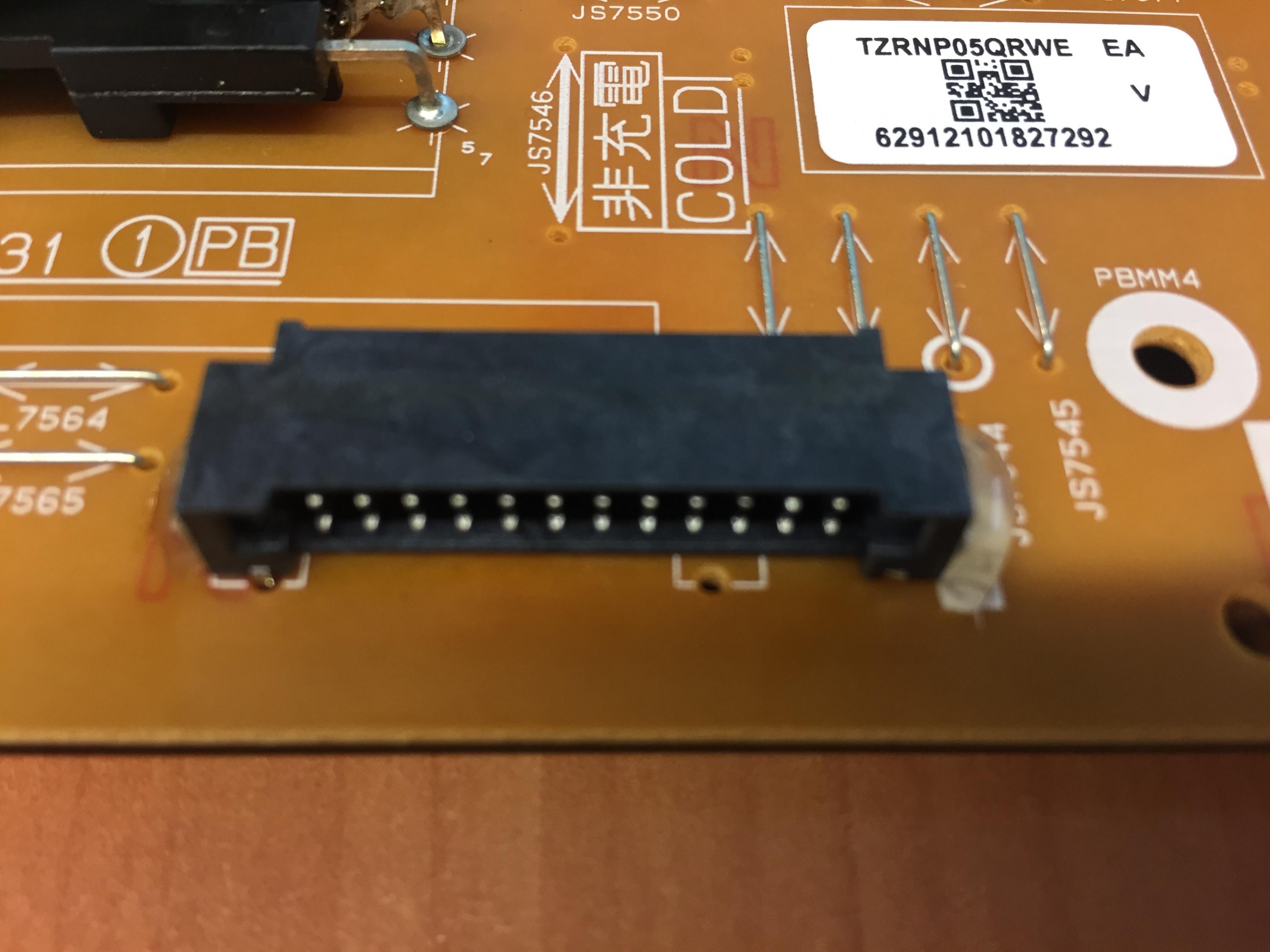

      lotas provide the right schematics and that is exactly what I just test with my multi meter.

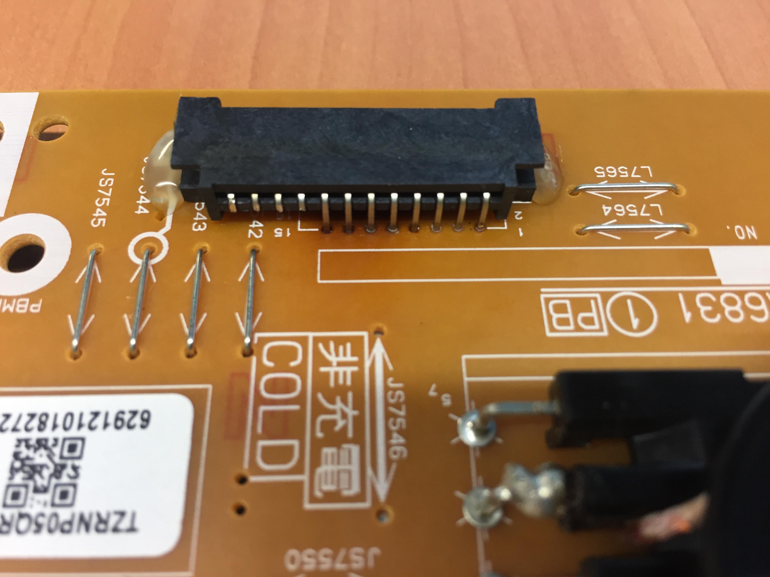

        OK I will remove the socket tomorrow at work, I have all the requested stuff.
        Do you have a socket reference then I could by one on Farnell or RS web site and replace it by a new one.
          we have risk at the socket PIN 7 (-) & 8 (+), they are up and down same level
          you need to plug the socket out under any cost.. its not hard work at all.
          edit... we can run the tv with out socket.... when the fault clear you can diy it as you like later
            its size and the shape of it and pin amounts.. on lg could be find at power borads too

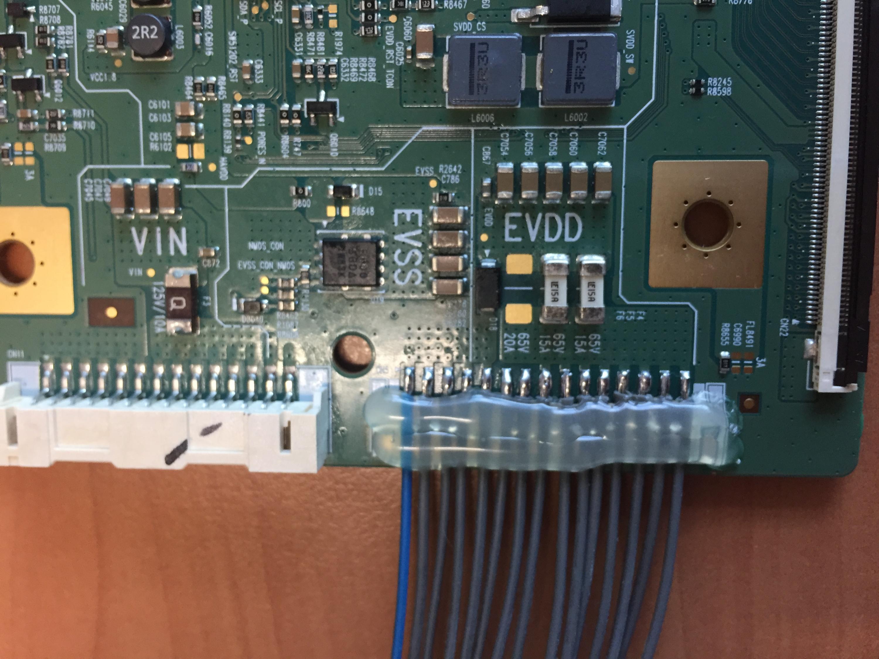

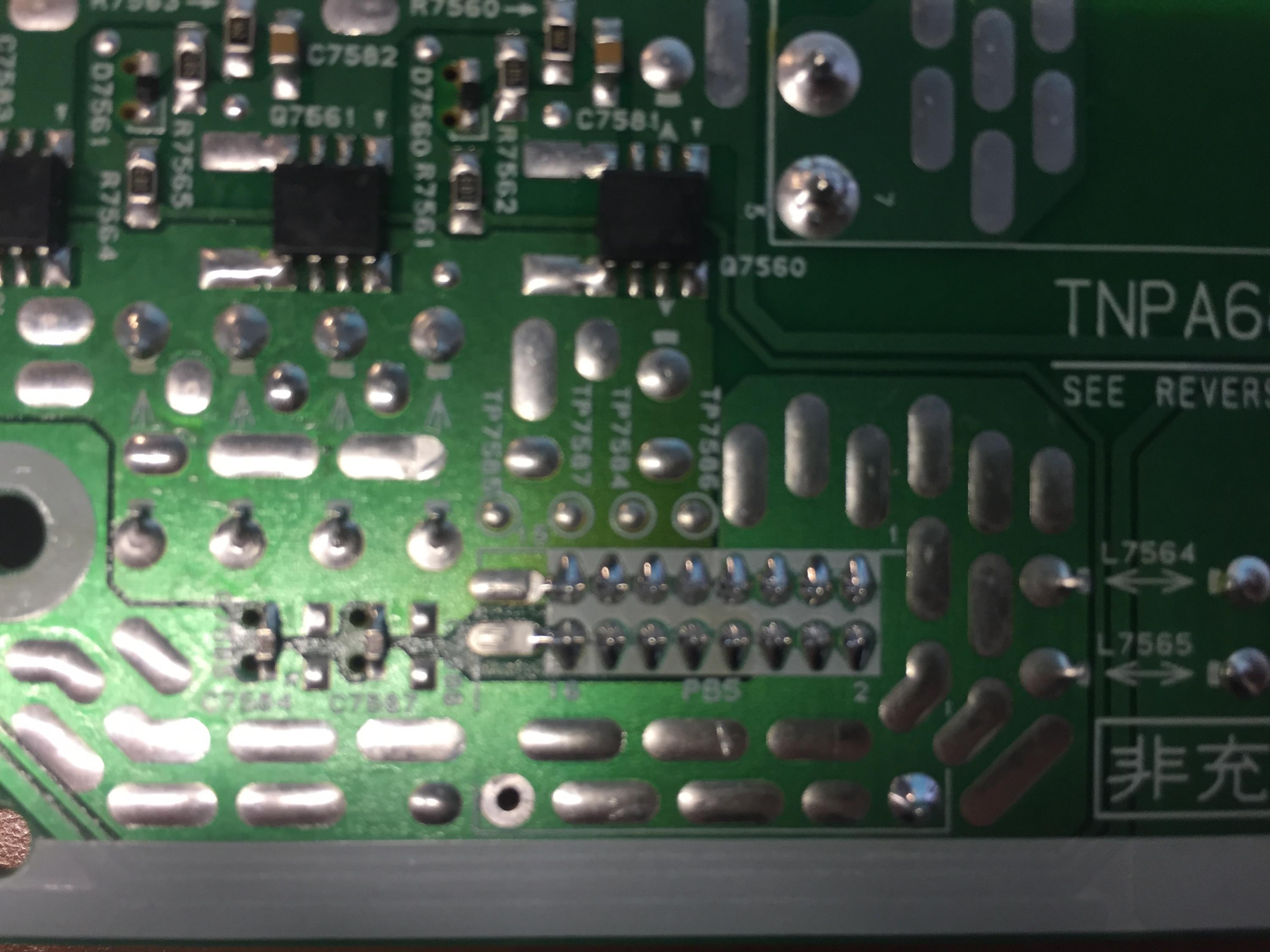

                  I removed the burned connector and plug the board again.
                  I plug video and audio on HDMI1, switch on the TV but no sound.
                  The 12V(SVDD) is switch off after 1 sec, even if I push the standby button.

                      #30
                      OK I will solder wires directly from EVDD inverter board to T-CON board tomorrow to get good connections. I will go back to sockets later.

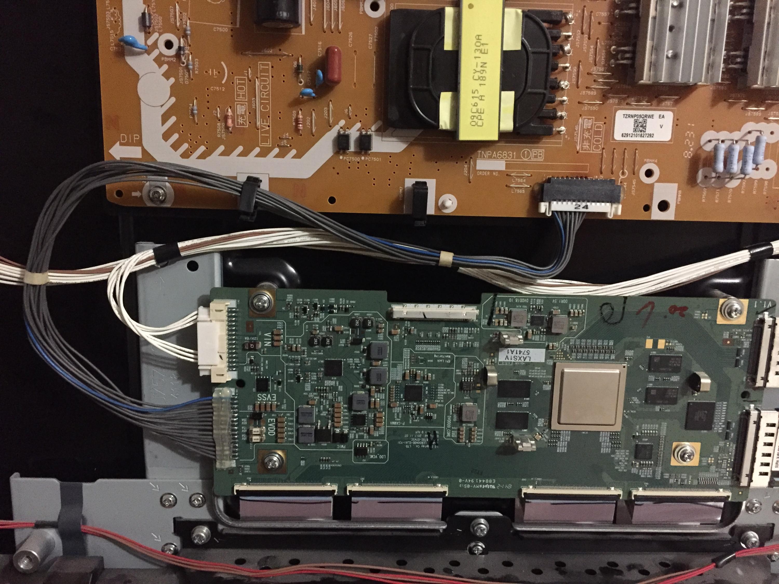

                                    #37
                                    I solder a new connector on the inverter board, the new one is a bit too big but after removing some pins to let only the 15 required, it fit well.
                                    I remove the connector on the T-CON board.
                                    I get a 24 wires cable from an old LG TV I had, exactly the same wires 24AWG, 105C, 300V.
                                    I solder the wires on the T-CON board.
                                    When checking the old cable wires, I discover that three 24V wires where cut. That means, 5 wires over 8 left for the global 24V power.
                                    I made a test with a video on HDMI1 and all is working well. I checked the temperature of wires and after 10 minutes, they are warm (about 30 degres) and the main T-CON component about 50degre without the metalic plate.
