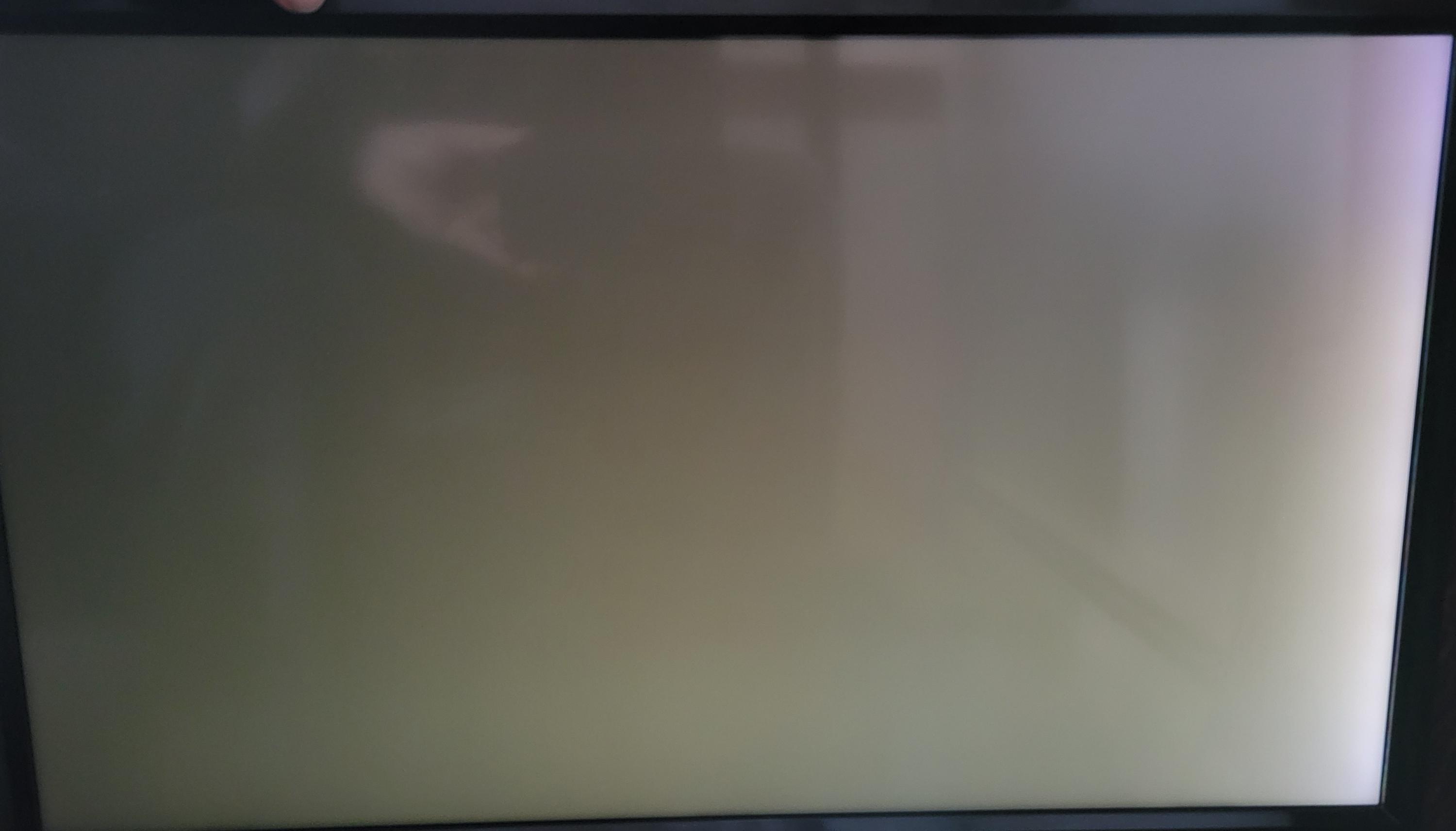

    Hi to all.
    Just picked up 5 of these Samsung TV's model LT24e310nd/ZA ' They all have the same issues. Screen has bright white strip on the right side and rest of the screen has a yellowish hase.
    Tried reset to factory defaults.Different power supply. Same issues.
    Please help. Thanks in advance.

    Try a firmware update on one of them, see if it helps any, these seem to be led lit tv/monitors.

          Re: Samsung TV LT24e310nd/ZA backlight bleed or Bad CFL??
          Perform the Picture Test and to see if your TV is displaying the test image properly.
          Go to MENU - Support - Self Diagnosis - Picture Test
          If the test image is properly displayed, the poor picture may be caused by the source or signal.

              Try a different source, like antenna, dvd player, cable pc or different pc, etc, to make sure it's not just having trouble with the source.
                Are these edge lit?
                  Didn't see anything describing the backlight array, I'm guessing it's not edge lit because it's over 2 inches thick??
                    I think I would pull panel and have a look at backlights. It's a small monitor, so shouldn't be to difficult.
