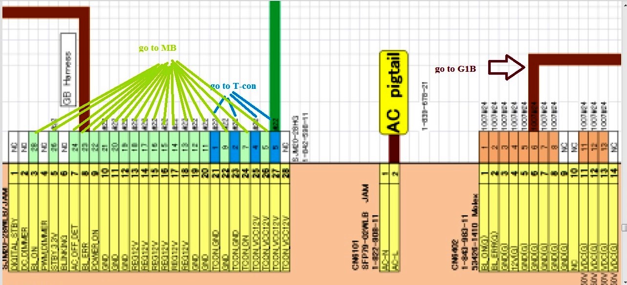

                        #291
                        Re: Sony xbr65x900c sound yes, no backlight or image.
                        i jumped 5 stby with 9 power on and 24 tcon on, got 3.4v at tcon on pin.
                        • Diah
                          • Feb 2013
                          • 6573
                          #292
                          look on attached... did you have problem with reading service manual ??
                          1- you need to jumper power on with STB same time you jumper STB to T-con_on
                          then you should have
                          pin 13,14,15,16,17,18 12V REG 12
                          pin 25,26,27,28 12V tcon_12V
                          • nomoresonys
                            • Jan 2013
                            • 12330
                            • U.S.
                            #293
                            had bad connection first time, all the v12s are there now.
                            • Diah
                              • Feb 2013
                              • 6573
                              #294
                              yours PCB working... so they didnt sell to you defective one..
                              remove all jumpers either the one you make me crazy about the grounded BL_error and connect all sockets in place to turn on... tell what you see and what voltage you read just now you said ( all 12s are there now )
