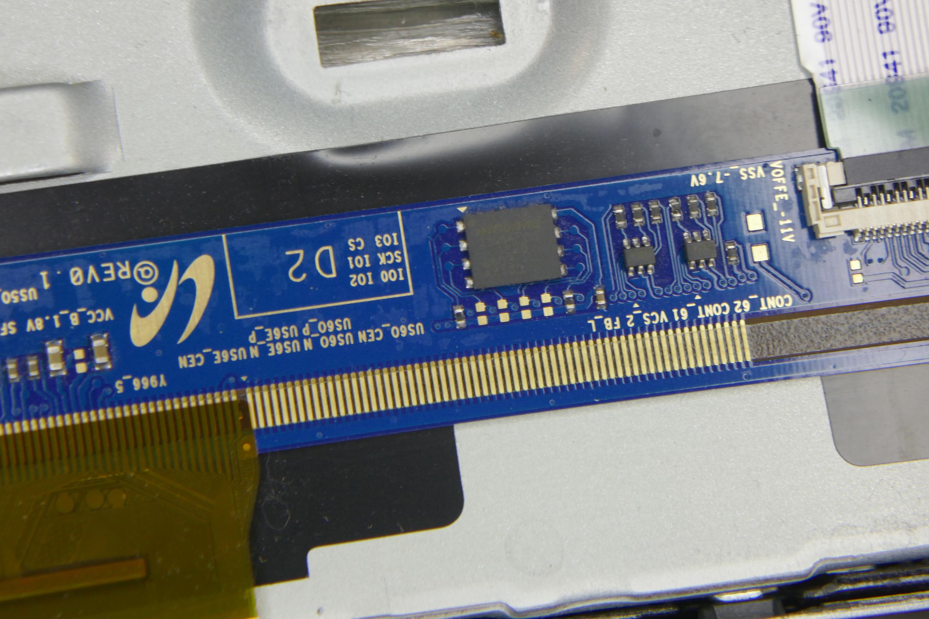

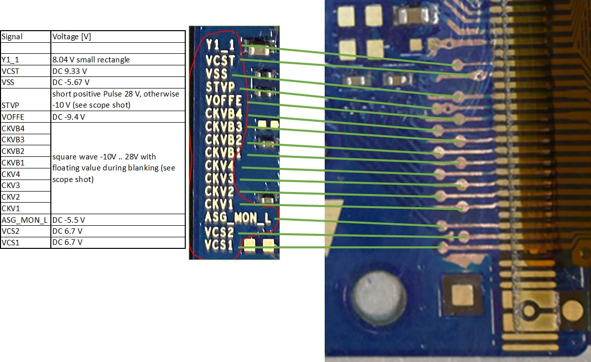

      On the UE49KS7090 I am really confused. I have tried to block signals 12-22 (all CLK and CLKB) either on left or on right side with tape, but always get the same image now (see attached image).
      That method seems to work for other people, what is wrong on my side ?

        Re: Samsung UE55KS7000 and UE49KS7090 main board protection mechanism

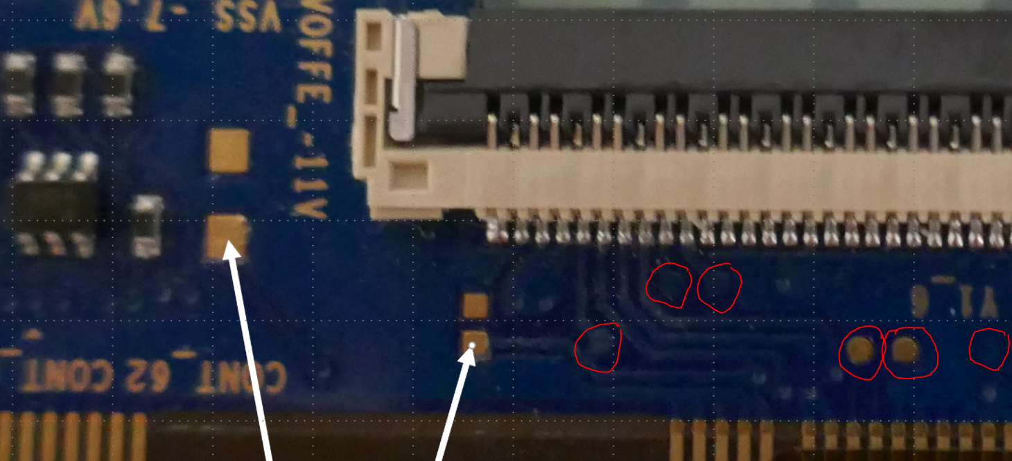

        I took now a bunch of measurements on those test points. Looks to me as if I do not have the same problem, since those measurements at least seem to be OK.
        Can the experts please look at this ? Do I have a completely different problem ?
          Actually I just realized something: Since CKVx, CKVBx and STVP range from ~-10 .. 28 V, and there is a VOFFE with -9.4 V, should there not be somewhere VON / VGH with ~28 V ?
          But what would be the label for this voltage ?

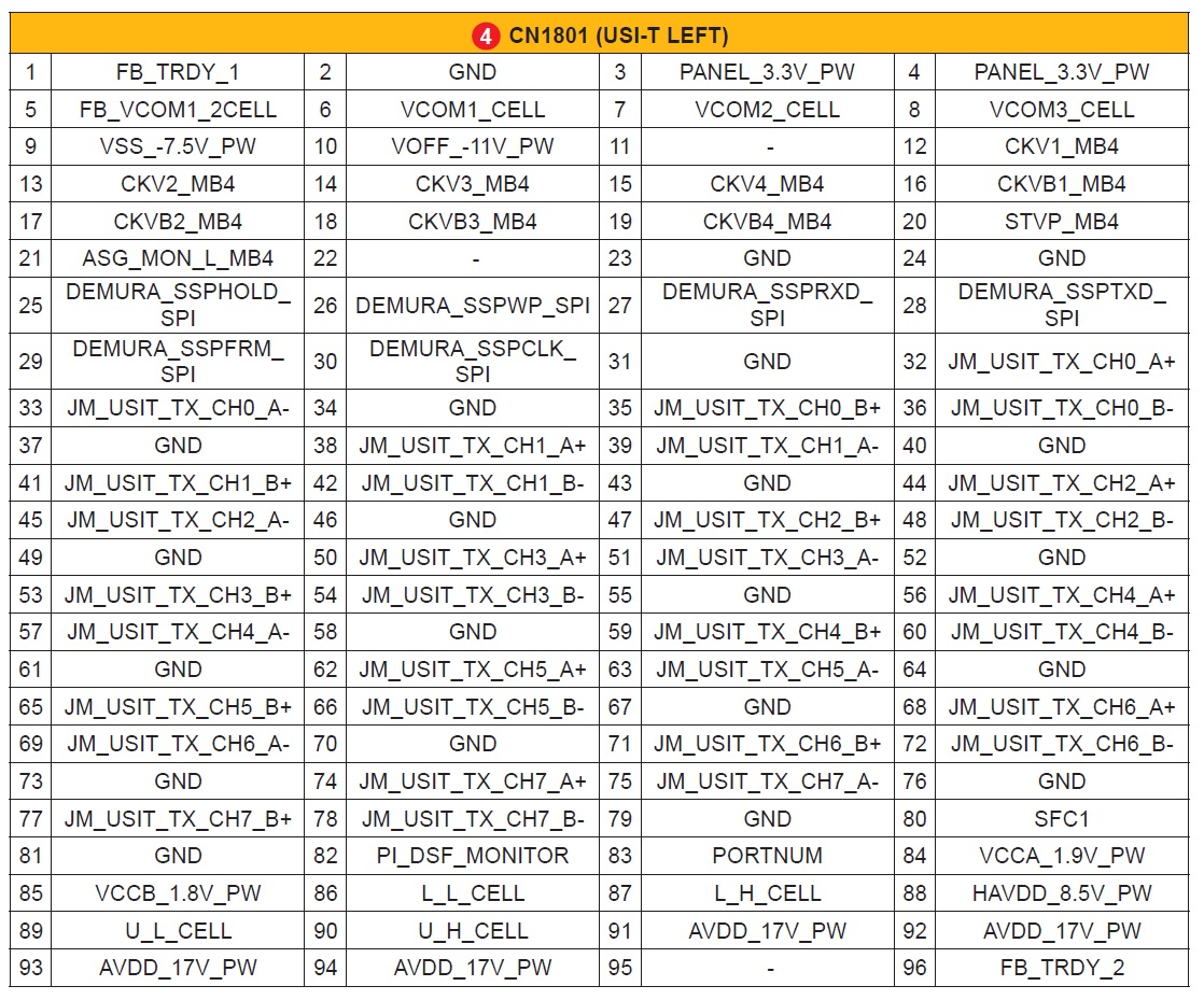

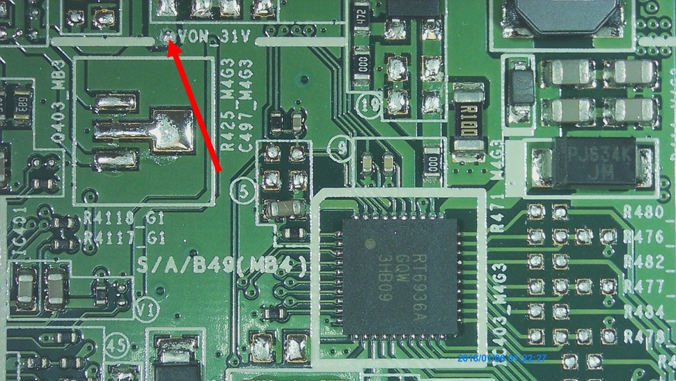

              On the main board there is a VON test point and I do read 0 V, so there is a problem.
              However I cannot see, how VON goes to the panel. In the pinouts from the Service Manual it does not list VON.
              Also the circuitry on the main board uses two ICs from Richtek RT6936A and RT6935B and I cannot find datasheets or pinouts anywhere. I would assume, that that voltage is 0 due to some protection circuit ? Since all other voltages seem to be correct and also CKVx, CKVBx and STVP have the right high voltage, I doubt that the voltage regulator actually does not work.
              Does that make sense ?

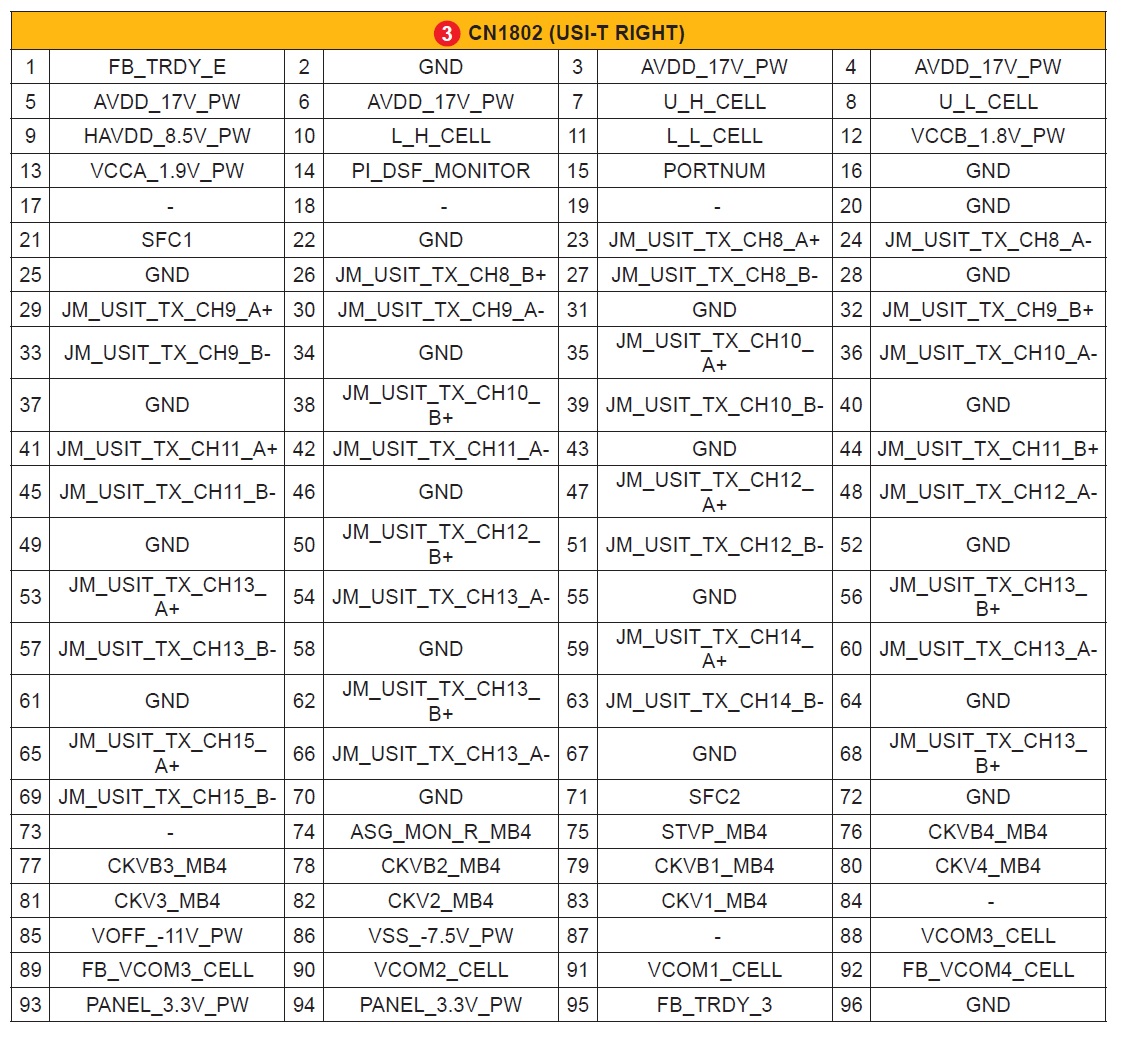

                        The second question for me is, where is the VON voltage on those connectors ? As far as I believe to understand the functionality, VON and VOFFE must be present at the gate drivers, which are integrated into that generation of panels, but what label is used for VON ?

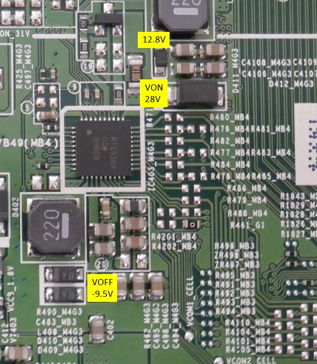

                                #35
                                Debugging the 49 inch TV I am completely confused now. According to all I have found on the Internet the panel should receive VON / VOFF or VGH / VGL for the gate drivers (see attached block diagram).
                                On the main board I measured those voltages, please see the picture.
                                I can also measure VOFF on the panel test points and the connector to the panel. However I cannot measure the 28 V anywhere. How could that ever work ?

                                        #39

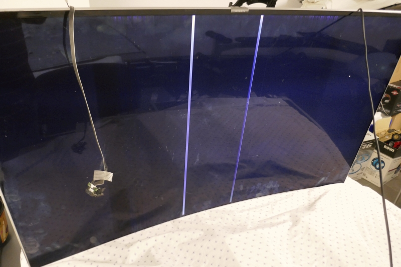

                                        [QUOTE=kevinallein;...However I cannot measure the 28 V anywhere. How could that ever work ?[/QUOTE]
                                        When here 28V, on screen the vertical strips.
                                        When here 32V, on screen is normal picture.
                                        Ballon with Freezer can help you to locate the damage.
