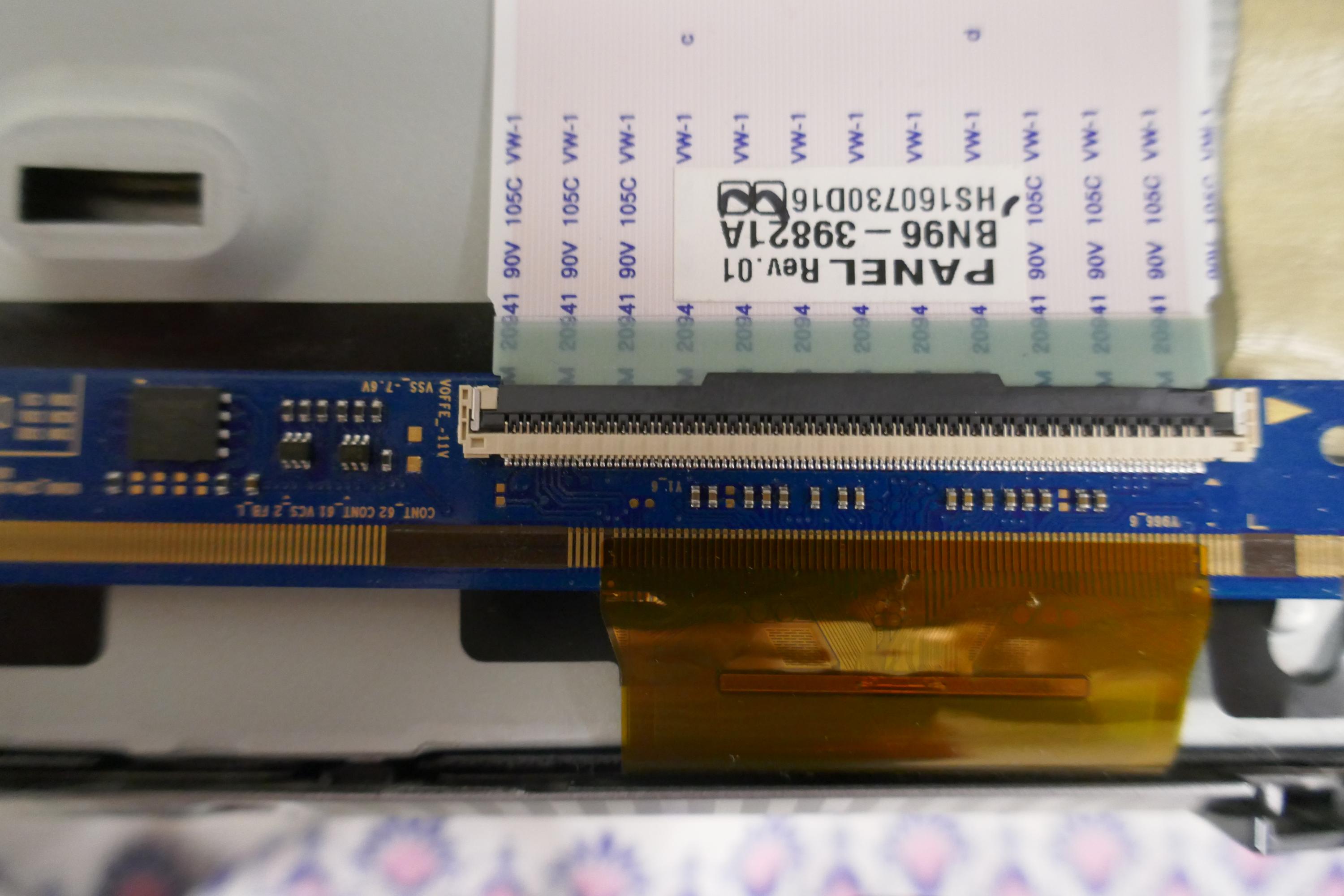

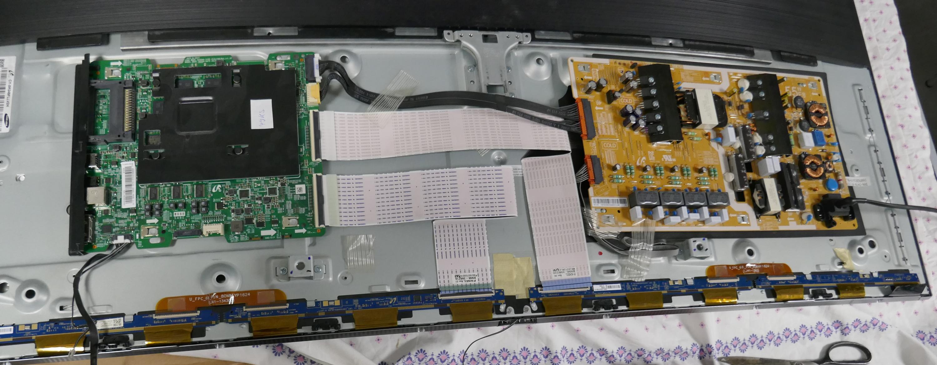

          Re: Samsung TV main board protection mechanism
          Here is a picture of the UE49KS7090.
          - With all cables connected it starts with bad picture.
          - If I disconnect any of the Flex cables, either the ones from the main board to left or right or the connecting cables between the two subassemblies in left or right the TV will not start. I am missing the negative voltages VOFF, so I wanted to check, whether the problem is on the left or right side.
          Funny enough, on the UE55KS7000, which uses the same main board, the leftmost subassembly is disconnected and the TV works with 3/4 of the screen fine.
          I am trying to find out the pinning, however I struggle to associate the signal labels with the test points. Please see pics attached.
          In the Net I have found a service manual for the KU series, but it seems the pinning between main board and panel is different from the KS series.
          Any hints ?

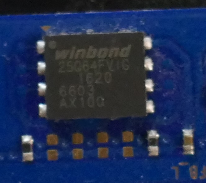

                The only chip on that panel assembly is a 3V 64M-BIT SERIAL FLASH MEMORY WITH
                DUAL/QUAD SPI & QPI
                    DUAL/QUAD SPI & QPI
                    the lable of it ?... this one which SPI and I/O which comunicated with CPU

                      Re: Samsung UE55KS7000 and UE49KS7090 main board protection mechanism
                      Here is the picture of the SPI Flash

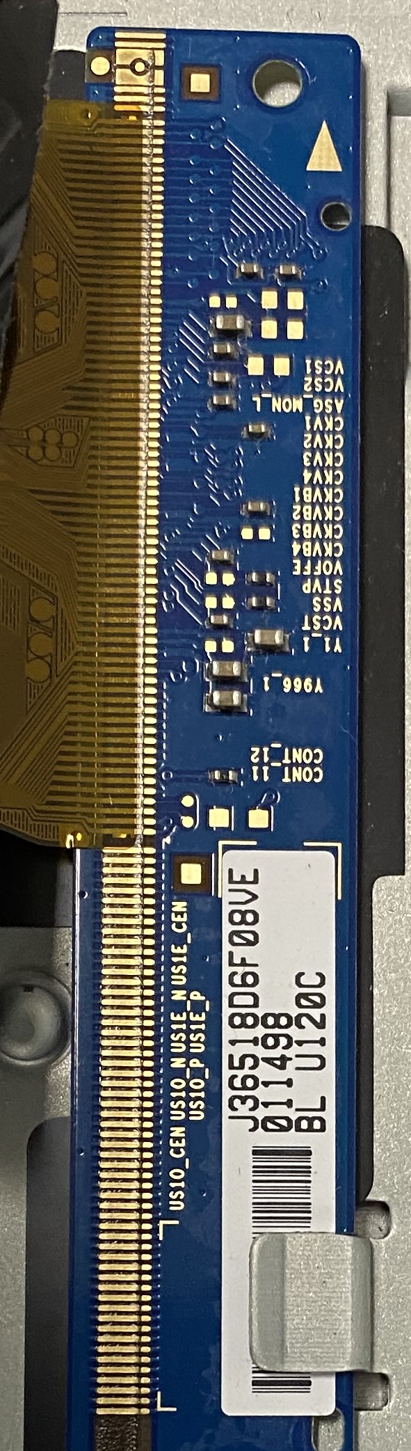

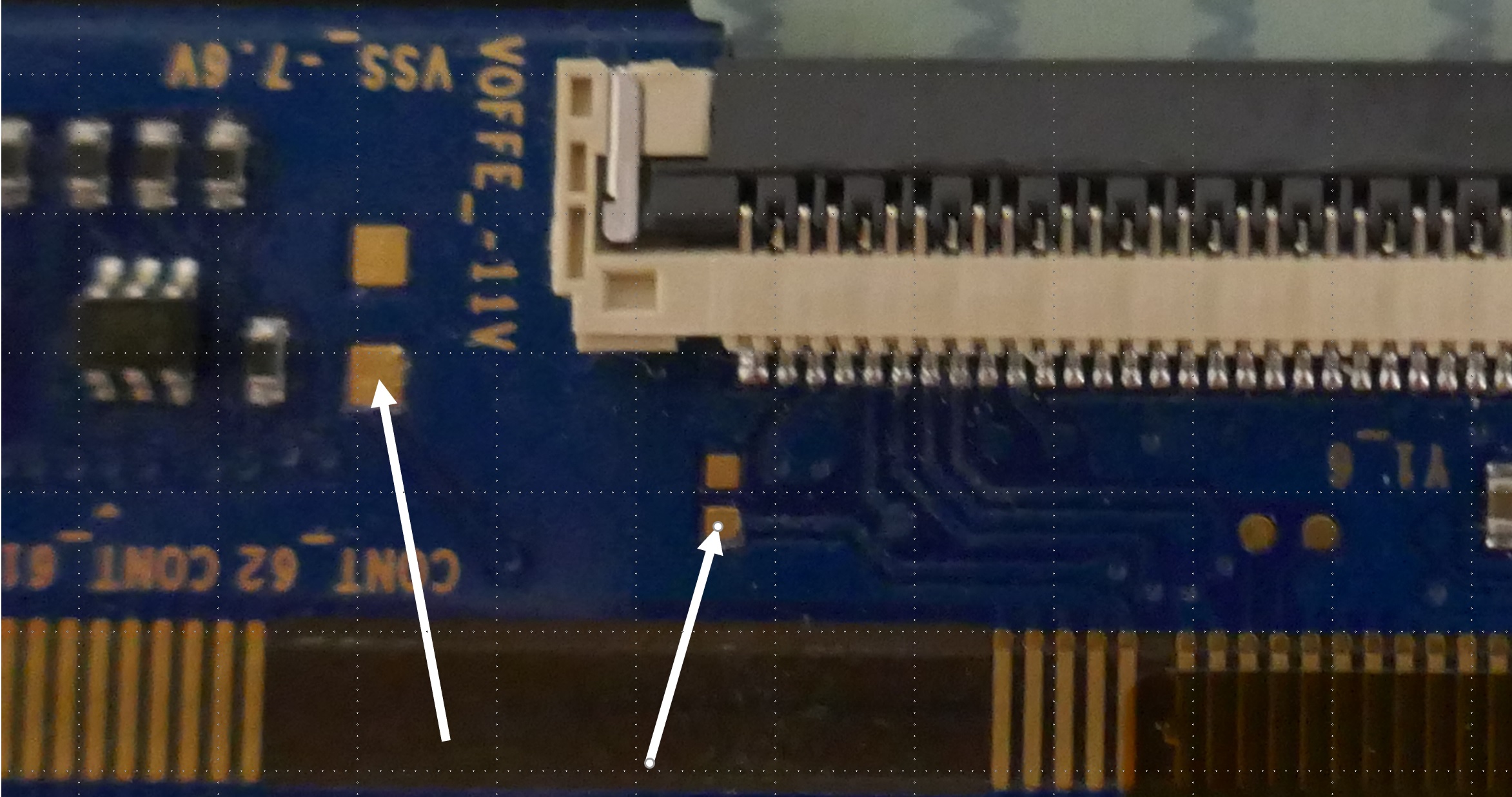

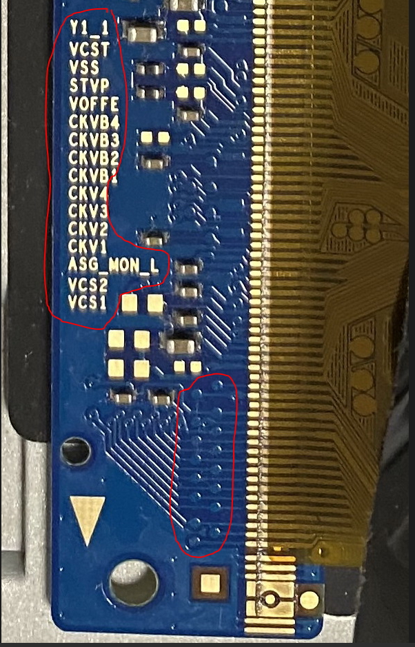

                                Can someone please help ? On the scalar board of the panel I see those two labels "VOFFE_-11V" and "VSS_-7.6V" and I thought, those could be observed on the two test points I marked with a white arrow.
                                However I found out, that those two test point connect to "VCOM2_CELL" and "VCOM3_CELL".
                                So where can I see the negative voltages ?
                                • lotas
                                  • Jan 2016
                                  • 4899
                                  • Russia

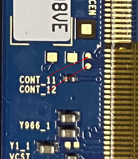

                                  Control points are usually marked with round heels, like this:
                                  • kevinallein
                                    • Dec 2010
                                    • 32
                                    But where would those test points in this pic be then ?
                                    • lotas
                                      • Jan 2016
                                      • 4899
                                      • Russia
                                      They can be disguised as here:
                                      • kevinallein
                                        • Dec 2010
                                        • 32
                                        So I need to scratch off the protection paint before ?
