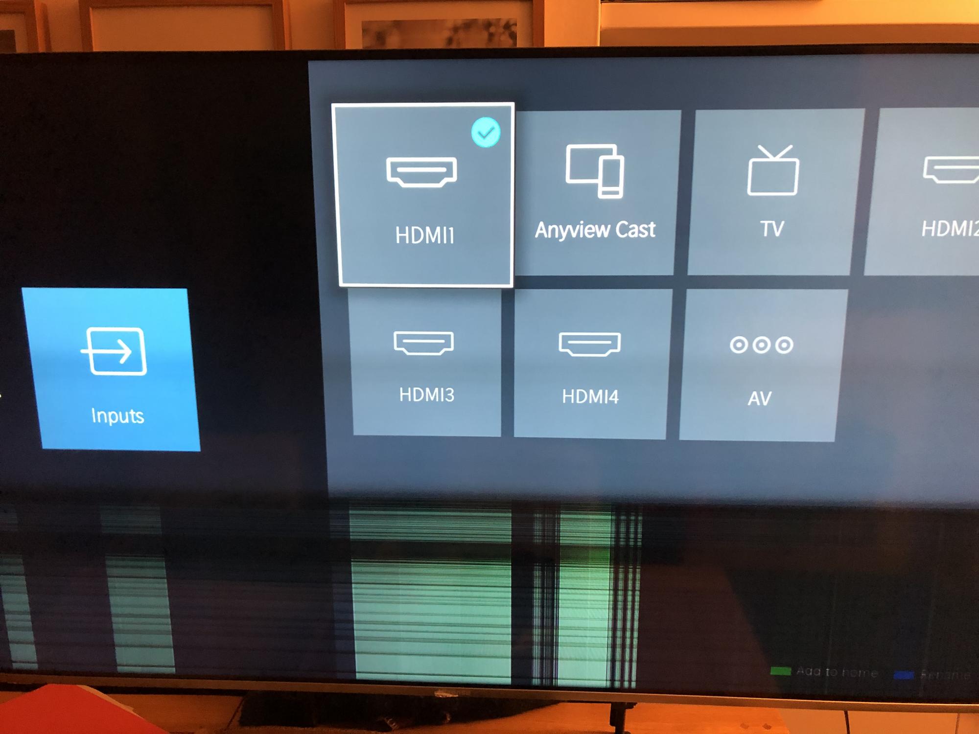

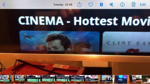

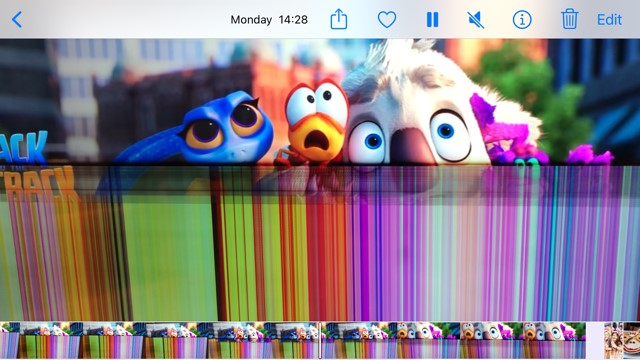

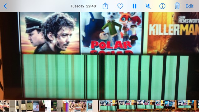

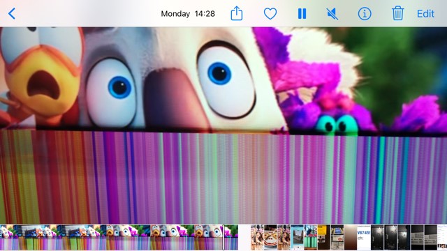

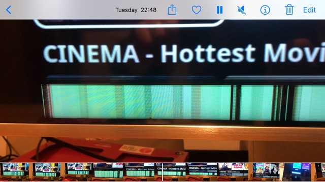

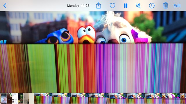

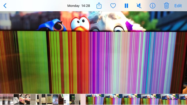

    I have a Hisense 55" H55U7BUK television which has a very strange issue. When you first turn it on the the Hisense logo page appears as expected, then an image appears with the top 25% of the screen displaying correctly and the remaining 75% as if the T-Con is faulty (i.e. it has vertical lines). The screen then starts to recover the missing 75% line by line, taking a minute or so, until you end up with a great picture (please see attached photos). FYI - I've tried replacing the T-Con board but get the same results.
    Has anyone seen this type of issue before?

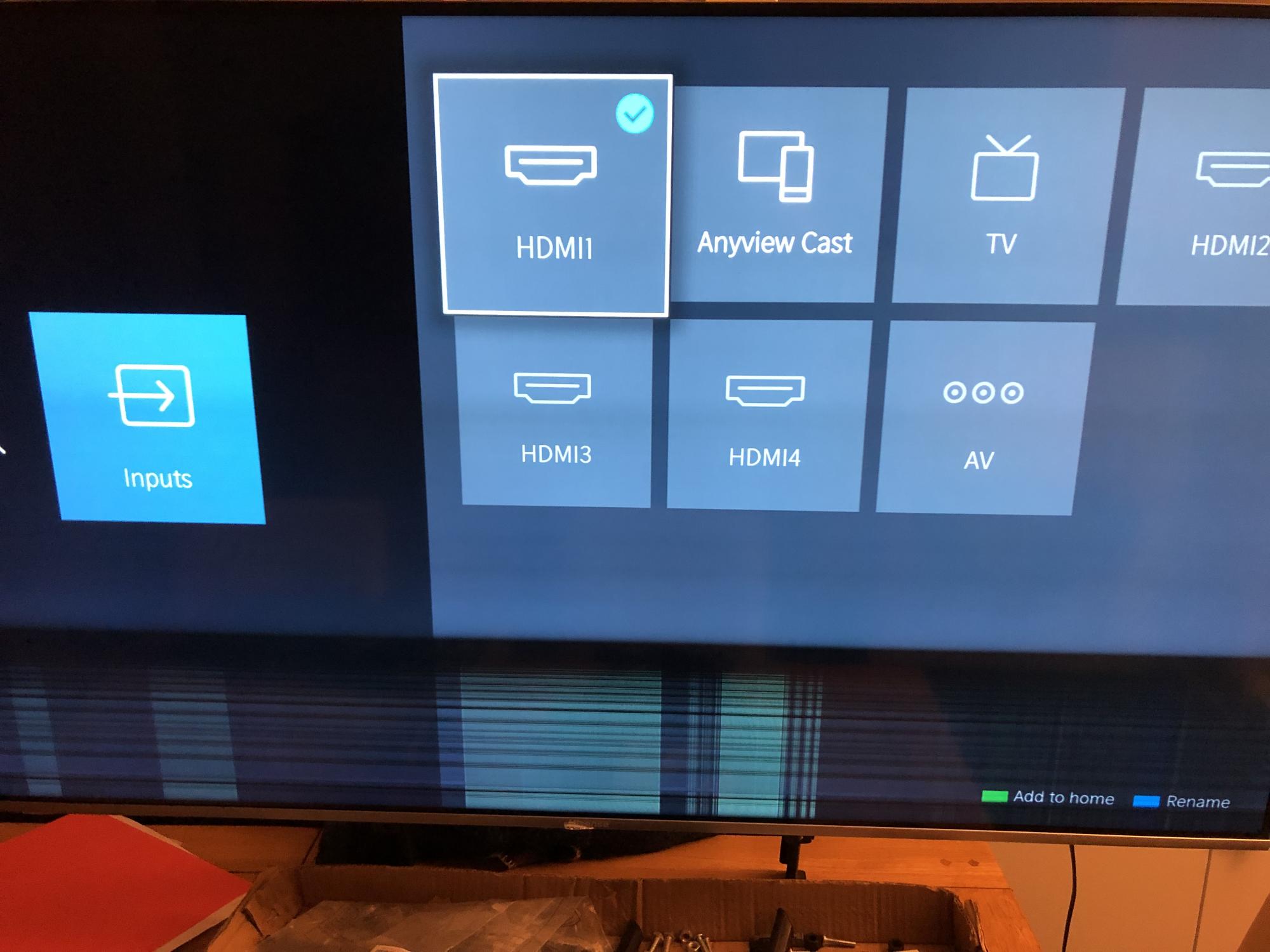

    Re: Hisense H55U7BUK - slow to load image
    What does the OSD look like?
    • djmka
      • Aug 2021
      • 35
      • England
      It appears the same way (please see attached picture).
        Looks like panel problem.

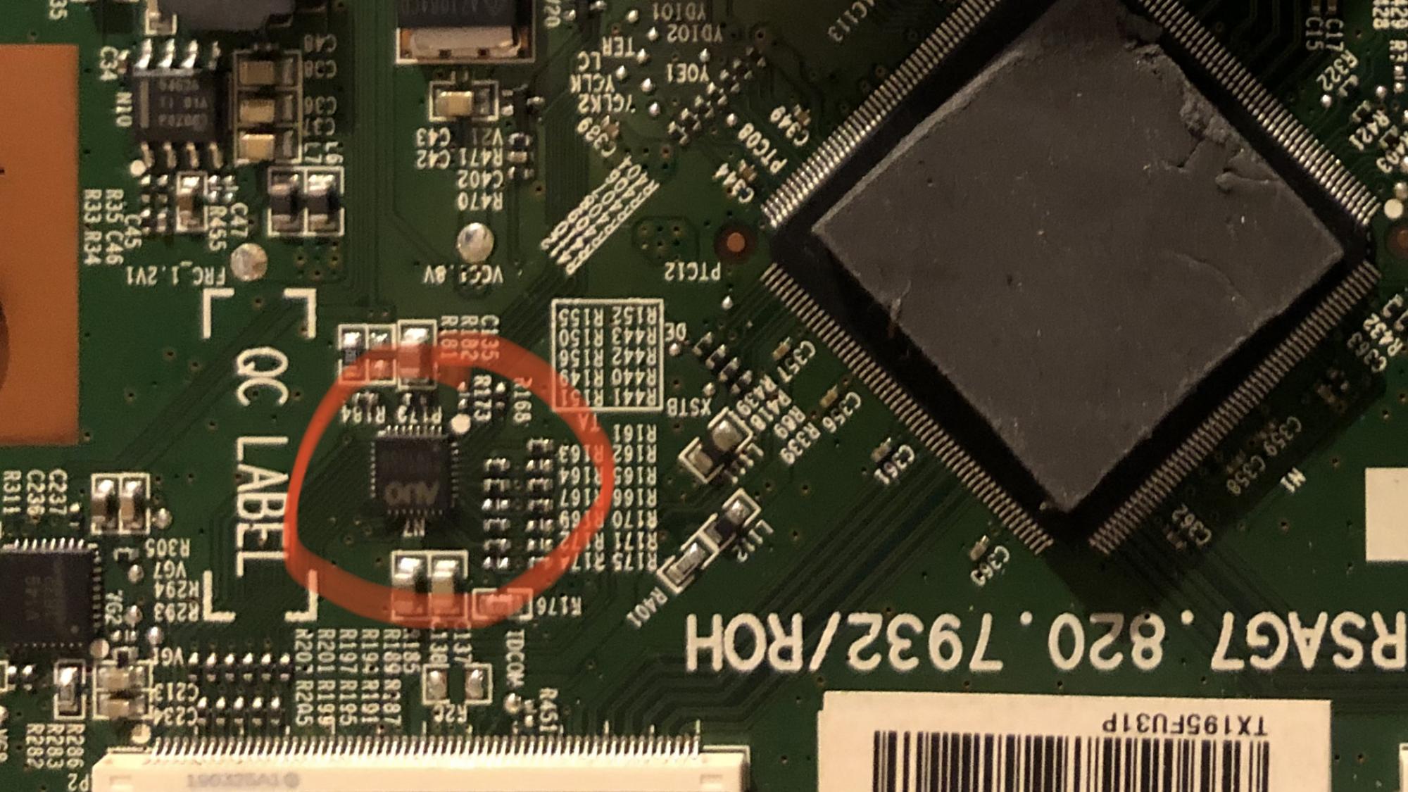

                    my doubt and clue is very faint... taken in to consideration that electrolitics faults are much less common nowadays, but in the small case that a bunch of brands suffers still today of that, an electrolitic that works bad at cold and it works at the same frequency of the vertical of the screen, typically 50/100hz, can shorten the lenght of the disturbance until disappears.. but since the only part affected is the images i had guess it is on the tcon.. can you favourite the photo?

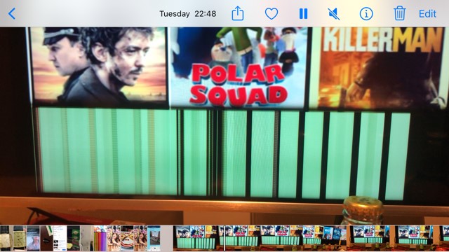

                        Thanks you to everyone who has responded so far. I have realised that I should have told you the history of the television first (apologies for not having done so). I bought is as a non-working device. It powered up but showed coloured vertical lines on the screen, some thin, some wide. I know this issue was related to the T-CON so I decided to identify which pins of the LVDS cable were causing the issue. Through a process of trial and error, I masked off some pins and the screen started working properly, albeit with the slow start up issue. Next, I checked the part number of the T-CON only to discover it wasn't the correct one. I ordered a replacement, (funnily enough it was from the supplier that lotas suggested) and when it arrived I installed it without masking off any pins. I got the same vertical lines as before. When I masked off the 4 or so pins, the screen started working (again, albeit with the slow start up).
                        Using either of the T-CONs and the tape, the televison's display is fine once it's been on on for a minute or so. If I power it off and on again the display is perfect immediately. This makes me think that something is taking its time to "warm up" but once it's warm it operates as expected.
                        Could it be a voltage issue on the power supply?
                          do this test, at cold tv, warm up the AUO chip N7 with the soldering iron, then turn tv on an tell me..
                                  Message for Davi.p - when you say heat up the AUO chip N7 - how long should I leave the soldering iron on it?
