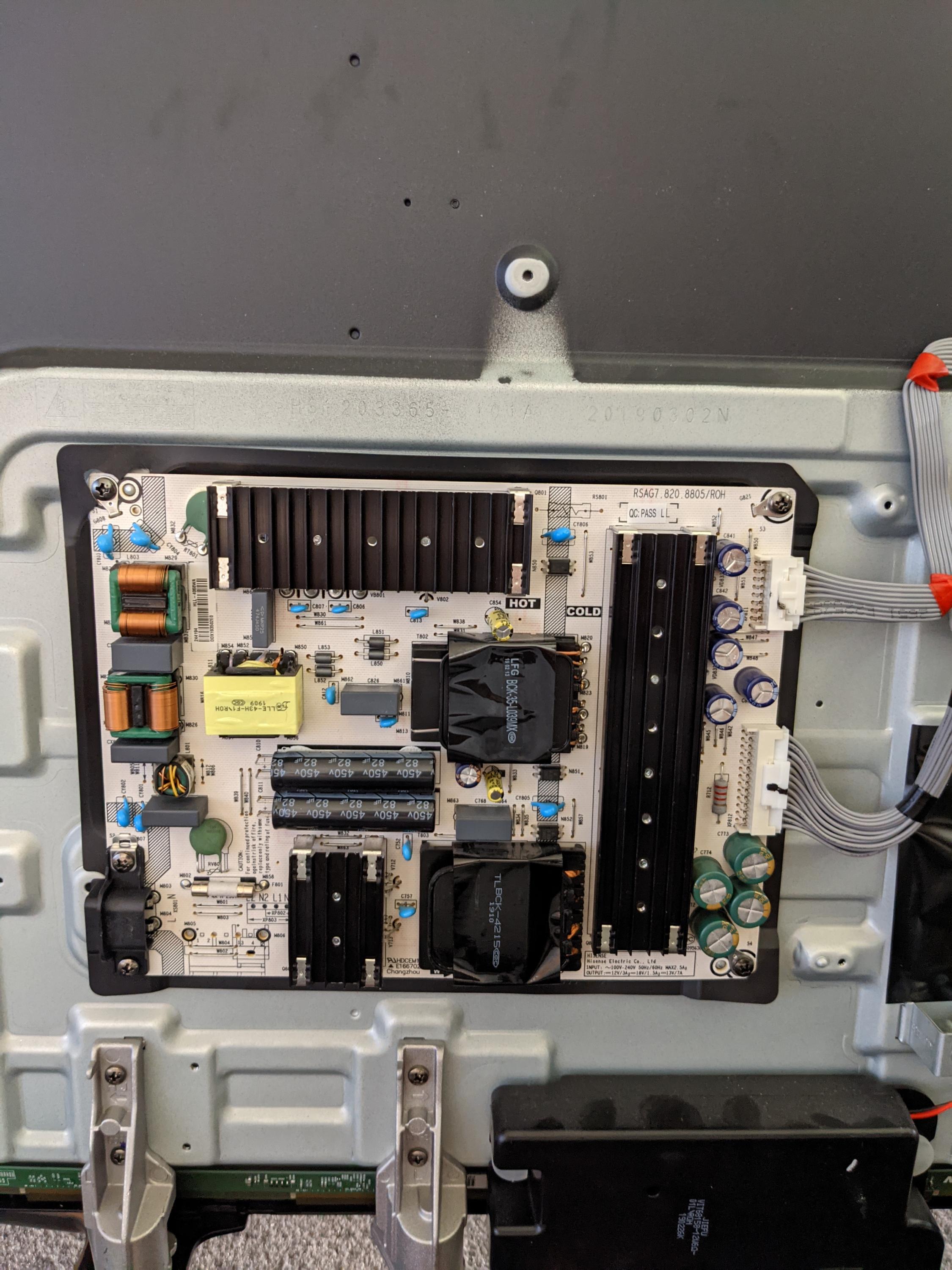

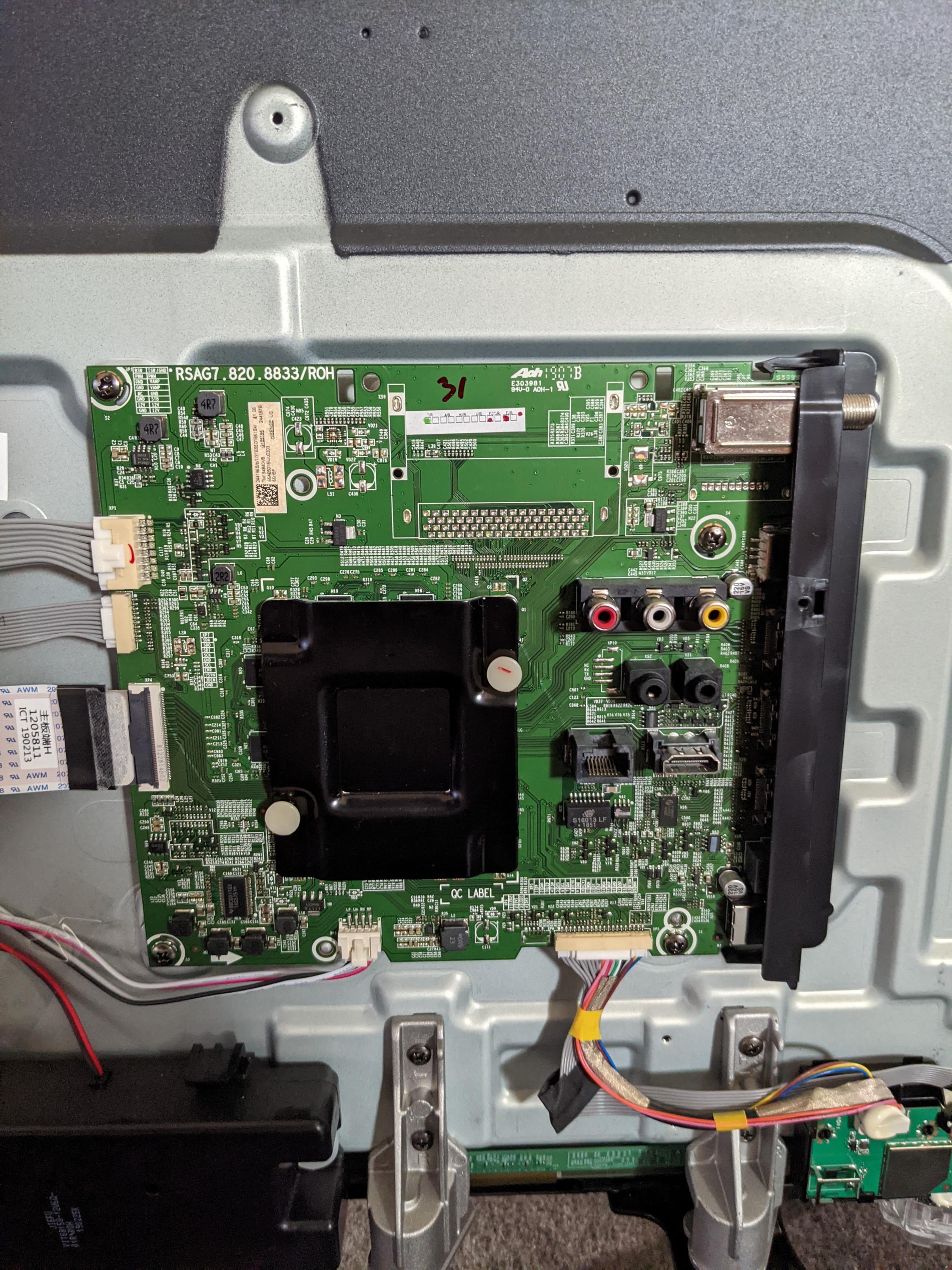

    Re: Hisense 55h8f, standby ok, not turning on
    Could use some good pictures of boards
      Shopjimmy has some good high res images here https://www.shopjimmy.com/hisense-24...-supply-board/
      Here are the boards on my tv
        Ordered a new power supply and tv has the same issue so it rules that out... Main board is suspect?

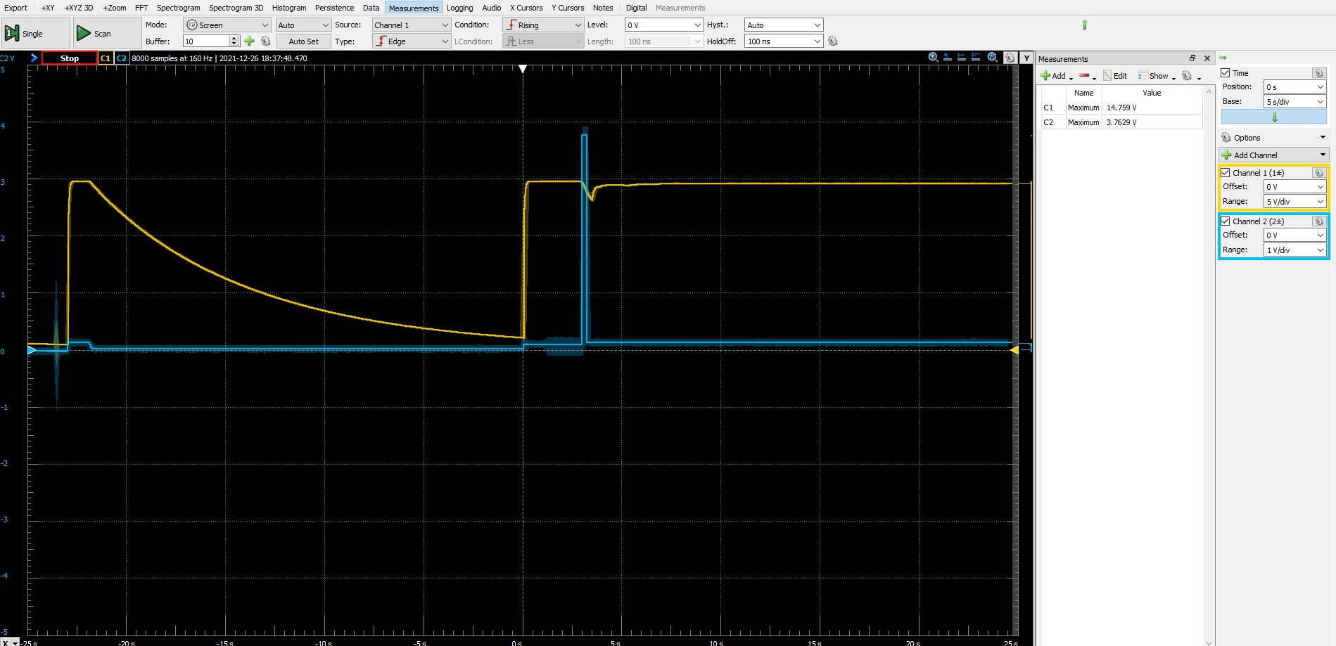

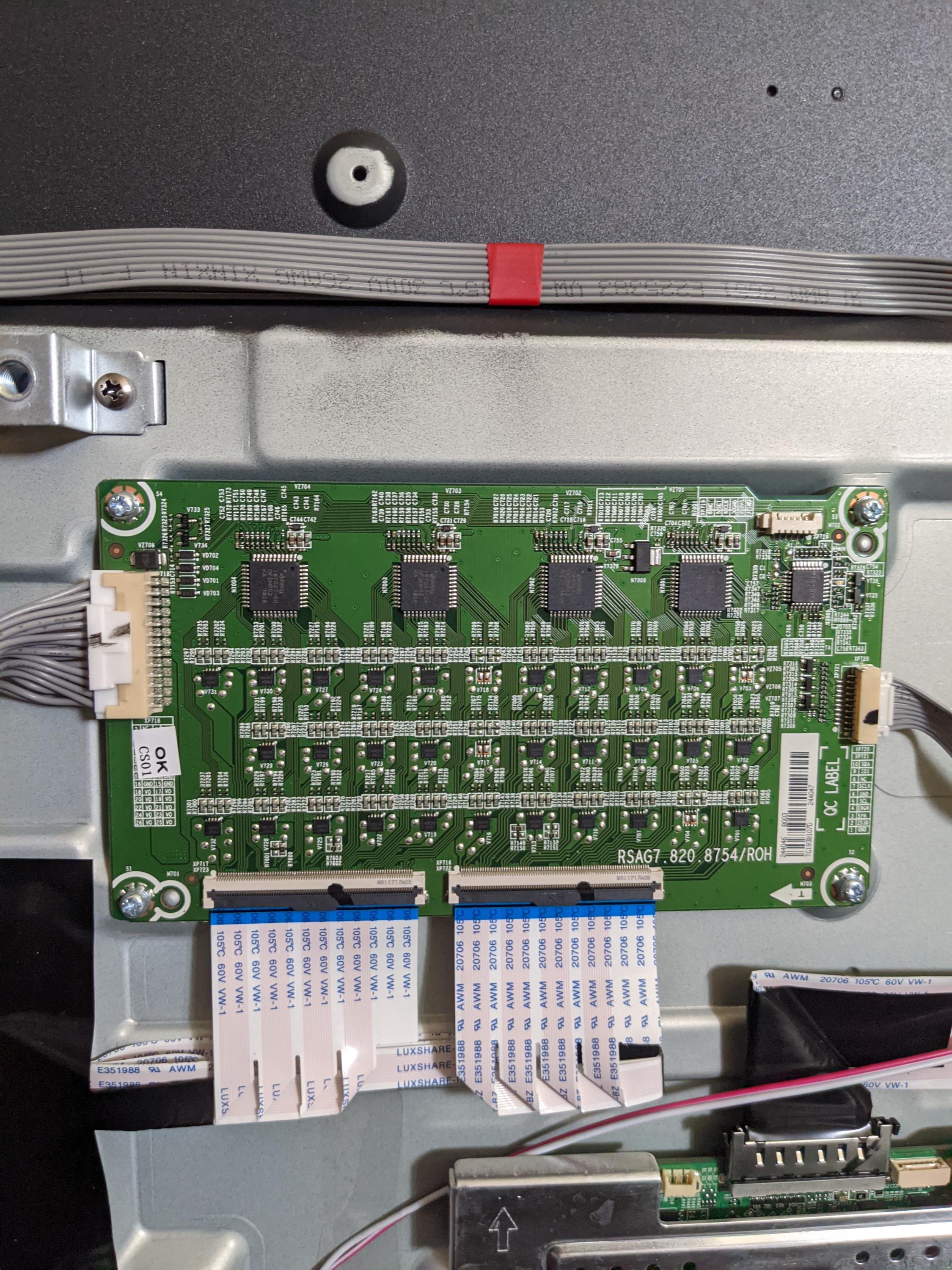

          So I used an oscilloscope to probe around and it might have gave me a lead. I was probing the power supply connect XP812 to the LED driver board and I am seeing transient behavior, as though something is possibly shorted?
          In the attached screenshot I have a probe (yellow) on VIN on XP812 and the other probe is on SW, I think it was. So you can see at the beginning when I plug in the board, the VIN voltage peaks and when decays to 0 (though I press the power button before it fully reaches 0) and I press the power button around t=0s, and VIN goes high, about 3 seconds later SW goes high to about 2.8v and there is a dip of VIN, about where the TV locks up and becomes unresponsive.

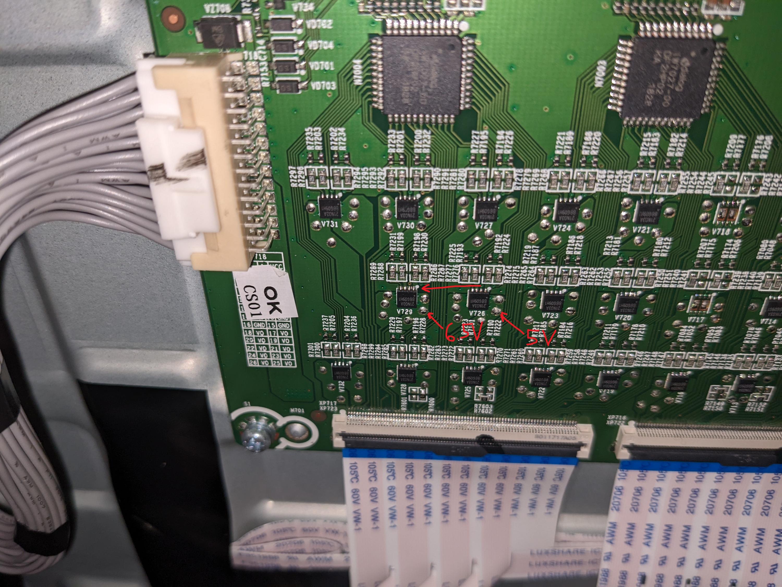

          Well, this seems to indicate a problem with the LED driver so I began probing around on that board. All voltages to drive the LEDS seems to be ok except this one pointed to on the picture, this one is outputting 6.5v... What do you think, bad IC?
