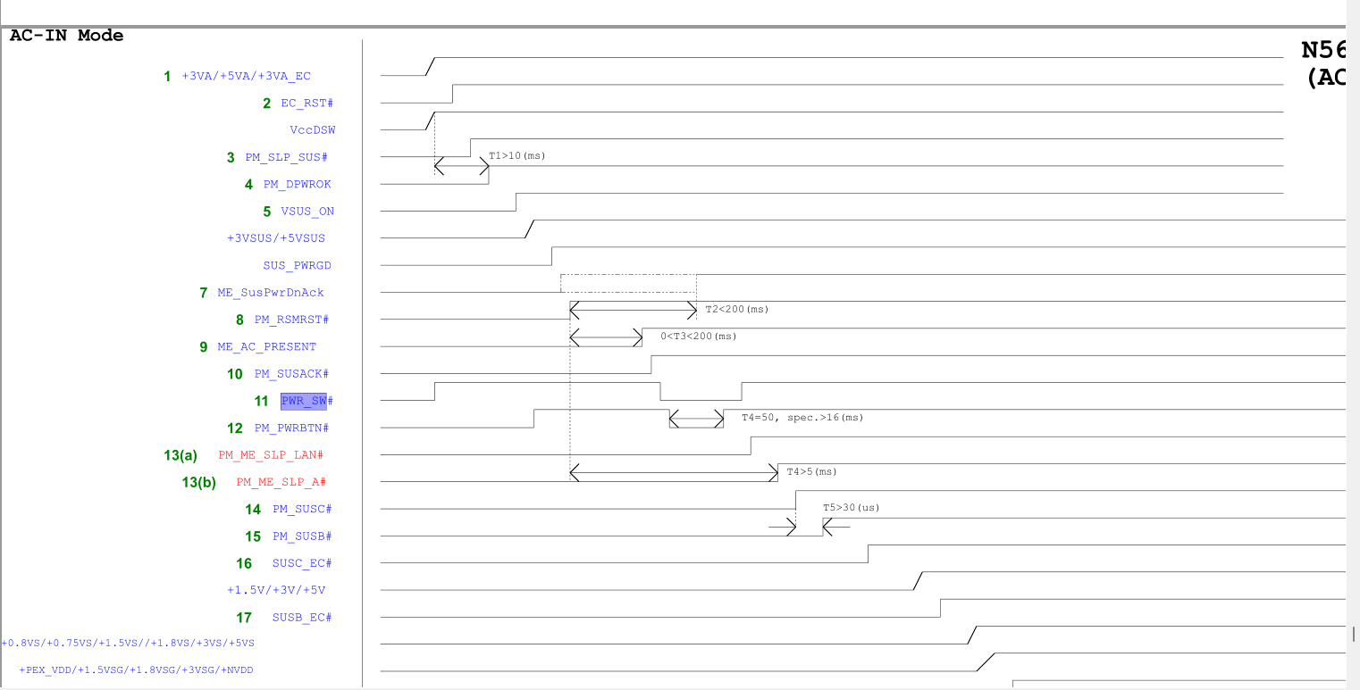

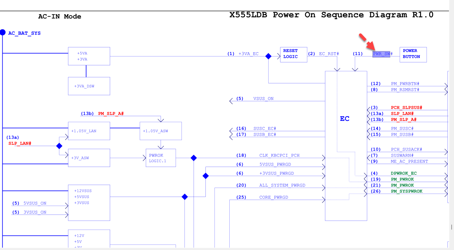

        Re: Asus A555LF (X555LD Rev.3.6 Board) Not Turning On With Power Button
        See attached.
        Confirm that PWR_SW# indeed goes to logic LOW when pressed; logic high otherwise. This is an active LOW signal to toggle the ON / OFF status of the logic board.
        If the default pull-up resistor is missing or defective, this could be a fault.
          power sequence, yes, that's i've been looking for
          PWR_SW# is working as it should, on power button pin and pin 110 of ITE8585E. it has 3.2V when not pressing power button and 0V when pressing power button
