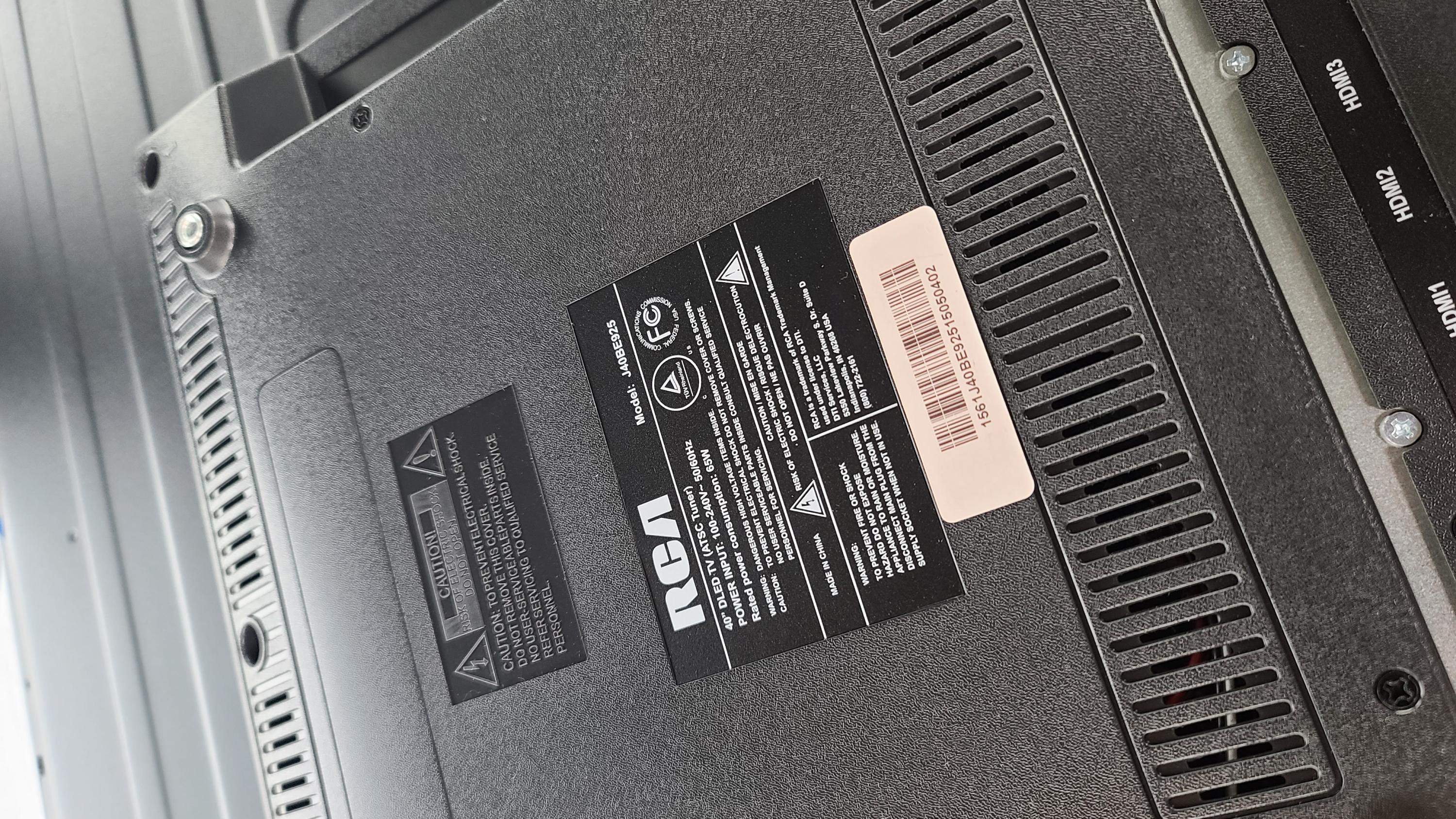

    I got ahold of a bunch of these sets. Some have cracked screens, and the others were lightning strike victims. Simple enough to swap good mainboards for bad. Tvs power on and display the HDMI input. I can change it to tv, but I had to scan for digital channels. Tvs work just fine until I turn them off. They reboot to the RCA screen and then go to HDMI screen. When I change it to tv they start to autoscan for channels again. I cant find any info, or a manual on these sets. I'm thinking I might need a MASTER remote. Any ideas?

      Does the mod# end in a 5 or 9 ...
      • tvtimmy
        • Mar 2015
        • 1160
        • usa
        Re: RCA J40BE925 hospitality set
        Here's the label.

          They are hospitality sets. Hopefully the master remote control I ordered will reset them.

            To exit the set from COMMERCIAL mode :
            Press menu
            Go over to lock symbol and press the down button
            Enter 0000 for the password
            Set system lock to off
            Go down to commercial menu and press ok change to off.
            To stop the set from running the setup wizard every time the tv is turned on:
            Press menu
            Go over to the tv setting on the left
            Go down to auto channel scan and set to off.
