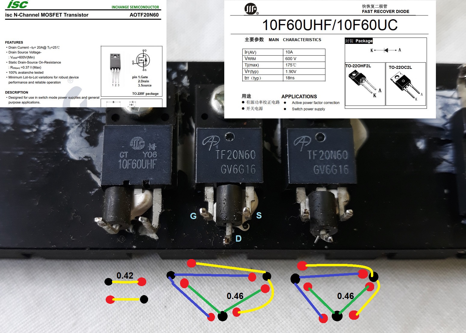

    Here are the results :
    To make it clearer I did not type 0.L
    Method : Diode Mode . Black probe fixed , test 1 , 2 , discharge with finger, test 2,1 .
    No conflicting results
    And all that, was done twice
    P.S The white print is the White Silicon Thermal Paste treatment. touch the paste , touch the IC, wipe gently with another finger

      Sad to see my bets go to the water closet, i can't believe it.. let me check better the ic2 datasheet..

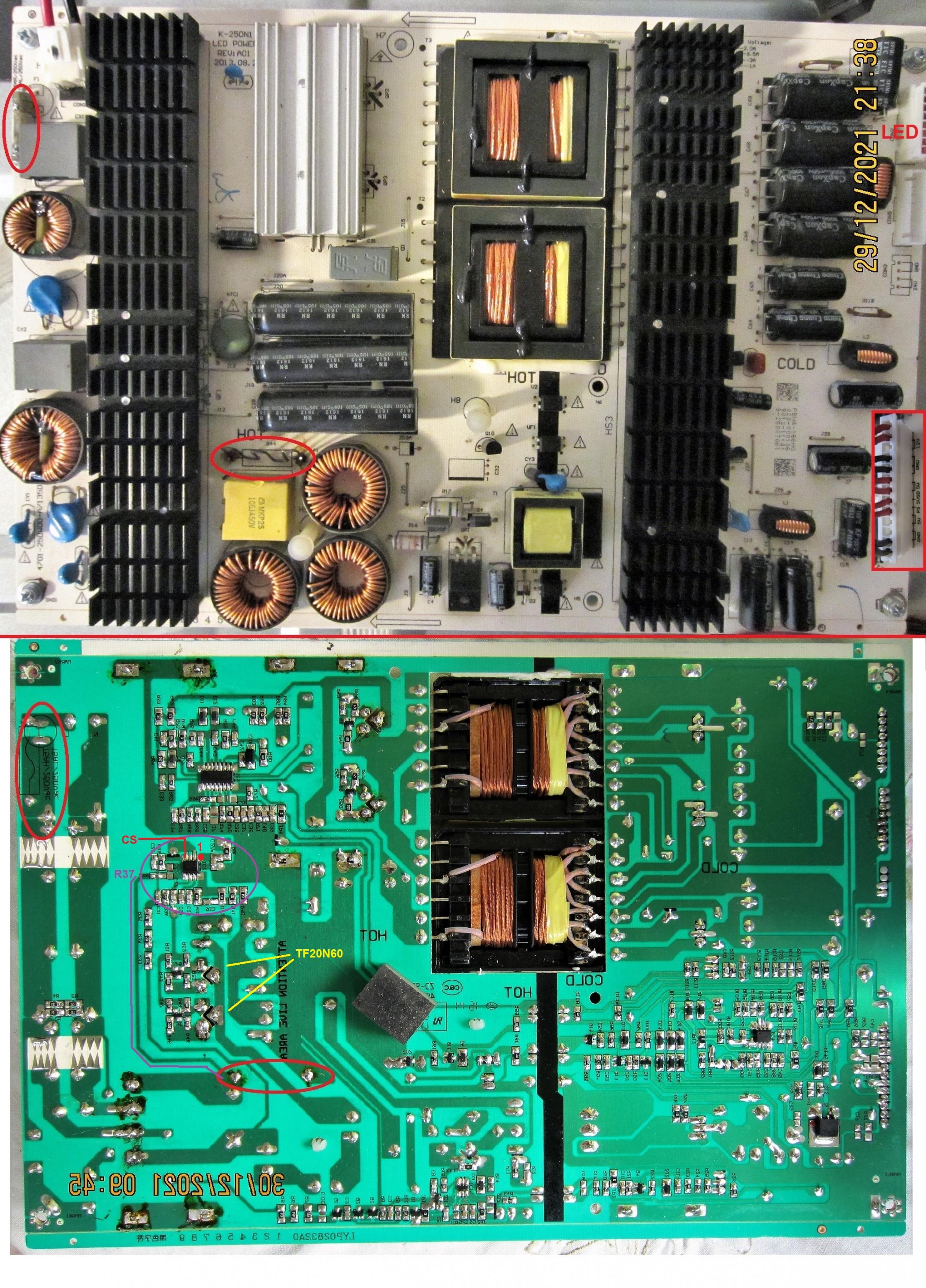

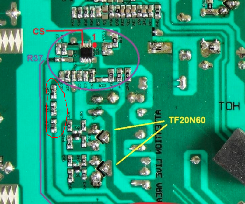

        My suspicion is that the sense wire resistor burned a bit and reduced its value, it must be precise i think, since the current on CS pin of ic2 is measured in uA, and/or the new R37 is not precise.. this would bring to a OCP protection that shuts down the pfc..

          Re: Can you dignose from the photo ? . Toshiba 65S2650EV
          Hi
          R37 measures fine. The Wire Resistor - I don't know how to replace ( to buy).
          Looking at the IC2 Pins description - I don't know what I can do , is it possible to trick the IC or .. no clue. If VCC is present , where else does it go ..
          What can we do .. could it be the other, IC3 ? Cold side not related at all ?
          I marked the Mosfets TF20N60 .
          I measured the resistors around them. They have same ones of course. One anomaly : R is 103 . but measures - in both - 5K Ohm. Not 1000 Ohm.
          I will check all other SMDs

            Check also R33-R35.

              So you don't want to follow my clue? You can simply try to enlarge the wire resistor, by using a thick copper wire from old electric home wiring or from an inductance with exposed wire..
