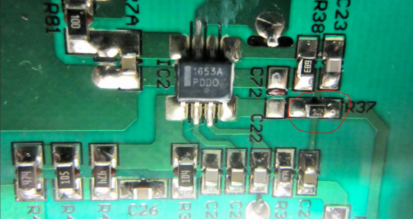

                    It looks like the R37 resistor has burned out.

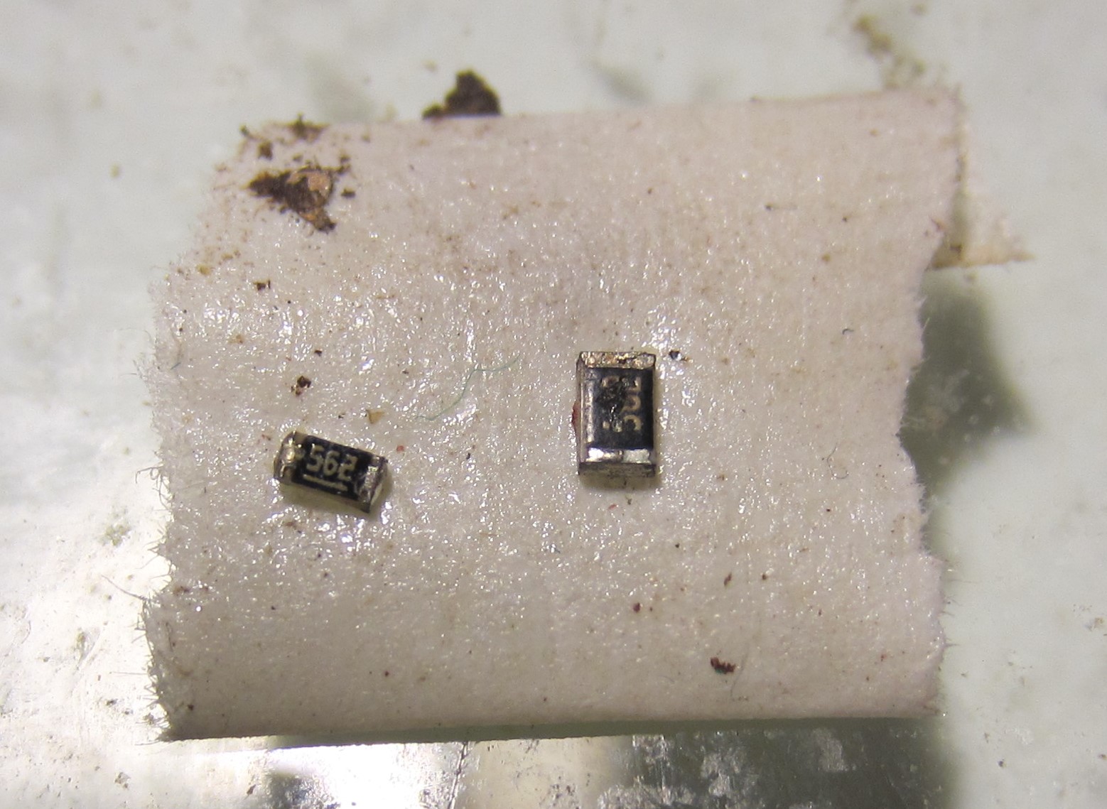

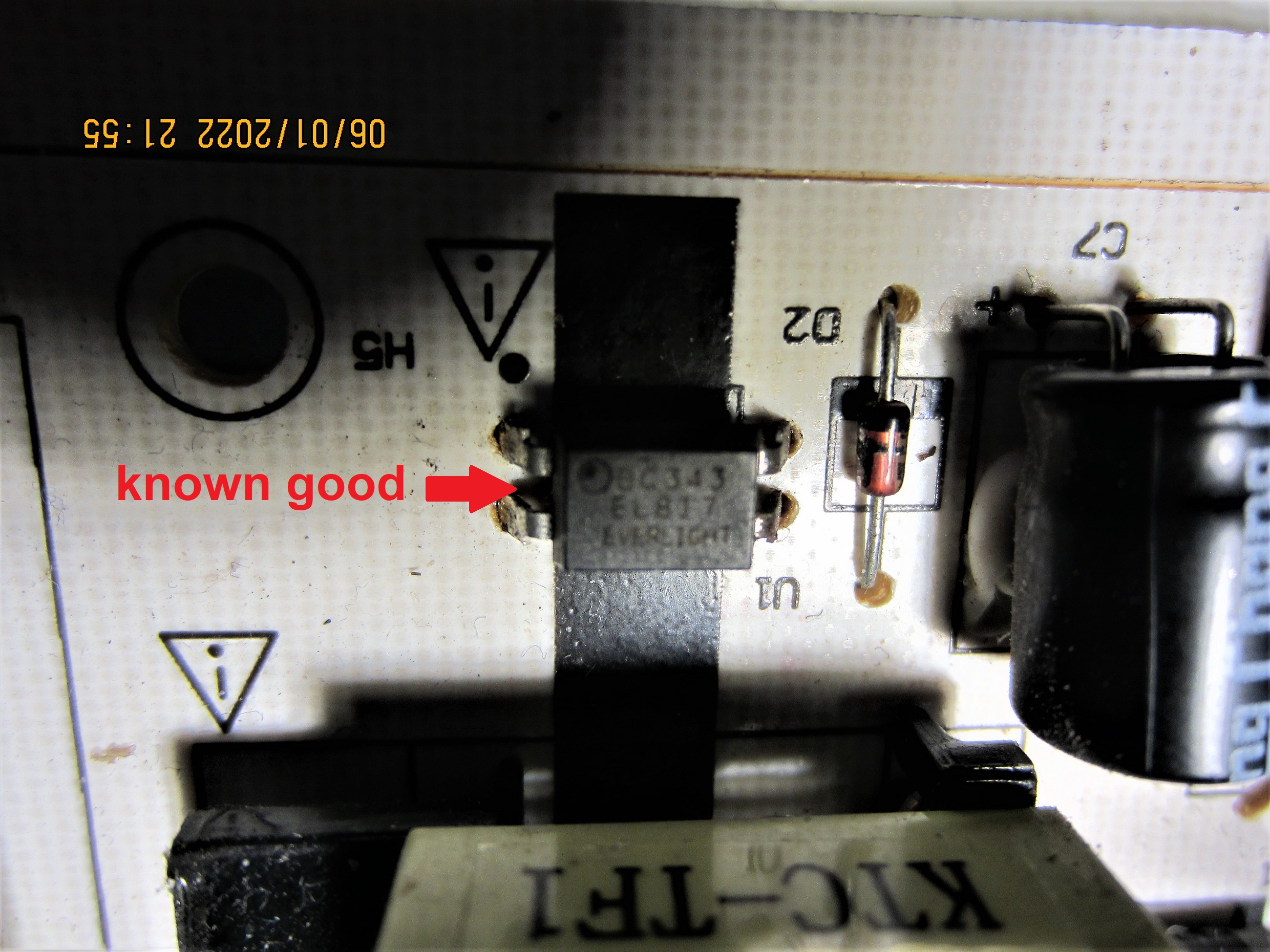

                        Re: Can you dignose from the photo ? . Toshiba 65S2650EV
                        OK
                        I replaced the Opto and the "transistor" IC : 817 and 431 , with new ones. AZ431 , EL 817
                        I took out R37 .. asking for trouble.. I knew it..
                        puff .. gone !
                        and found after vacuuming the whole area
                        I put it on masking tape : measures 123K . Its marking is 562 = 5.6K !
                        * I tested my DMM : with 4 AA batteries and SMD Resistors ( which are easy to know the value of ) : my DMM is fine
                        Now I am looking for new 5.6K SMD

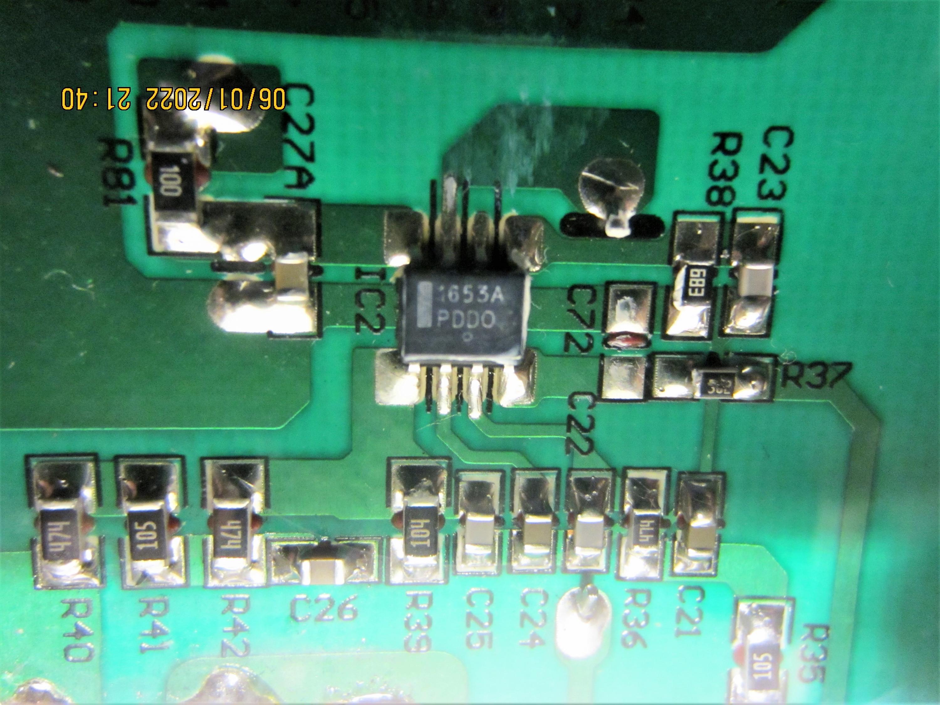

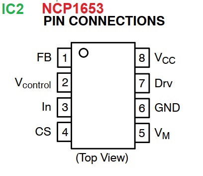

                          If the resistor burns out, then most likely the NCP1653A also burned out.
                            OK. Got the datasheet.
                            I'll look for shorts. and new R37
                            But FYI , we got 5.2 on 5VSB Pin at first ( no PSU High V output ) , and after changing the Opto and IC : 817 and 431 : we got 7.2 . Thats for standby V

                                Found R37 Resistor 562 . But smaller - see image.
                                Would it burn
                                haven't checked yet for shorts on NCP1653 = IC2.
                                      is the face of 431 facing the hot side? if yes so you have probably a bad ic1, to mention that i usually don't have seen any transistor near the 431 area and i ignore its function, maybe check it for shorts..
                                        I don't quite understand : U3 AZ431 is (flat) facing out from the separation line
                                        IC1 ? where is it ?
                                        check what for shorts ?
                                          i was asking if you have put attention to the right rotation of the AZ431, forget the rest, i think we are going quite to a dead rail.. i don't understand why these strangenesses.. there are not much components to test in a feedback..
