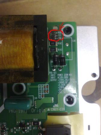

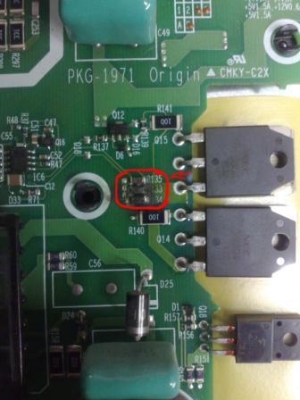

    Hi there i recently bought this tv from a family member as it was not turning on when opening it up i found 5 burnt smd resistors
    here are some pics
    sorry about pitcher quality ?
    there are 3 at bottom right next to the transformer
    and another 2 next to the fets
    so i bought a brand new board of ebay and replaced it and it still dosent work
    it will only switch on when you put the voltage switch to low when you put in on high you get one click then a few seconds later another
    I am in the process of checking the caps but my solder tips are nackered
    so i cant remove any just now. Any advice and help appreciated
    thanks.

    Advice, first. Read the FAQs, especially this one on inserting images.
    Next, it would help if we know the area you live in - or more specifically, is your line voltage 120 VAC as in North America, or 240 VAC as used in other parts of the world?
    Also, it's a minor point, but I fail to see the purpose of posting mediocre pictures of a power supply you don't need.
    Question next. Who made the panel in this TV? This should be on labels in the upper right or upper left of the plasma panel. I'd suggest pictures, but....
    Help next: A common cause of the symptoms you describe is a shorted load - for example, a shorted Z-sus card. LG Electronics suggests troubleshooting by unplugging power cables to specific cards to identify the culprit. NO IDEA what would happen if you tried this on panels from other manufacturers.
    More help: Search Scribd. They have a lot of training manuals and service manuals for plasma TVs.

      Here is some better pics i have circled the problem area in red
      The power board part number is ( pkg-1971 ) made by Sanken pdc20327.M

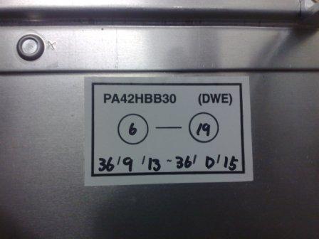

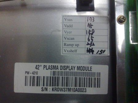

      The panel maker not sure. Hear are some pics of the stickers on the pdp
      first sticker
      2nd sticker

        Maybe Daewoo makes their own plasma panels?
        PlainBill
          Re: daewoo DP-42SP
          i dont know who made the panel ?
