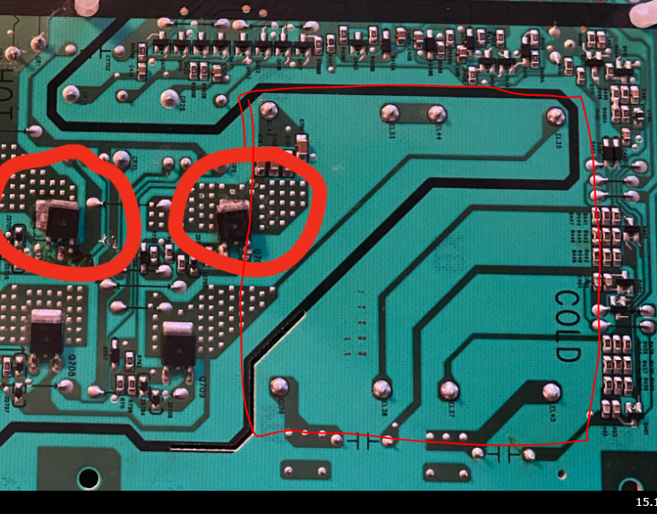

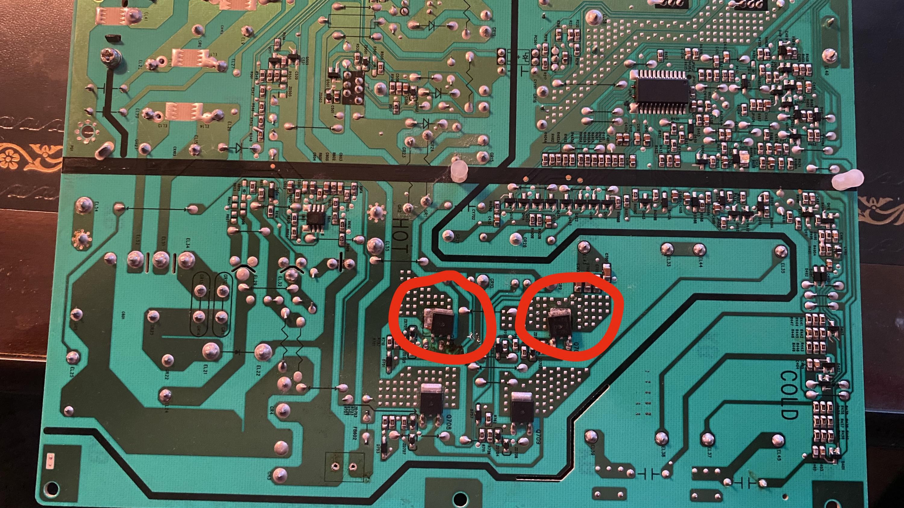

    Good morning techs. Need some help. I have been in electronics for over 50 years but as you know it changes fast and left me behind.
    I have a Visio VO320E that is completely dead. I know it is old but if possible I would like to repair it to component level. I have located a few components that are bad and have ordered them from somewhere on the planet.
    I have circled the components that are bad. Two FETS and one Thermal resistor.
    I assume this has something to do with the display in some way. Any help would be great.

    Re: Dead Vizio
    They are in the backlight inverter.

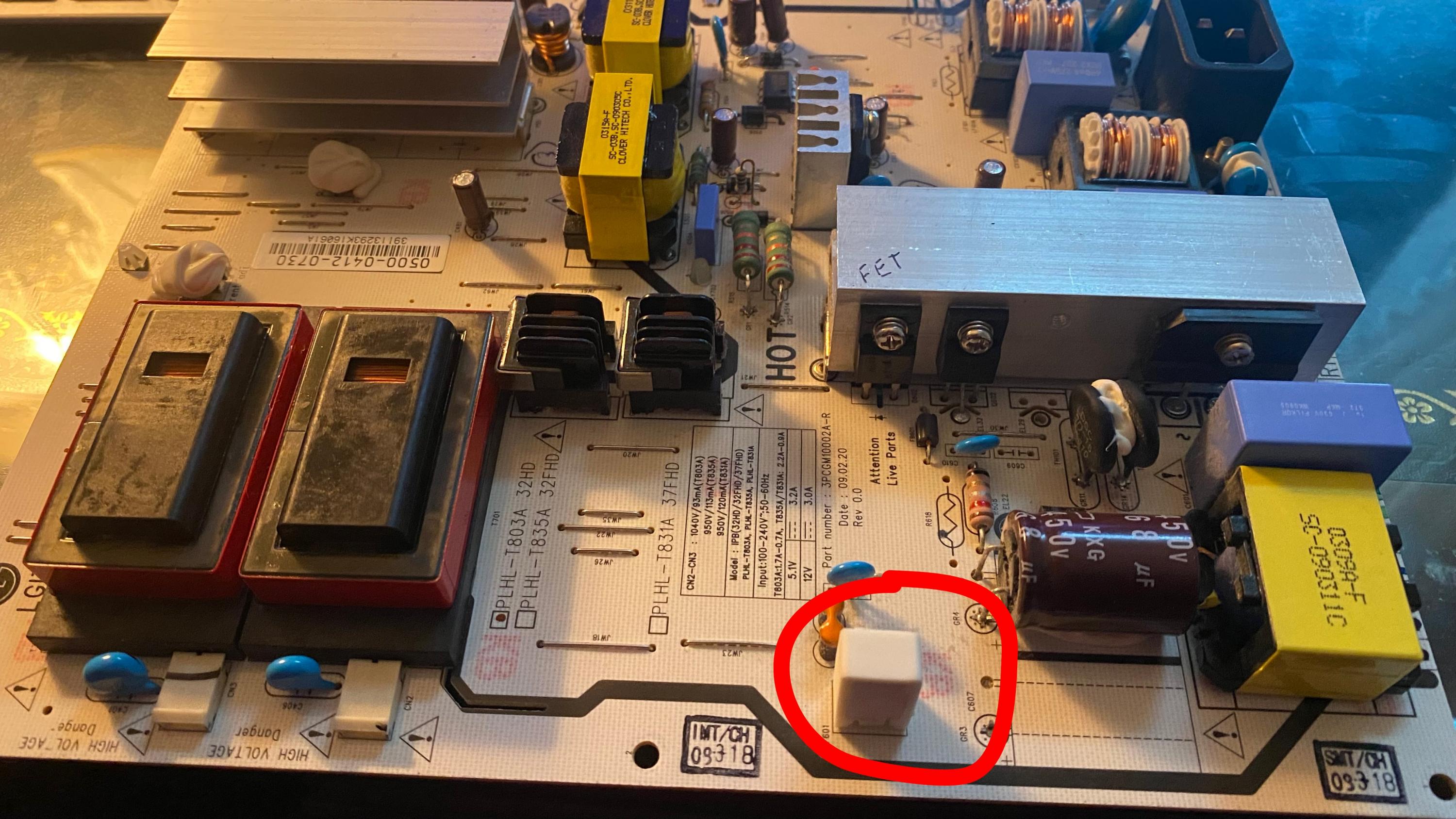

      Re: Dead Vizio
      An inverter takes DC and makes AC. So you need AC to run the back light is that correct? These FETs are gated by the AC?

        Re: Dead Vizio
        They power high voltage transformers

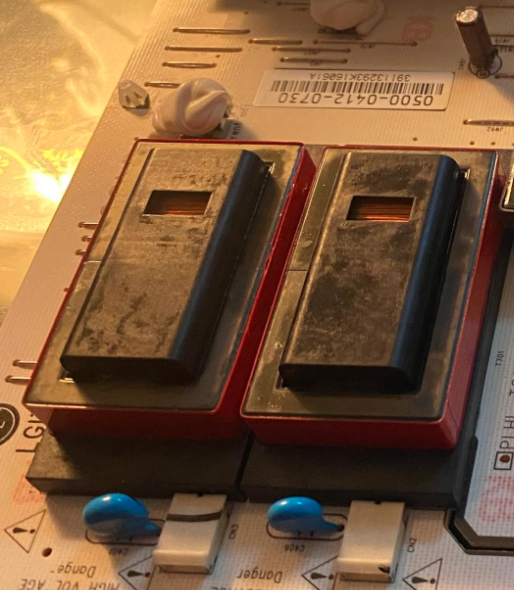

          Re: Dead Vizio
          Thanks for your response. Are they the two larger flat transformers on the power board? If so might one be defective, causing the fets to go? Where might I get some information on this circuit.

            Re: Dead Vizio VO320E
            Your backlights are fluorescent tubes. You will probably have to compare resistance between each of the transformers.
