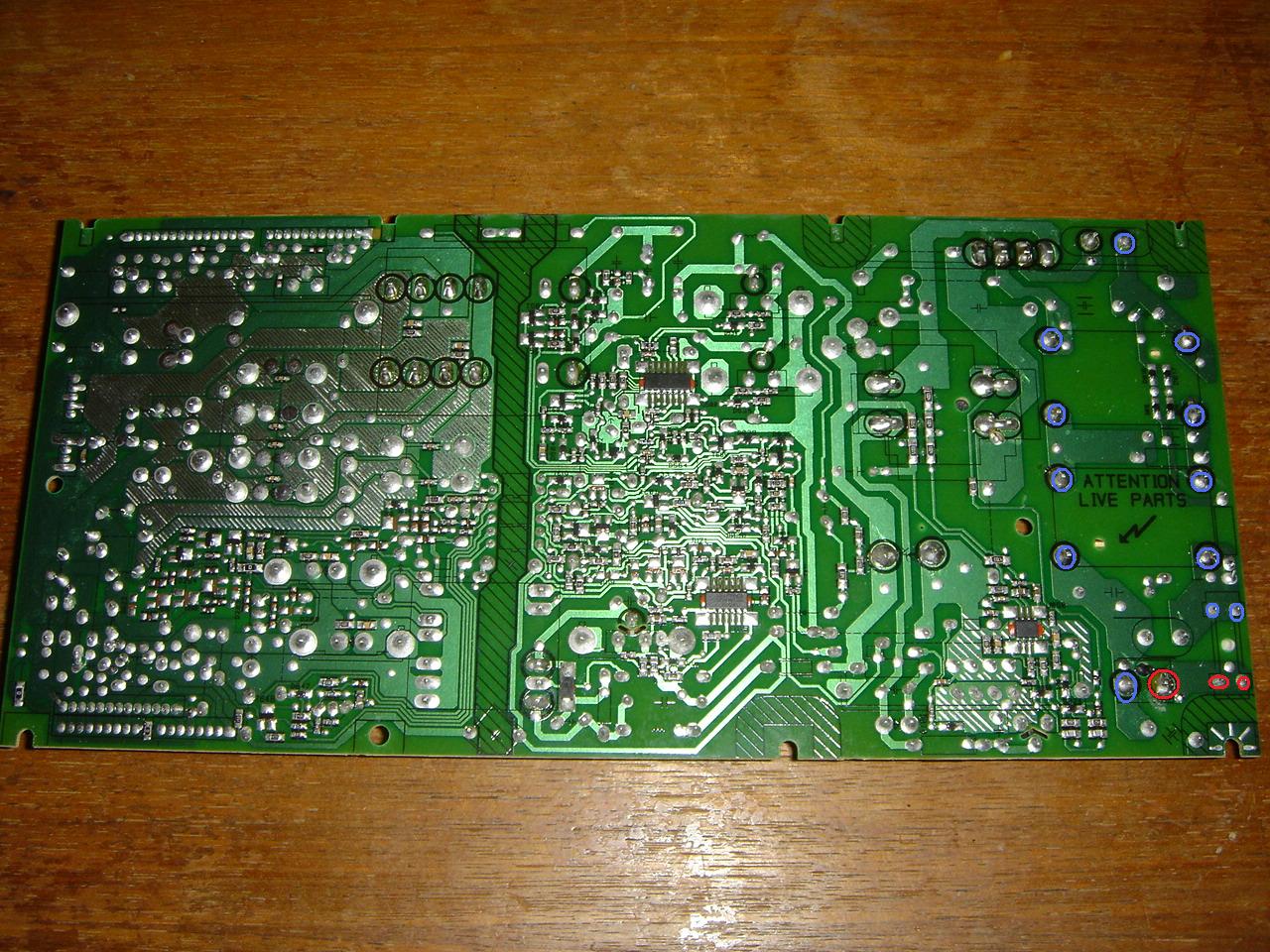

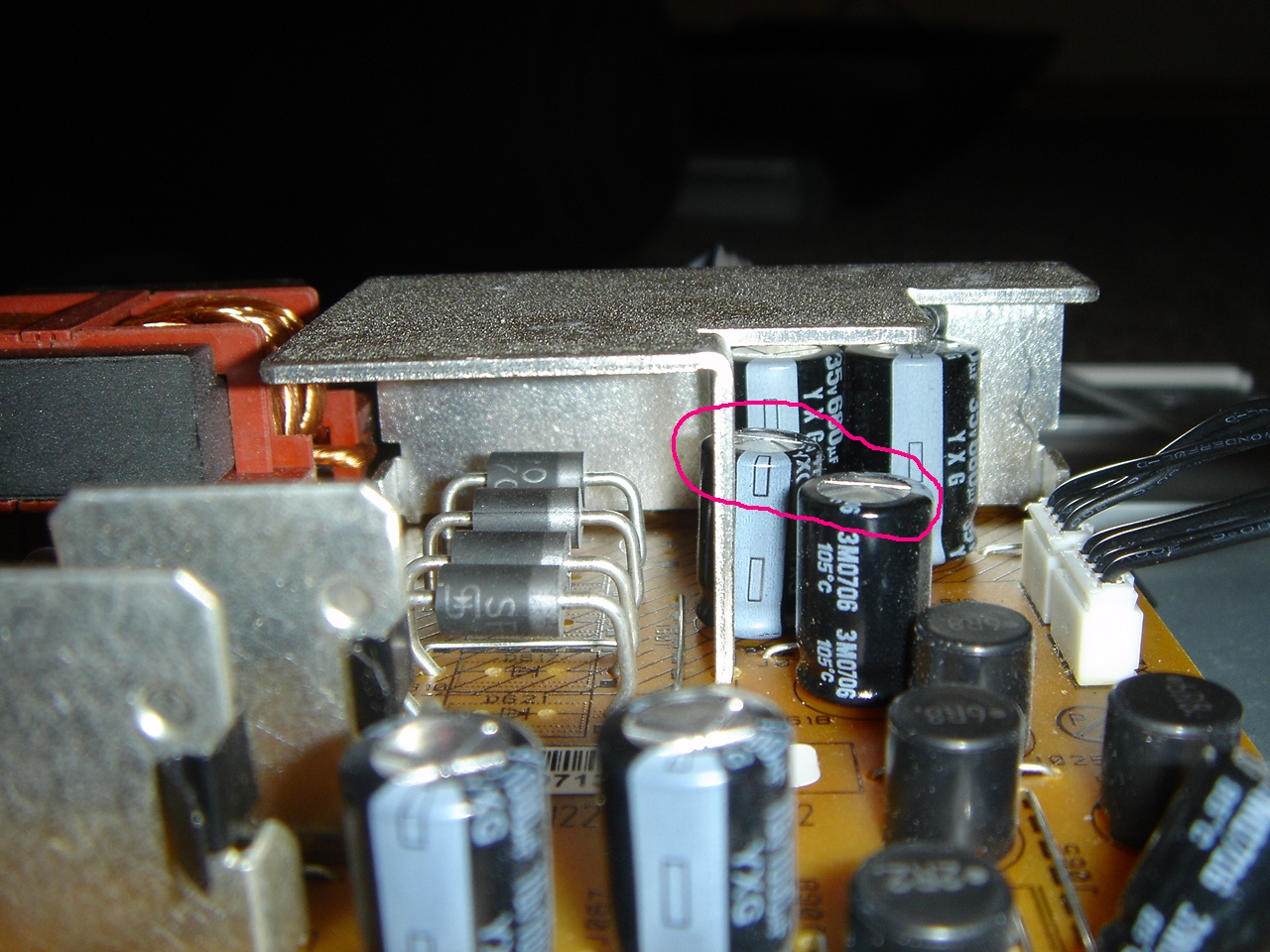

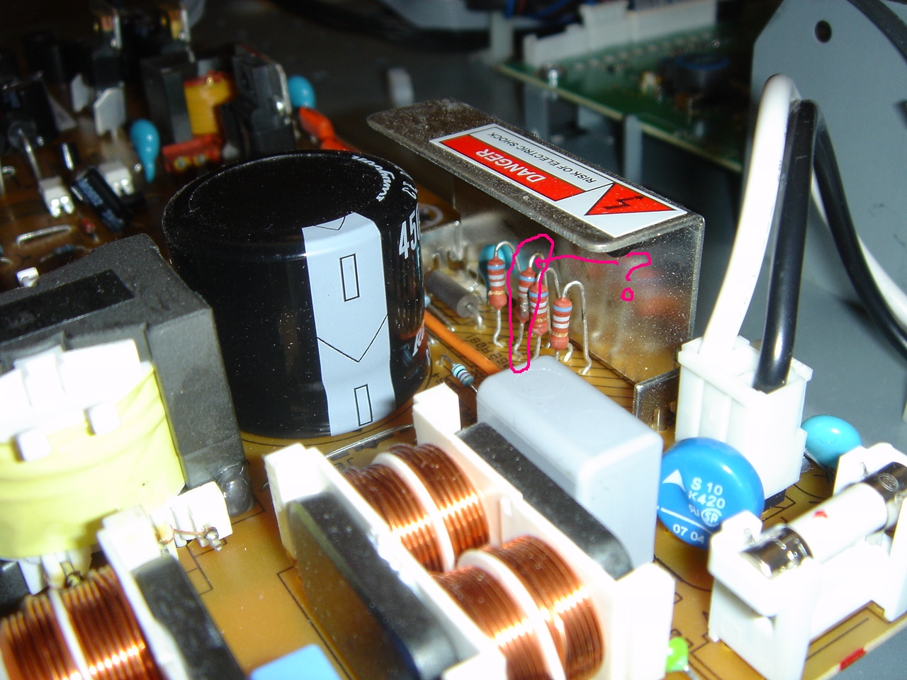

      a couple of things here. in photographs, lighting & the lens can play tricks so no way to be sure but i've reposted a couple of your pics with 2 circles of interest.
      one has a circle around what appears to be a couple bloated-top caps.
      the other has a circle around what appears to be a burnt resistor.
      you'll have to check them in person to see if that's real.
      (with the power off that is - remember, death is permanent).

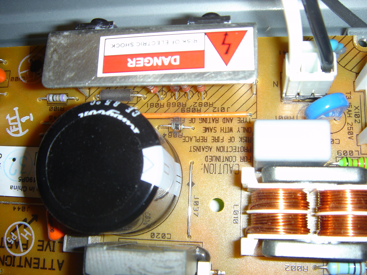

            The caps looks perfect in person. Unfortunately I don't own a ESR meter to really be sure.
            I was going to mention about that resistor. I just tested all of the resistor under that heat sink and they all are giving 22.00kohm. So I'm assuming they are still good.

              you might have to unsolder a leg on that resistor to check it.
              i'm seeing blue grey grey on those .. not red red orange..
              probably something in parallel.
              it could also be intermittent.

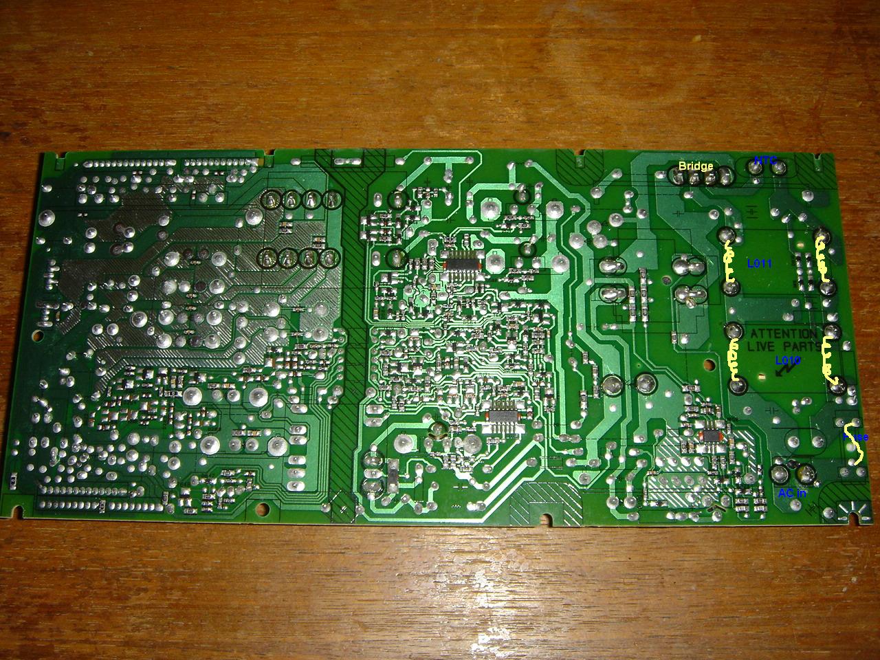

                              GBU606 is a bridge rectifier. Depending on where you were educated, where you live, who your boss is, and the day of the week it could be designated D020, BR020, Rect1, or whatever. With the TV plugged in you should see AC voltage across the two center pins. If you don't something is bad on the AC input.
                              I've marked up the picture of the bottom (good thing you took that) What I would suggest is to check continuity of the entire power input system. Have the power cord plugged into the TV, but NOT the outlet. Set your DMM to the lowest ohms scale. At the top right I've marked the terminals of the bridge rectifier. Counting from the left, terminals 2 and 3 are the AC input.
                              Hold one probe on terminal 2 of the bridge rectifier. Working down the board, you should get continuity to the top left terminal of L011, the bottom left terminal of L011, the top left terminal of L010, the bottom left terminal of L010, the left terminal of the AC input connector, and finally, to one of the two blades of the power cord. If at any point you lose continuity, you have located a problem. Pay special attention to the solder on the pins of L010 and L011.
                              If you got continuity all the way out to the power cord, start by putting one probe on pin 3 of the bridge rectifier, and working your down the right hand side through the NTC, the right terminals of L011, the right terminals of L010, the terminals of the fuse, and finally the AC connector and the power cord.
                                All of this tests pass all the way out to the cord.
                                PlainBill
                                Two bottom solder points for fuse failed and right side of AC in failed, also cord test failed The right solder point for the AC IN also looks like a bad joint. Possibly a blown fuse causing the right side to fail? However I am getting proper VAC through the fuse when plugged into an outlet.
                                Picture to explain things better. BLUE = PASS & RED = FAIL.

                                  You've found the problem. Good job of marking the results.
                                  Bad fuse, bad solder joints on fuse holder, clips on fuse holder not holding the fuse tightly. Pull the fuse, test it (it's not beyond the realm of possibility that the fuse is intermittent), resolder the top AND bottom contacts on the fuse holder, reinsert the fuse, making sure it clips in firmly. Then verify the right side shows continuity from the lead on the bridge all the way to the end of the power cord.
