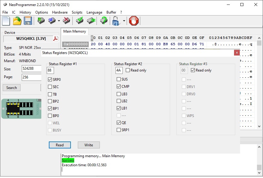

                        Hi Lotas
                        I just can't seem to solve the problem.
                        I try to write register 1 to 88 and register 2 to 42.
                        When I click on write everything seems okay.
                        Then I click on read and register 2 reads it to me at 4A.
                        How can I solve it? It doesn't seem to store the second register at 42.​
                        • lotas
                          • Jan 2016
                          • 4593
                          • Russia
                          #492
                          1. First you need to delete all status registers (uncheck all the boxes and click "Write")
                          2. Erase the chip.
                          3. Write down the corrected dump and check what was written down.
                          4. Set the status register (0x88, 0x42), check the boxes and click "Write"
                          5. Everything is ready, solder the chip in place....​
