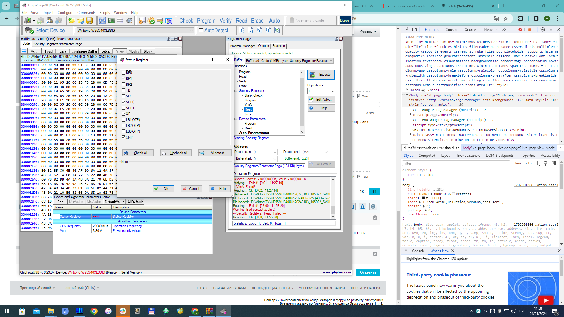

        Thank you very much, but the TV still doesn’t work, there is no response to the power button, I set the status register as it should, but after turning on the beginning of the dump is destroyed, please tell me what could be wrong.Click image for larger version  Name:	image.png Views:	0 Size:	13.2 KB ID:	3172713

          What programmer do you have? If CH341A, what program do you use for it?
          And how do you record the dump, what is the order in which the commands are executed?

            I read the dump with SVOD3 , but the status registers in it are not entirely clear, so I took another programmer - Chipprog-48. I pasted a picture with the status registers from it

              when I read the dump again, I see that the beginning is FF, I load fix , I click erase then write, then in the security register column I select read, I go into them, I see that everything is still the same as I set it up​

                The procedure is as follows: 1 - Remove protection (uncheck all checkboxes and record St. Reg.) 2 - Erase the chip. 3 - Record my Dump. 4 - Check the recorded dump. 5 - Check the boxes in the Status Register (0x88, 0x42, 0x00) and write to these registers.​

                  Why do you have errors on 2 pins?

                    Thank you very much, after 10 attempts with the SVOD programmer I was able to write the registers correctly, the TV started up! Thank you!
