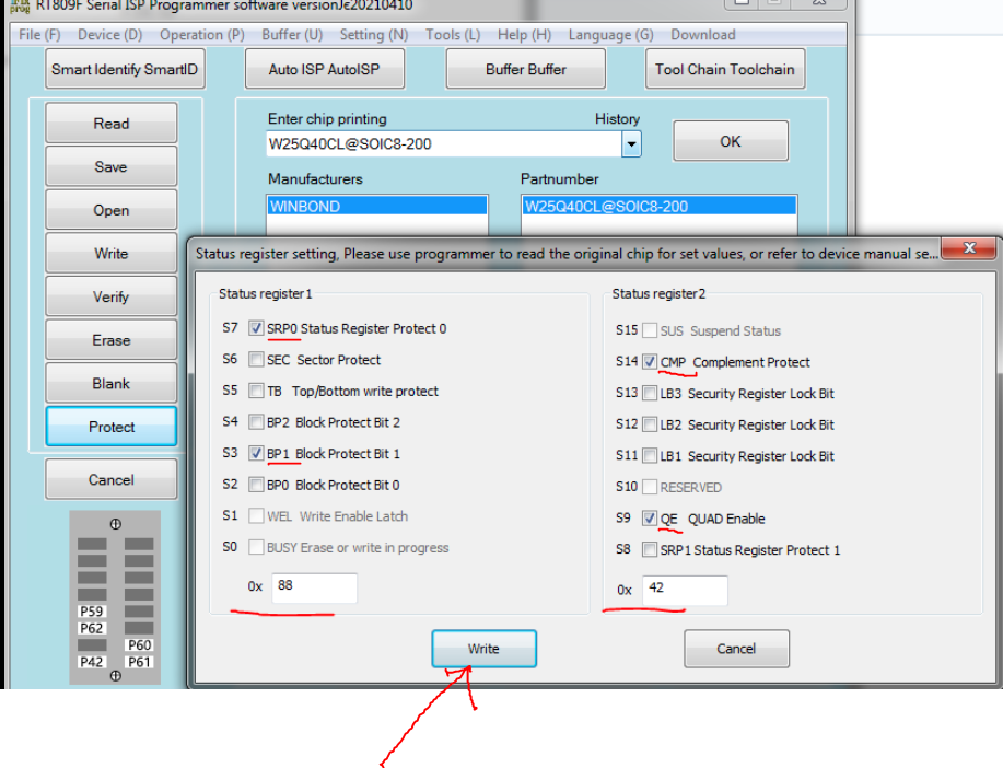

                Yes, I do that on my TV UE49MU6120KXZT:
                Mainboard BN41-02568A BN94-12570P fixed 25Q40 with your dump "25q40_orig_fix.bin" setting status register => now works

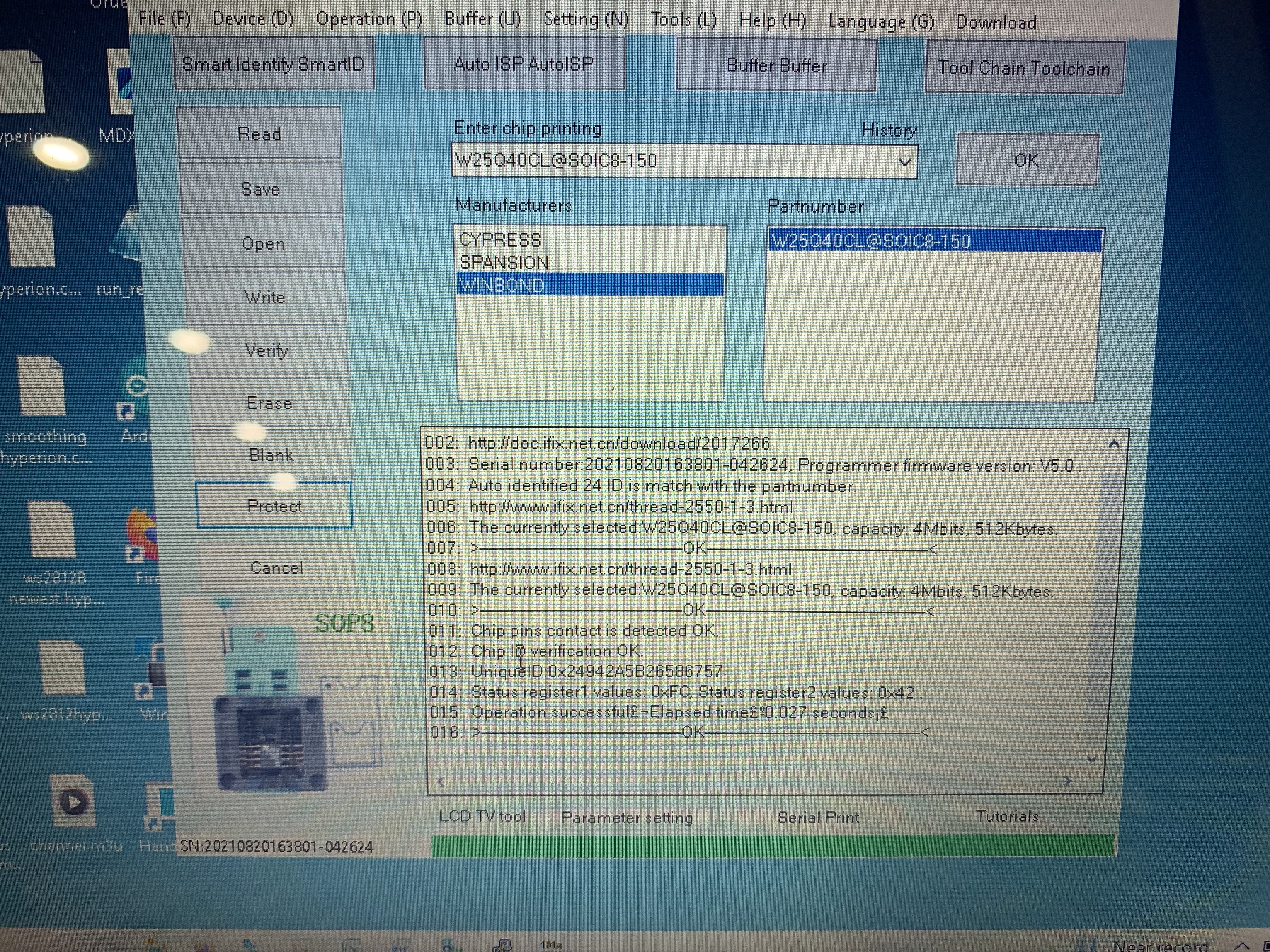

                          I tried it, but for the life of me I cannot get the registers set to 0x88 0x42. It's always 0xFC 0x42 even after changing the protection and writing. It shows successful but 0xFC
                          I have rt809f programmer and should be able to set registers. Even after I erase everything and verify the registers still 0xFC 0x42
                          Am I missing something or doing something wrong

                            #393
                            First, we define the flash, remove the protection (uncheck the boxes and press write), erase, write a dump, check, install the protection (check the boxes and press write).

                              I did exactly as described and have the same 0xFC for register 1
                              update: I quit being lazy and removed the ic from the board and it worked right away. Lesson learned.
                              thanks again for the help

                                #395
                                You always need to remove the chip from the board, especially when recording it; I don’t trust this clothespin (problems can always arise).
