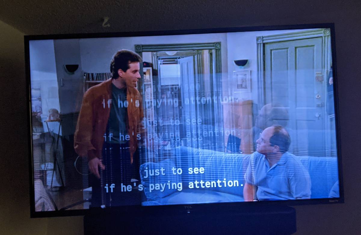

    TCL 43S403 with odd image that jumps
    Any idea if this is a t-con or driver board issue? Or bad panel Not sure where to start the troubleshooting.
  • lotas
    • Jan 2016
    • 4749
    • Russia
    Re: TCL 43S403 with odd image that jumps
    This is not a working panel (signals CKV, CKVB, STVP), but you can fix it, cut the tracks of these signals on the sick side of the matrix strip or T-CON.
