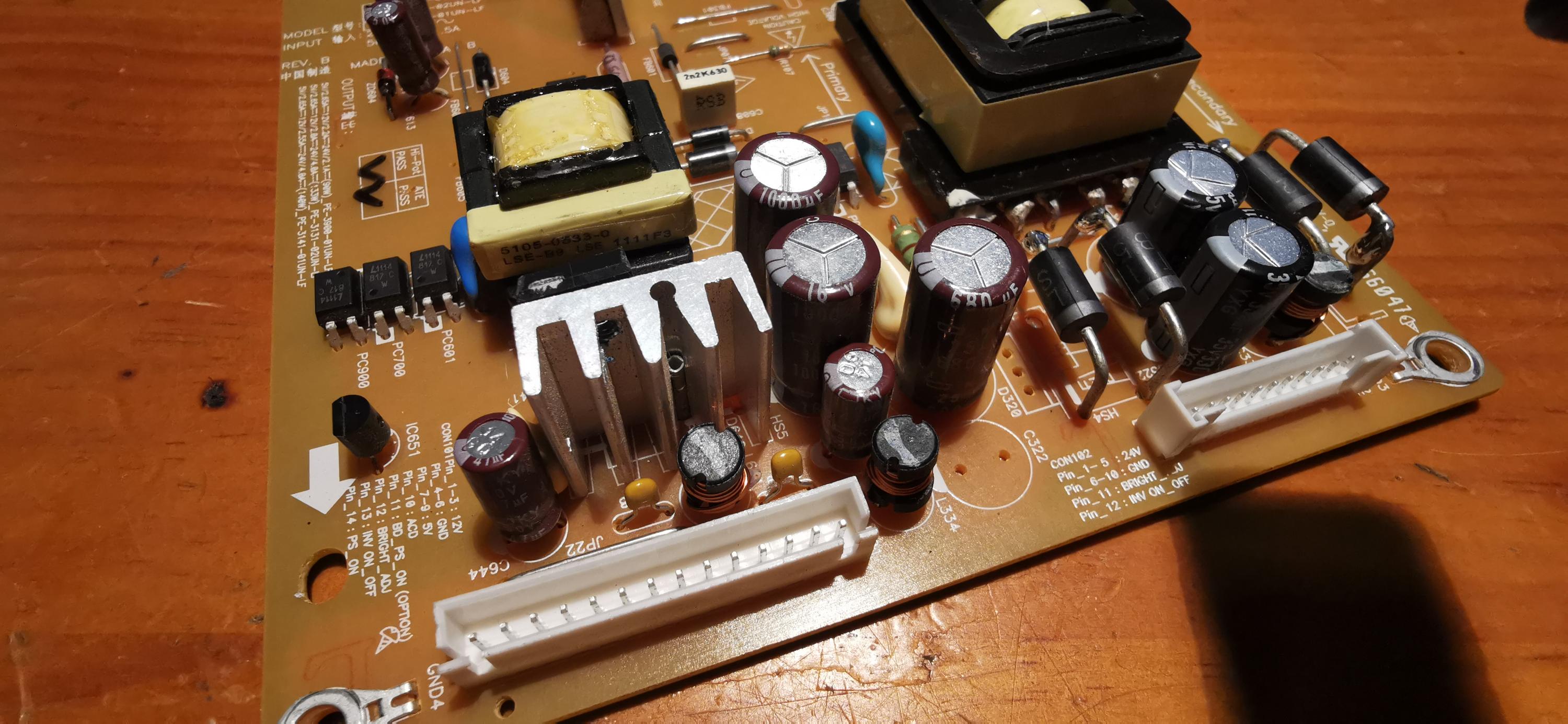

    Hello.
    I have a problem with this led tv. When I turn on, the red light turns blue but the tv does not show any more symptoms. Does not respond to buttons or remote control. It is only possible to turn it off and the red light flies again.
    I have serious doubts as to whether the problem is with the power board or the main board. I wanted to run the power board without any connection but I don't know which pin to jumper. So I can see if the power board is capable of delivering all the voltages. Currently it only delivers 5v of stanby and others with low voltage that do not correspond to the voltages printed on the board.
    I hope someone can help me.

    Could someone tell me which pin I should jumper to make the board work outside of the tv?
    I would like an answer

      Ps_on.
