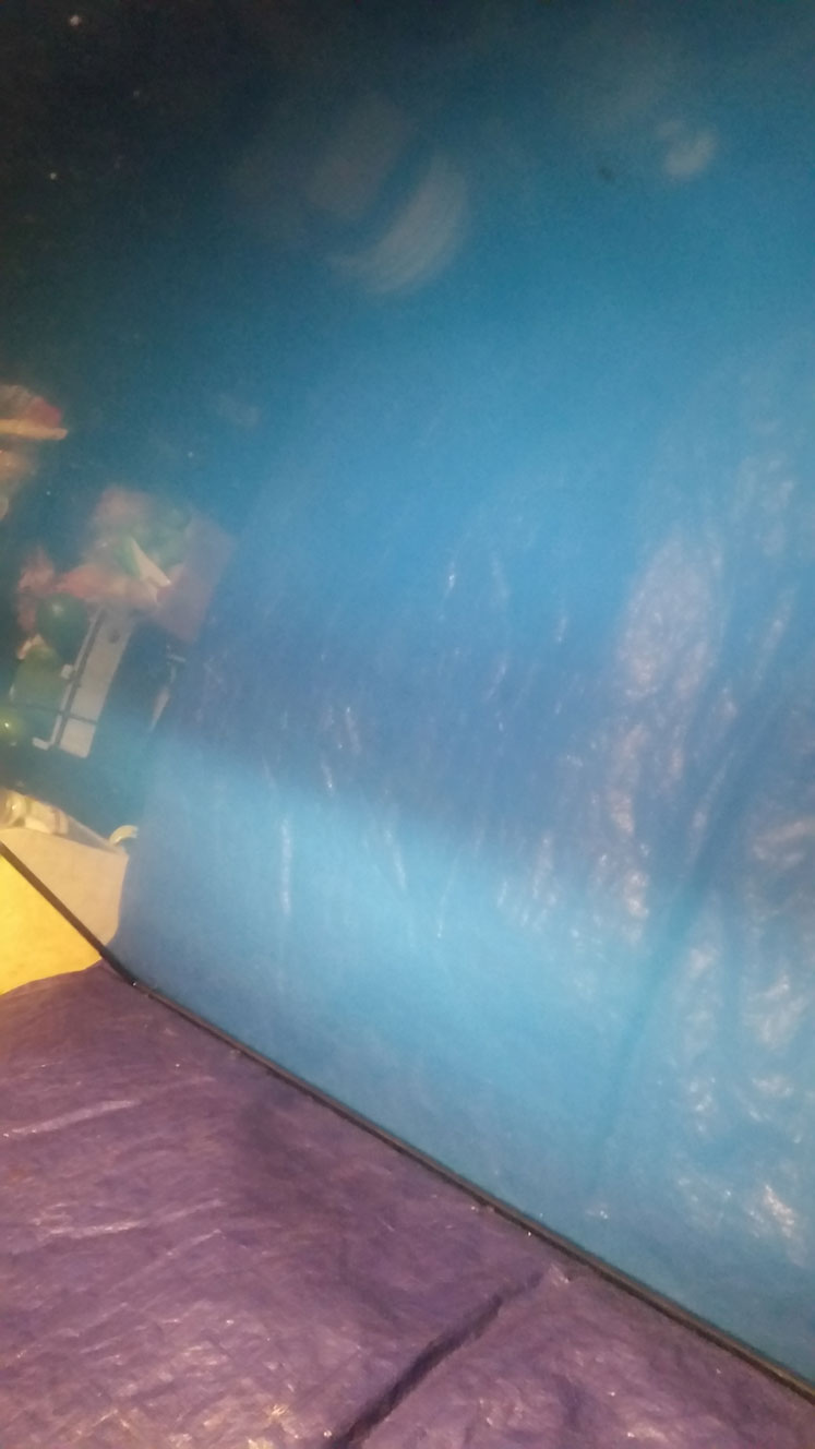

    Blank Backlit Screen w/ sound verified via DVD on HDMi 3
    no change to display when disconnect tcon
    no change to display when disconnect panel cables (both sides, one at a time, etc-)
    can faintly see a vertical dividing line splitting the panel even in half. super faint tho.
    also can faintly see a black cloud in the center of the screen. a darker area.
    color of screen is backlit black screen which basically looks gray

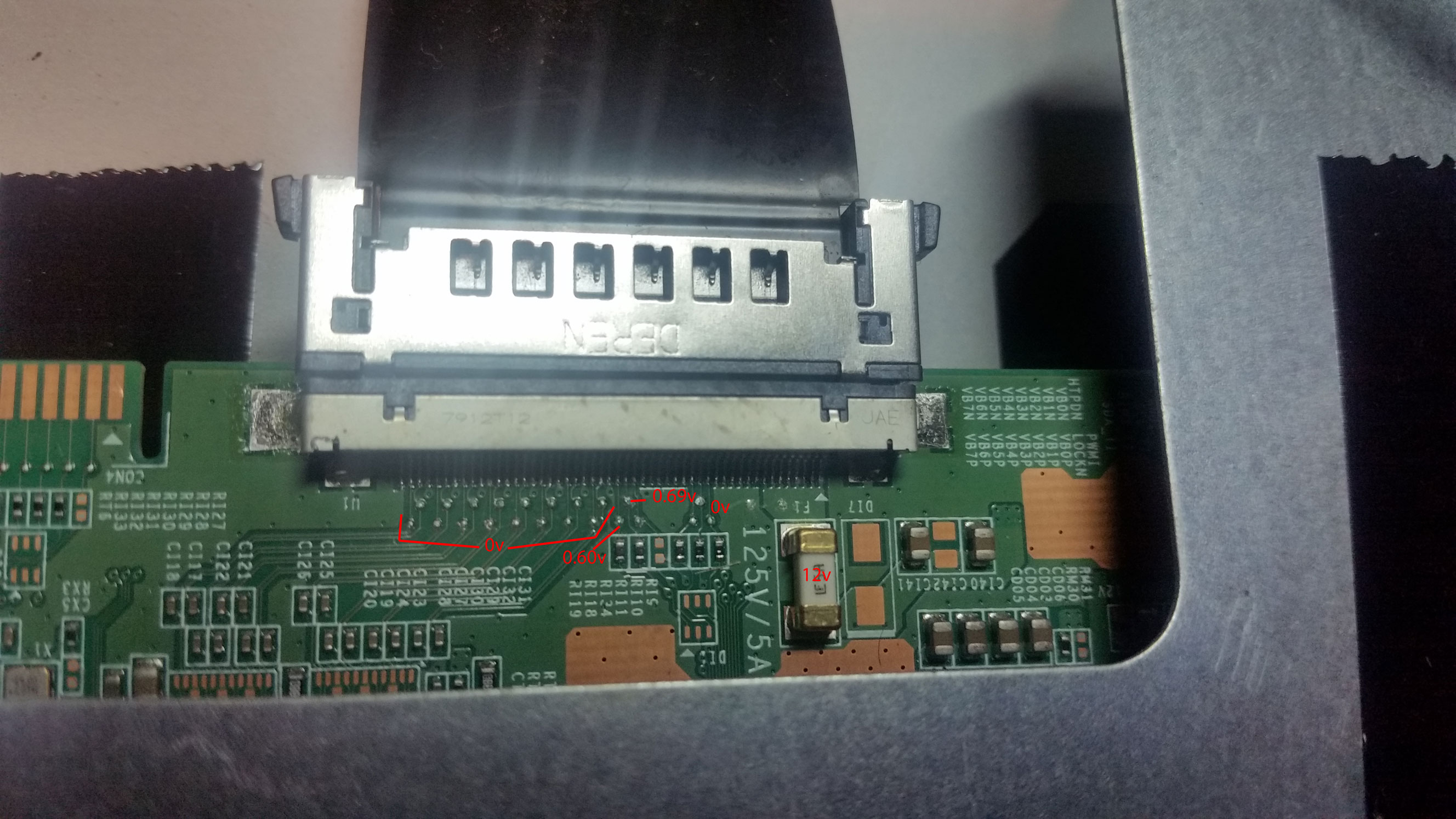

    12v present at TCON fuse

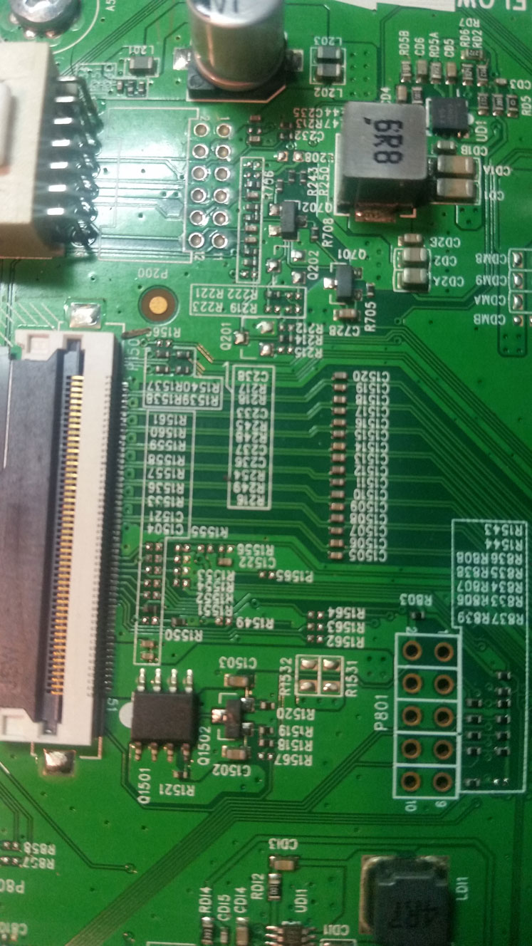

    other voltages on LVDS cable (TCON side) are missing. only see 2 pins with voltage .69v and .60v
    values dont change when disconnecting panel cables or when there is no siganl present (unplug DVD from hdmi3)

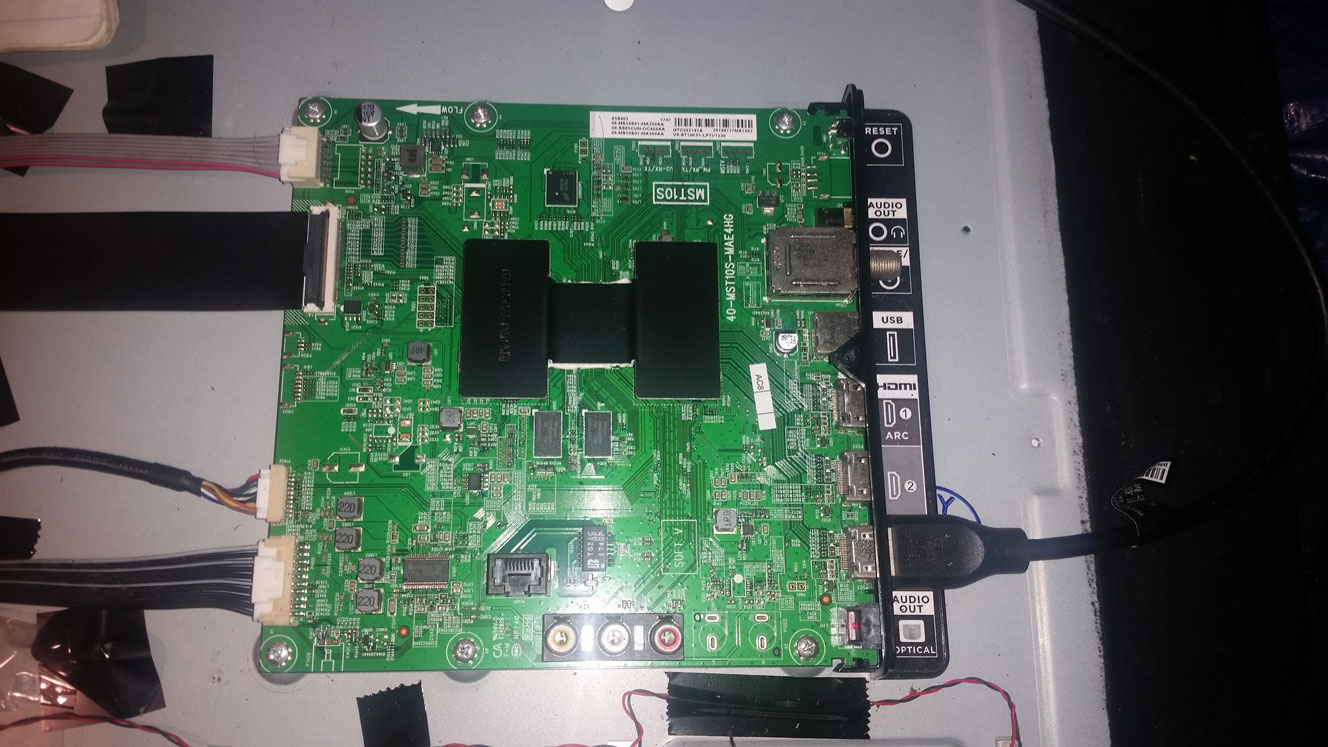

    suspect MB for not sending voltage to LVDS cable but cant rule out panel defect as well.

    anyone have any tips? should i just assume the MB is bad since i dont see voltages (besides the 12v) going to TCON?

        Originally posted by triplefour
        Re: TCL 65S403 Blank Backlit Screen w/ sound ... voltage besides 12v missing at LVDS
        MB only sends 12V to t-con and then t-con "creates" other voltages. Check for HAVDD, AVDD, VGL, VGH and other voltages on t-con, first with one side of screen connected then with other side of the screen connected. Are there any?
