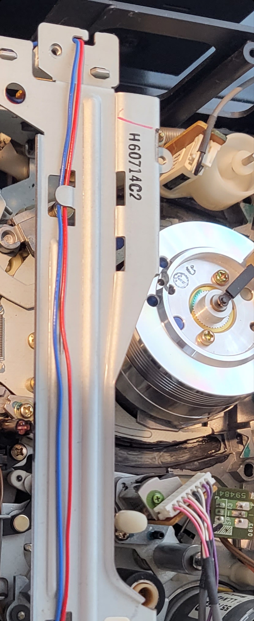

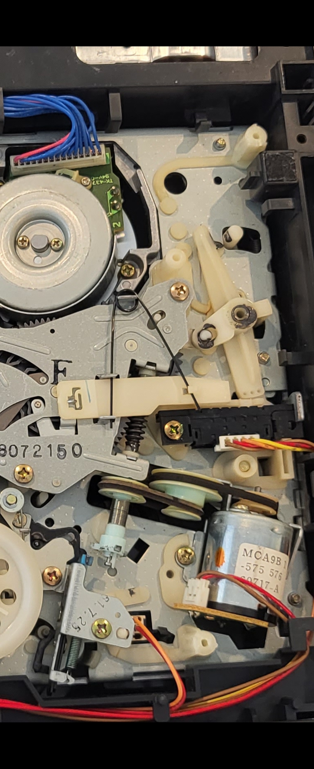

                Re: New Here! Trouble with RCA VMT-395 VCR
                Attach a picture of the lower mechanism and I will point it out, it should be near the loading motor, black, about 1/2" x 1 1/2 long usually held in with one screw.
                • SuperFrankieOSX
                  • Oct 2021
                  • 6
                  Here's a picture I took before replacing the belts, I believe I see it. Here's another picture I kinda got of the loading mechanism on the top with that gray looking grease.
