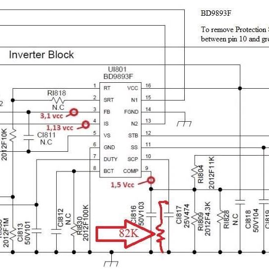

            Re: Le32b530p7xxc
            Then I would look at the high voltage capacitors on the output side of the inverter 5pf 6KV for breakdown. I would imagine that the feedback circuit of the high voltage side is activating for whatever reason normally as a result of failed ccfl's however you state that you have checked these. So I would check all the components that activate this circuit. You can temporarily bypass the protection circuit by inserting 82k resistor see attached picture however do not use it as a solution to your issue.
            Just be extremely careful to ensure you don't use it for long as can cause fatal damage to you as a result of the very high voltages on the combined inverter psu!
