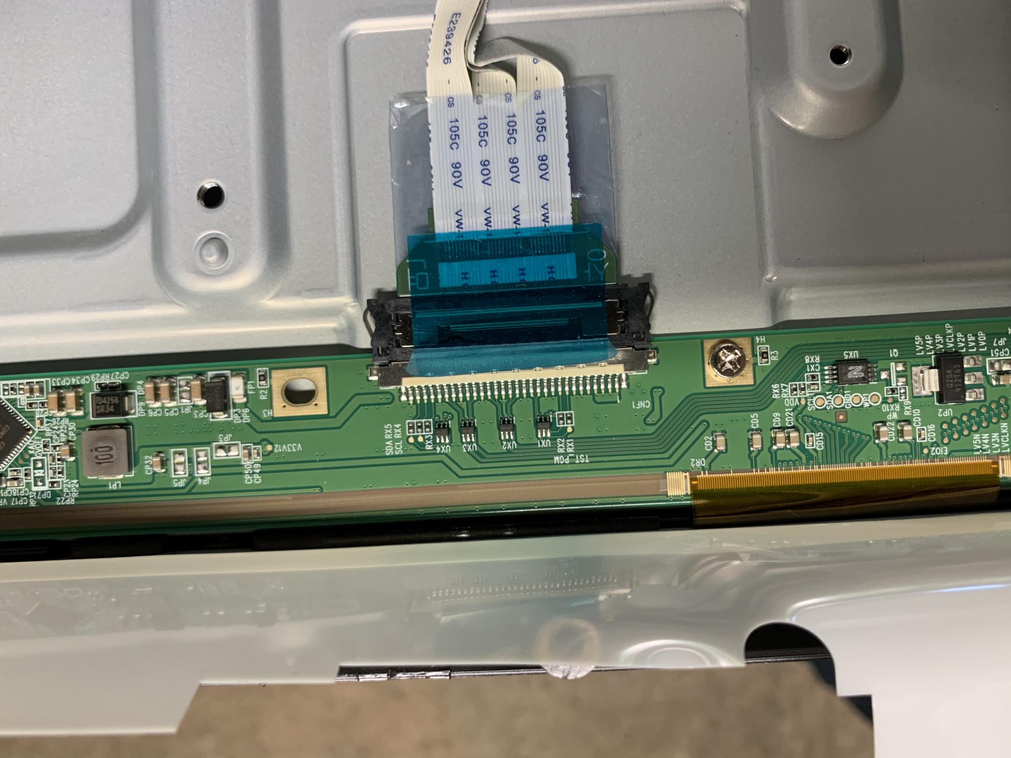

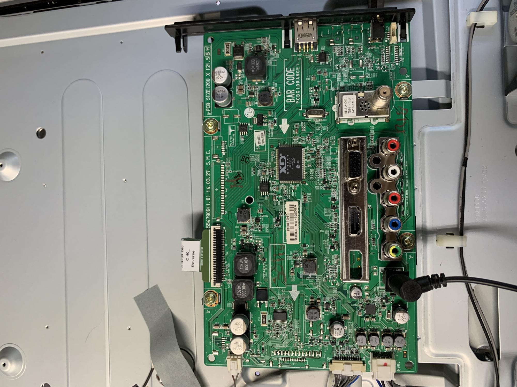

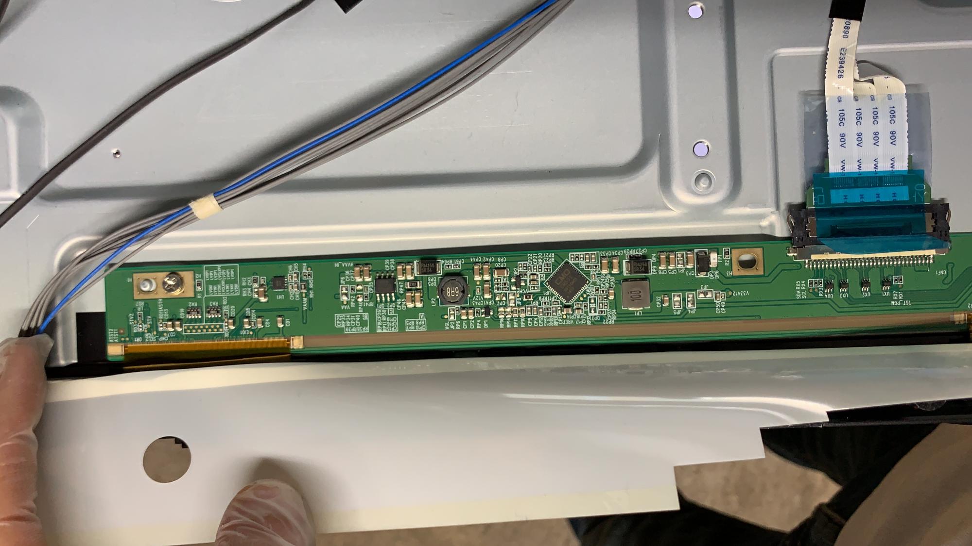

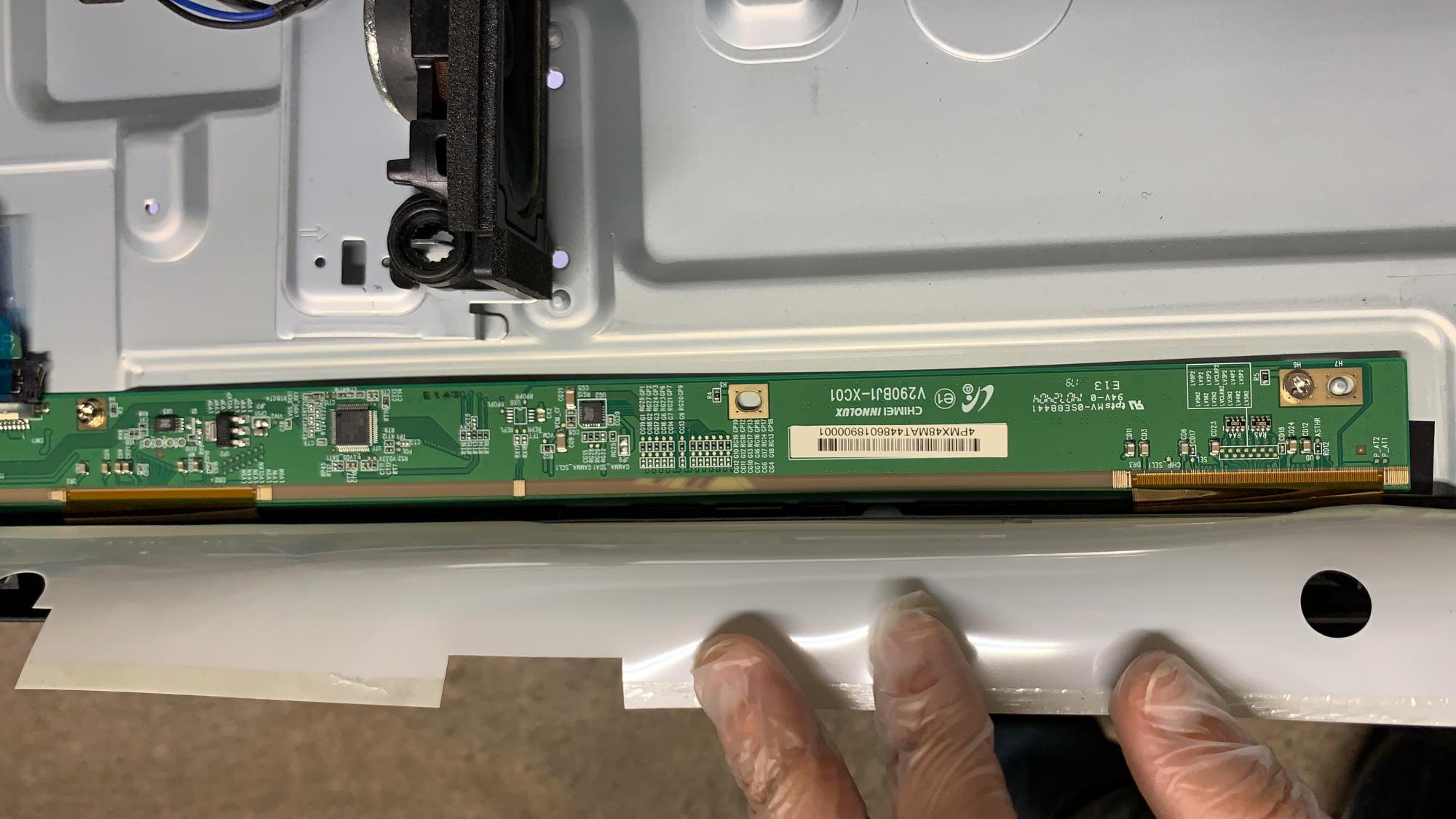

    LG 29LB4510 - Backlight on no display
    Powers on/off fine. Backlight visible but nothing on the screen, just black display.
    Made following checks on t-con
    V33v12 = 3.3v
    Vgl = -7.8v
    Vgh = 27v
    Rx5 = 3.3v
    Rx4 = 3.3v
    Rx3 (1k ohm) = 0v
    Rx2 = 3.3v
    Rx1 = 3.3v
    Not sure what else to check for at this point

      This is when a scope is useful, without it you are guessing, is it the main board not outputting a video signal? or is it that t-con not processing the signal?
      • caphair
        • Nov 2011
        • 1249
        Re: LG 29LB4510 - Backlight on no display
        Unfortunately don’t have a scope. Maybe I could borrow one. Where would I be probing with it?
