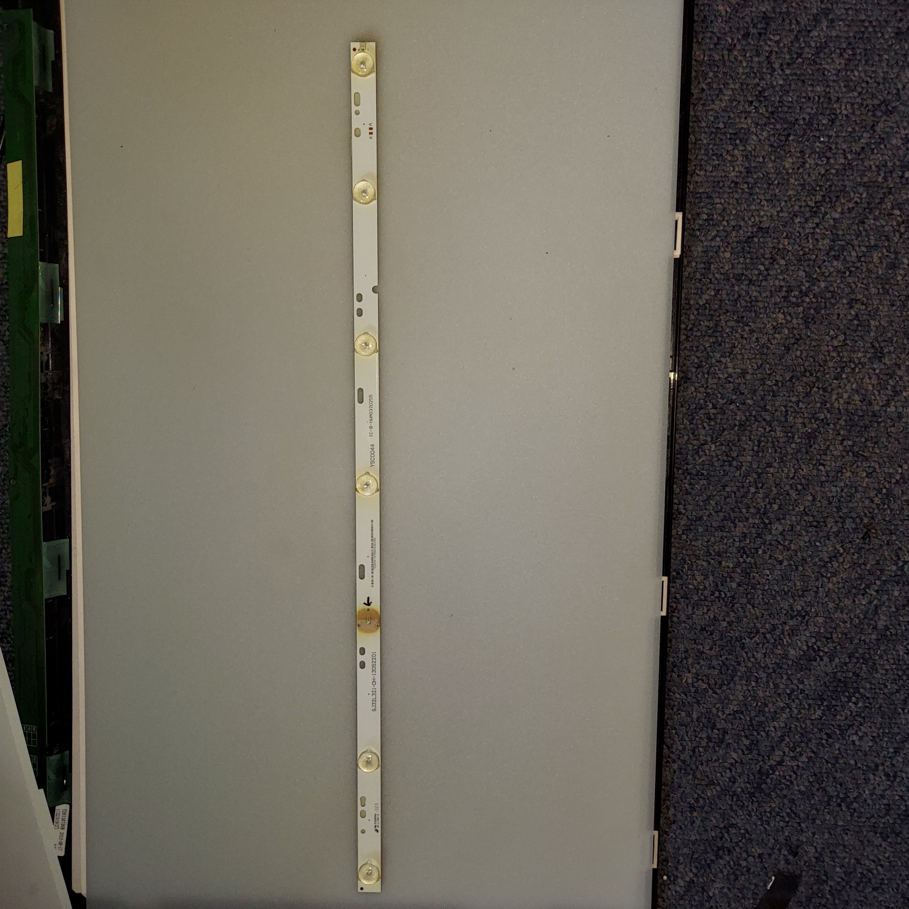

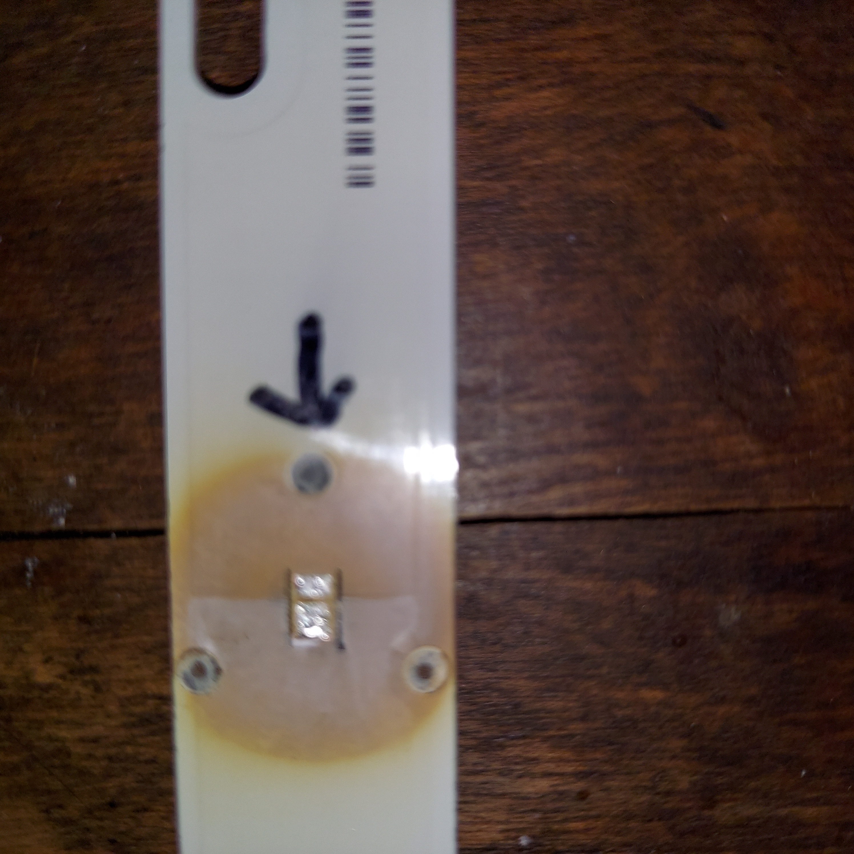

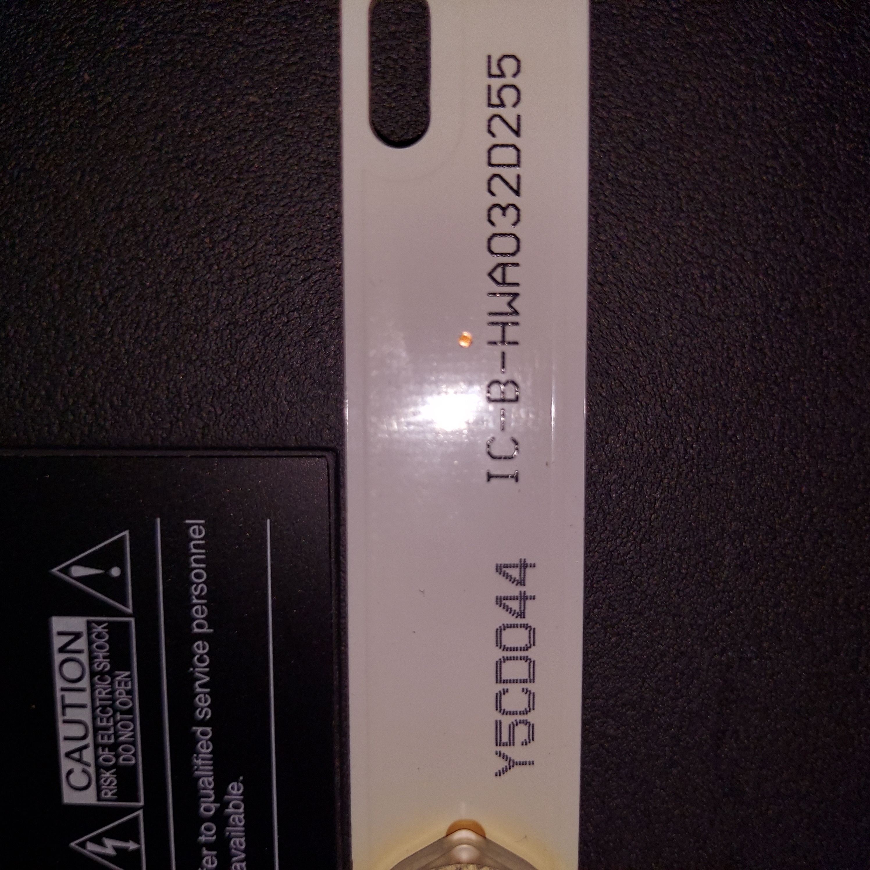

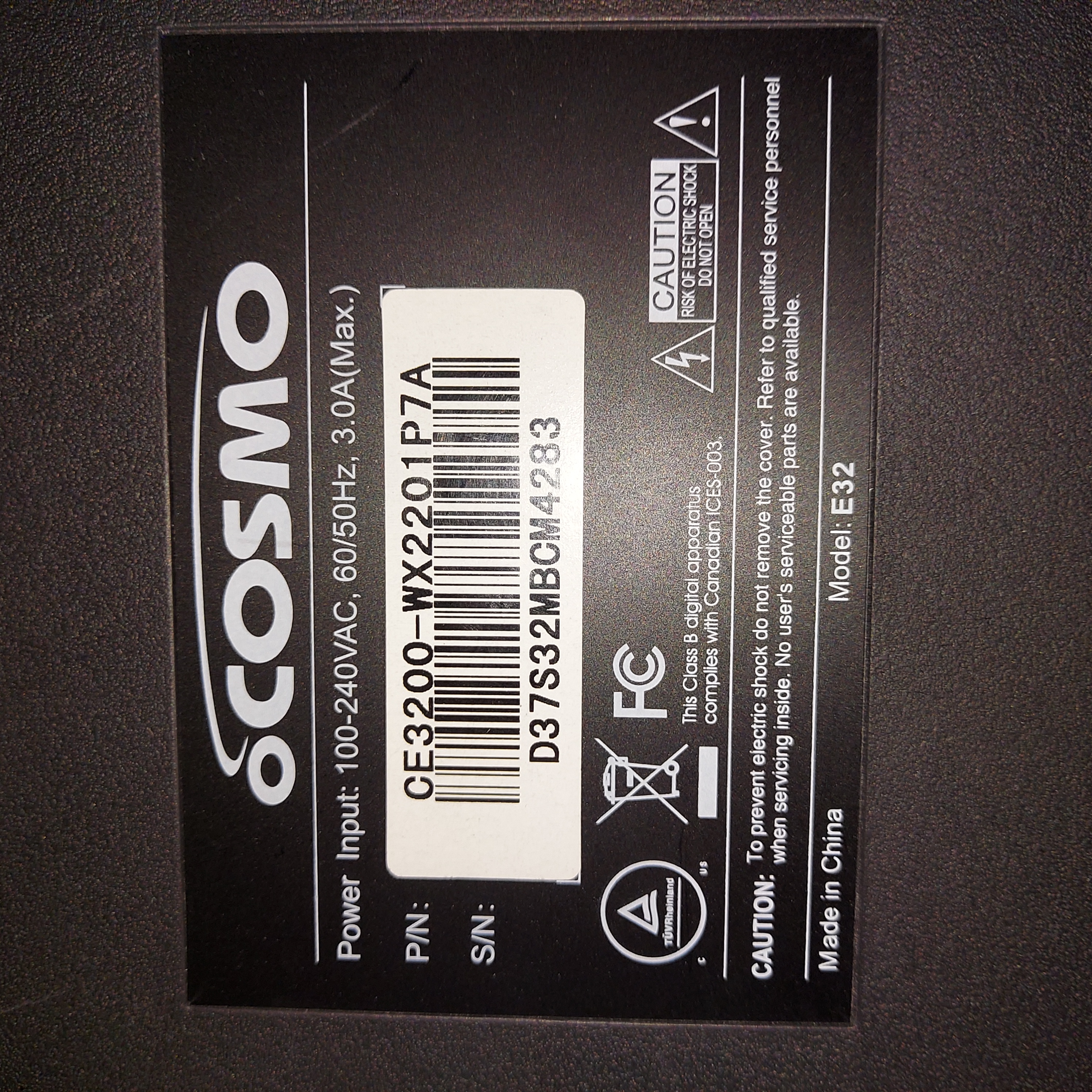

    Hello all reading this post. I have an Ocosmo E32 TV and have isolated the backlight problem to one defective LED. Testing the good LED strips I have found that each LED drops about 3.0VDC across it. Also from reading and using my DVM each LED draws about 350mA of current. My unit has 7 LEDS on each strip with a total of 21 LEDS. Guessing from this the series supply voltage should be 66 VDC. I have removed the defective LED from the LED strip and using my micrometer I'm getting a 3.5mm x 2.8mm layout. Would this be defined as a 3528 LED SMT? The next question what temperature is this LED 6000K? Is it cool white?
    Where can I get just the SMT LED to fix the LED strip?
    Attaching Photos of Device and removed LED from strip.

    Yes it's a 3528 and no there is no way to know the colour temperature that I'm aware.
    You can get individual leds from aliexpress and even ebay. Or you can look for a single working strip from that particular model and replace it as a whole.

      If you look at all the LEDs, the lenses are all yellow and heat damaged and the strips should be replaced with new. With these low end, white label TVs (RCA/Element/Haier/Proscan/Westinghouse), new strips are impossible to find. With low resale value and no availability of new strips, I don't bother with them anymore. The part number usually has the screen size embedded in it. Shopjimmy shows out of stock but even for $30 plus shipping, it is more than the value of the TV (32" non-smart). Replacing the single bad LED is a temporary fix since the remaining ones are likely to fail.

        My recommendation is to replace ALL the LED strips with new ones. You will not wnat to have a repeat failure with the older ones acting up in the short term. Do a complete job once and for all.

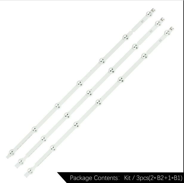

          Looks as I have found some that will work. All 3 for $12.35 from ebay.
          Product information
          Condition: Brand NEW
          Size (Length): 630mm
          Number of LED beads: 7 per strip
          Every LED Lamp Voltage: 3V
          Package include: Kit / 3pcs(1*B1+2*B2)
          May have change connector or cut harness and solder directly to panel,

            Those strips looks like they are for LG models. You will likely have to wire direct and cut new holes in the reflector sheet. For a 32", it isn't too much work and they are likely wired in one long string but you don't want to do this for for larger TVs. If the lenses are different, you may get an uneven backlight but don't think it will be an issue in a small TV.

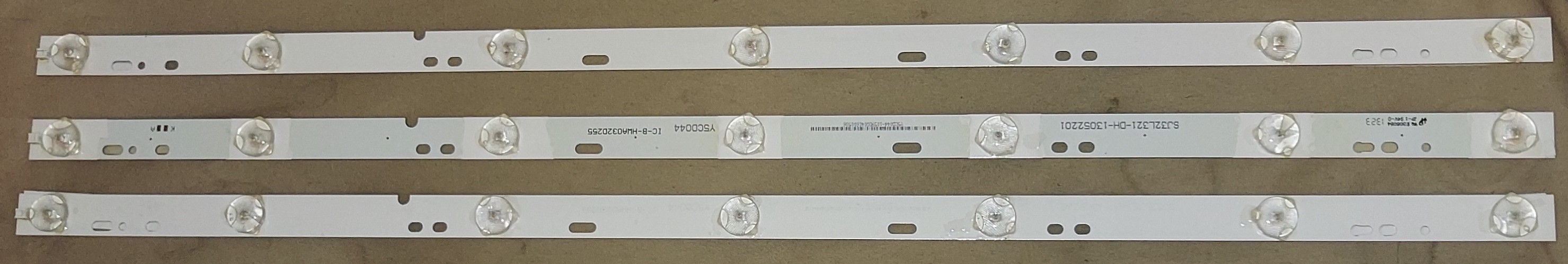

              Update: I took your advice and replaced all 21 LED's. I used my Hakko FR-801 set on heat range 4 and air at 10. Each lens popped off in a few seconds and just dressed up solder pads with fresh solder. I let the pads heat up until the solder was molten then placed the new LED on the pads and it seemed to seat by itself with gravity. Tested each LED after soldering to insure proper polarity and connection. I am going to mask the LED's off and paint the light strip with white glossy enamel spray paint to make the panel uniform as each replaced LED area was discolored due to heating. Using urethane glue to put back down the diffuser lenses. Will submit pictures of light strips when completed.

                  These are the finished panels. I used a high gloss white enamel paint and then used a urethane clear glue to attach the lenses.
                  If you're wondering why the center panel is a little off white after the LED's it's because I masked off the part numbers for reference.
