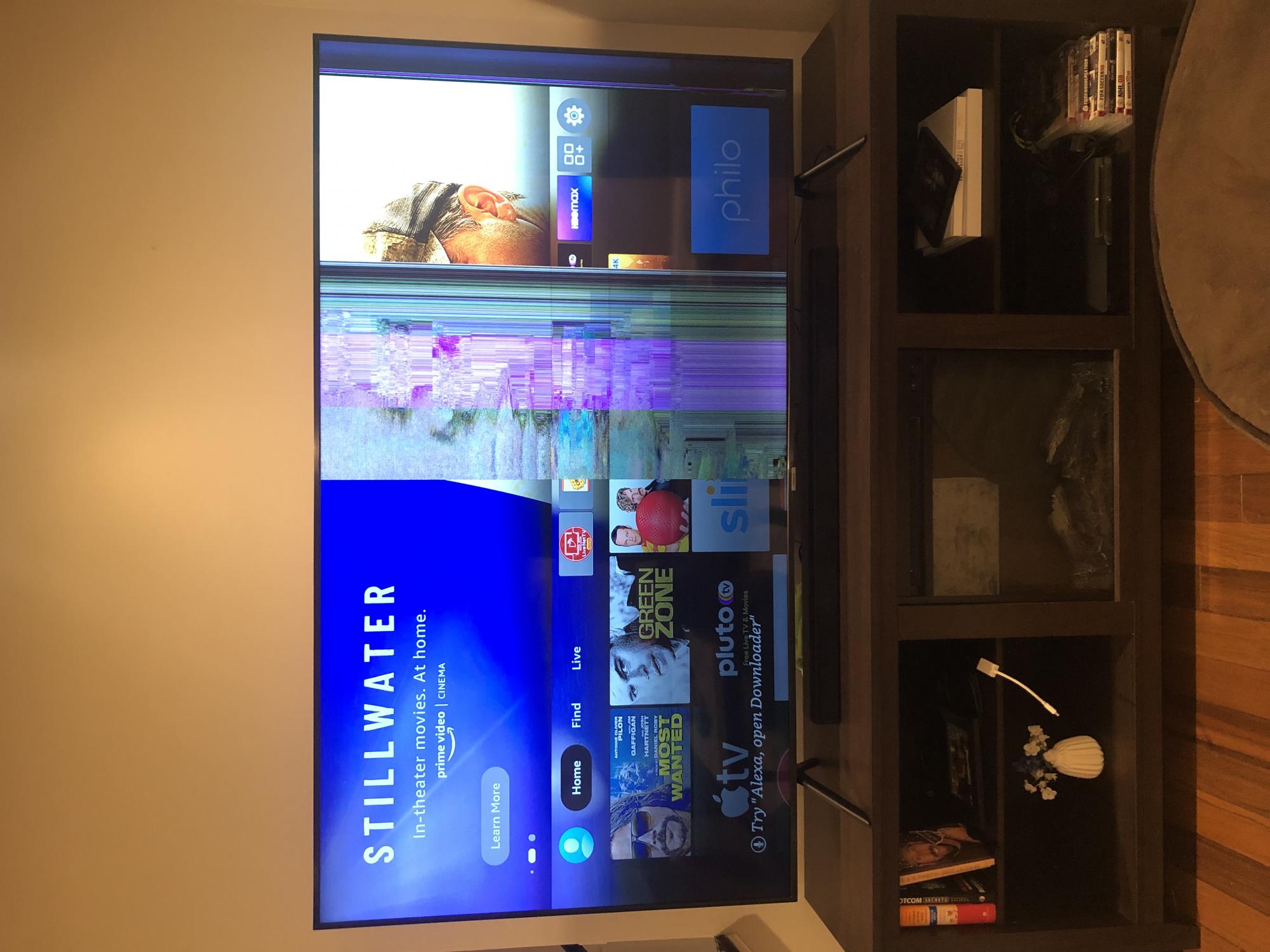

    It's 100% nothing to do with any of the color settings. I've tried a million variations but the issue still remains. Next step is to order led lights. I'll keep everyone posted. Thanks all.

      bad diagnostic method...

        How is this a bad method? I'm eliminating all the variables. If it works, great, if not, no big deal. I'm not going to cry over $50.

          setting apart of a big screen is high dangerous, must be more sure it is not the power suppky, i have told this, read past post.. 5 minutes test..

                Replaced the led strips and I guess I wasn’t gentle enough and it appears I cracked the panel. Am I right?

                  normally don't crack screens in that area. I'd check ribbon connections or you have tab bond issues.

                    You have a cracked side part, after you have also a center crack or a cut in a cof tab.. tv for the landfill... i hope you were non alone, it's fool to dismantle a giant tv by himself..
                    Next tv let to add to it by a technician a protection for the transients, either outside or inside the tv, for example some varistors, maybe the next tv will last longer also the backlight...

                      Looks like you have damaged the panel/ cof tabs.You should have asked for a replacement under warranty since the tv was 1 year old and not fuck around change every part of the tv just cuz the colors are a little bit of.
                      Sorry but the tv is not repairable anymore.

                          Thanks I'll check it out.

                          Nah, I like the challenge and yes I had help.
