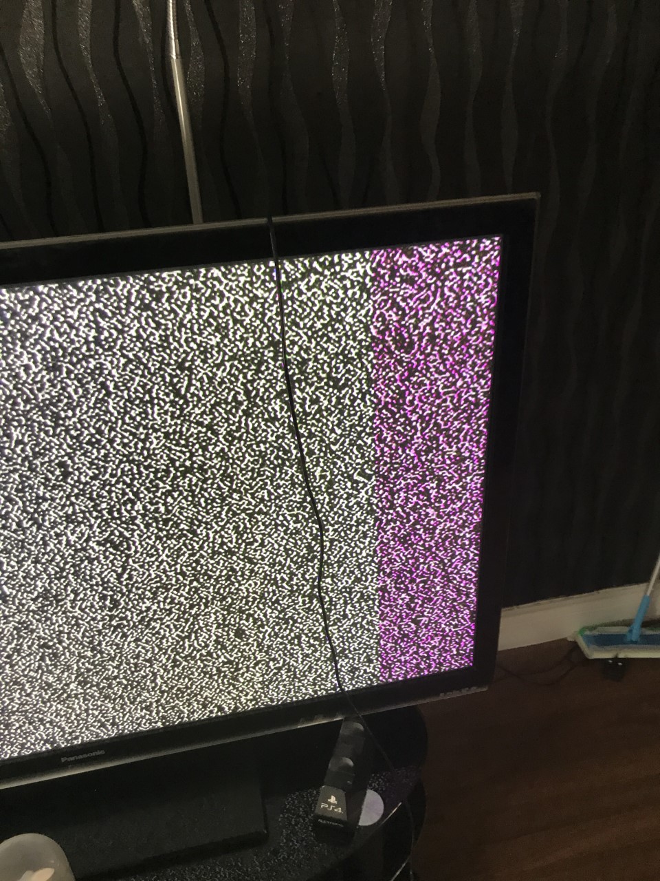

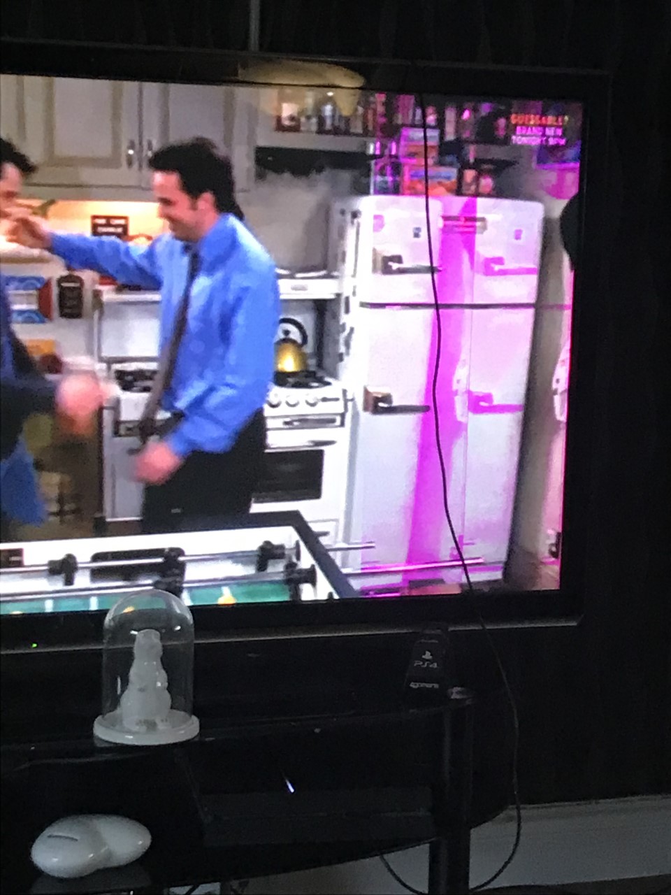

Panasonic TX-P50XT50B Strange Vertical Discoloured section.
  • StephenU
    • Dec 2013
    • 230
    • United Kingdom
    Hi all, wondering if anyone can help with this issue i'm currently seeing on the above Panasonic Plasma. I have a section going from the top to the bottom of the tv where it goes discolored, this is very intermittent. Any pointers as where to start would be greatly appreciated.
  • R_J
    • Jun 2012
    • 9624
    Re: Panasonic TX-P50XT50B Strange Vertical Discoloured section.
    If the fault is intermittent, check the cof ribbon connection to the driver board at the bottom of the screen below the problem section.
