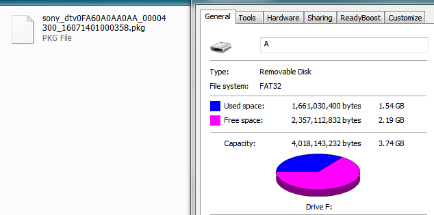

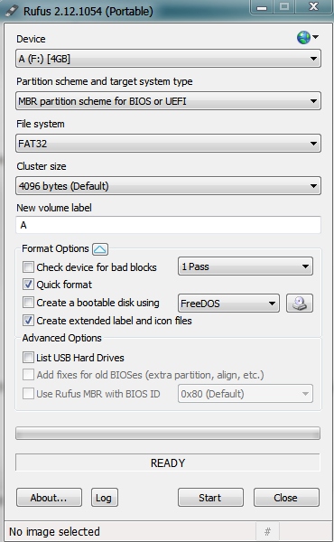

            Diah, thanks for advice, take a look at screenshots and see if I done it right. Also, there 3 USB ports, any of these is OK?

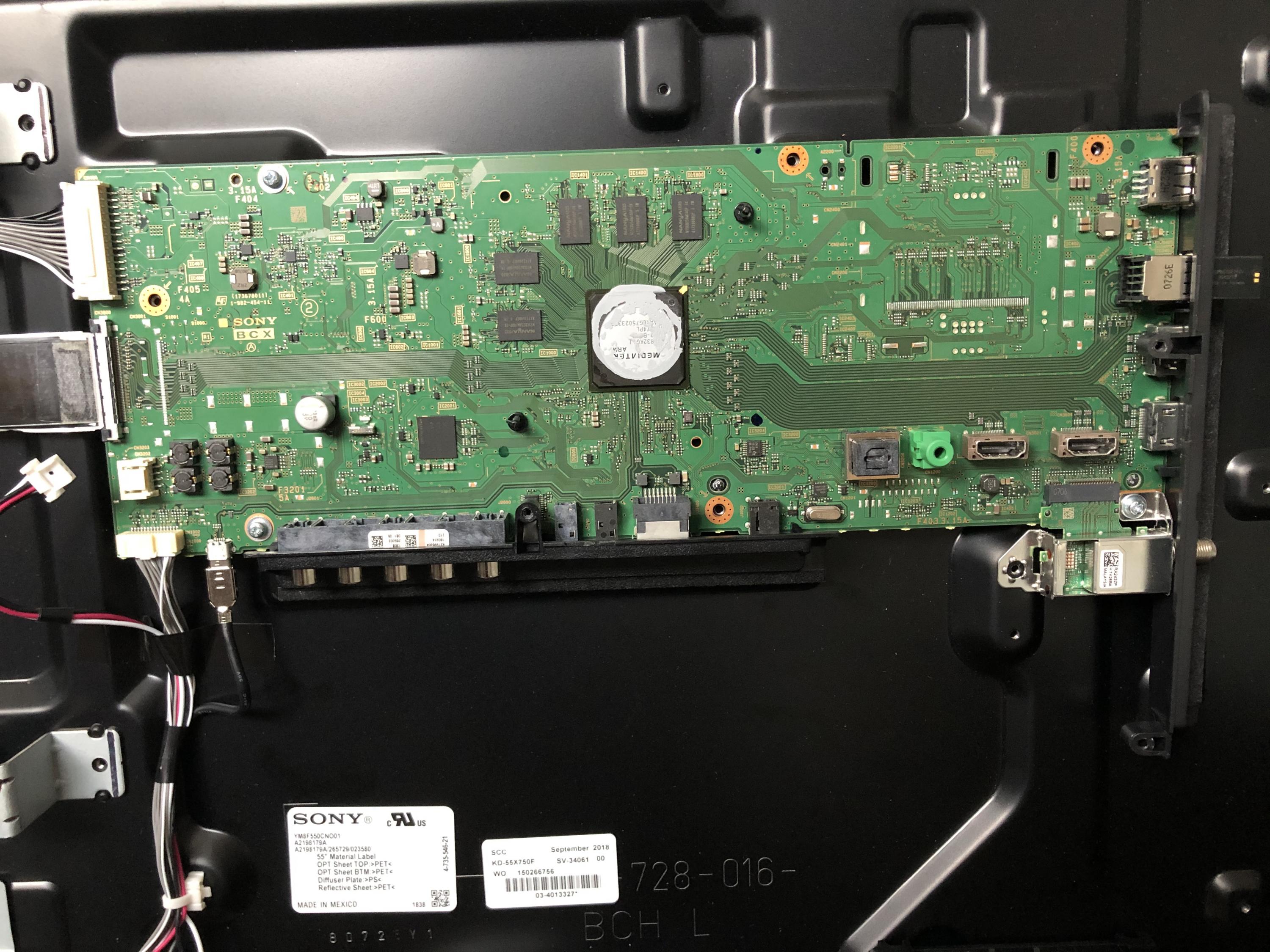

            On #2, yes, it could be hardware problem too. The main board was not abused and I was the first one who removed heatsink, but few screws are missing, so somebody already looked at it.

              Re: Sony KD-55X750F bricked, keeps rebooting
              i use always command at windows CMD if i have new usb flash to convert it to MBR,
              look here i wrote before how to

                TVs have always a serial port for debug, if you have schematics it's better so you can check if it is present on vga or hdmi port, but if not there is at least a not populated connector on the mb of 4 pins.

                  Attempting update via USB didn't help, tried many times. I did format it as Diah suggested.

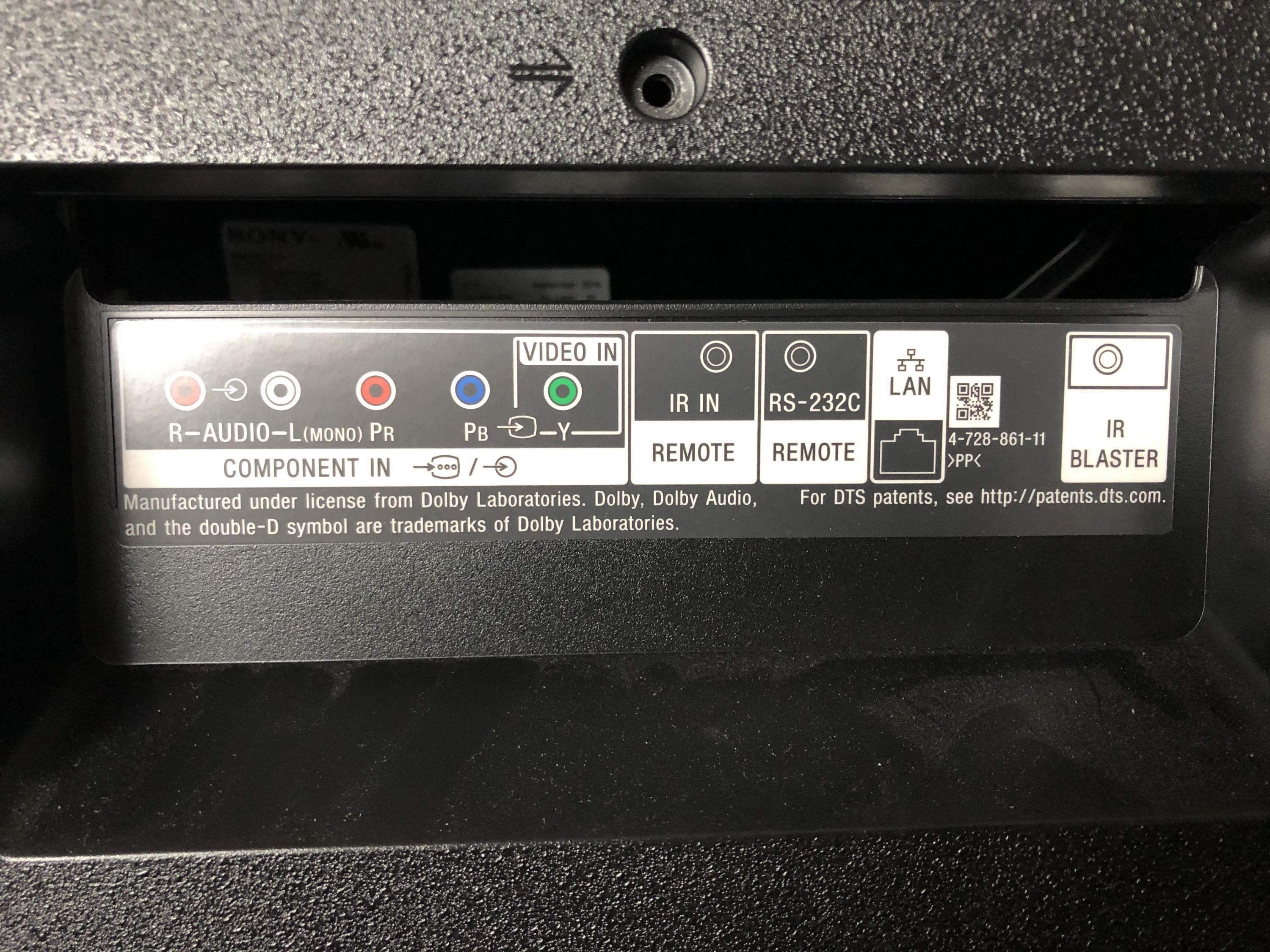

                          Still need to identify that port.
                          Take a look at pictures, is it RS-232C remote?
                            I've never done it on a Sony, maybe it is that connector but you have to check if prior it there is a level shifter IC like max232 or similar, to know the correct interface, or them are those 4 pins on the bottom of board right to that quartz and under the optical out, the pins to be used are the one visibly at gnd and the 2 center ones, that is a 3v serial
                              its so limited the UART, i am not sure you will get info to located the issue
                              however what i know and use
                              RS-232C are the TX RX for UART , the connection with audio stereo Jack as following
                              stereo Jack:
                              TIP = TV TX go to yours TTL RX adapter
                              RING = TV RX go to yours TTL TX adapter
                              SLEEVE = GND
                              Terminal Protocol:
                              Baud Rate: 9600 bps
                              Character Length: 8 bits
                              Parity: N/A
                              Start Bit: 1 bit
                              Stop Bit: 1 bit
                              Flow Control: N/A
