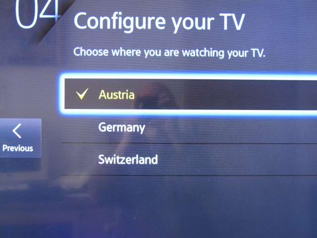

    Hi guys! I have trouble with setting of my TV Samsung UE48H6470 after replacing of mother board. There are displayd only thre countries in the table "Location" - Germany, Austria and Switzerlad. See the photograph. But I need The Czech Republic. I wanted to change the "Local Set" in service menu, but this item is missing there. I do not know, what to do more.I am helpless. Can somebody advise me, please? Thank you. Miloslav

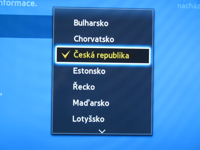

      Thank you for reply, but I do not think you may heve understood me well. My problem has nothing to do with Smart Hub, has nothing to do with internet. I will try it otherwise.
      If I want to install the TV for the first time, I am asked for Language of Menu and then for the Place of watching TV. I thing the place of watching is important, due to the right charakters in the text applications. We have for example č, ř, ž, é, á, Č, Í... When I can not set the Czech Republic, I have then wrong characters. For example instead č - ?, ř -!, ž - % atc. Normal table of places is full of countries, but I have only thre - Germany, Austria, Switzerland. So my question is how I can get the full table. What have I to set in Servce menu?
      Thank you very much for help. Regards. Miloslav

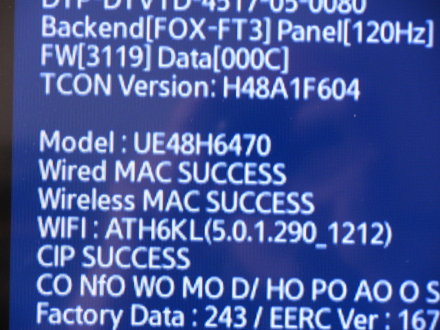

        look on the back cover of yours TV, you need to match the letters after Samsung UE48H6470XXXX with the model type at service menu.. after change the vlaue need to do do hard reset from the service menu.

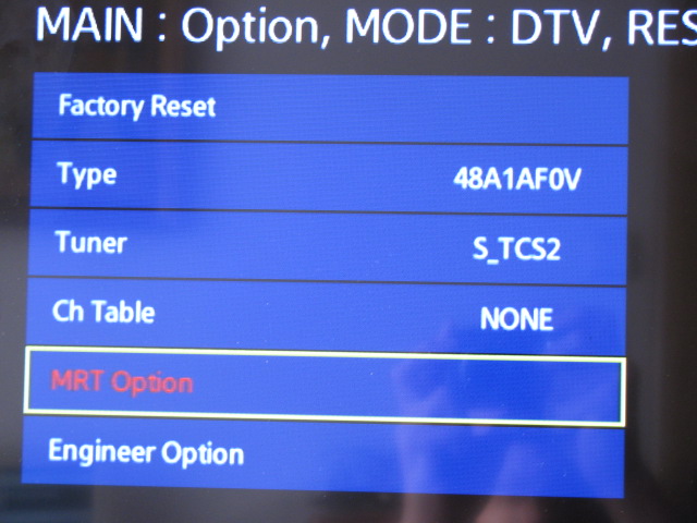

          On the cover of my TV is written UE48H6270SSXXH. In the service menu is written: Model UE48H6470 without else letters. See the photo. So where and what should I change? In my opinion the model is now given by the new mother board without regard to legend on the back cover. And also in the model UE48H6470 must be the possibility to set the Czech Republic. But the question is how.
          In normal situation there are a lot of countries for choice, but I hawe only thre. Look at the photos. Somethig is wrog. Thank you for reply. Miloslav

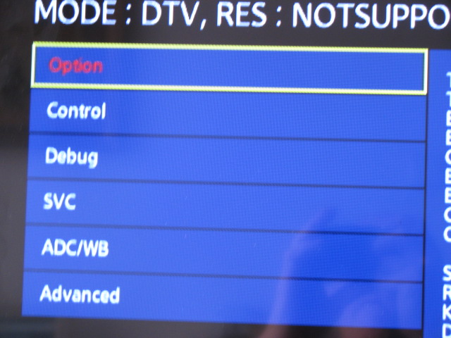

            show us more photos of yours service menu pages

              Enter the service menu with a service remote , go to the options and select LOCAL SET, there you can change that option into the country you live. For example there is EU_German for Germany, Switserland and Austria, there is EU_Benelux for Netherlands, Belgium and Luxemburg and there are many more. After selecting the correct setting go to FACTORY RESET and press enter a few times until the tv switches off. Now the TV is ready to install with the correct options.

                  There is no LOCAL SET in my OPTION menu. This is the problem. Look!

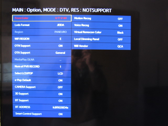

                    do you have under MRT option region?

                      Yes, how can you see in the previous picture. But the region is displayed only weakly. It is not possible to choose.
                      I have another simillar TV Samsung, which has set the same region, PANEURO, and the charakters are displayed OK. That means in this item is not the problem.

                        i asked to show us photos on the service menu... where are the MRT Option photos?
                        search after samsung service remote.. you need it so all option will be active.

                            The MRT Option photo is here. Do you think, it is not complete?

                              go back to the first option and make factory reset.( could be this mainboards rooted before ) after that use samsung service remote i linked it to you, also check if there any firmware update
