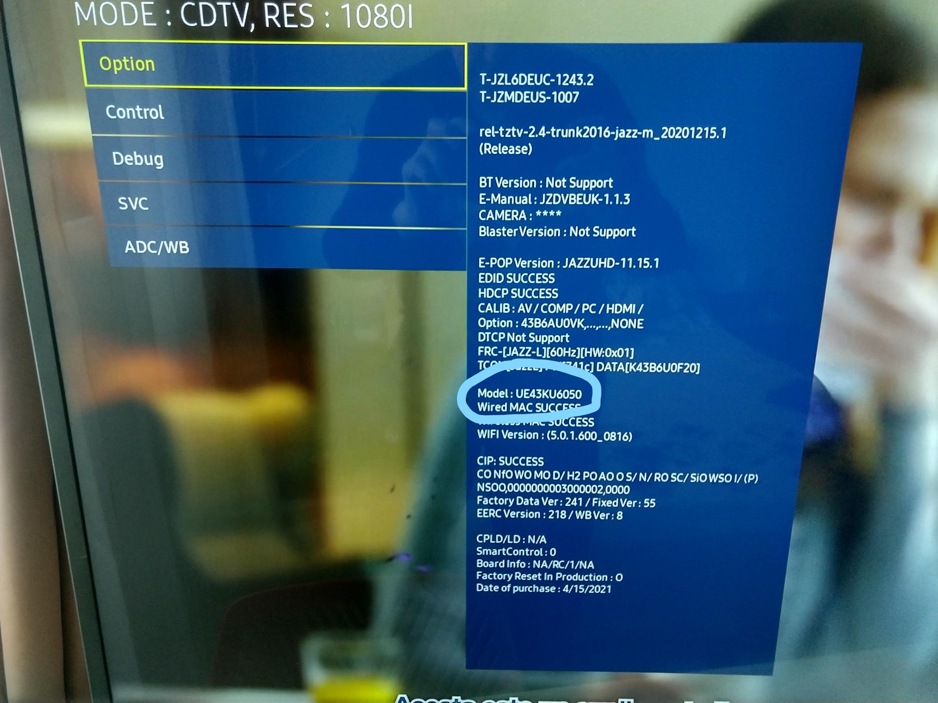

      1. To my shame I don't know what f or ff is
      2. Unfortunately for the European area it seems to be made for Italy (and a Nordic country). Everything on the net is in Italian
      3. Do I risk writing UE43KU6072 firmware on UE43KU6050 board? (they have the same codes and work with the same panel. The difference is that the defective one also has the lnb input).

            no need to write firmware.. just change the model No to yours original and make factory reset at service menu. i think you need here also S.RC

              The first thing I did was go into menu service and do a factory reset. The model changes from the TYPE ?. I knew that was the type of panel.
              I don't have a service remote control.

                  I know how to use files. I also have the LED mounting. I used it at LG. I connected the LEDs to the headphone output of the laptop. Maximum sound and open with winamp. I entered the service menu with INFO / MENU / MUTE / POWER. I accessed the wav file FACTORY + 3SPEED, I opened it with winamp but nothing happens. The 2 LEDs are next to the IR receiver on the TV.
                  L.E. The TV works perfectly. Even if it has only Italy, it receives all the programs in my country (Romania). Maybe just writing UE43KU6050 instead of UE43KU6072 is annoying. An exchange of experience on this minor issue I think is useful.

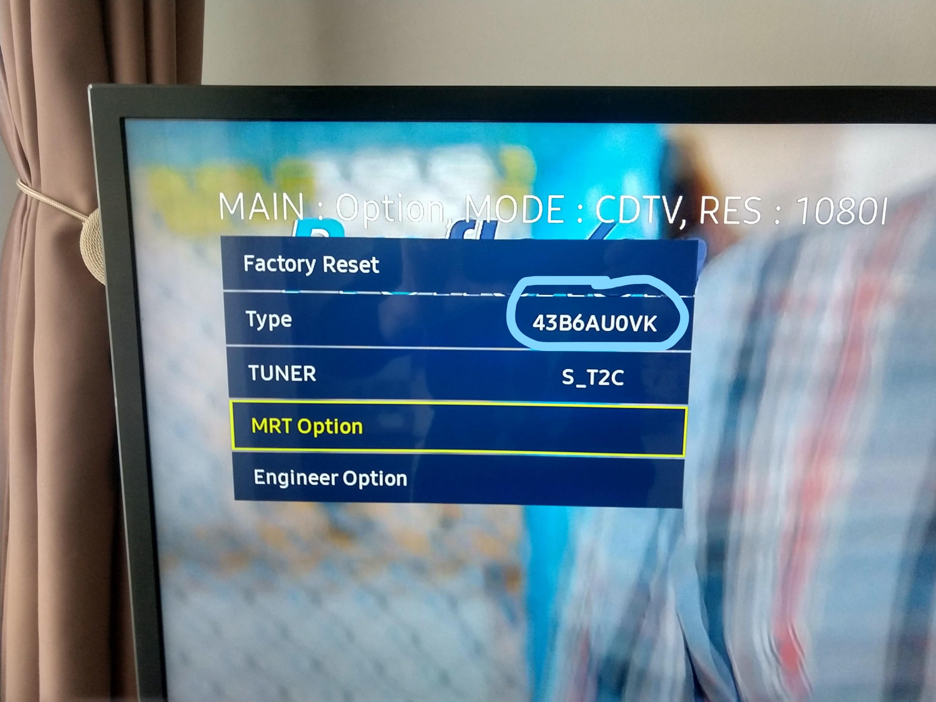

                        So what happens, can you choose MRT option?
                            That appears

                                  Paneuro, pannordig, afr, s_afr, chi, hkg, usa, cuba.

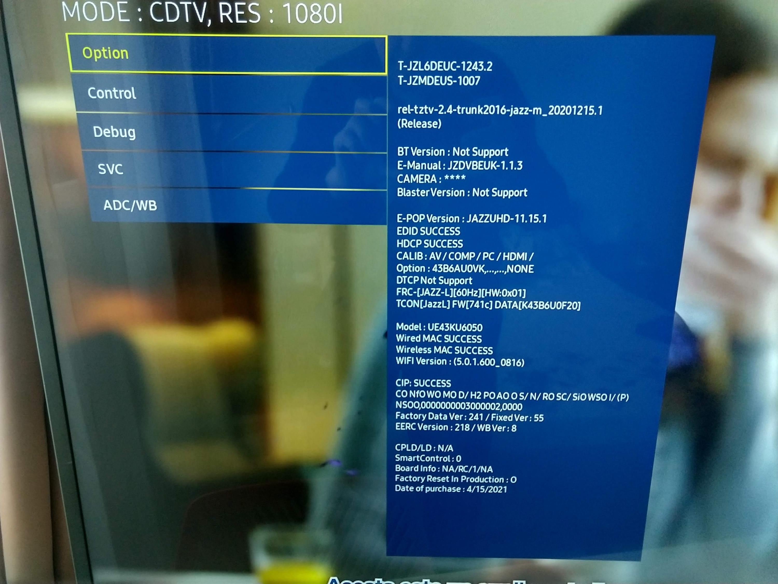

                                    Don't know what is left if you tried everything else, possibly ser. rc or flashing with the UE43KU6072 firmware, it looks like these 2 mainboards are from the same year, just my opinion as I haven't had this exact situation but I have used different firmwares than the exact ones with success but I don't think it will hurt flashing the firmware with UE43KU6072.

                                      Before writing the UE43KU6072 firmware on the UE43KU6050 board, I'm waiting for some more opinions.
                                      I entered the service menu and accessed the 3speed wav file. The TV has entered burn mode. When accessed again, it returned correctly in service mode and with a hidden setting: ADVANCED. The problem is that it can be accessed (does not open).

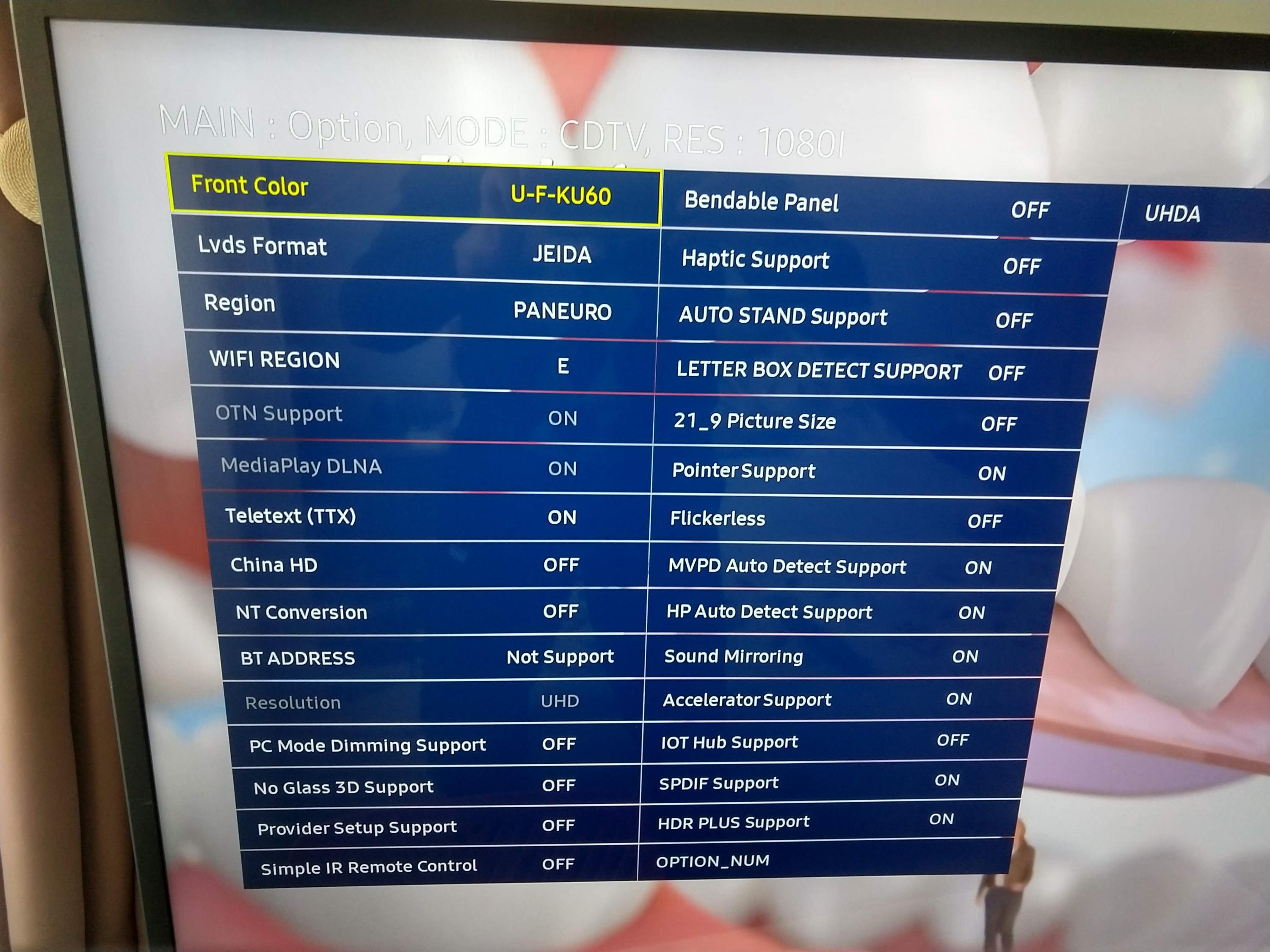

                                        You can easily enter Service menu by pressing INFO & FACTORY (INFO_FACTORY_inv.wav) when the TV is on. At this moment Local set and others options are unlocked.

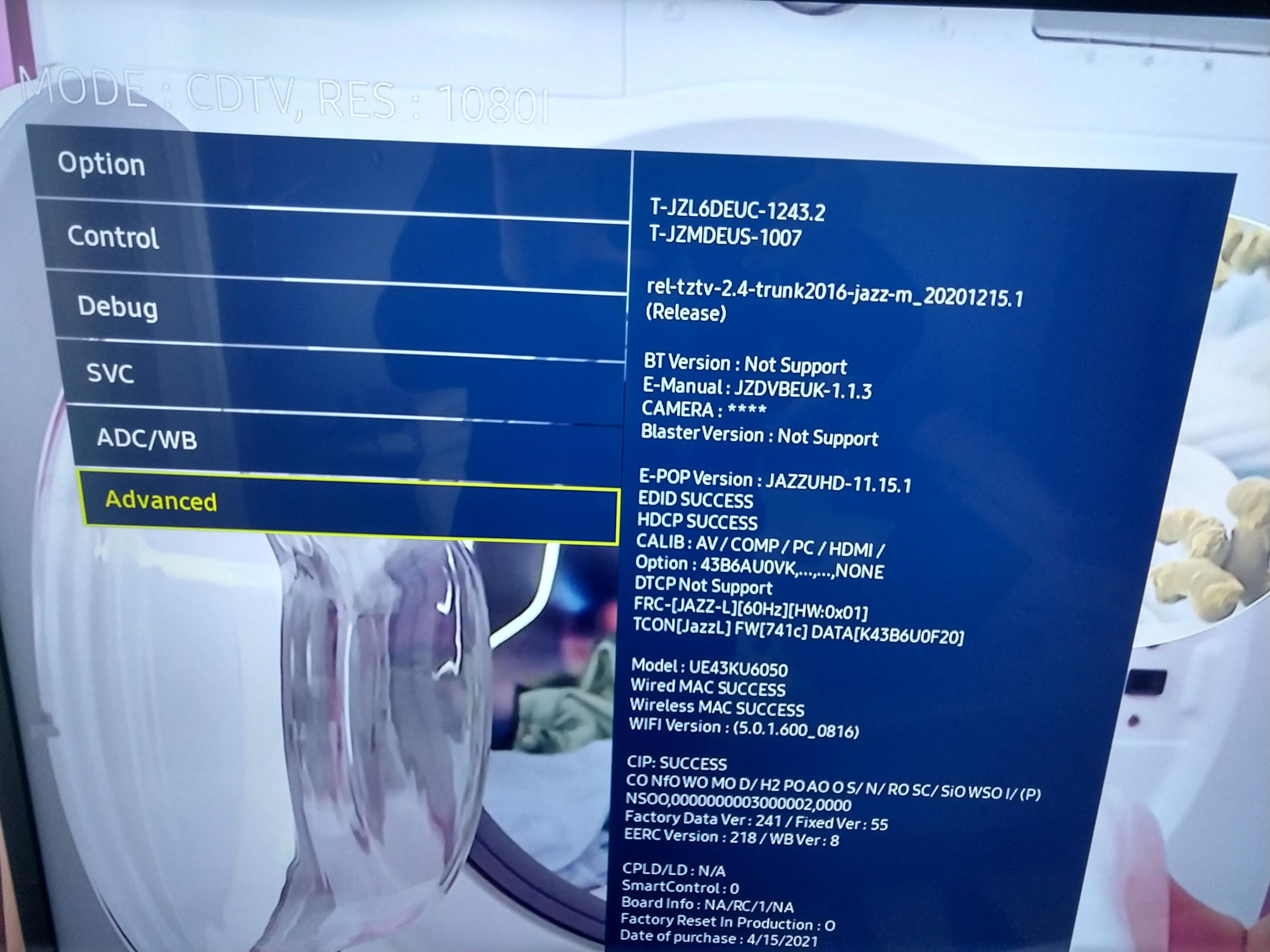

                                          With the TV on I accessed the wav file INFO_FACTORY. The TV has entered the service menu with more options than normal including Local Set. From there I was able to select the EU where my country is. I also changed its name from KU6050 to KU6072. Thanks to everyone for their help.
